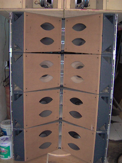

3 years ago we have a line array project...everything was home made "DIY".
here are some pics when we used it in MOA...4 per side delay fills.
its quite impressive...the more array you have say a min. of six boxes...the more directional you will achieve...very good.
problems: down fills needed...center fills needed...side fills needed.

nice pics sir 🙂. what components are you using for your diy line array?

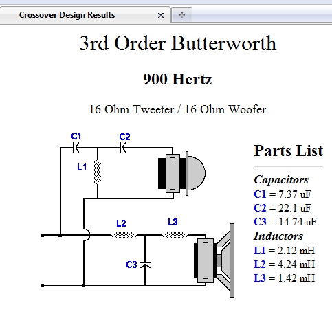

@jef3...all drivers are local...12" JH126...1" x 2 Hi driver Crown 500...passive crossover at 900hz 12db...3rd order Butterworth...there are Series Notch Filter,
Parallel Notch Filter, Driver Attenuation Circuit, Impedance Equalization.
it became complicated when we wanted to have a flat response...and the rigging labor is hard, because you have to respect the safety of the crowd and the riggers...anyways it was a good experience and we learned by means of real world application and not just by reading materials.

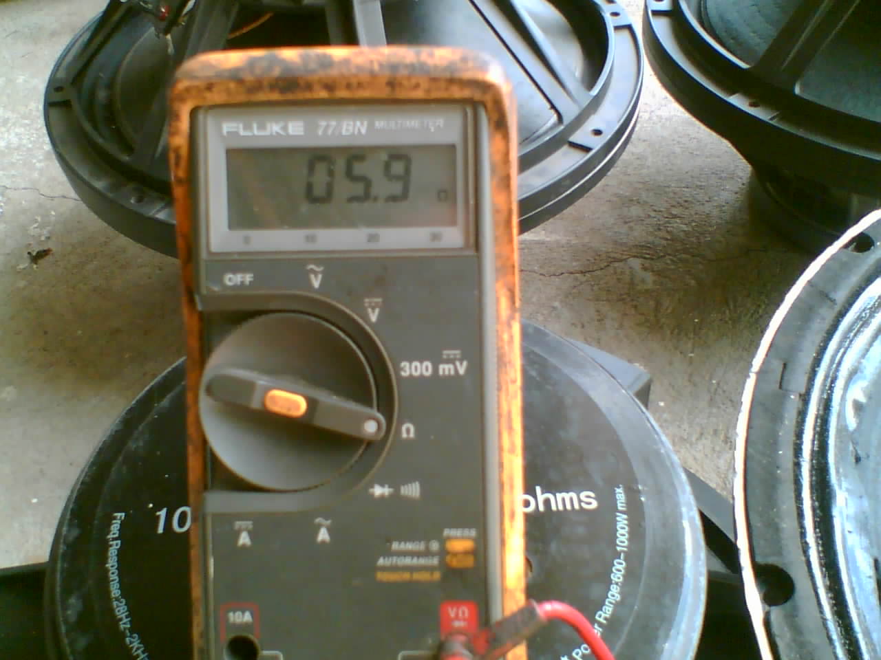

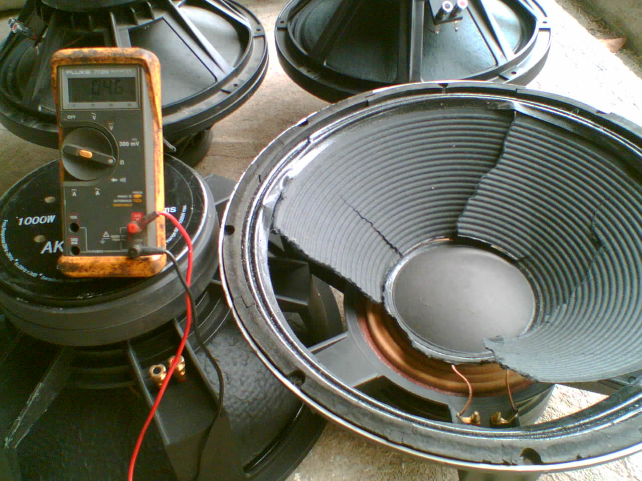

just arrived yesterday...the driver with the intact cone has a burnt voicecoil (where the DVM is sitting on), the other one with a shattered cone has a good voicecoil "both" had been pulled out from a bass horn😕😕😕

sir i would like to ask what kind of metal braces have you used for those line array, is it aluminum alloy or steel? and where can i get those kind of materials, i have projects that needs those kinds of metals i hope they have other form of it or tubes...thanks

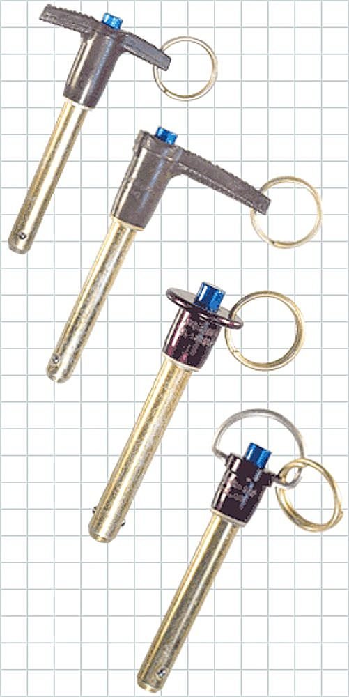

@wakanga...aluminum bar .5" x 2"...inserts .75" bronze round bar...inside the box are BI iron flat bar 1.5" x .25" with weld insert nuts...we machine fabricate everything...the assembly could have been simpler if we have the button head positive lock pins...anyway it was fun and learned some.
if you want the flying harness plan i can give it to you...and improve it...try to look for positive lock pins " its a must use".

thank you for the info pards. your line array reminds me of the outline butterfly line array. 😉
just my two cents to improve the frequency response and over-all sound output.
firstly, have you tried an active set-up i.e. putting it on bi-amp? for me, using a passive network will save you on amplifiers but over-all calibration may be a compromise. the dbx driverack pa plus is an almost complete tool for this. a crossover cut-off of 1.6 kHz may do well.
second, have you tried upgrading your speaker components? most groups i know have changed to p-audio as direct replacement on their china-made line arrays. the most popular yet tested 1" hf driver are the bm d440 and bm d440s. these can also be used as direct replacements on most 2way powered and non-powered system with faulty hf drivers.
P-Audio BM D440 (bolt type) 1" HF driver 50w rms titanium diaphragm & aluminum voice coil with ferrofluid p2600
@jef3...yes Sir, first modeled from a DRPA...everything is good using all the available tools from this loudspeaker management...but we challenge our self to do it passive...making it more interesting to learn the DIY way.
anyways it was fun and lessons were learned...LET THE BIG BOYS HANDLE THE BIG EVENTS...they have the inventory.
P-audio are good drivers we have them fitted for some our clients...we dont have to spend much on a project that will not materialize, we know that honestly speaking, we just want to experience what are the benefits we could get from a line array system.
as for now we are happy with our horn loaded array boxes...for a very small sound company like us we are contented on what we can cater...for now
