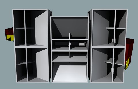

@adkins845...

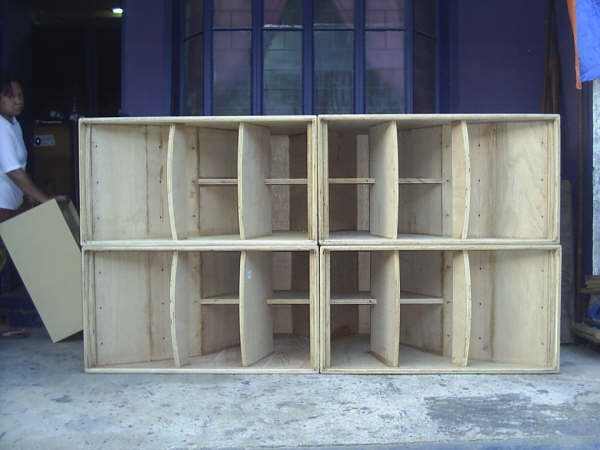

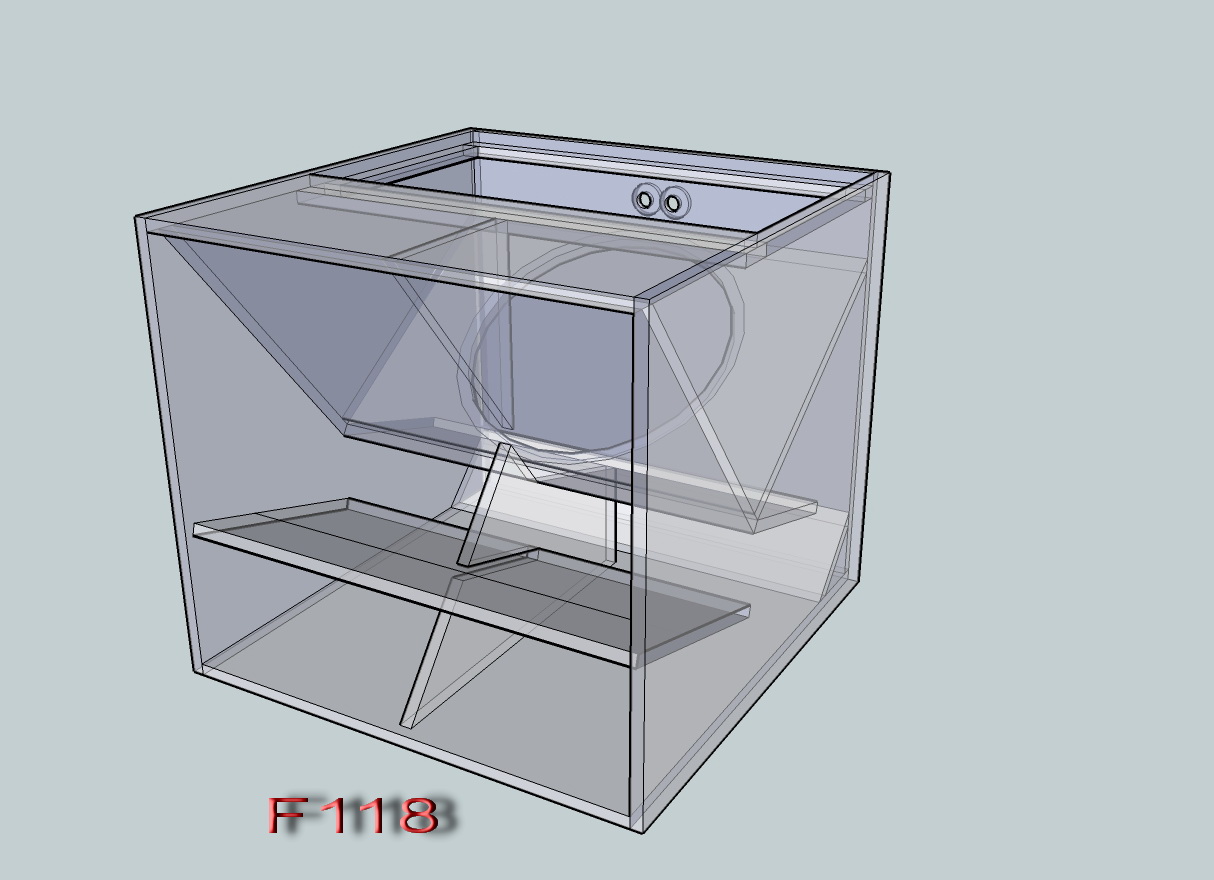

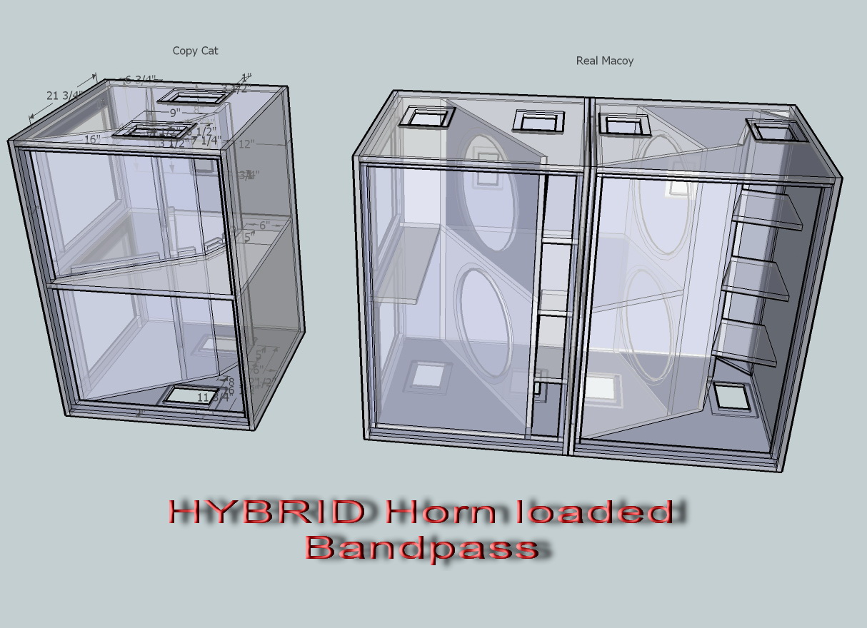

USB are originally copied from Turbosound which was designed by the Research and Development department called " Funktion One" under Tony Andrews...this design was way back 90's. It is a bandpass hybrid...a bandpass with a short horn, thus, making it hybrid.
today there is a lot of these modeled for a specific driver one of these is "USB" whilst at TurboSound its "TSW-XXX", and Funktion One its "F118 or F218".
here in the Philippines there is "Lexus" it is the same configuration.
USB are so very easy to build...DIY friendly. Bandpass are one note...be aware in crossing and hi-passing.
As for the Line Array project...its good using the DRPA...time alignment of the Hi driver to the 12's for comb filter issue...a little filtering for the bumps and spikes...overall performance OK...SPL they will compete...Robust? i dont know...what would you expect from a cheap driver?
My line array project was patterned from L-Acoustic...this are the guys who first introduce line array system to be use for Pro Apps...but line array was an old technol0gy for audiophiles...nothing to be exited...in the line array business its the Mid and Hi drivers battle for supremacy...not the box...its just another ordinary bass reflex cab.
Line array is all about directivity...the more stack you have...the more forward SPL you will gain...the more forward gain for have the narrower the pattern will be...side to side spills will be lessen...and now you need to put some fills...side fills and center fills...now we have a problem...INTERFERENCE!!!

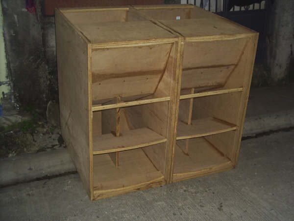

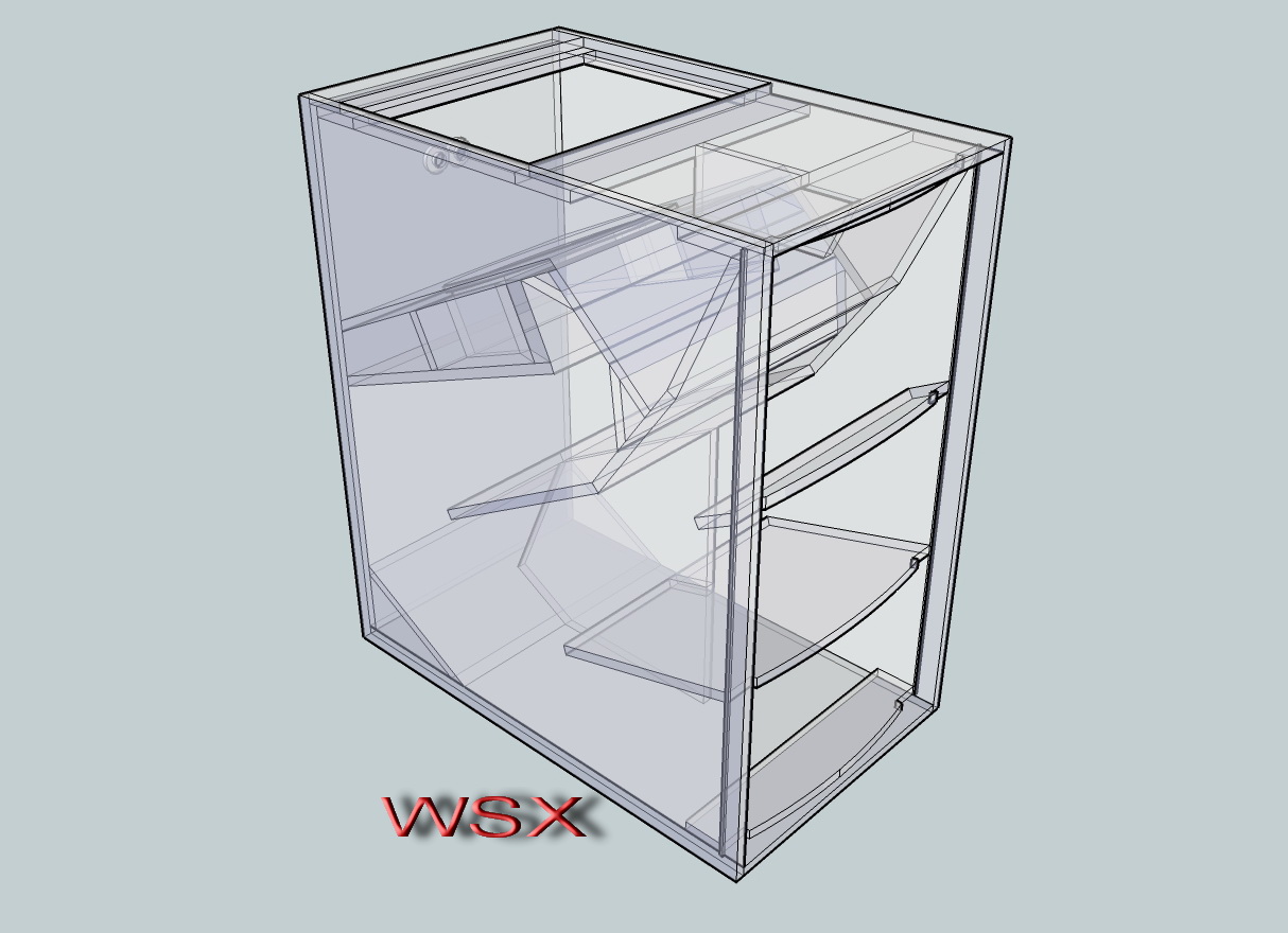

@leinad61

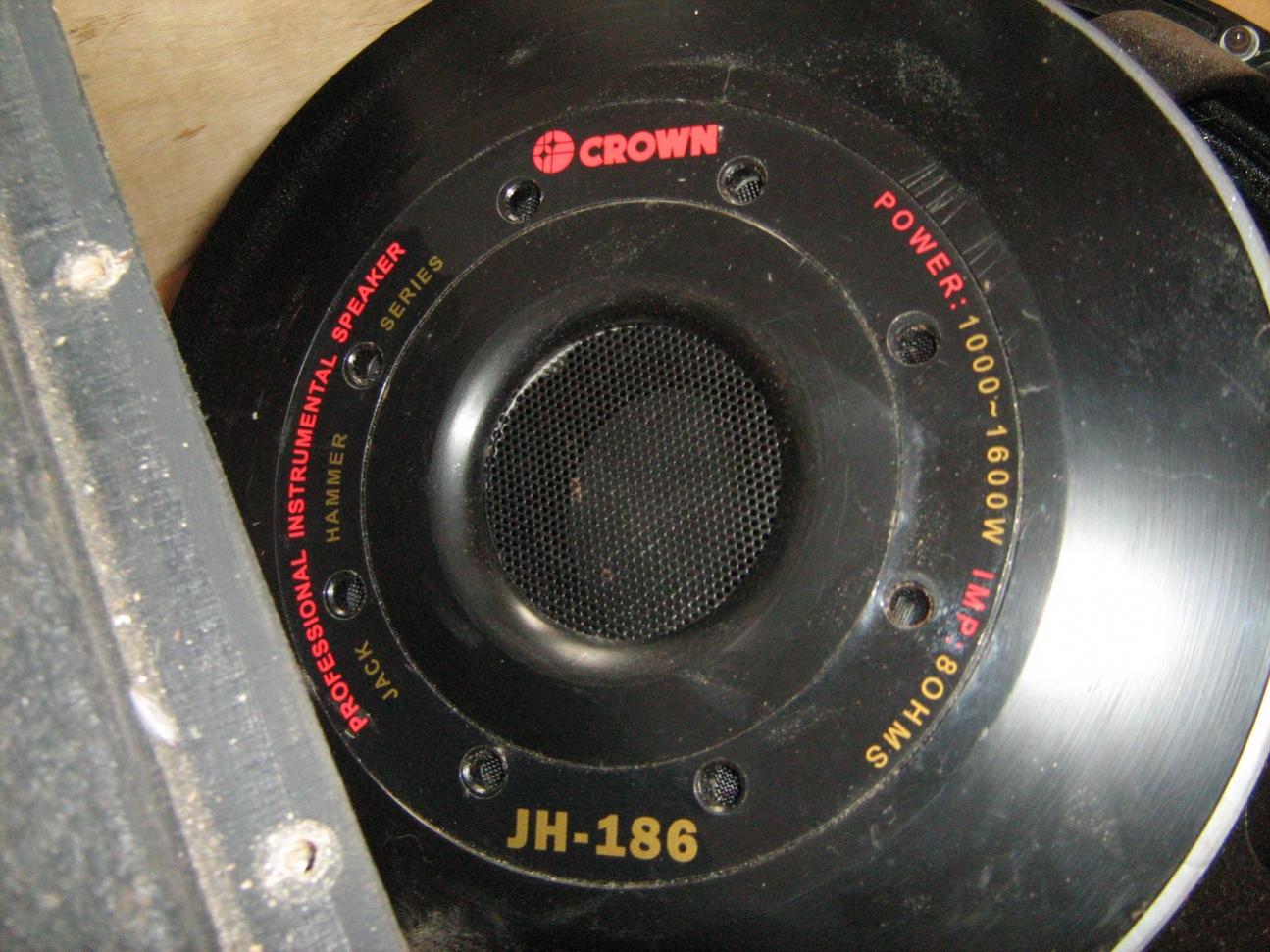

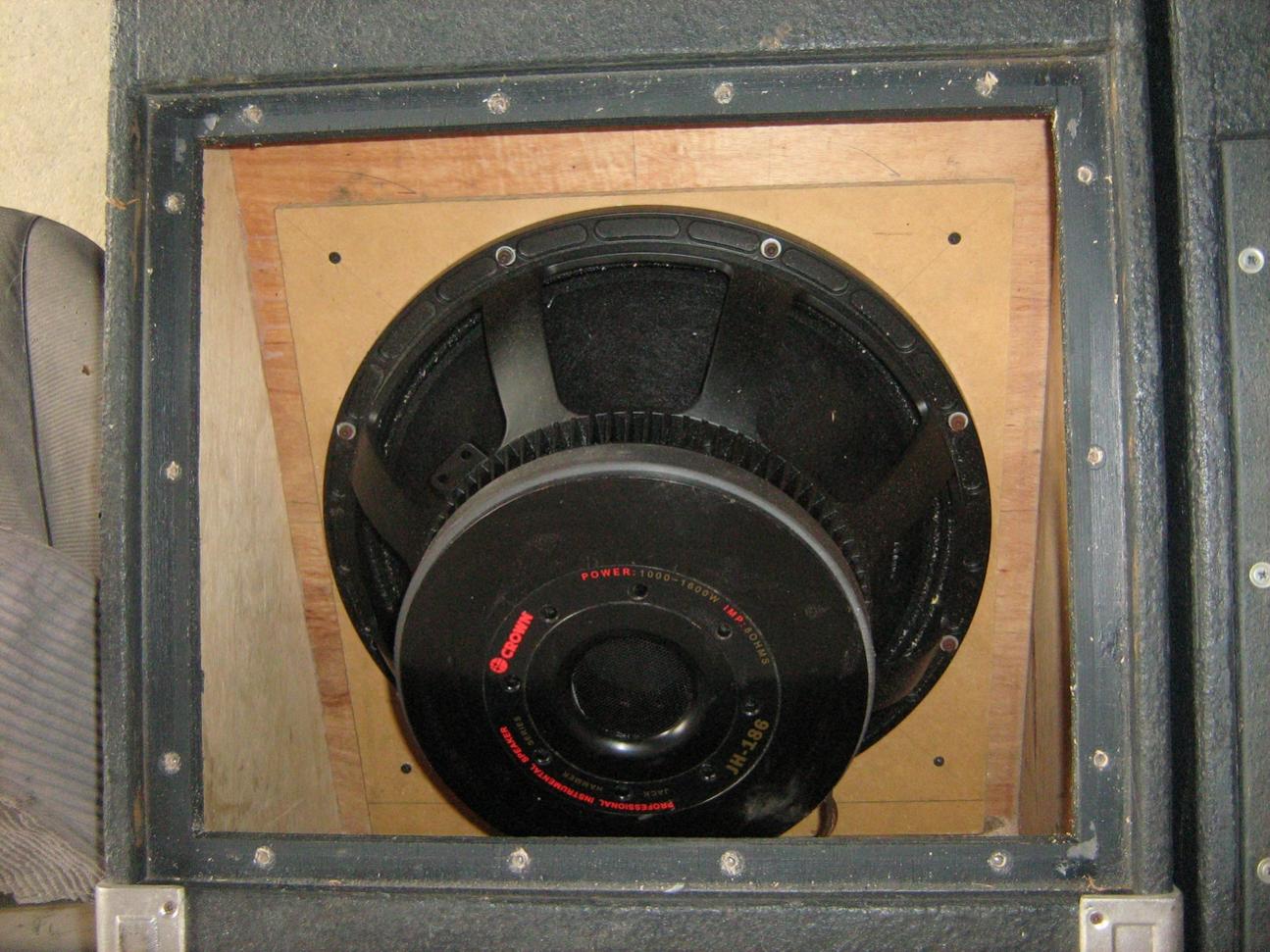

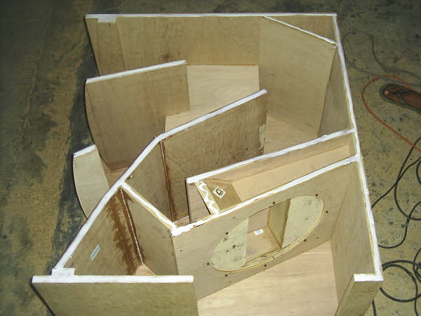

WSX is one of the best 1/4 wavelength horn loaded sub-woofer by Martin Audio to be fitted by RCF L300p.
Putting different kinds of driver is like letting a dress fitted for Maria to be wear by different kind of people...obviously they will all look differently and will never be the same as for Maria's look.
WSX is the dress...putting different kind of drivers (the people) they will sound differently and will never be the same as for RCF L300p's response.
as for us we just have to settle with JH189 response and the Pro PA 1860 response...the difference of the two is sensitivity and power compression.

WSX box
i have seen some WSX boxes being fabricated and being fitted w/ the Crown 18"ers, wonder if the PD1850 driver or the Fane colossus 18XB driver will wok on these boxes.. anyone tried modeling it in their respective softwares? Are local 18" drivers suitable to be placed inside a horn-loaded cabinet?
TIA for any comments..
