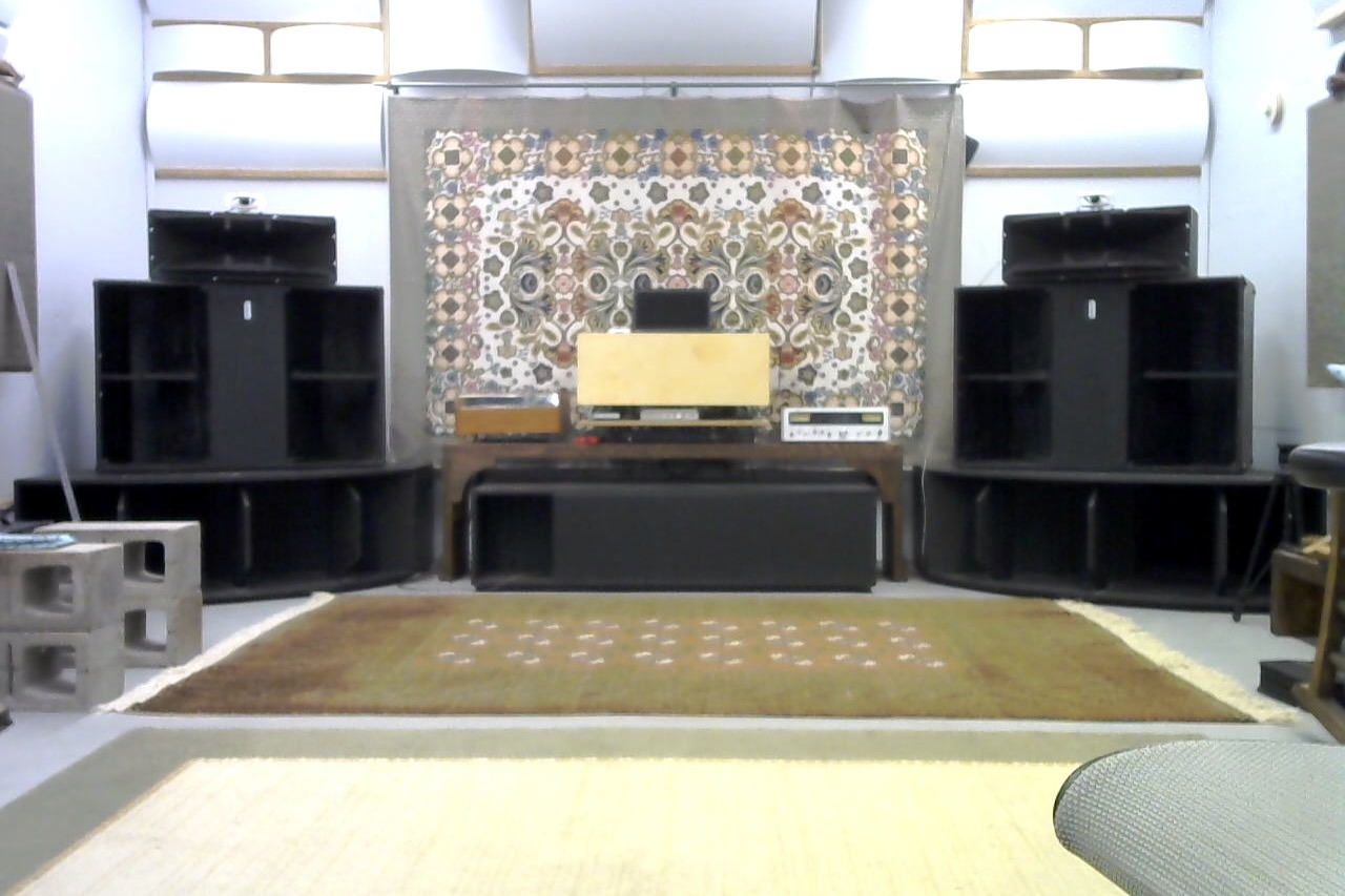

I'm also coming from the Kipsch forum, same username. I don't frequent it that often and found that the technical/restoration forum had been really lacklustre in the past couple of months only to find the reasons in this thread. Yeesh. Immediately signed up here 🙂
@claudej12000 has guided me in building an all horn, 3 way active + 2 LAB-12 tapped horn sub system which brings me much joy and tweaking possibilities. System as follows: QPie with Kappa 15C, SM120A Mid horn with A55G, SMAHL V2 with DE120. Driven by an Ashly NE8250 8 channel amp with Protea DSP, which was absolutely lambasted at ASR but which sounds just fine to me.
I've applied @Cask05 's advice for corner placement and room treatment. Also tried my best with the "Dialing in a DSP Crossover" tutorial. Wonder if he ever released the second part?
I also believe a horn forum here would be very helpful and serve a subset of mad-scientist type diyAudiophile. Anything I can do to help this become a reality?

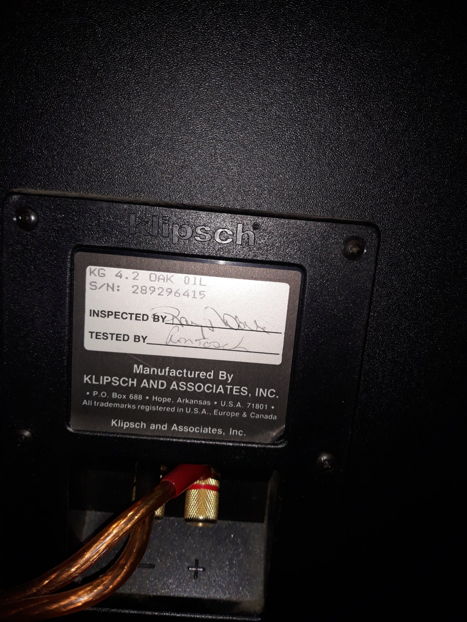

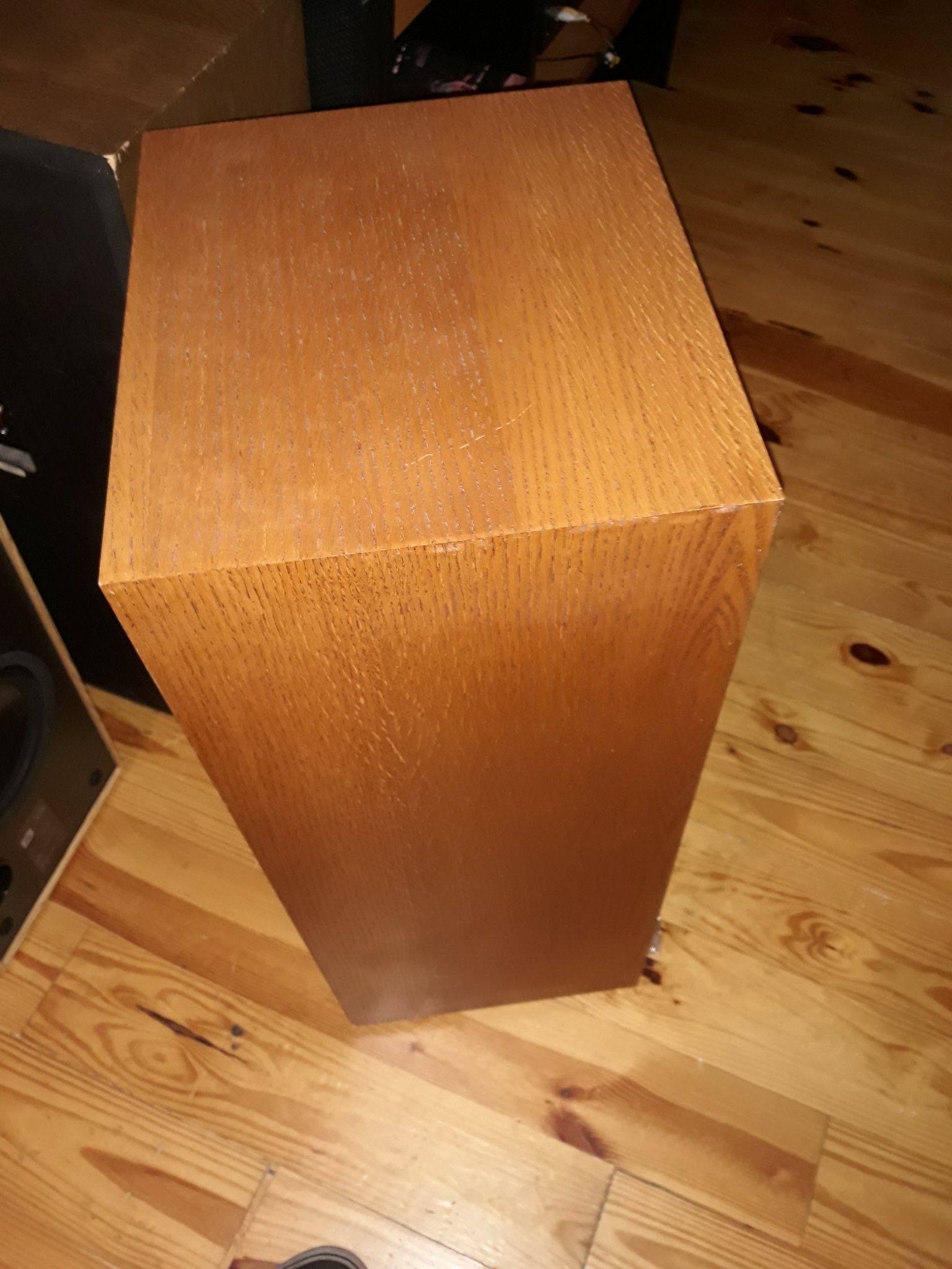

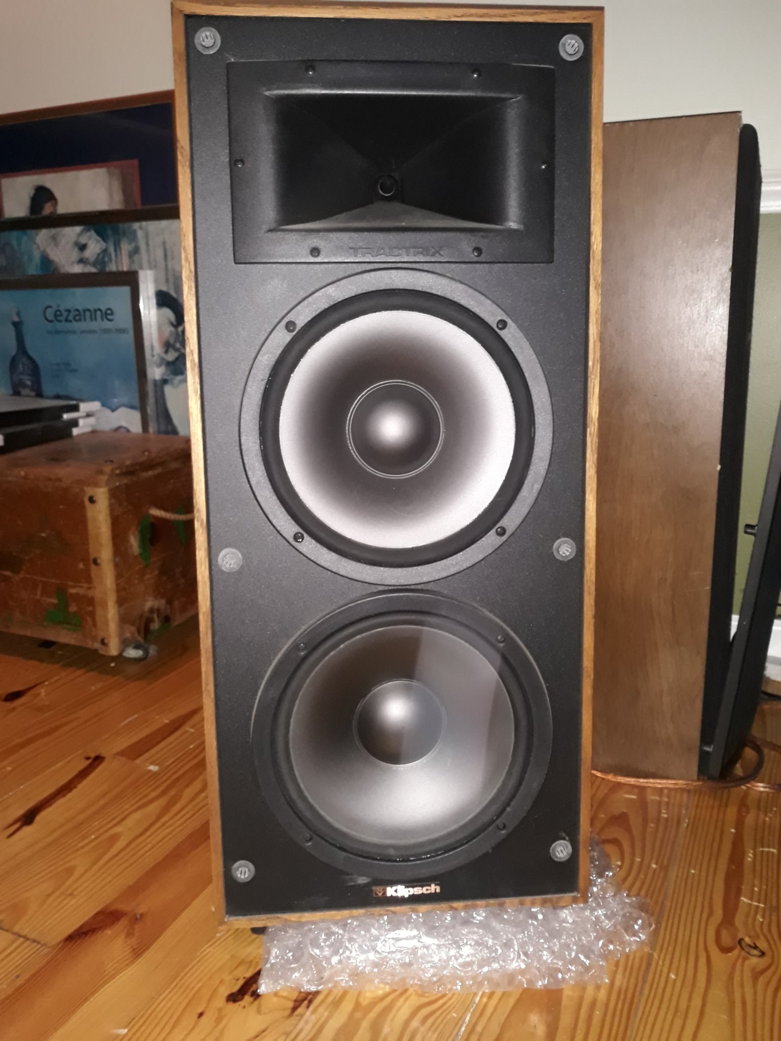

Holy cow, Ray, that is beautifully imposing! I would love to hear your system. I just got a pair of KG 4.2 speakers given to me by a sax player friend. I still remember when he bought them brand new with a Sherwood integrated amp! I went to his house for dinner, and brought these home. I could bring the Chorus ll pair down from my master bedroom and use these as rear channels. I'll recap, brace, and dampen the boxes, but they aren't bad for rock with 15 subs. Glenn.

On the KG 4.2, what are the favorite woofer replacements? Simply Speakers has a recommended MW 5010 4 ohm with stamped steel basket, and PE has a Delmar series Goldwood gw-10pc-4 with cast aluminum basket.
The GW is on sale for $55 , while the MW is $100. I was also looking at the Faitalpro 10FE200. Thoughts, opinions, ideas? I'll also be recapping and possibly swapping out to Ti diaphragms on the horn driver. Thanks, Glenn.

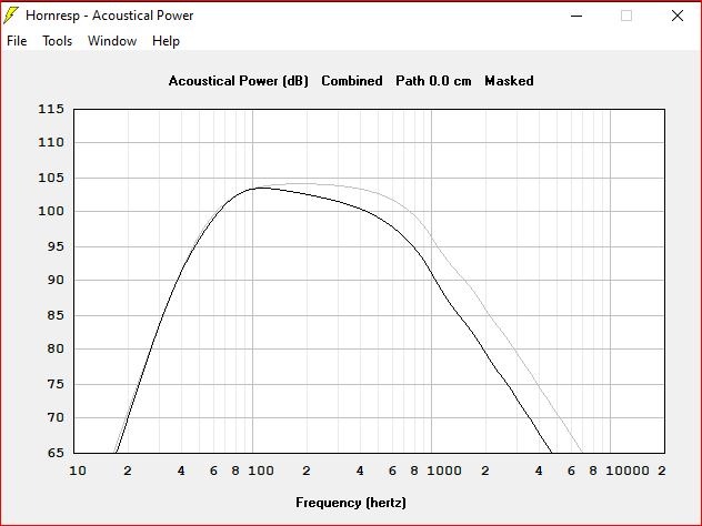

Here's the simulation for both in H1 ported to Super. I originally wanted better Midrange, knowing the higher BL woofer (DeltaPRO) would favor that end and I would lose too much bass to get it so I had to port to get the bass back.
So if you look at the black curve, it's bass is fine but it lacks midrange because of the higher cone mass. So you can partially try to compensate by shorting out the 2.5 mH woofer inductor in an E network (in addition, also removing the woofer Capacitor if you have an E2 network). This should bring up the midrange to a closer match for the Delta Pro 12a (K-42 equivalent).
If listening instead of measuring, you should put them side by side and use a Mono Signal to feed R and L channels. You can then use a Balance control on your pre amp if you have one. If not, then you will just have to plug and unplug the speaker in the same Amp channel (I use an AB switch but it's not necesary if you have help (one swaps, one listens).

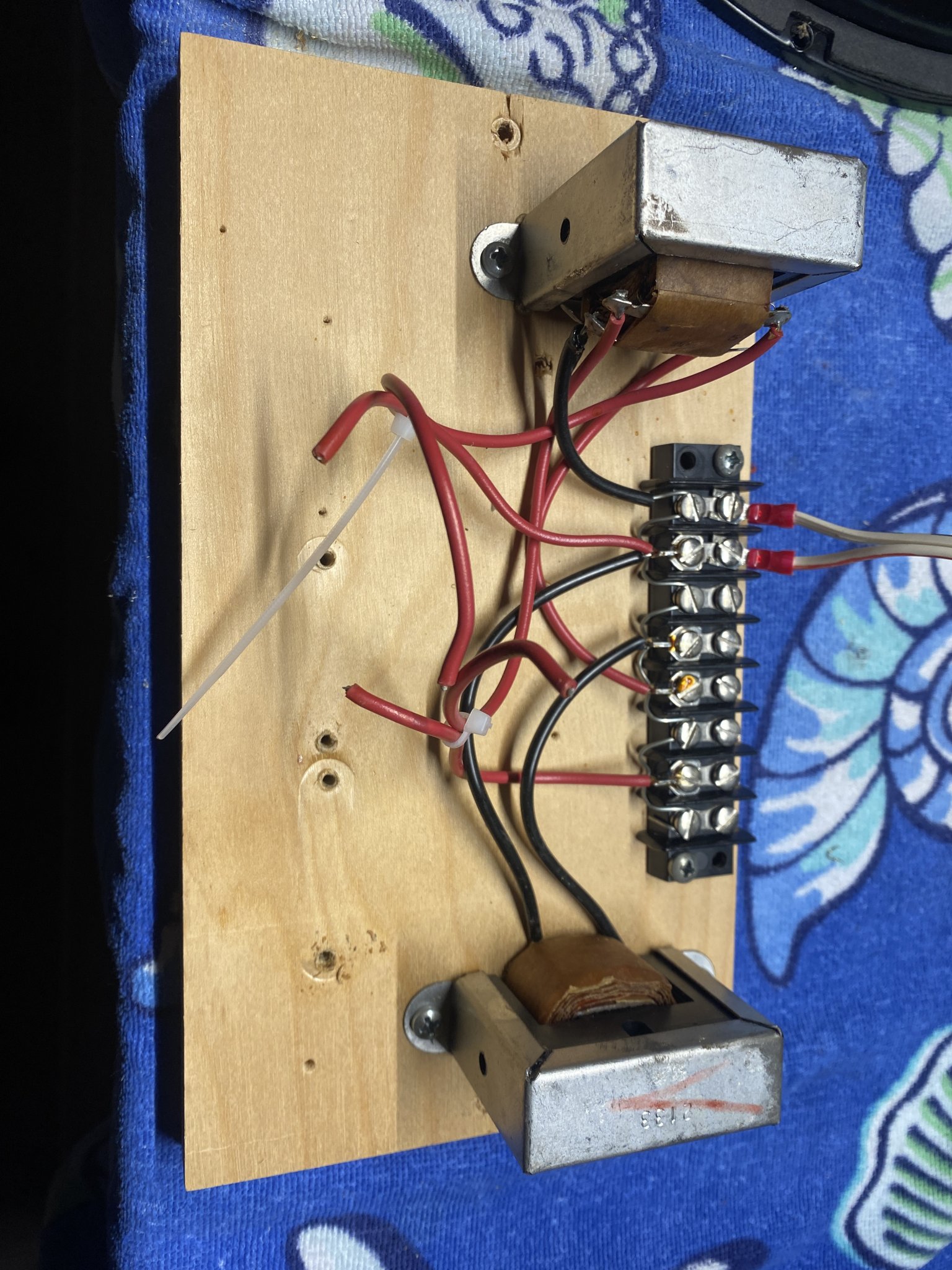

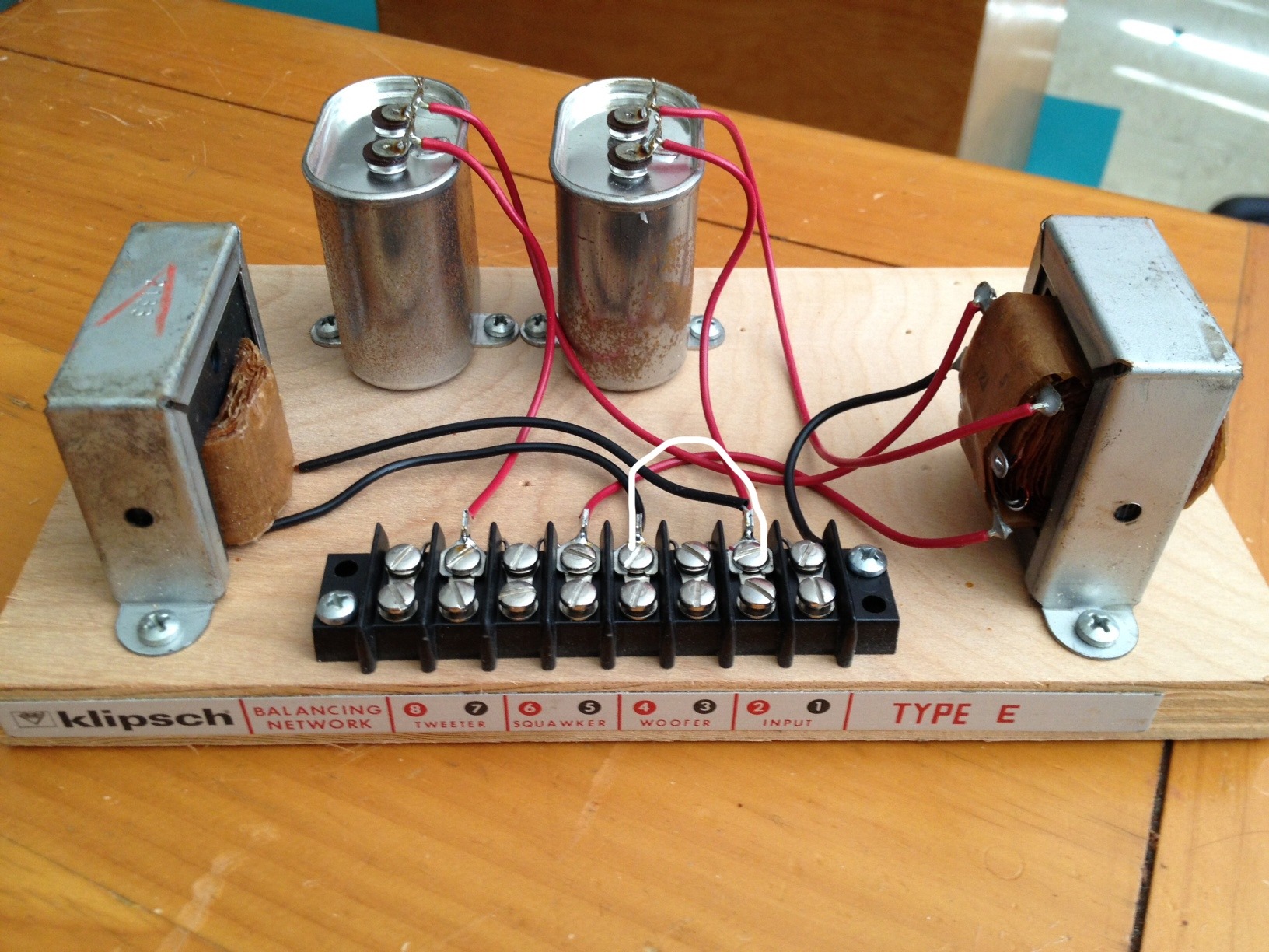

Perfect. I do have the E network. I will try and bypass the 2.5mh inductor.
Is that as simple as me adding a small wire here (shown in white). Just bypassing it this way.

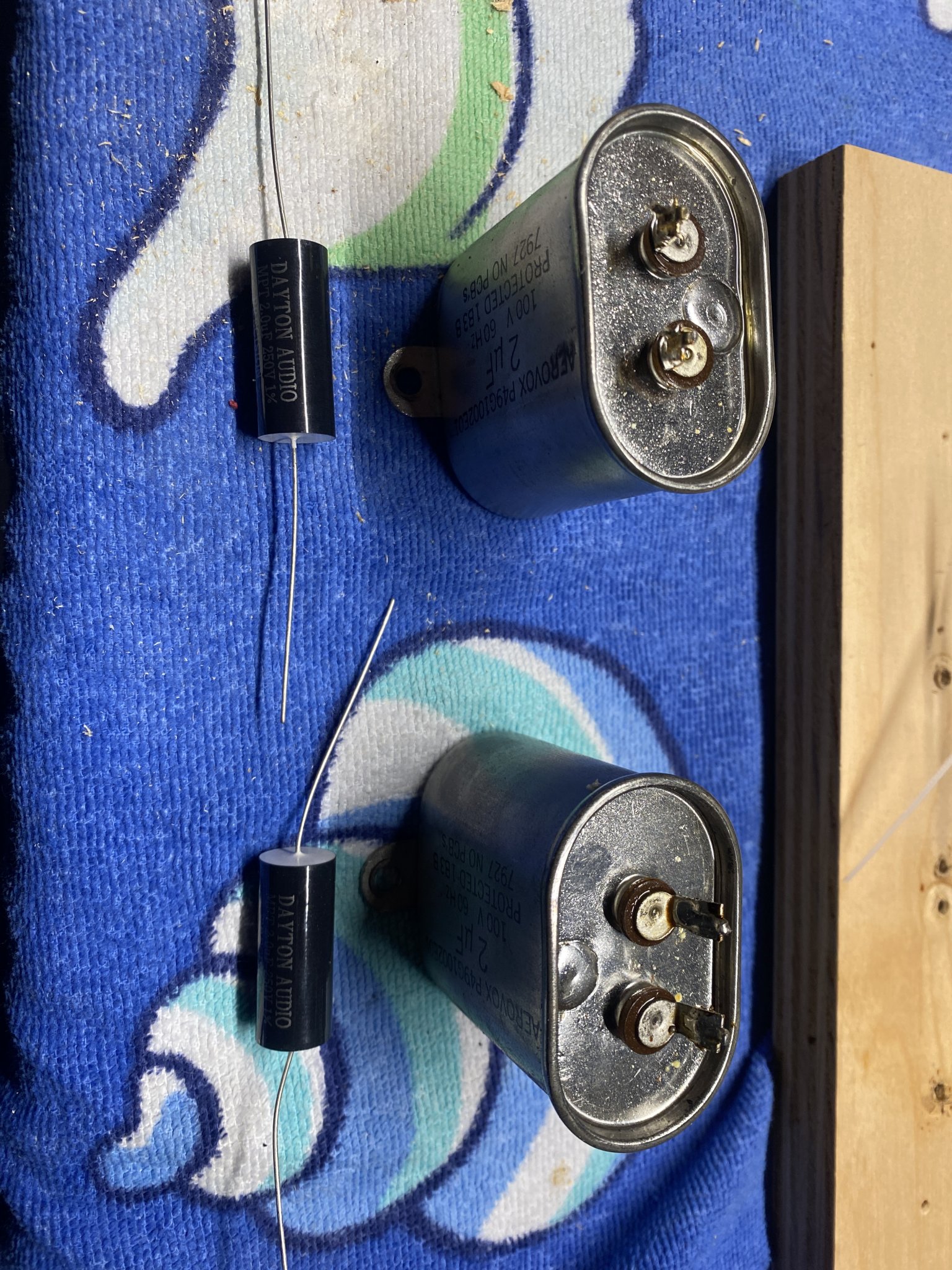

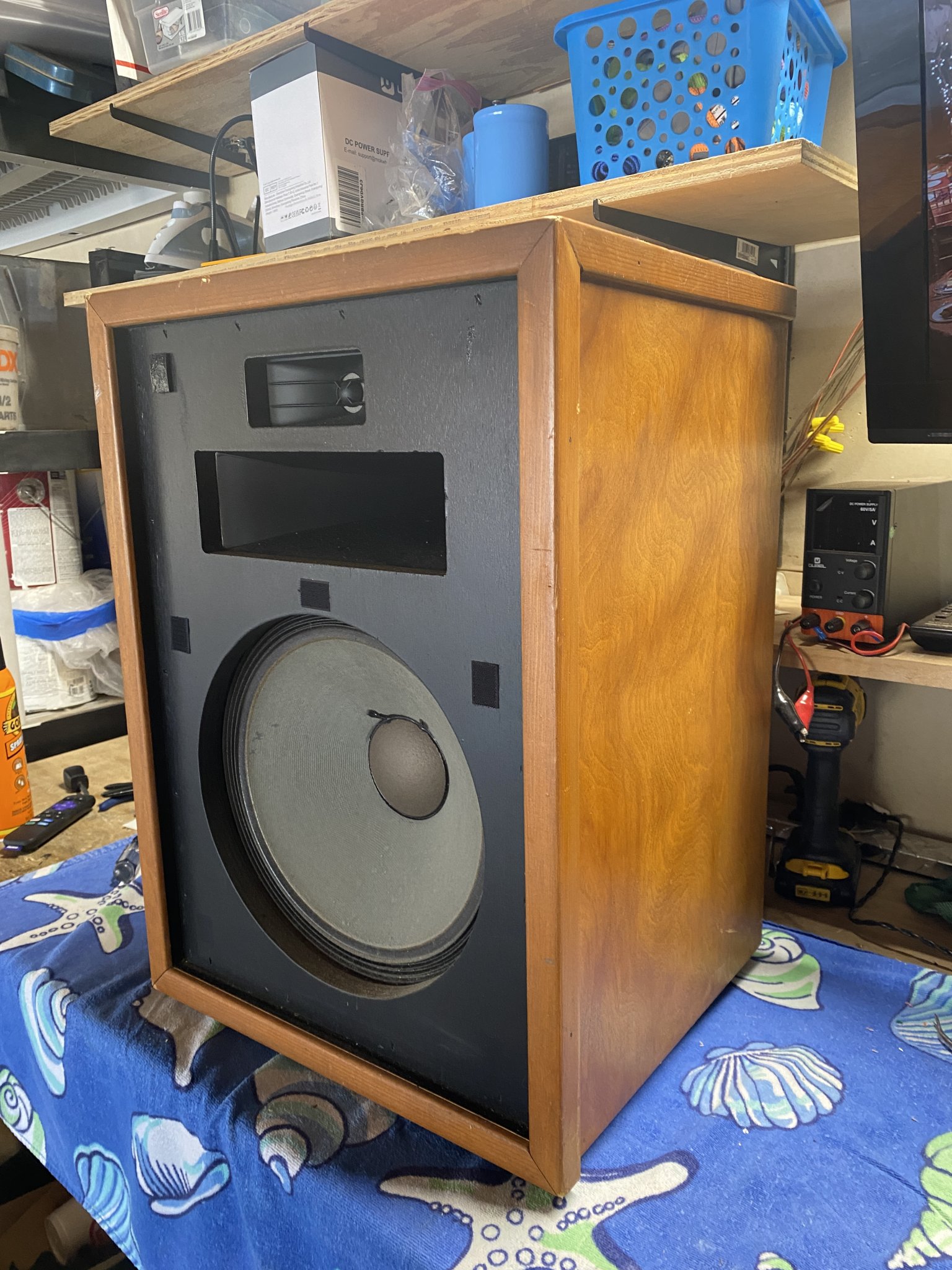

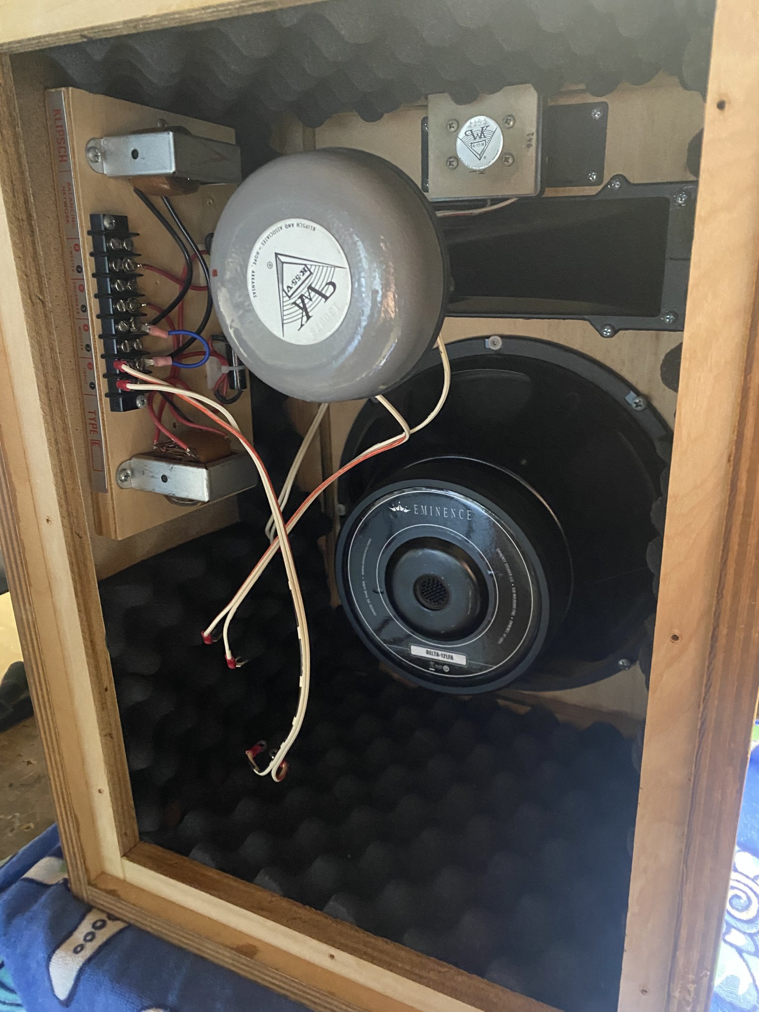

Quick update on the Heresy’s with the 12LFA’s. Because I have the 2 pairs I decided to complete the mods on one pair before restore while the other pair gets new walnut veneer and cane grills.
On the first pair with 12LFAs:
I recapped the E networks and left the values the same but added a jumper wire to bypass the inductor. Port added with the egg crate foam.
Upon first listen I noticed right away a popping/flapping noise when there is heavy bass or the volume is turned up… I vaguely remember Dave mention having to sand the inside of his woofer cut out to avoid the foam hitting the side. I inspected it and sure enough I could see where it was hitting. I am going to install a 1/2 inch wooden trim. Hoping that is enough to raise them.
12" Subwoofer Speaker Spacer Depth Extender Extending Ring - 1/2" thick - ID: 11 1/8" OD: 12 7/8" - 1 Pair - SSK12K - Stackable - Perfect For Framing Fiberglass Enclosures https://a.co/d/fnt8ZVd
Listening at low level I feel there is a good balance but I’d like to allow the caps to burn in and add that trim piece so I can really listen and see how the two compare with and without the inductor bypassed.

That was on a Heresy 1 with a K-42 woofer for me and this was in a Super Heresy build. I had to bevel the inside of the woofer cutout so it would not hit. That was with a cloth surround on the woofer. Same issue with my K-43 woofer on my Super MWM set and I am now a firm believer in a spacer ring for them all if I am going to push the excursion.
Never tried the 12LFA's but I have tried the Kappa 12A's in a double woofer bass bin and they are really good there.
Got it! Thanks Dave. I think the 1/2 inch spacer will solve my problem.
I will get your tweeters and the spacers on Tuesdays and install at the same time.
My other pair will have the Delta Pro 12a’s with the correct crossover mods. I can then compare and learn how to run some sweeps on my minidsp to see the differences.

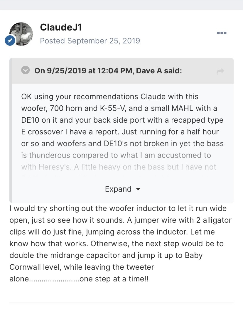

You are on the right track. You may want to end up with a 1.2 mH inductor instead of the 2.5 that you short out. Meanwhile, I'll model the LFA to see what happens with that "tweak" to a woofer I did not recommend, but may still work our for you after the mechanical tweaks are done with the spacers.
Does the gauge (AWG) matter?
Yes it does. But as long as the DCR is 5% or less of the driver impedance, it's not a big deal. However, to eliminate Hysteresis, I chose the 14 AWG for my Midbass Horns with 8 ohm drivers. DCR went from 0,1 to 0,3, which is tolerable, since mine is horn loaded. YMMV. Try the cheaper one first, like I did, and I'm still not sure my overkill use of air core is audible or simply technically "convinced by reading."
Ok. After looking at all my options it looks like the two 14awg options from Dayton or Erse fit the DCR of 5% or less. The smaller gauge options have higher DCRs out of your recommended range. I am going to go ahead and buy a pair of the below.

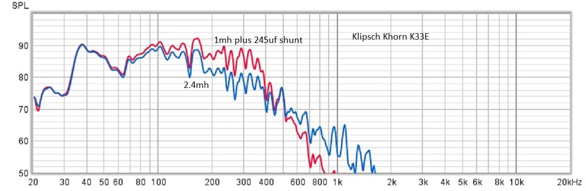

I've been experimenting with a low pass woofer filter on my Khorns and have been wondering if such a filter would benefit my Heresy I's. It's a severely underdamped filter consisting of a series 1mh inductor and 245uf capacitance across the driver. The increase in voltage really flattens the response up to 400hz vs a 2.4mh series inductor.
Thanks, Mike

I think if you stick with vanilla E networks with all Dayton capacitors at 2 uF for mid and tweet, to start, you will be able to do better incremental mods. Just change ONLY ONE thing at a time! Here's the simulated curves of the Delta Pro 12a vs the LF you have. Also try lowering the tap while keeping the 2 uF cap as an experiment. Let you fave music be your guide. Saxes, piano, female vocals, etc. should be part of the experiments. Look at the curves to see how much high end of the woofer your are trying to trade for bass with the heavier cone.
