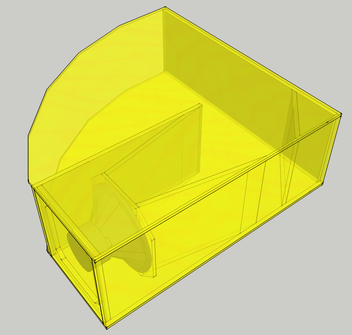

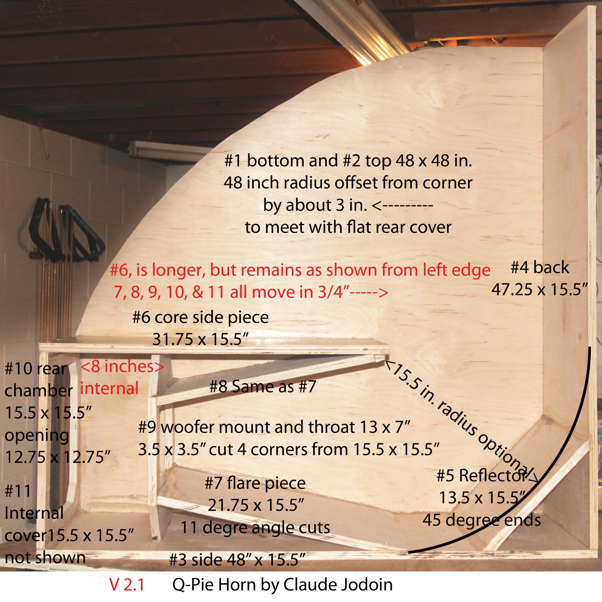

Great news, Lee. I've been a fan of Chris's MEH horn from many moons ago on the Klipsch Forum, so looking forward to your build post. I will post the photo of my v2.2 version of my Quarter Pie horn here. I will also add the "bigga mo betta" version I call the Super Quarter Pie Bass Horn. Both fit neatly into corners, but don't require them to work. Also both can be stood up vertically, as they are 4 ft. and 5 ft. tall, respectively, if done that way instead of laying down (the preferred way). The reason for the name is it looks just like a pumpkin pie cut in Quarters from above!!
Here's a photo with the top missing. All 15 3/4 inch RIP cuts from 4x8 Sheets of Plywood or MDF with 48x48" tops and bottoms (bottom shown). The horn is reasonably flat from 50-500 Hz. and a very easy build. I ran mine with a 6 watt chip amp until I moved to a bigger house! It's about 105 db/watt, so you will likely only need 1/4 watt at normal listening levels. I'll post a drawing of the Super version when it's done. Right now it's just a crude sketch.

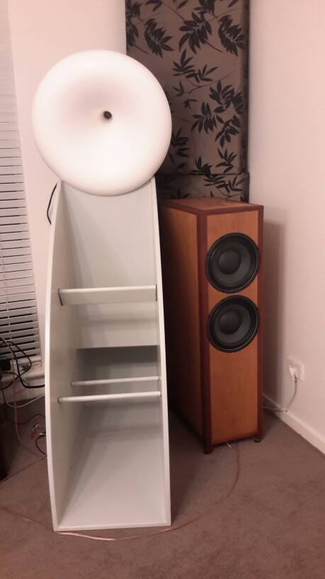

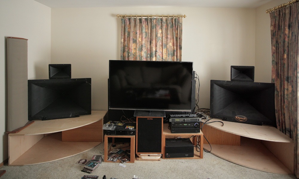

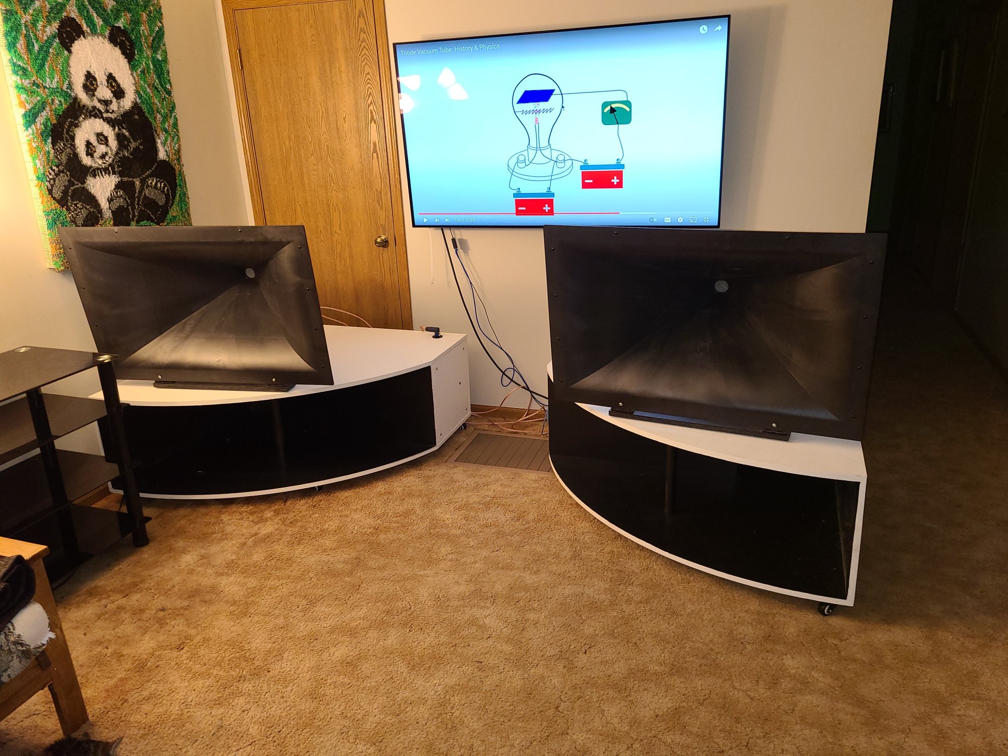

Here are some installs from around the world from people who built them and like them very much.
@claudej12000 , have you ever considered orienting the QP such that the driver is near the ceiling, pointing down, the horn opening downward in the room corner, terminating in a mouth that fans-out horizontally at the floor? You could get nearly 8' horn length that way.I will post the photo of my v2.2 version of my Quarter Pie horn here.
Yep considered it, and sketched up a design. I rotated the core section about it's axis to fir in the corner without any dead air space there. The 90 degree reflector got a little tricky, but it would work for sure. I tried to keep things as simple as possible, construction wise, with the Q's.
