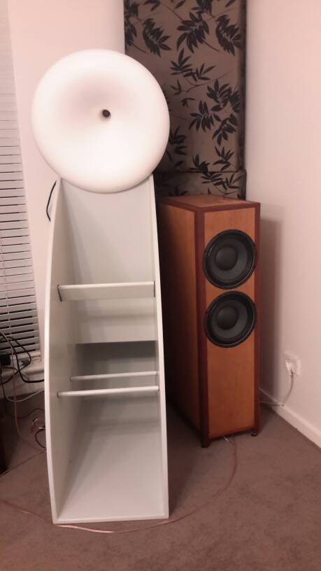

Has anyone ever tried building the quarter pie with a hinged mouth?
I’ve thought of using it standing as in the picture and wondered if I was using it that way if there was any benefit to being able to open the mouth up?

I see no point in doing that? Just curious as to why? The mouth is pretty big now. I have designed a Super Quarter Pie that goes lower and has larger mouth with the same basic Easy built with more lumber.@claude

My first thought was that placing any Mid/HF horn on top of a 4 foot standing quarter pie was a bit high for my room and seating.Just curious as to why?
I was looking for a way to possibly mount a horn a bit lower and partially in the mouth of the quarter pie.
I didn’t know what effect opening the mouth might have on its performance.
Lots of effect from opening the mouth. But not so much near the woofer door. There you could mount a small horn in that part of the mouth, with the current design, when it's standing up with very little effect on the response. Even if the horn blocked the last 12-15" or so, it would have little effect, so you have the right idea with little compromise.I didn’t know what effect opening the mouth might have on its performance.

having your mid horn centred on your seated ear level would be a good thing as your horn will be most accurate on axis.My first thought was that placing any Mid/HF horn on top of a 4 foot standing quarter pie was a bit high for my room and seating.

you should place the pie horn up against the wall and your tower where the pie is now that will give you all the reinforcement that you will need and you will have fewer side wall reflections to listen to that will be a win win situation.@claude
