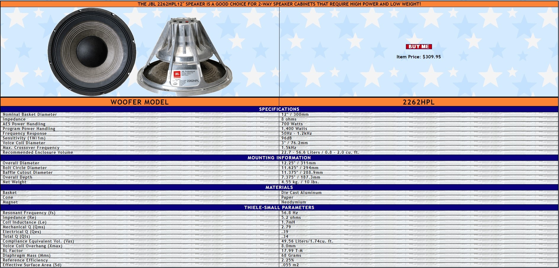

Hi Claude,
I have a pair of Heresy II's that I want to mod to supers. The recommended Eminence woofers' outer diameter is a little too big to fit in the countersunk hole and the midrange horn's flange.
I found a pair of these JBL's open box for a reasonable price. Will they work for this design relative to spec's. The Vas is lower and the BL is higher than the Kappalite. Sensitivity is 96 vs 100.5
I also posted over on the Klipsch forum, I wasn't sure if you still frequented there.
That's a NO. The mod is for a Heresy 1. I don't intend to do further R&D on this (10 years ago with hundreds of happy modders). Get someone with wood working skills and route out a slightly bigger hole if you insist on a II, which is a different animal, just because it has 4 legs........you know the rest.

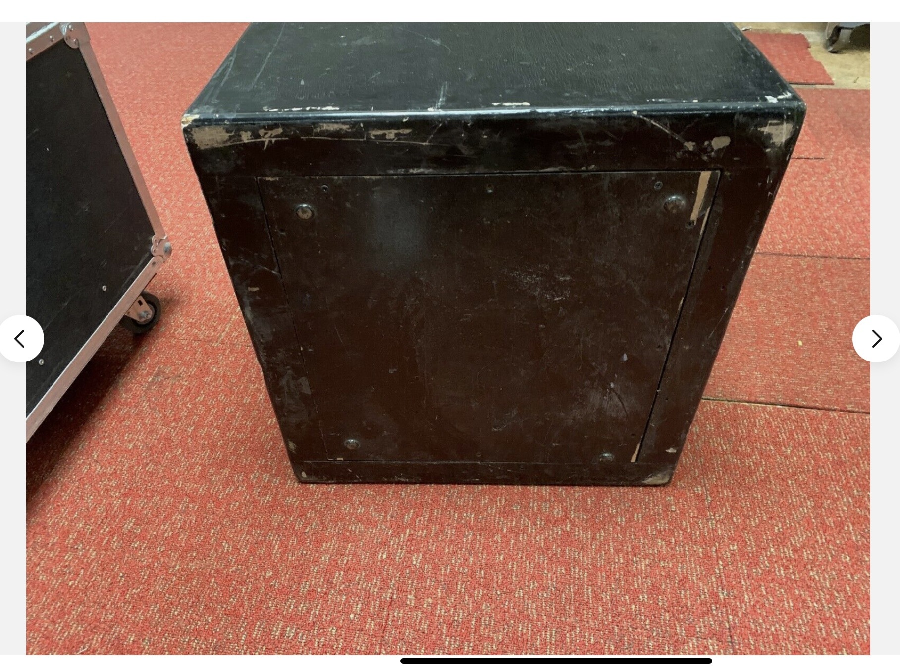

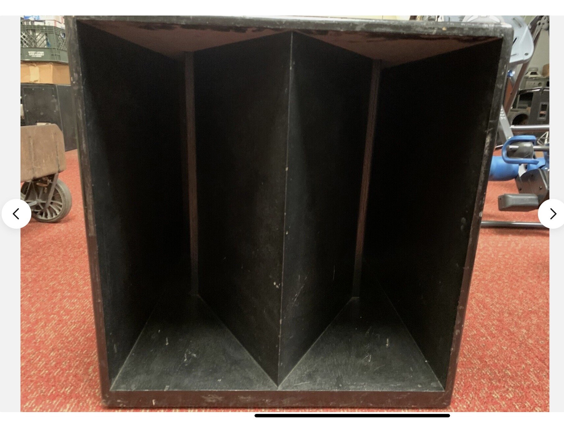

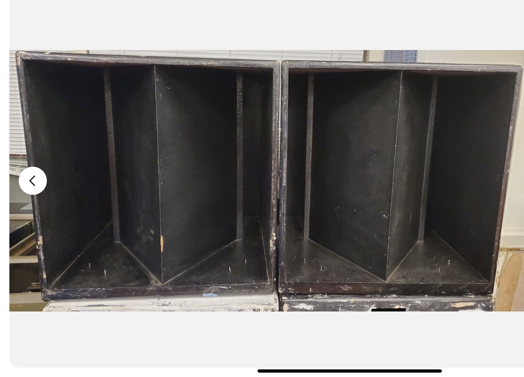

Hi claude and klipscheads
Well it seems I’ve joined the ranks.
I’m not sure I can be considered a “Klipschead”…maybe more of a “Klipschbumm”…I pulled the trigger on a pair of Industrial LaScala bass bins that came up cheap on fee-bay.
I’ve gotta go pick them up tomorrow about 2 hours away.
Crossing my fingers there’s no serious issues with them. There were no internal pics and I did notice some screws driven up through the mouth that look to be holding the dog house cover on the bottom. I hope there’s nothing ugly like stripped holes in the motor board.
They look pretty solid in the listing pics. Mostly scuffing, scratching and chips in the paint. Maybe a few chewed up corners.
If they work out for me I’ll figure out a way to make them prettier for home use.
The seller doesn’t know a lot about them. He got them in a purchase of a larger group of items.
He had K-43 drivers as well that were pulled…two pairs for sale. I wasn’t sure of their condition and said I’d like to look at them when I pick these up. The K-43 listing’s disappeared…not sure if he sold them or is waiting to see if I take them.
I have a pair if reconed Electrovoice EVM15B I can try in them that I originally bought to build either a conical mid bass or Quarter Pie…which I just couldn’t find the time for.
If that doesn’t work well I can always look into the Eminence Kappas, Crites etc.
The idea is to finally get a bass horn up and working in my new house that I can try various “heads” on.
I’ve got a few I’ve hoarded over the last several years including some 511B, Edgar 350Hz round wood Tractrix, Oris 200 some custom conicals and some big B-52 horns I picked up on clearance at Parts express.
I’m not sure what drivers will work best I’ve got some Dukane 5A540, Radian760pbneo, Dynavox D54 and even some BMS 4590 coaxials. Plenty of high efficiency wide bands as well. A two way may be the easiest way to start.
The LaScala bass bins will be driven by Hypex FA502 amps which will hopefully allow me the flexibility to adjust things well enough to meet up with what’s on top.
I have a pair of the hypex, so they’ll even be the flexibility of a second channel on each bin if I decide to go three or four way and add a mid-bass.
Already thinking about the ported reflex base modification tothe LaScala for the possibility of some added bass extension.

Not sure what your expectations are but a LaScala is not a bass bin. They start to roll at about 140 Hz and in a multi way systen should be crossed at around 90 Hz. to a woofer. At 50 Hz. their response is about the same as a Heresy. Just so you know.
A number of us have done variations on the DJK ported LaScala, using the PRV Audio WG45-50 horn and their D2200PH driver and assorted tweeters and detailed the builds either here or at Audio Karma. A couple were top-ported and extend to 35-32Hz; I built a set with a 15” passive radiator in lieu of a port, that extends 23Hz - 20kHz -/+ 3dB: https://www.diyaudio.com/community/threads/lascalus-a-horn-loaded-lascala-chorus-hybrid.403921/Hi claude and klipscheads

In my opinion, they sound better than a Klipschorn and are a lot more flexible with positioning.
Hi Moray
I’ve no direct experience with the LaScala.
I didn’t mean to imply that these were meant to be a complete bass solution.
I’ve read enough about them to know they don’t go as low as quiet a few would like them to.
That’s why I mentioned the ported reflex modification for them. I can always try it to see if I can wring a little more out on the bottom end.
I’m hoping the Hypex amps will help in that area as well as the top end where I need the LaScala to hand off.
My experience with various front and back loaded horns and wide bands in the past was always focused on support below 150-300Hz.
I do have a Jamo subwoofer that has been a big help in the past below 75Hz.
P.S. Dave Ault's tweeters have also been on my radar for a while now.

With a pair of 4” x 7” ports, either below or in the upper horn enclosure, you can easily get to at least 35Hz; I don’t have any direct experience, but I’ve read that ports as long as 11” will enable even more extension, but it also sounds “boomy”.
My clones used Dayton Audio 15” passive radiators with no added weight and JBL 2226H woofers and a cabinet volume of around 9 cubic feet. It had simulated to 28Hz, but in actual practice, I got down to 23Hz. & I’ve sold my subwoofers except for a small one in my home theater setup.
A Heresy does not have a 7 db peak at 140 Hz.Not sure what your expectations are but a LaScala is not a bass bin. They start to roll at about 140 Hz and in a multi way systen should be crossed at around 90 Hz. to a woofer. At 50 Hz. their response is about the same as a Heresy. Just so you know.
The HORN portion of a LaScala cuts off at 104 Hz. the rest is a closed box in a really tight "corner" in the cabinet that gets further Augmented by a room corner. The Peavey FH-1 is a far flatter, better built, MIDbass Horn. They both need subwoofers below 80 Hz.

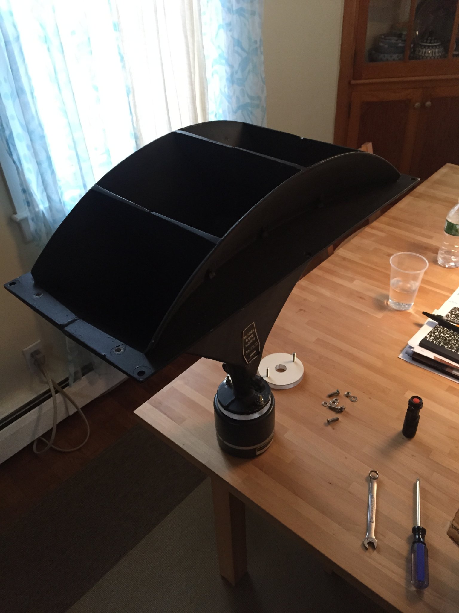

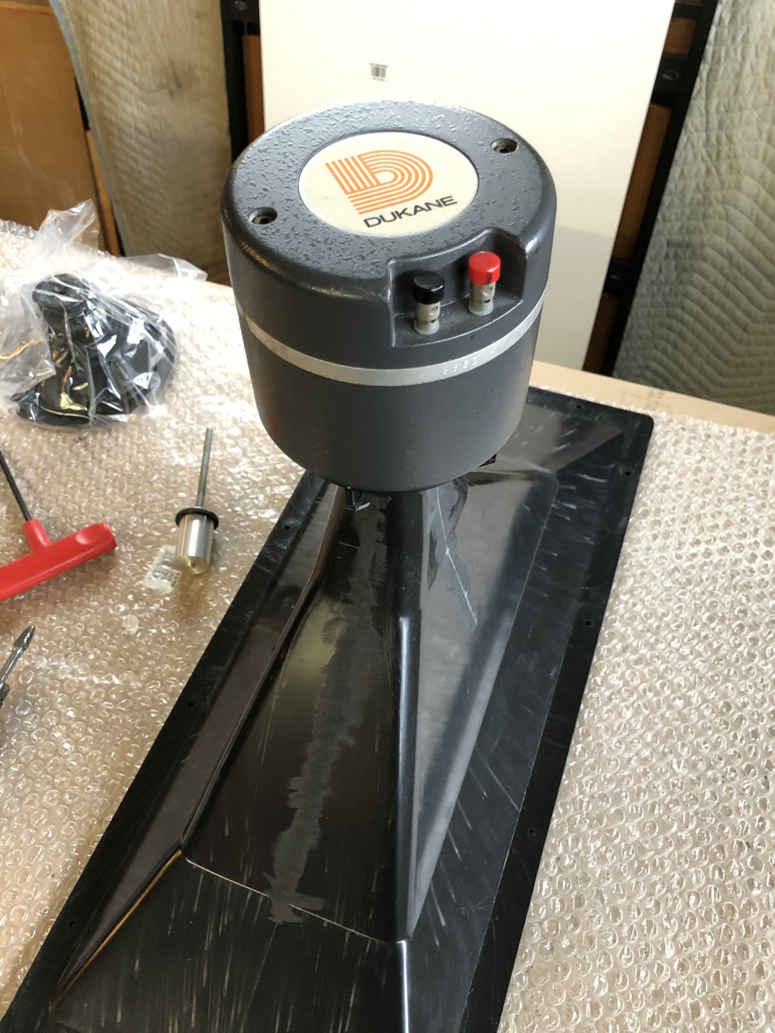

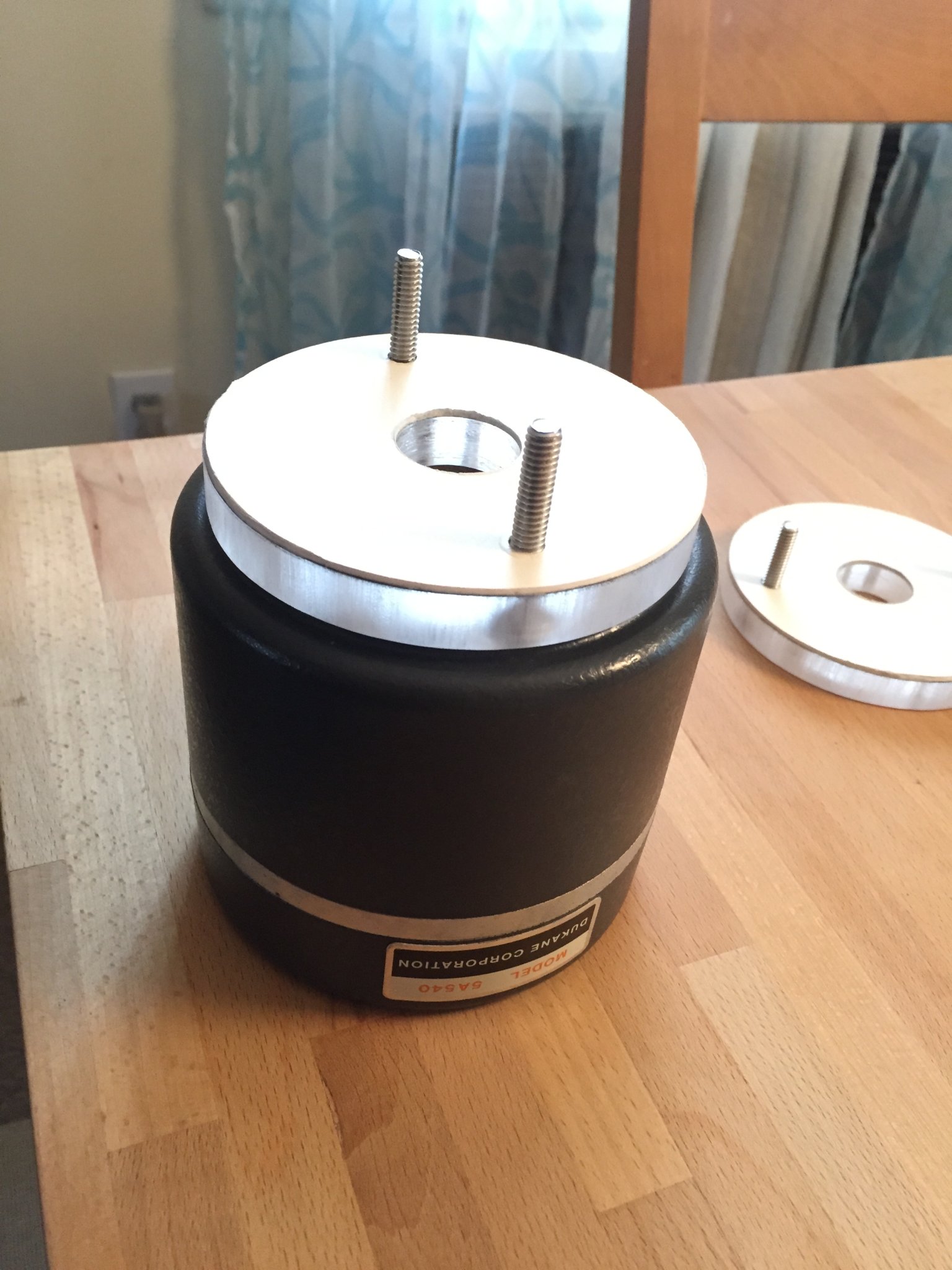

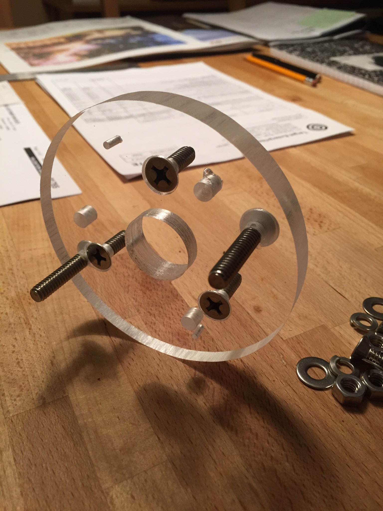

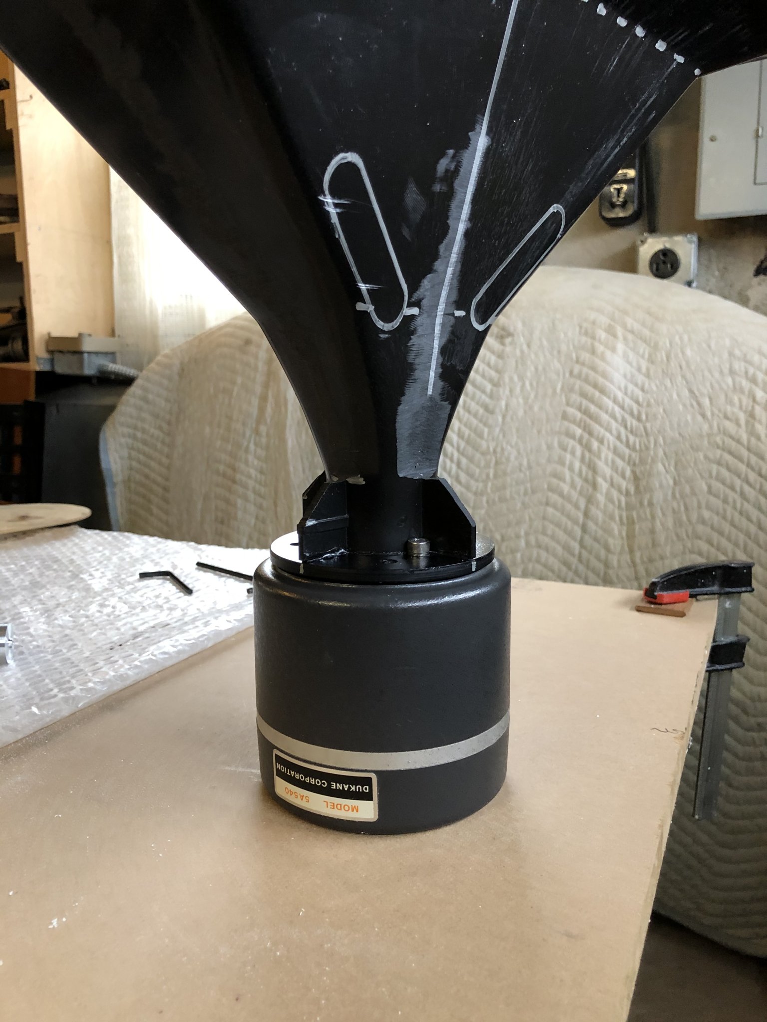

These are the buyout horns I got from Parts Express a few years back:
https://www.parts-express.com/TE-8180-1-Horn-22.5-x-10-1-3-8-18-TPI-299-2306?quantity=1
I was originally going to try and build a MEH from them…might still try. I modified them by removing the threaded throat and building my own flanges out of PVC so I could mount my Dukane 5A540.
Some test sweeps with my mic and REW showed a lot of potential…very good extension.
I also built adapters for my 511B horns, but haven’t taken any measurements yet.
I’ve been finding all kinds of threads with information…some also with missing content…but for the most part its out there and accessible.
Things went well today with the pickup.
The horns are very solid and in overall very good condition for their age (70s).
I don’t think it will take too much work to get them smooth and ready for some fresh paint or some other finish to pretty them up.
The seller also still had the 2 pair of K-43 drivers.
After looking them over and measuring them with my DMM it became apparent which drivers were in better condition and belonged together.
The pair I was interested in was cleaner overall and measured 3.4 and 3.5 Ohms. I suspect they might be recones.
The only real issue I found was one driver had a section of gasket that has partially delaminated. Not a big deal to fix with a replacement.
We talked about price. I decided to take them just so I could have a set in case I ever pursue a build that follows the original design more closely with a passive crossover.
