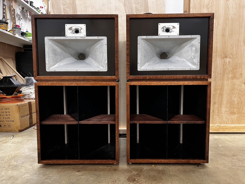

I have had a pair of LaScalas for almost 40 years but unfortunately they were in a storage unit for the last 20. I recently restored my barn and now finally have a room for them again.
They are black commercial speakers from the early '70s and came with AA crossovers. Over the last couple of months I have made quite a few changes and upgrades.
Shortly after I got them out of storage one of the original oil filled capacitors failed so the decision to replace the crossovers was effectively made for me, lol. I went with Universal crossovers from Crites.
I installed braces in the bass bins and used DynaMat on the squawker horn. I replaced the K-55 drivers with Crites A-55G/2 drivers. For the tweeters I'm using B&C DE120 drivers in Celestion's H1-9040P horns. I built frames for them and have them time-aligned with the squawkers. I also used DynaMat on the tweeter horns.
I have a pair of Fostex T90As that I had tried using as super-tweeters to add some sparkle to cymbals and such. I'm using 0.68 mfd ClarityCap CSA caps and fiddled around with a bit of resistance and was able to get the level where I wanted but I was never entirely happy with the results so that's when I decided to replace the tweeters. I'm currently using the Fostex tweeters as out-of-phase ambience tweeters, facing kind of back and out and up.
I decided that the way to really get the bass bins level matched with the rest of the system was to bi-amp. I have been bi-wired for ever, and split the Crites crossover as soon as I got it, so passive bi-amping couldn't have been easier. I'm not sure why it took me so long to get around to it! I've been using BRZHIFI Audio A80 300B monoblocks and the smallish OTs seem to like running this way.
My current project is to replace the woofers, which is probably where I should have started. I have finished one speaker so far. The old driver has a much bigger and heavier magnet assembly, presumably the Crites CW1526 woofers are using more modern materials. When I pulled the first woofer I found that it makes a strange huffing noise when shaken. That could explain why I was dissatisfied with the system, lol. It could sound fabulous at lower levels, and sounds much louder than it is if you know what I mean, but it would go from just right to too loud and blaring with just one notch too much volume.
All of these changes have fundamentally had the same effect: lower distortion and resonance. The speakers still sound like themselves, only better. The extra control that I've gotten from the adjustability that I now have has allowed me to really get the drivers in balance.

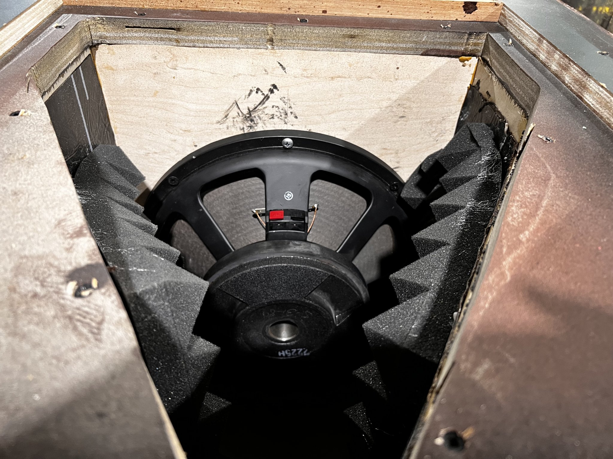

Hi everyone. I intend to post about everything that I have done to my LaScalas but I have an immediate question.
I am replacing the woofers and I have opened up the first speaker. I was surprised to see that there is no damping material in the doghouse. Shouldn't there be some?
If I am going to add some, does anyone have specific recommendations as to what, where and how much?
Thanks,
Pete

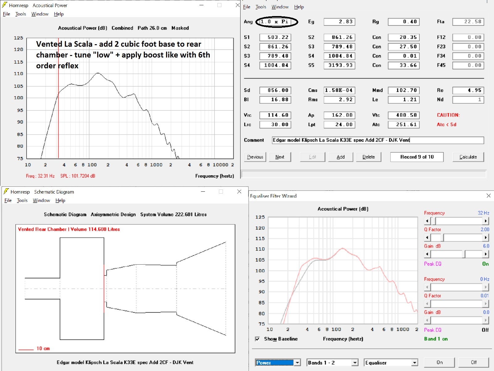

Several posts down DJK responds to this statement in quotes:
"Never use any damping in the dog box"
1 inch thick layer poly foam added to the inside of the doghouse and some measurements. The poly foam used is the same stuff that is in your couch bumm cushions. Below are results with a 2 foot by 2 foot sheet of 1 inch foam added to the legacy sealed cabinet. The notch at 200Hz is all but gone and the one at 575Hz is substantially reduced. And notice the new gain above 700Hz in the red circle.
Debate ensues…
The doghouses may or may not benefit from interior damping. I'm of the mind that it doesn't detract and since I was building my LS clones from scratch, I might as well add it. I lined the insides with ice and water shield, hich is indistinguishable from the automotive bituminous damping and quite a bit cheaper. I also lined it with 1.5" pyramid acoustic foam. Does it make a difference? Since I didn't do any before measurements, I can't really say.Purists say don‘t stuff It. People who want it to sound better stuff It. Which are you?

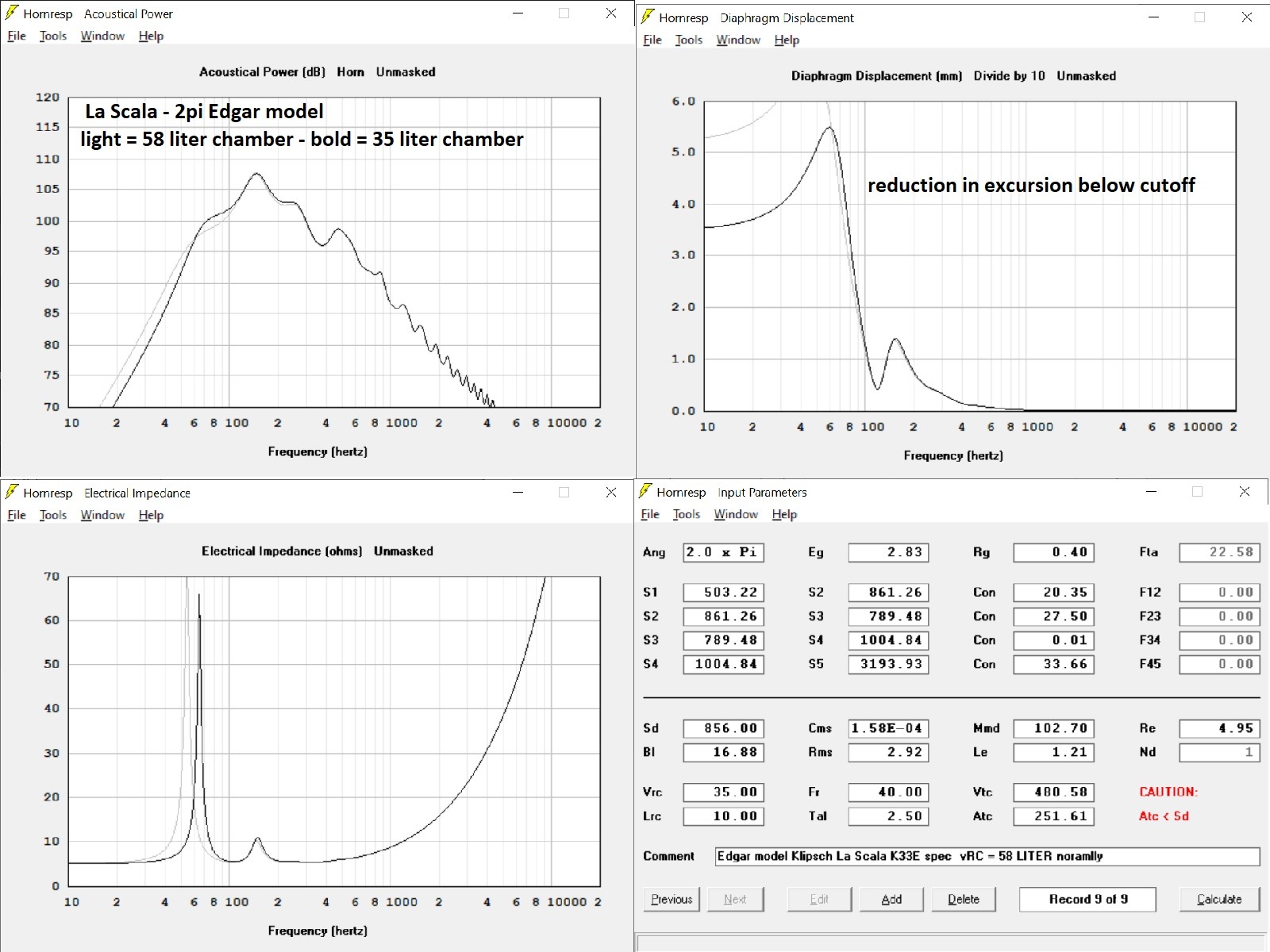

We all (here on the forum) can certainly understand this point of view. With all the documentation available, it is much less expensive to build an AA or Universal if you have the aptitude. The most expensive component is the pair of autoformers if you choose those over an L-Pad solution to attenuate the midrange. The caps and inductors for a pair of universals is fairly inexpensive as long as you don't go bonkers and use boutique caps/inductors.I’m trying to determine where the best VALUE is….not just price, but also quality.
Typically, lining the interior walls of a loudspeaker tames midrange resonances, not so much bass resonances. Lining a wall and stuffing an enclosure are not the same. These two approaches are done for different reasons.
Stuffing a sealed enclosure (correctly) can increase the apparent volume of said enclosure (Adiabatic Process) by 15~20%.
Lining the wall(s) of an enclosure will help tame mid-bass & midrange resonances inside the enclosure (sealed or bass reflex).
Although subtle, I think lining the dog house helps the completed (ported) loudspeaker sound more balanced.
I have 3" fiberglass lining in my dog house and some in the upper midrange horn area. Measurements confirm taming of some peaks here and there with no loss of sensitivity.
Don't do it as a first step. Take care of other, more important things, first, one step at a time and NEVER change more than one thing at a time. Otherwise you will never learn which thing you improved or made worse in the evolutionary process.Hi everyone. I intend to post about everything that I have done to my LaScalas but I have an immediate question.

Hint, port the LF horns and they will be bass bins. Porting is not just for low(er) bass, but to enhance the entire range from 30Hz~400Hz.LaScala…the industrial version with K43 drivers. They are stand alone from the Klipsch factory with no mid or high frequency sections.
I began referring to them as low frequency horns because there were comments about how they’re not “bass bins”…lol 🤷♂️
Best (realistic) bass you will ever hear without a subwoofer.
I built my LaScala with a 15” passive radiator instead of a port, because I had it on hand. This is what the frequency response looks like, using a Dayton audio DSP 408 active crossover and multiple amps:

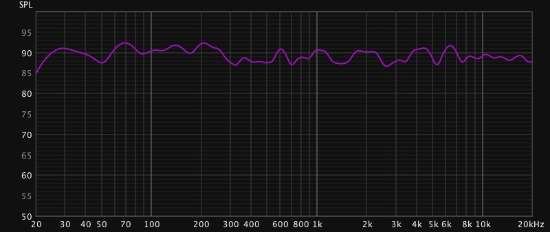

This is what it looked like before parametric eq was applied to get the response +/- 3dB:

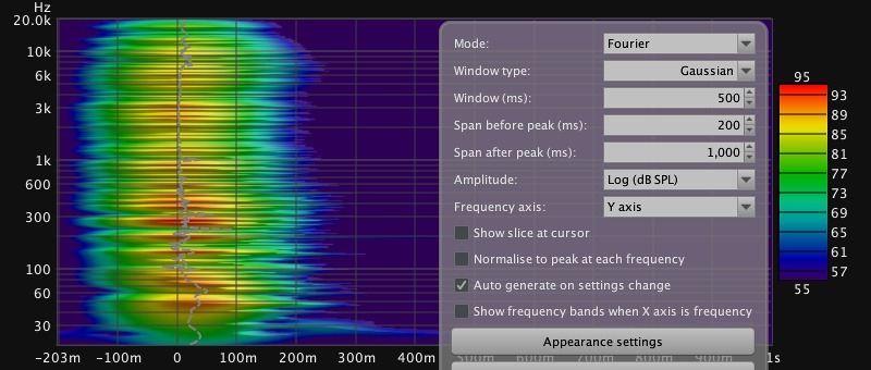

You can also do time alignment with dsp, which you can’t do with a passive. There’s a 3 foot difference between the woofer and tweeter drivers a s that distance can make a huge difference in how the speaker images.

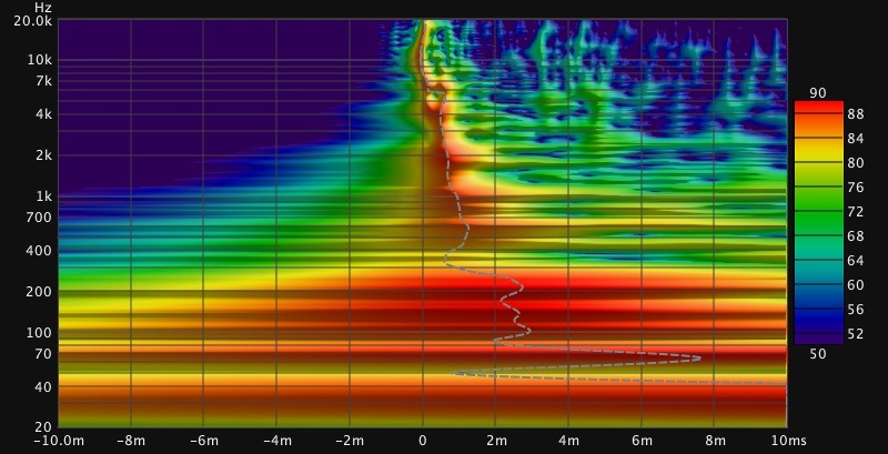

This is time aligned:
This is before:
I can’t say that the before was terrible, but the time aligned sound and imaging raised the hair on the back of my neck.
This is before:

The ported modification has been on my radar and reading list for a while…even before I pulled the trigger on buying these.
All this additional information is great…thanks for posting the Hornresp model data freddi!
I am on the fence a bit simply because I am wondering what is a more efficient use of time and resources right now…the ported modification or building a tapped horn.
Neither would be a major financial investment.
If I pursue the ported mod I was thinking I would flip the LaScala upside down, remove the doghouse cover and build a mid/high frequency top with a proper additional volume that would seal against the dog house opening…completely reversible if desired.
The tapped horns would have the added benefit of being usable with any system. I have some 10” drivers on hand that I believe would work well in them.
Eventually I hope to try both.
