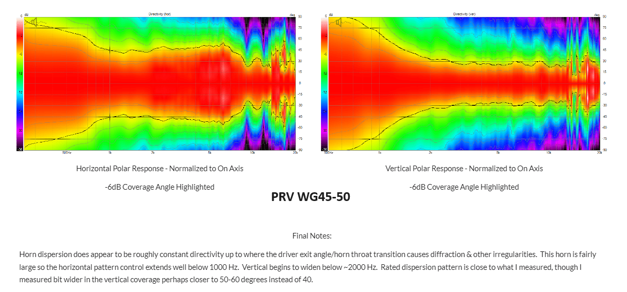

IIRC, the primary reason that the B&C DE120 was selected for the sMAHL, was due to clearance issues in many enclosures. Claude may correct me, but if you have the space, the DE10 is fine.
The D2200PH is less expensive and plays lower: 475Hz in a K510 and down to 400Hz ih the PRV WG4550 18x10" tractrix horn. I don't really see an advantage the the D3220Ph, tbh, unless you need the increased power handling and nominally higher sensitivity.FH1 plays smooth - and is well braced - lots of fun cranked with Bon Scott and Altec 511 as a midhorn. Have the Klipscheads played with PRV's d3220ph ?
https://prvaudio.com/products/d3220ph/
You don't. The ZXPC or PRV WG45-50 and PRV D2200Ph will blow away the A55G/2 and 401 horn. Plus the suggested parts are much less expensive.I had a short conversation with Michael over at Crites to see what their recommendation would be.

The D3220Ph looks like it has a fairly smooth frequency response according to PRV data. However, the D2200Ph has the perfect frequency response and bandwidth (400Hz~6kHz) on the ZXPC or WG45-50 18x10 horn. Who could ask for more bandwidth than this from a midrange/horn combo for a three-way system?
As stated earlier, unless you need the extra power handling, just use the D2200Ph.

I bought the ZXPC 510 clone and returned it for the PRV WG45-50/ZXPC 18x10. It has an extremely flat response and the polar pattern is pretty good from 400Hz~7kHz (horizontally). It looks like it is more of a "constant directivity" type horn rather than "tractrix".
I had the k510 clone with the the D2200Ph in an alignment that is comparable to a Forte. I’ll admit that it sounded better than any mid horn that I’d used up to that point, K700, K701, K602, but ultimately, I was kinda disappointed by its performance. When I decided to build LaScala clones, I went with the the PRV WG45-50 and couldn’t be happier. The frequency response is much better (lower) and smoother and the dispersion is better. Granted, I put mumps on mine, but overall, my LaScalus are significantly better sounding than even the latest generation AL-5, from both a subjective and objective standpoint, i.e. I think they sound good and I have the measurements to back up my opinion.Interesting that you are both talking about the PRV and K510 (eBay clone?).

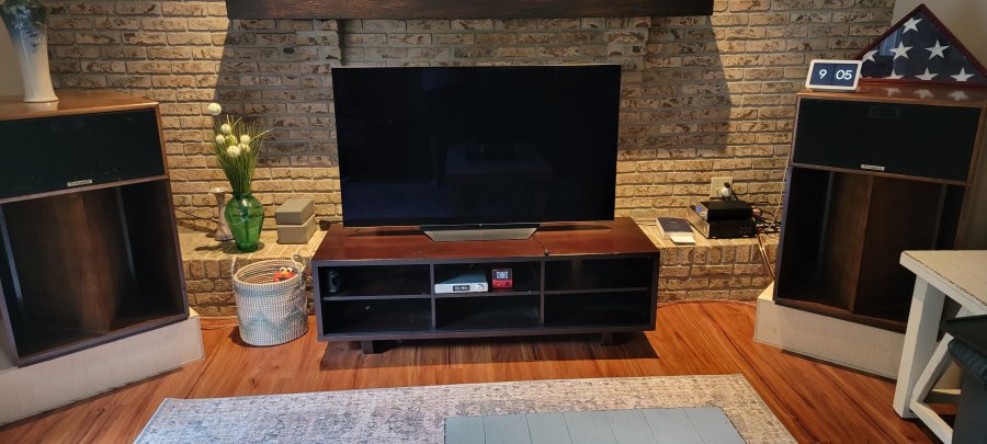

Hi everyone. I intend to post about everything that I have done to my LaScalas but I have an immediate question.
I am replacing the woofers and I have opened up the first speaker. I was surprised to see that there is no damping material in the doghouse. Shouldn't there be some?
If I am going to add some, does anyone have specific recommendations as to what, where and how much?
