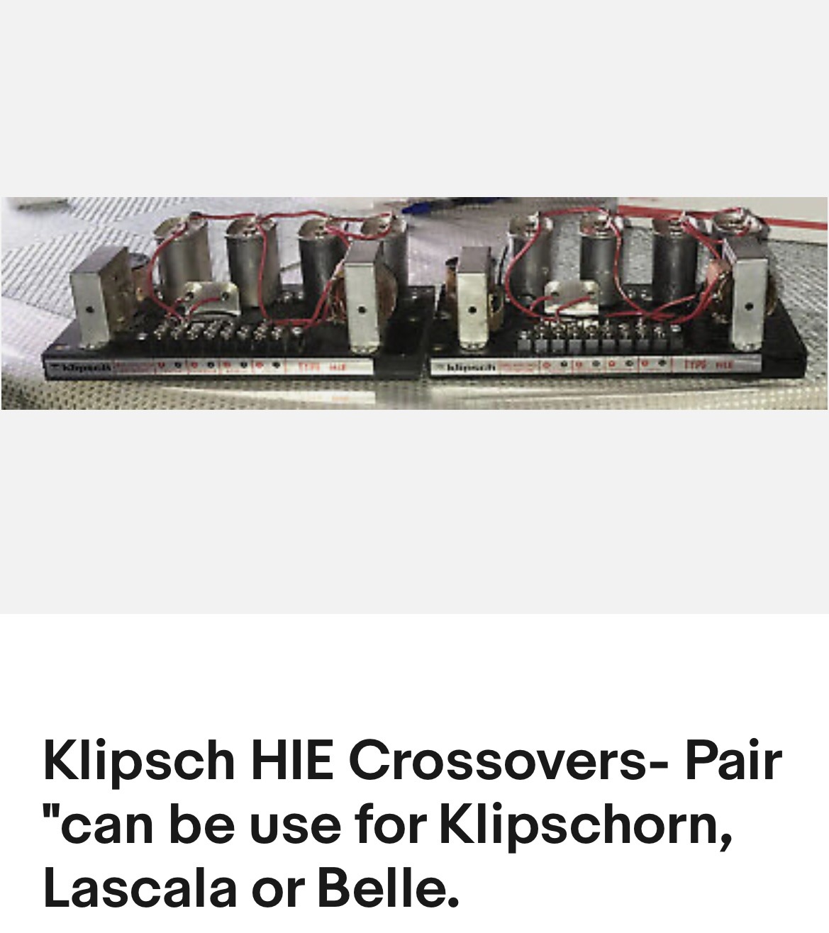

After going back and forth between various new and used crossover options over the past week I finally decided to pull the trigger on a pair of clean looking HIE I was watching on eBay.
I was looking for an AA so I could at least have a basic crossover to try “out of the box”.
Most of the AAs I came across looked like a$$ unless they had already been rebuilt…and then they averaged about $400…and would have to have components adjusted anyway.
At least this way I get some clean looking original autoformers (which will allow adjustments as needed) and the boards, barrier strips etc…all for $10 more than the 3636 alone from Crites.
Plus they’re local pickup so no shipping as long as I wait for my wife to go into her office in NY or a relative can swing by.
At least I’ll have something to work with now if I want to try driving this project with a single amp.

The barrier strips on those crossovers (above) are you best connection. Use spades instead of Banana plugs for your main connections.

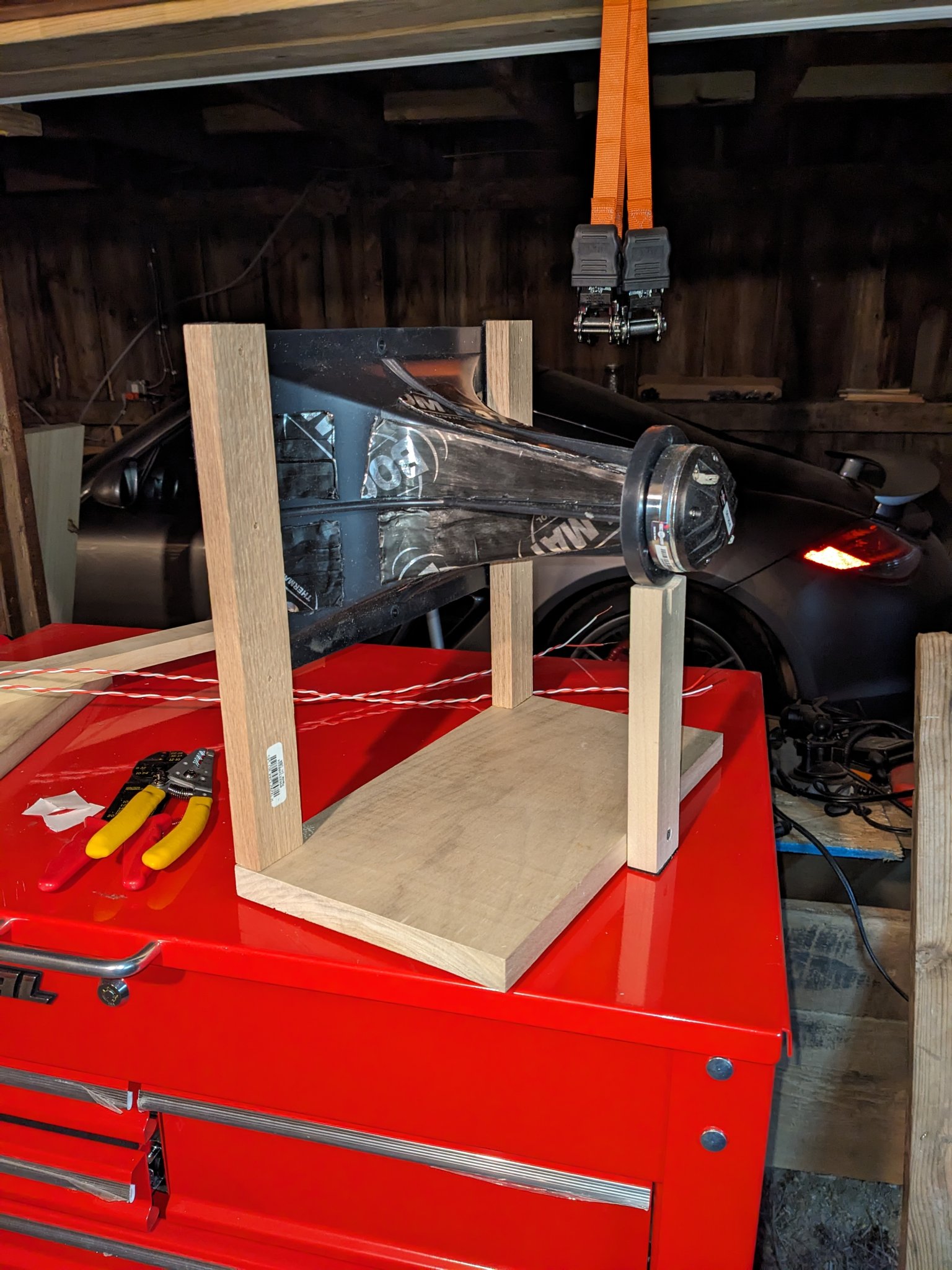

In the mean time, the PRV WG 45-50 horns and d2200ph CDs arrived along with the little Dayton h07e and adapters.
Everything looks good. I was impressed with the thickness of the horns…looks to be at least 1/4”. The CDs also have some heft to them.
I am a little concerned that the horns may resonate. I’ll probably want to add some damping to them.

No need to worry about horn resonance with the wg45-50. It’s completely not an issue.Everything looks good. I was impressed with the thickness of the horns…looks to be at least 1/4”. The CDs also have some heft to them.
Waste of time and material if you MOUNT Them into a plywood panel/speaker face.I am a little concerned that the horns may resonate. I’ll probably want to add some damping to them.
