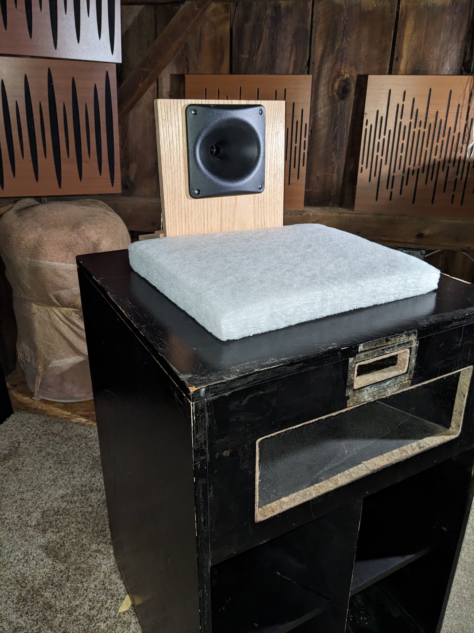

I already have some equipment that will allow me to experiment with actively controlling things.
I have more than enough amplification on hand. This past year I built a new pair of stereo Babelfish J2 amps specifically for this purpose.
I think I mentioned previously I have a pair if MiniDSP 2x4 that I’ve used before. I also have the UMIK-1 and REW set up on my older laptop.
However, I was not ultimately satisfied with the sound quality of the MiniDSP when I used it with my Oris horns previously.
My goal would be to use the MiniDSP as a tool for establishing crossover points and slopes that I could mimic instead with some JFET based active Bi-Amp crossover kits that I purchased from the DIYAudio store.
I’m limited with the Bi-Amp kits as far as EQ in concerned…but I’ve never been a fan of EQing a problem to fix things.
I can use some L-pads if needed to adjust levels…and convert to resistors later if desired.
I also have some Hypex amps that I have been using to drive Dipole bass.
They work really well in that application and I would have no reservations in trying them to drive the LaScala low frequency horns.

My 4 & 8 ohm derivations of the ALK Universal crossover are specifically tailored for the integration of the PRV D2200Ph with a 4 or 8 ohm woofer in a ported or non-ported LaScala and a B&C DE120/LaVoce DF10.142 tweeter.That makes sense and is what I would hope for.
I’m not sure how this project will develop yet.
The first priority should be to get the low frequency LaScala horns operational and presentable if I want to use them anywhere besides the basement.
After that I can imagine things could get a bit chaotic with the various midrange options I have at hand.
I’m not sure I would necessarily execute a finished upper cabinet right away if I’ve not tried a few options first. Although I have thought if I build one it should be modular and allow substitution of various horns and drivers.
I’ve been reviewing the schematic for the PRV horn/driver scenario and comparing it to a standard Klipsch AA and HIE. Trying to wrap my head around the various modifications and additions.
The ALK Universal is only a 6dB/octave on the woofer and midrange high pass. A 6dB on the woofer made the upper bass from the LaScala bass enclosure seem too "tubby" for my tastes. Going to a 12dB/octave on the woofer, plus the acoustic roll-off of the low frequency horn gave me a nice steep roll-off around 425Hz. The 6dB midrange high pass on the ALK Universal was also changed to 12dB/octave because the D2200Ph is not supposed to be crossed over lower than 500Hz if you want to be able to use its full power handling ability (which most of us will not). Crossing the D2200Ph over at 12dB/octave @ 400Hz on the 18x10 horn has not had any negatives anomalies that we have heard or measured.
The D2200Ph will go out to 8kHz, but you want to limit it to around 6kHz so you are well within the polar pattern of the 18x10 horn when you crossover the upper midrange to the tweeter for a smooth crossover region (acoustically). The 12dB/octave low pass filter for the midrange has been maintained (as per the ALK Universal) but modified specifically for the D2200Ph frequency/impedance curve. The 18dB/octave tweeter crossover has been maintained as in the original ALK Universal too.

Yes I agree. I can’t seem to get over my baggage on this issue.I like the idea of being able to time-align the bass horns but I don't like the idea of effectively turning my high resolution digital files and vinyl collection into CDs.
I will say I’ve been happy enough with using the Hypex amps for bass support. Which in the LaScala scenario would allow for time alignment.
Since the mids and tweets need to be delayed compared to the bass horns I'm not sure how that works. I've decided to ignore the misalignment of the bass but getting the tweeters aligned with the squawkers is a nice improvement in focus and coherency.Which in the LaScala scenario would allow for time alignment.

It doesn’t…except in my little world where I am thinking a$$ end backwards 🤪Since the mids and tweets need to be delayed compared to the bass horns I'm not sure how that works.
Putting the tweeter on top of the mid cabinet so it can be slid back and aligned makes most sense…even if it may not be as aesthetically pleasing as mounting it in the same baffle as the mid.
That's what I have done.Putting the tweeter on top of the mid cabinet so it can be slid back and aligned makes most sense…

When I tri-amped my La Scalas using DSP, I time aligned the drivers in the La Scalas.
To determine delays, I took 4-5 REW sweeps (and threw out any where the delay wasn't close to the delays from the other sweeps) and used the average. There were very slight variations between the two speakers, The woofers had no delay; the squawkers were delayed 1.24ms (left) and 0.96ms (right); the tweeters were delayed 2.70ms (left) and 2.41ms (right).
So, it seems that both tweeters are delayed 1.45ms compared to the squawkers. When I got 9.3 inches did I do the math right? That sounds wrong, roughly half the physical distance that I would expect.the squawkers were delayed 1.24ms (left) and 0.96ms (right); the tweeters were delayed 2.70ms (left) and 2.41ms (right).
I grossly aligned the diaphragms and used REW to generate a 5khz tone. I adjusted the position of the tweeters to maximize the output. The level changes several dB as I adjust the position forward and backward an inch or so. It feels pretty easy to find the middle.
The results sound great!

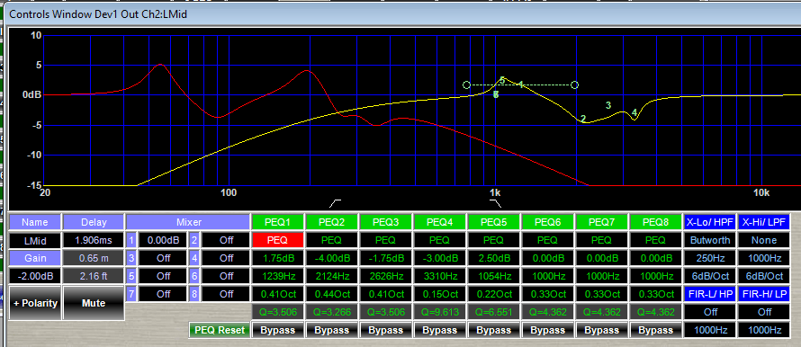

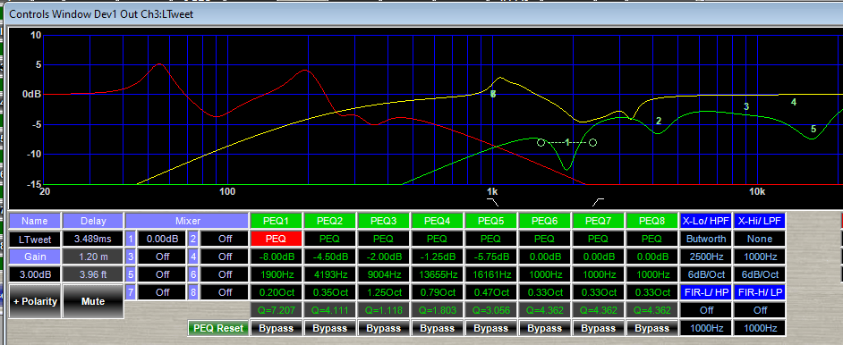

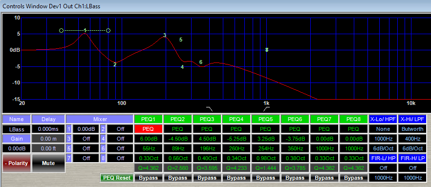

When tri-amping a La Scala II for a guy that lives in New Zealand, here are the settings that I found for him (noting of course that first order crossover filters are used--just like PWK used for the original La Scalas). The use of first order IIR filters is to minimize the all-pass (excess) phase growth of the entire loudspeaker--a big factor in how it sounds overall in my experience.
Also note that the midrange has no low-pass filter on it--just like PWK did for the original La Scala--because the cutoff of the midrange compression driver/horn is so sharp that no electrical/electronic/DSP filter is needed on the midrange high end. This saves an additional 45 degrees of phase growth for the entire loudspeaker. First the bass bin:
(Note the polarity reversal on the bass bin, above, in order to save 180 degrees of phase growth. This also affects the midrange/tweeter channel delays.)
Then the midrange:
Finally, the tweeter:
I used input channel PEQs also. Here are the two input channel PEQs used to flatten the amplitude further through the crossover bands. Remember, I was performing this remotely via his emailing of REW measurement files to me, and Xilica configuration files (.xdat) were sent back to the owner, thus completing one "round robin" trial. This reduces the latitude of how tightly the dial-in can be (the number of PEQs, etc.), but the result is the same--flat amplitude and smooth phase response:
The above was for the left-side La Scala II. The right side La Scala II has a few tweaks but the delays, channel gains, and most of the PEQs above the room's Schroeder frequency (about 150 Hz) were basically unchanged. This was a typical dial-in exercise that took about 8 round robins, including initial individual measurement of each driver (woofer, midrange, tweeter) to flatten their response.

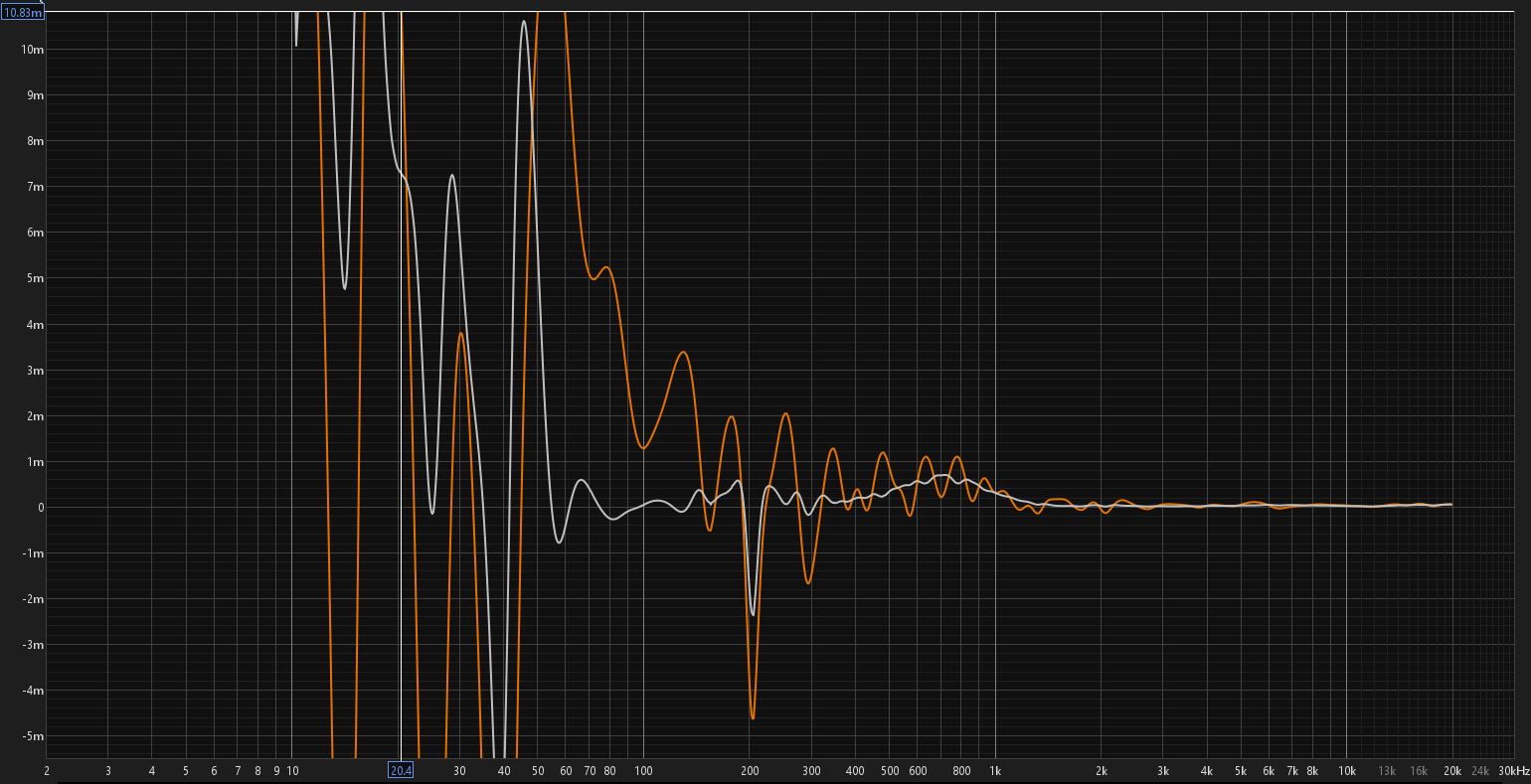

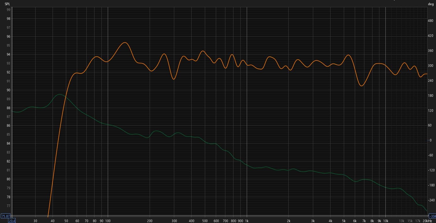

Here are a couple of plots of the resulting measurements.
Transfer Function (Amplitude and Phase):
Group Delay and Excess Group Delay:
Chris
Chris

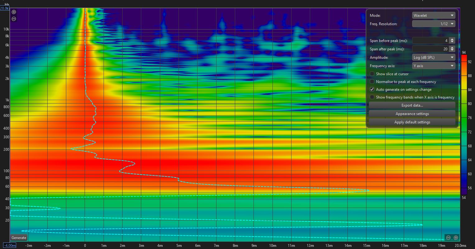

One of the things I'm a big proponent of is the spectrogram plot--which allows you to see the room's effects on the response:
Chris
