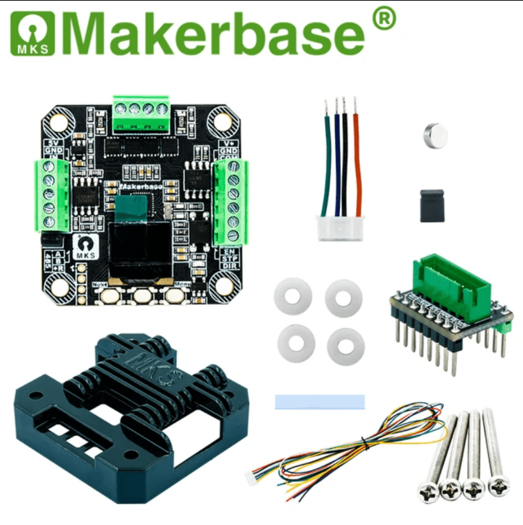

These are either available as a affordable additional pcb that you can mount on your current stepper motors or as a while unit incl the stepper motor.
You mean in the case of a whole new unit?Do I need something else or is it just a drop in replacement for the stepper driver?
As long as it's the same NEMA size and it roughly uses the same current (and sometimes voltage), it's just a matter of dropping in.
Keep in mind that they are a bit bigger obviously, since there is a entire encoder on the back.
no I think that is just a break-out board to be able to mount it on a breadboard.Does the little board with only the green connector simply replace the stepper driver on my CNC shield?
But maybe you can share a link/information about the product?

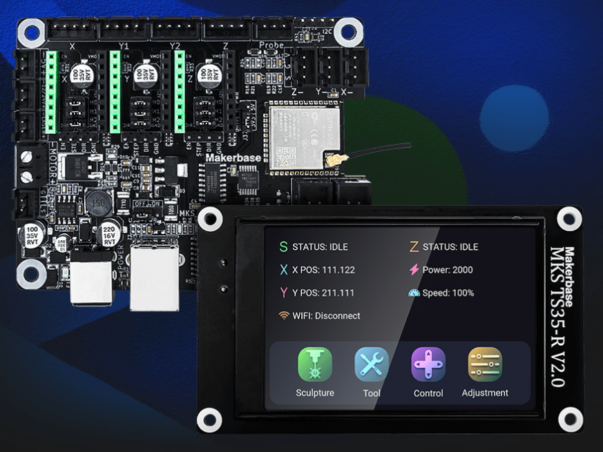

Coincidentally a few days ago I ordered an all in one ESP32 board from the same brand with TMC2209 Steppers and a touchscreen display to use as a base for the electronics. I am interested to see what the Stealthchop2 in the TMC2209 drivers can do, if it is quiet enough to be on all the time. It was also very cheap for what it is including wifi and bluetooth etc.I saw that video. I've also seen them advertised as drop in replacements for 3d printers. I just don't know if that's the same for the CNC shield. I think so, but 'the wish might be the father of the thought'.
https://github.com/makerbase-mks/MKS-DLC32?tab=readme-ov-file
