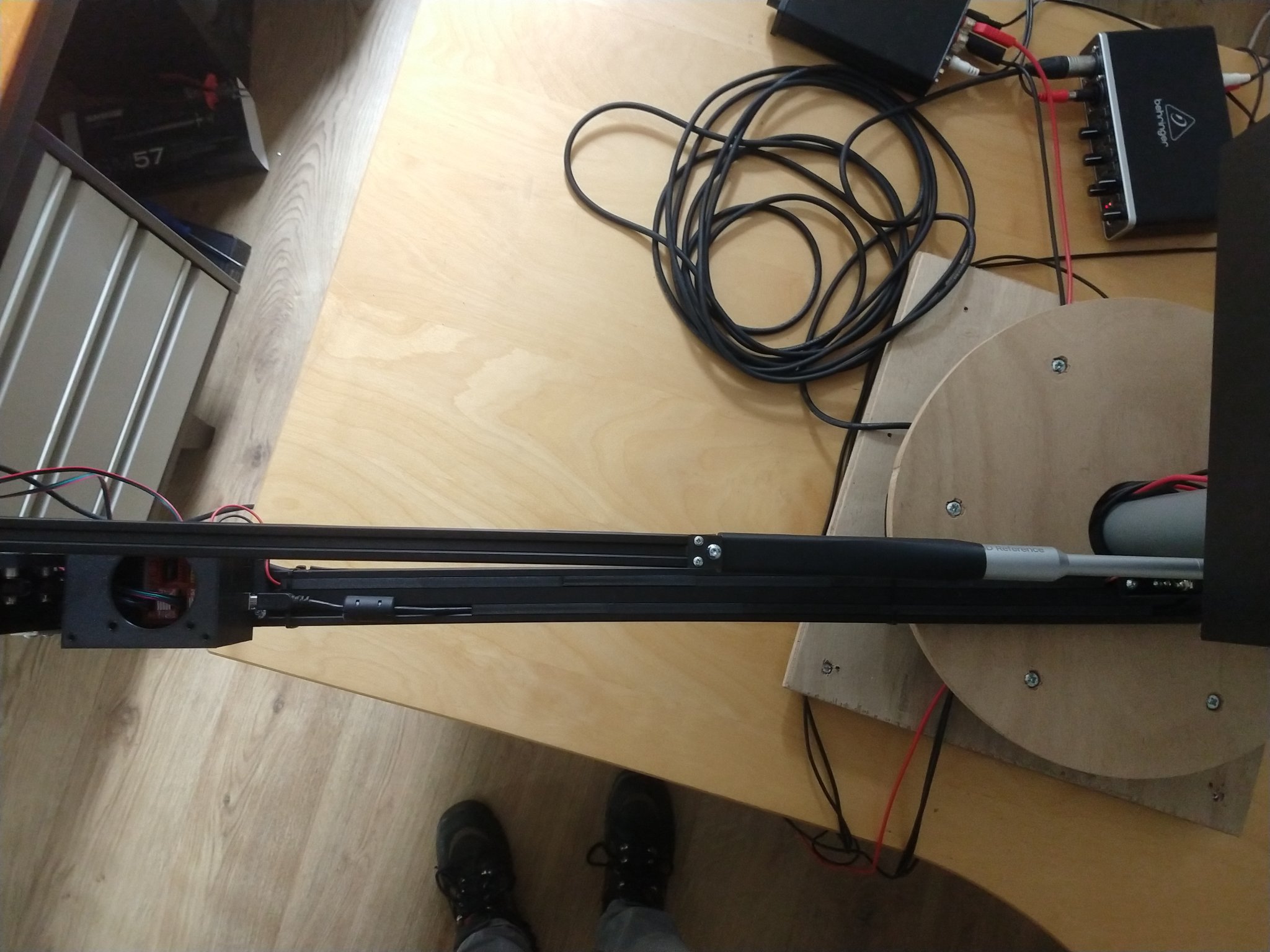

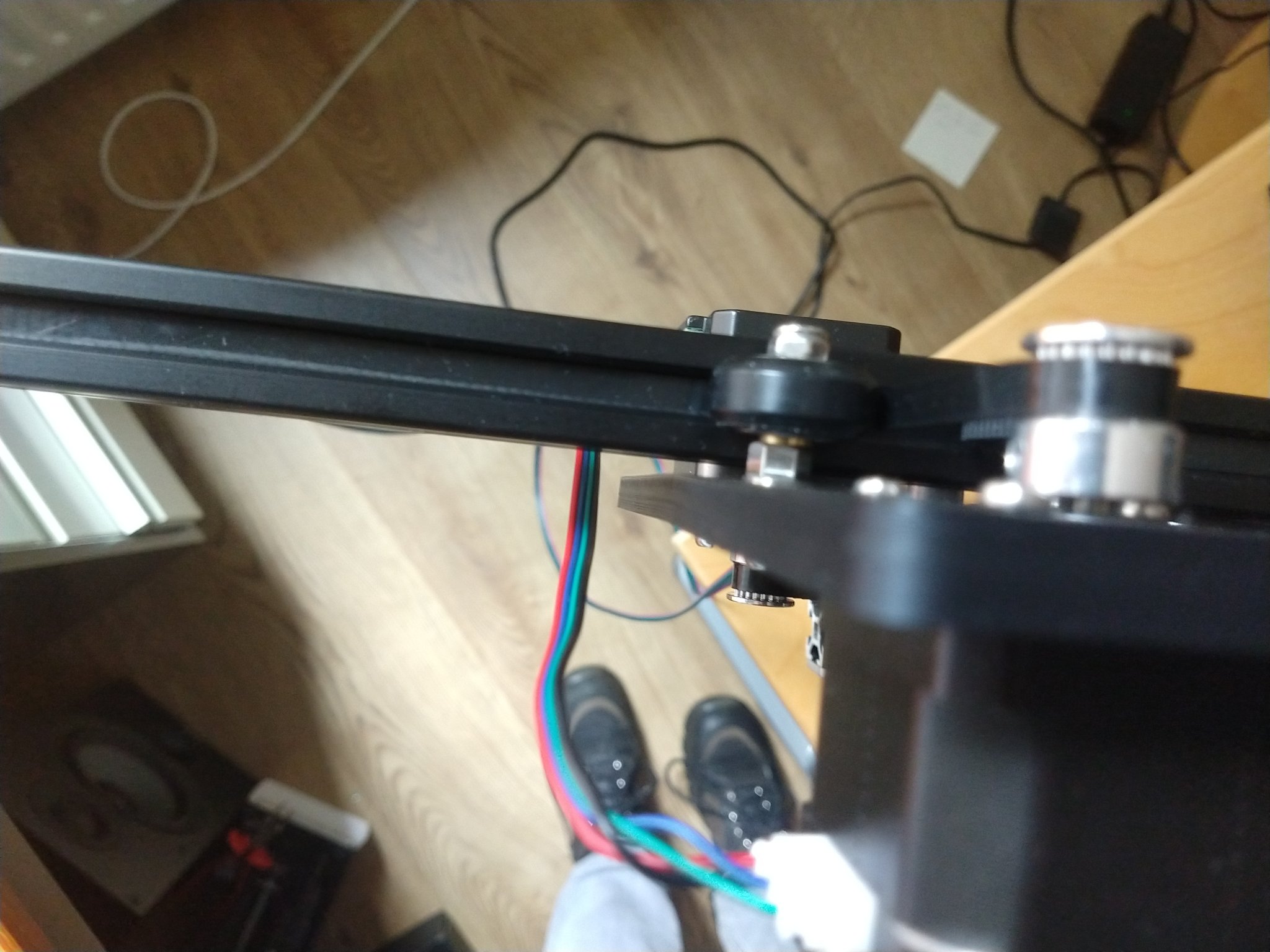

Also the mic boom is not parallel to the main arm:
Somehow the zero-point of the vertical axis moves up. I thought I fixed it by adjusting the counterweight. I also changed the rotation from 0-360 deg to -180 - 180 deg to limit these problems further. If you look at the gifs a few posts back, you can see that 0 and 360 degree don't line up neatly.
It still happens though and the problem is larger than I would like it to be. Of course closed loop steppers would fix this, but I hope I can fix it without having to change the motion interface with my code.
Losing steps is going to be an issue when you measure all day long to get a proper point cloud. So maybe the Closed loop stepper is the only way that is easy to implement. If I remember correctly that has become the best practice with the faster 3D printers as well.

The problem is that the z=0 (relative to the frame) creeps up.
Is it because the rotating platform isn't level over it's travel or something else?
I set zero as the lowest point mechanically possible on the z axis. Mic boom assembly is touching the rotating arm. Then after a full set of measurements for an angle, it should return to z=0 and move to a new angle. It returns to a point that's around 1cm above the original ('mechanical') 0.
