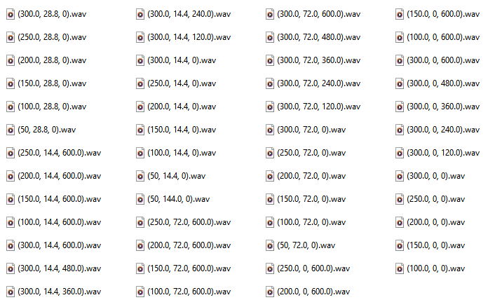

That is exactly what I am doingInstead of working with how many steps you have to take from/to each position, work with a coordinate grid system from a certain reference point.
Obviously under the hood it's the same, but it makes it just easier to work with.
File naming is currently (radius, angle, height).wavIn that case also the (file) naming will be super straight forward, since you just have to see at what coordinate you are and what measurement had been done at the same time. (Either like really in time or what time in your loop).

Timestamp could be added of course. Linking up measurements and coordinates is as easy as this:Just an idea, but you could also also add a time stamp maybe?
In that case linking up measurements with coordinates might be a bit easier?
But I'll add a naming convention layer so anyone can add their own way. "We can solve any problem by introducing an extra level of indirection" ("…except for the problem of too many levels of indirection,").
In this case I wasn't being silly about what fancy names people want, I am purely talking about keeping track of stuff to begin with 🙂ut I'll add a naming convention layer so anyone can add their own way.

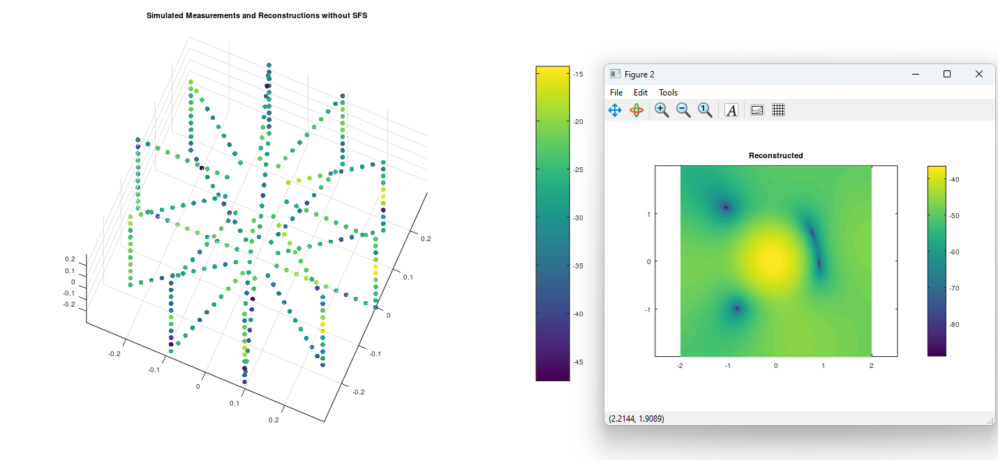

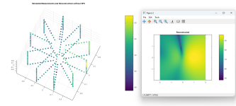

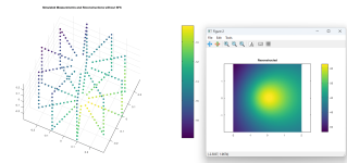

Sneak preview:
On the left the raw measurements.
On the righ a reconstructed sound field on the xy-plane
Low frequency:
You can see most of the sound is coming from the port.
Mid Frequency:
High Frequency:
Most sound from tweeter.
Not enough measurements, only one surface measured so no SFS, probably bugs, but we made some steps forward.
