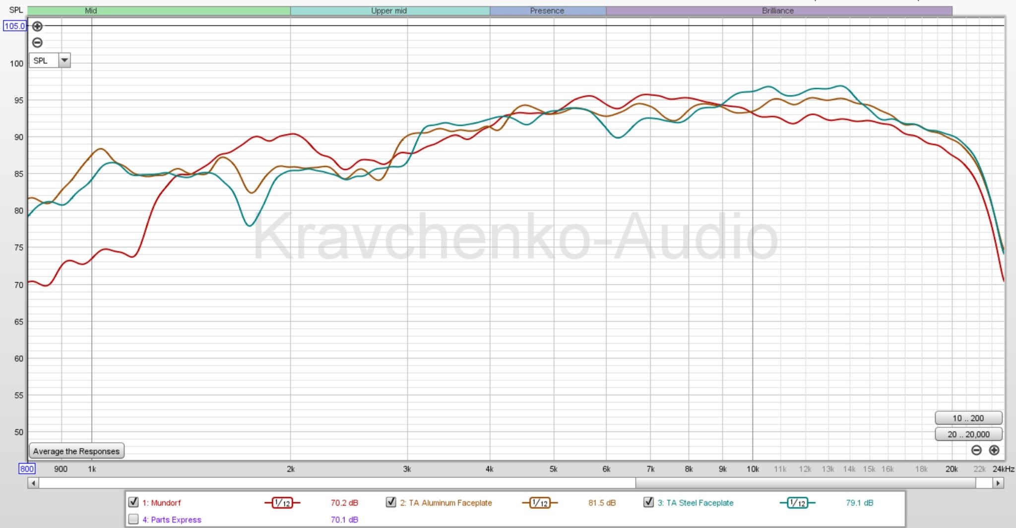

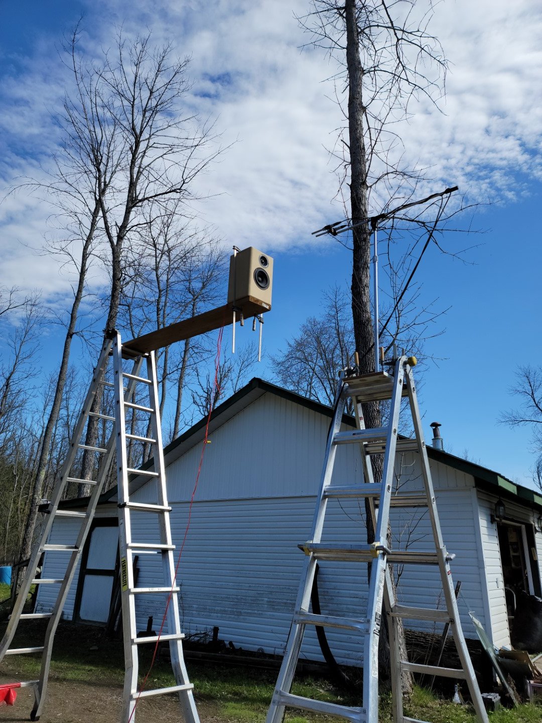

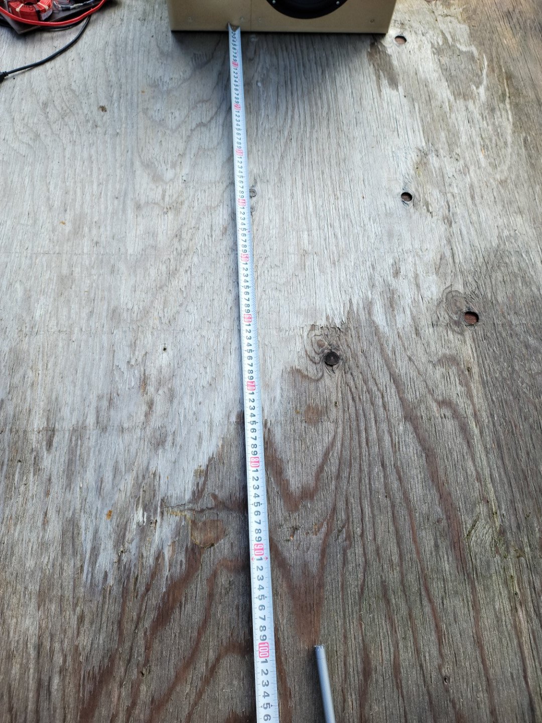

And when we want highest resolution now, it is a groundplane measurement. It saves me setting up a 12 foot and 15 foot ladder. The sheet of plywood gives you a smooth surface no matter where you are situated.

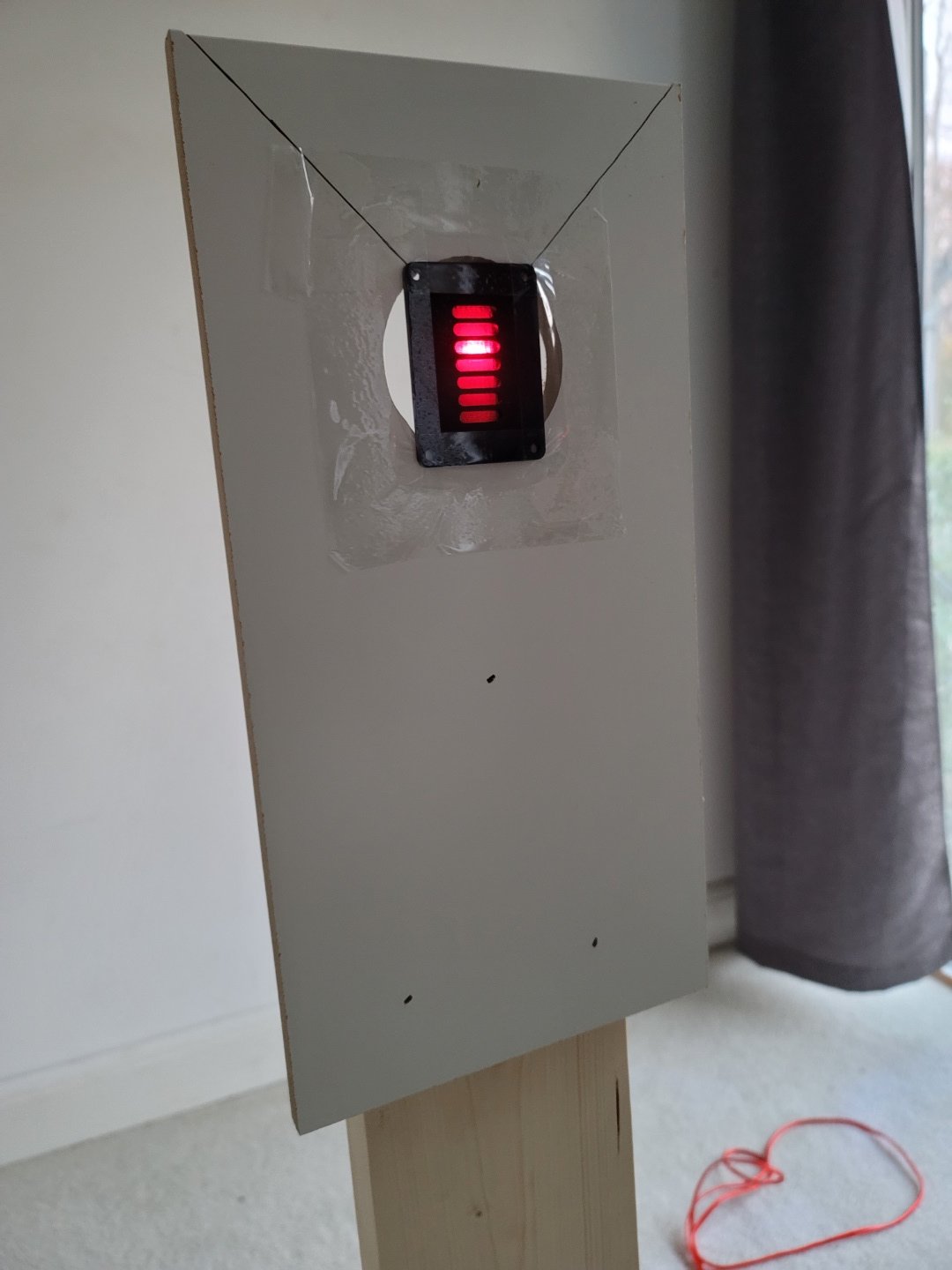

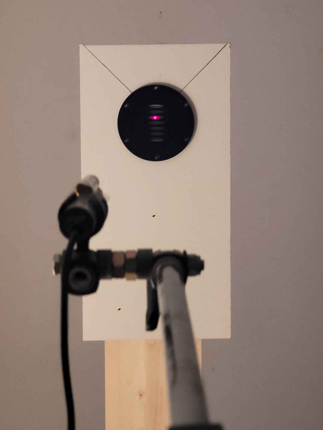

8 x 16 inch baffle and a Mundorf AMT
Pew pew

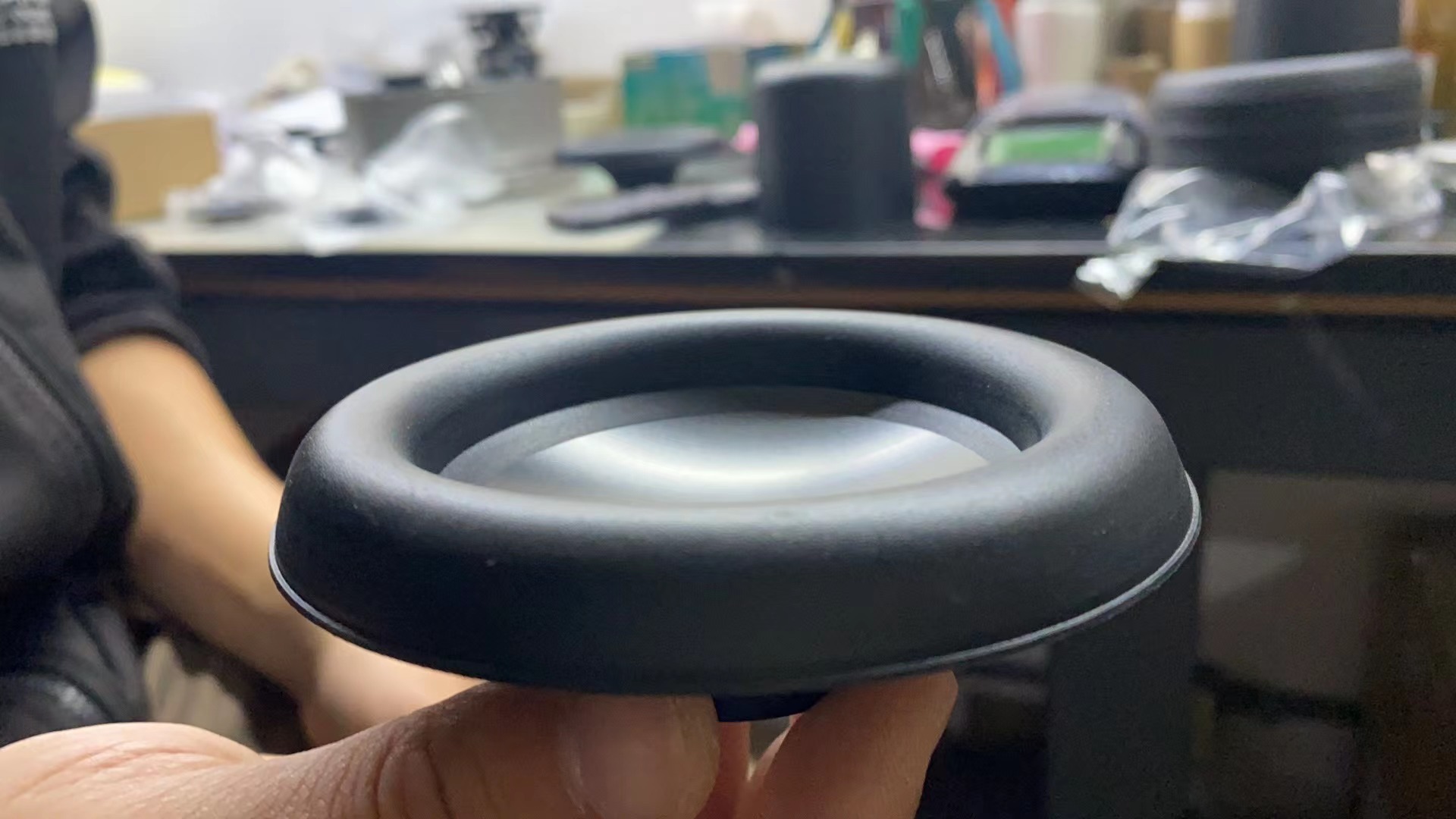

An AMT I am working on currently.
25 measurements via REW each driver Vector averaged. Each measurement is done via pulling the mic back 100mm starting at 1 metre. The is smoothed to 1/12th octave. Umik microphone. I have much more expensive mics, but it is as accurate as the good ones as long as the SPL is not to high.

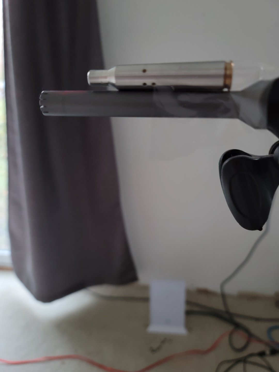

I look forward to seeing it!I will try to post a picture of what I have so far, but probably not until next weekend.But the basic idea is that the mic can be positioned conveniently in spherical co-ordinates, manually at first, stepper motors added easily as a second step.
Sounds like some good hardware. That's the M215? Is it's factory calibration any good? I have an NTi Audio M2010 but I've been interested in getting an M215 because the "nunchuck" style of the M2010 has disadvantages sometimes (although possibly not in this application)... and I'd like to have another Type I mic that's not crazy expensive.I now have a precision measurement mic, a Bruel and Kjaer clone from MicW, and it calibrated pretty well.
Structure is nice thin wall, cold drawn aluminium tube from cross country race ski poles.
I need a mic interface probably a Topping E2x2.

That momentum on that wooden board scares me though lol.

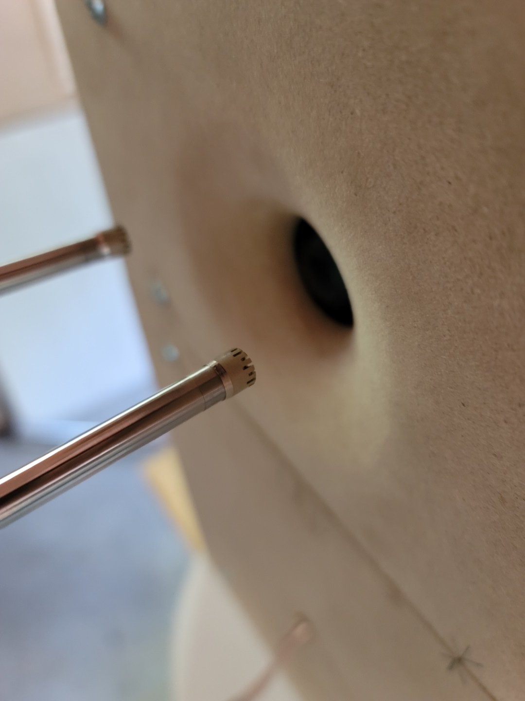

What find interesting is that the mic close to the speaker is not on-axis nor inline but next to the midrange and at 90 degrees. Looks at first glance to me to measure primarely modes not speaker response given size of the hall ?Seems that Kii is using a similar approach, see picture:

Yes, given the shape of the mic capsule. Still curious as to why the mic close to the speaker is not in line. It is close to the midrange, yet the far mic is on about a meter and on-axis and measures the whole speaker. Assumption here it is measuring the whole speaker and not just the midrange.
Could also be that the close mic measures bass as well, and therefore is positioned at a decoder for point between mid and bass.

Since Kii is an active cardioid system, which are a bit fiddly to get "perfect" , I can totally see why they wanted 180 degrees measurements for nearfield as well.
Also, we don't know the context of this picture.
So maybe they were just doing some specific or non related tests

Solid like rock. 238mm wide x 38mm thick. Clamped across two stiff ladder rungs. So it is a little springy, but not much. This used to be my go to method. Then I discovered this thread and did a lot of comparative measurements. Everything anechoic messes up your calculations in that you are missing the inherent bounces that effect the midrange greatly in any realistic room from just the floor, then the ceiling. I would make best guesses, and then measure in room anyway. So, why go through all the fuss? Do the measurements insitu. You mentioned how Anechoic chambers are now not really needed. I agree except for low frequency measurements.That momentum on that wooden board scares me though lol.

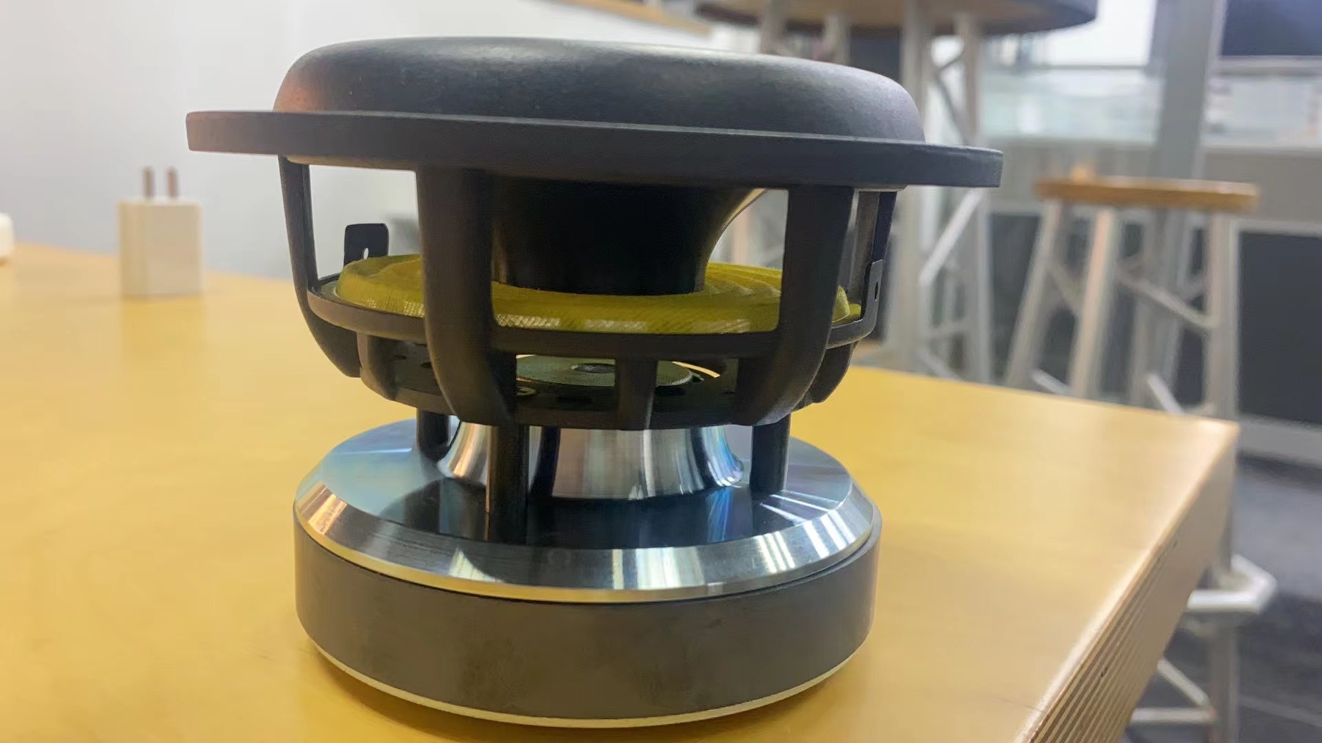

A very long excursion 100mm driver I recently designed. Not quite 10mm real world mechanical throw.
