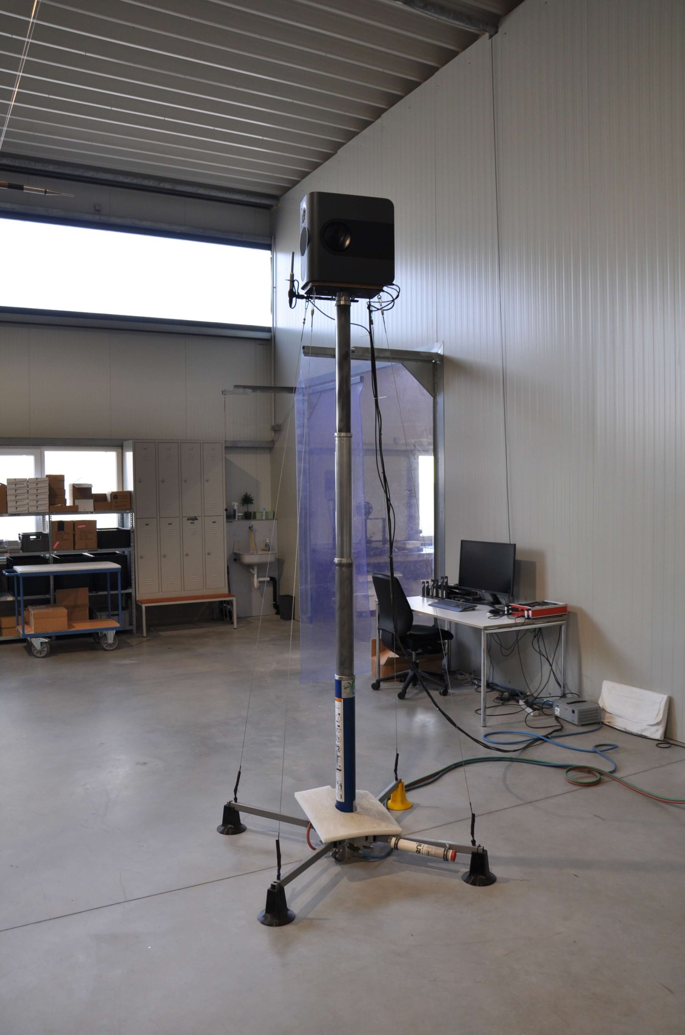

Seems that Kii is using a similar approach, see picture:I applaud your experiments! So far, you and Mark K. are the only other people on this forum to experiment with this method, and I do agree that your RMS average looks like a better fit... but the "sag" between 70Hz and 3.5kHz in the RMS Vs. Vector is interesting to me, there's clearly a lot of the room showing up below a few hundred Hertz. Daniel Krol's original paper also shows more variation at low frequency in small rooms too since room modes aren't quite the same animal as higher frequency reflections.
Having good ground plane data would be nice to compare to also.
It codes from an factory visit article in hifi.nl:
https://hifi.nl/artikel/33047/Fabrieksbezoek-Kii-Audio.html
Is in Dutch, but basically they measure in a fabrication hall with 2mics and special software, it removes the need for costly anechoic rooms etc.
It does seem like a similar concept, and it reminds me of this method too (which also works pretty well). I think it's worth a test to see if Kii's method is usable in a smaller space. My intuition says that it's less good in a smaller space because someone like Bruno would probably us it in one if it did, but I'm still curious.Bruno has developed a unique measuring method that eliminates the need to use an anechoic chamber. In the middle of the assembly hall, far enough away from all walls, there is a vertically extendable pole on which the loudspeaker is mounted, and the measurement is then done at a height of about four meters with two microphones: one close to the loudspeaker, and one at a somewhat greater distance
