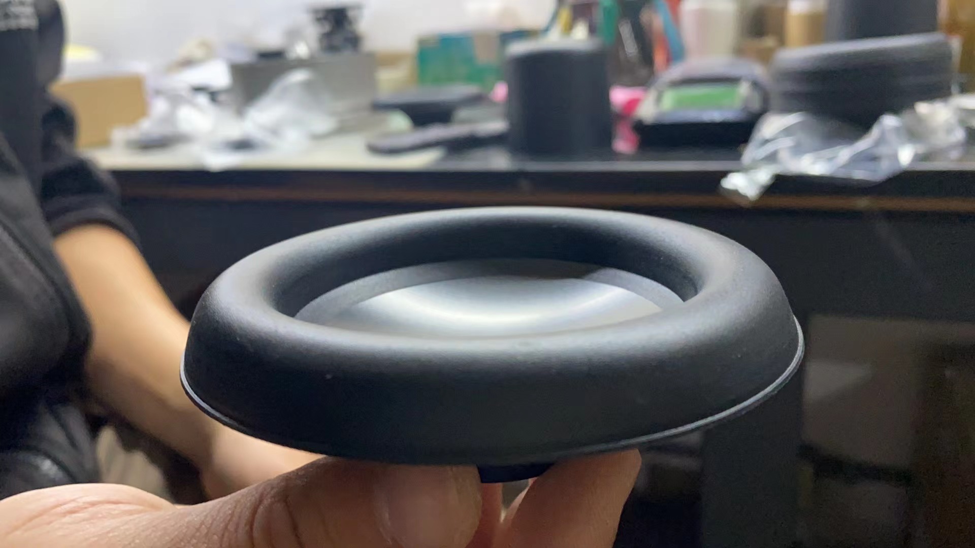

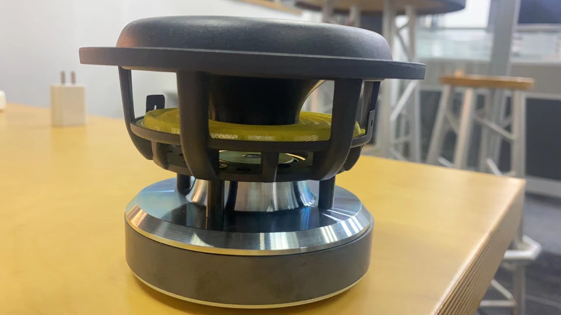

Yes, for the purposes of simulating maximum SPL from specifications I agree. Simulations are very accurate. Especially from Hornresp. But, Many many woofers are very optimistically specified using the geometric distance of the voicecoil minus the top plate, or at a BL of 80% calculated and simulated! When I measure subwoofers I do this outside and I can tell you it is a rare woofer that gives you honest specifications. I recently read of a car audio driver that purported 3 inches of travel in each direction. When you design woofers, you need to pay attention to the mechanics of the basket. And I knew the basket that they attributed this massive excursion too. To get that mechanical motion was simply impossible. Secondarily to have a surround that has that much mechanical motion you loose so much SD that it becomes a game where you gain almost nothing due to the smaller and smaller Sd. Through many years of design I have come up with a rule of thumb to not try to do anything greater than 34mm one way. Most of the driver designs that I do start at 10mm one way. Examples abound of wishful engineering. Some I cannot mention. But for real world performance testing of a subwoofer you need the great outdoors. Your building will not like 130db at 14 or 16 hertz believe me!
Mark
A very long excursion 100mm driver I recently designed. Not quite 10mm real world mechanical throw.
