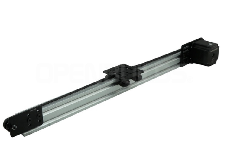

As this is the Klippel on a shoestring thread I assume we are discussing automation of measurements.
The method of using REW vector averaged measurements with incrementally increasing distance is quite time consuming if one uses 25 samples as @Kravchenko_Audio refers to in this thread. Do not know much about the subject but it looks like one could use the shareware Arta_Tic http://nicholasmart.in/measurement_platform/ as is and combine this with a standard guide rail with a stepper motor like this: https://www.ebay.com/itm/124901880488?hash=item1d14bb72a8:g:BpEAAOSwUFVhQbMk
For a really long axis a solution with the motor on the slide can give you several meters of action: https://openbuildspartstore.com/nema-17-belt-and-pinion-bundle/
If one wants to use REW for the measurements I think it would be quite easy to use a standard step motor controller to move the mic assembly in the desired increments both fast and reliable. Then one only needs to set the appropriate delay between measurements in REW. With a mechanically robust setup less than 2 sec between measurements is doable I guess. (These things are FAST).
I think that Arta_Tic is not available anymore. Fortunately an alternative is available, written by yours truly 🙂
Most info can be found here: https://www.diyaudio.com/community/...arta-stepper-motor-and-tic-controller.387325/
