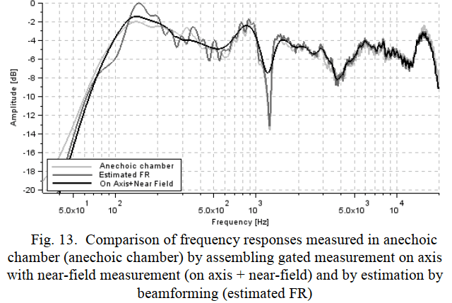

- I then merged the far-field and the (adjusted) near-field.
- Verify with gound-plane measurements, because its easy enough to haul a small bookshelf in and out of the house. For small bookshelves - the process above gets me very good matching to ground plane measurements.
Do you merge NF and FF phase or use the Hilbert transform to generate minimum phase data for the merged FR?
The LF resolution of the FF+NF curve ( the NF measurement) seems low. No? Hmm...I applaud your experiments! So far, you and Mark K. are the only other people on this forum to experiment with this method, and I do agree that your RMS average looks like a better fit... but the "sag" between 70Hz and 3.5kHz in the RMS Vs. Vector is interesting to me, there's clearly a lot of the room showing up below a few hundred Hertz. Daniel Krol's original paper also shows more variation at low frequency in small rooms too since room modes aren't quite the same animal as higher frequency reflections.
Having good ground plane data would be nice to compare to also.

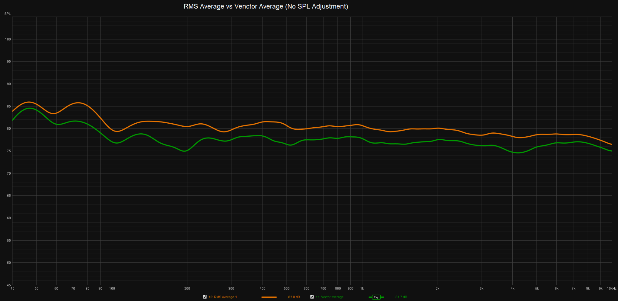

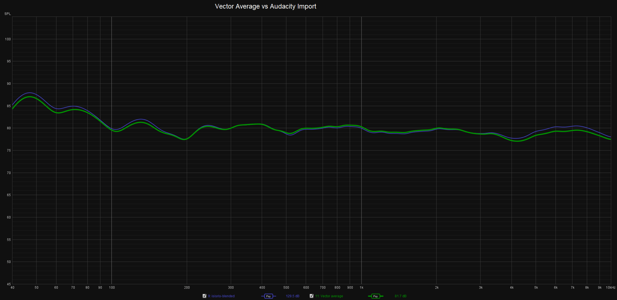

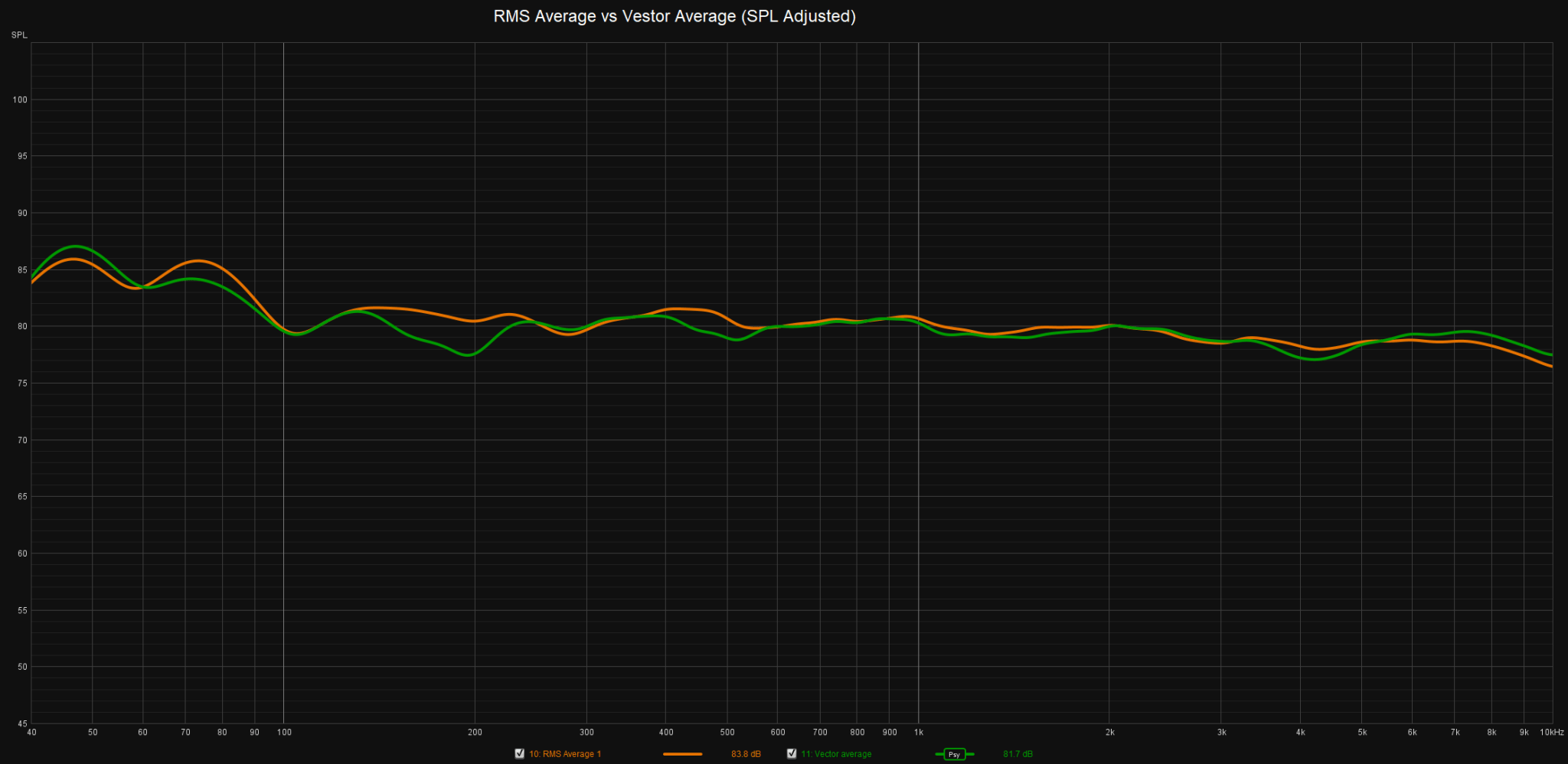

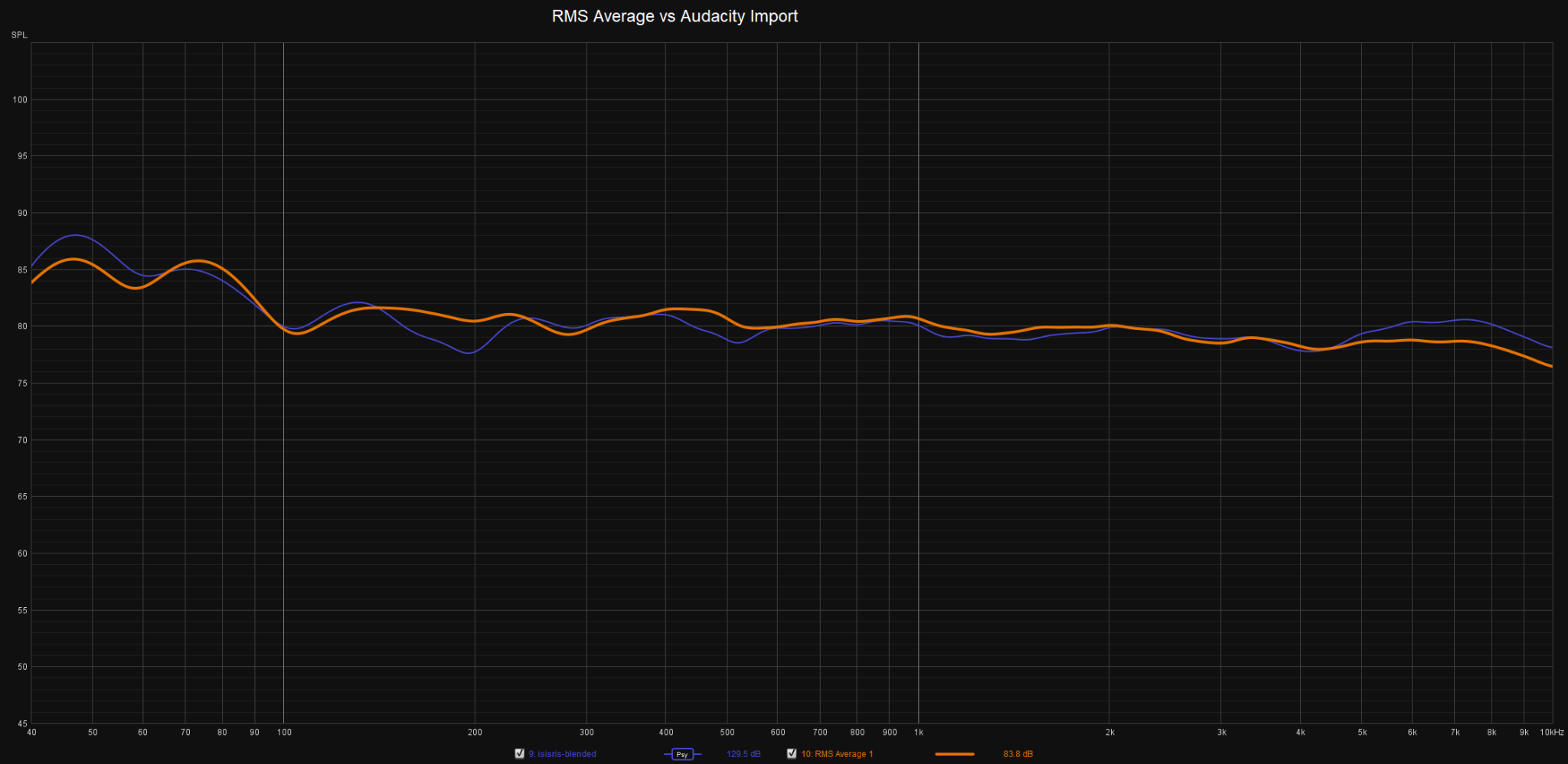

I took measurements of the tall tower speakers (in the earlier picture) using the slide technique (moving away from the speakers). I took 8 measurements, this time moving back 30cm between each measurement. I decided to include more distance between each measurement so as to make sure that at least the first reflection (as observed in the impulse response) does not land in the same spot between consecutive measurements. Over the measured distance, the first reflection was observed between 1.8ms (furthest away measurement) and 3.8ms (closest to the speaker measurement).
I again too vector average and RMS average. I so exported each impulse in to Audacity - reduced the amplitude of each measurement - and then mixed them into a single track and imported the track into a WAV impluse.
Four pictures have been included below (all why psychoacoustic smoothing):
1) RMS Average vs. Vector Average (no SPL adjustment)
2) RMS Average vs Vector Average (SPL adjusted to overlay one over the other)
3) RMS Average vs. Audacity Import
4) Vector Average vs Audacity Import
Which one should I be relying on? It will be impossible to take ground plane measurements to verify anytime soon 🙁. Does my speaker have a dip at 200hz? or no? Either way, I can't rely on my hearing to tell me whether it's there or not.

Um, what are you even worrying about? Seriously. If you move your microphone left or right 30cm you will have greater variations in your measurements. What many people do not think about it that a measurement is a snapshot of the device, the room and the placements of the Device, the microphone in the room. You have great measurements there.
I still do not know why you use Audacity. You can do all the math functions within REW. And as it is staying native within the measurement system it will be treated in a way that John meant in the first place. I have measured the same item for testing with different software and the same mic and gotten slightly different results as you have here. A lot of what is happening in measurements is related to the stuff under the hood. And while you know that a db or so ripple is meaningless. You do not have any large wide dips a db or so that would be audible. And even this, audible under limited circumstances. Our ears are marvelously forgiving after 10 minutes or so.

I do agree with your comment on the unnecessary use of Audacity. The last picture included in my post above clearly proves that the whole Audacity process results in a near-identical response to the REW Vector average. I believe @aslepekis came to the same conclusion at the bottom of post #593.
I'm just trying to get an understanding of how we can obtain better low-frequency response measurements when the ground-plane method is not a near-term viable option. So I wanted to know if there is any reason to believe that the Vector Average is a better indicator of a speaker's anechoic performance than the RMS Average, or vice-versa. Or maybe both are incorrect?
