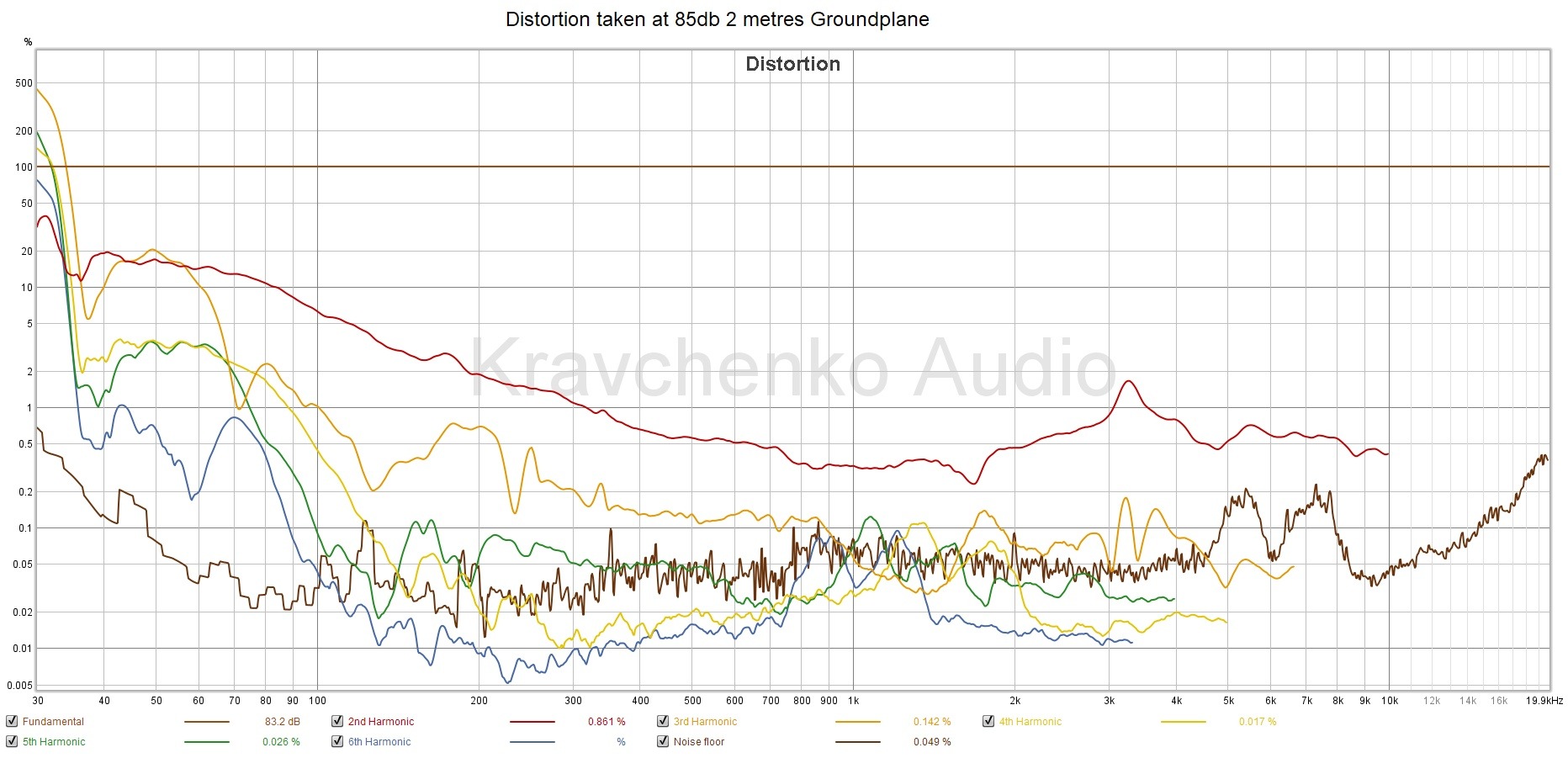

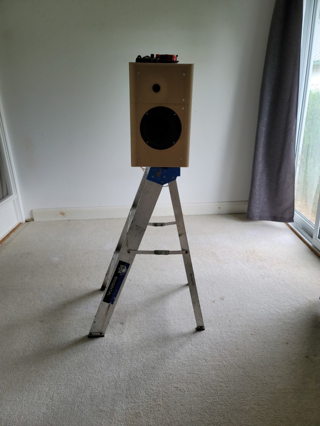

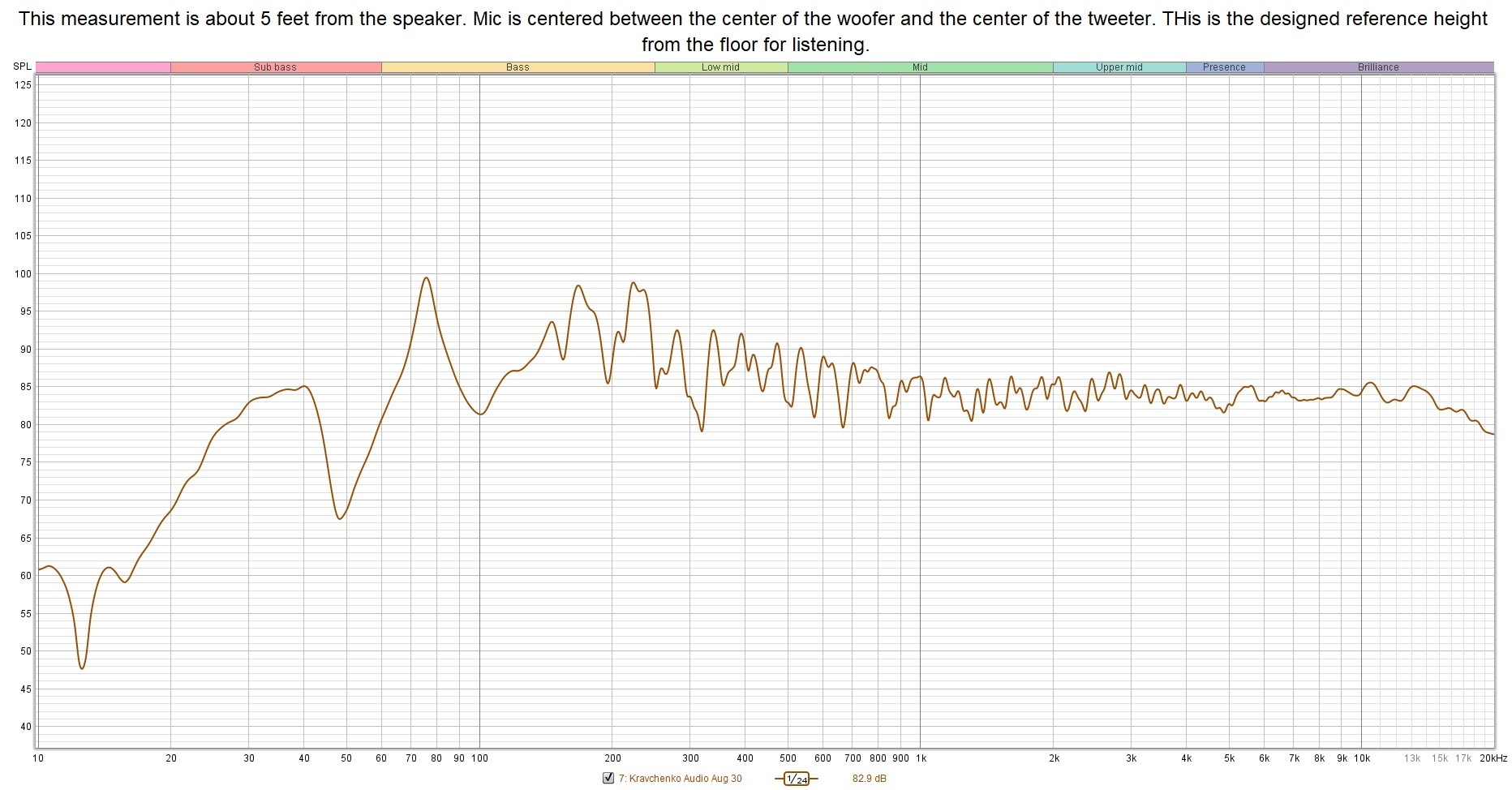

Well belatedly I have a few measurements that I can show to compare a multiple in room measurement via REW and a proper ground plane measurement. Please note that there will be an absence of floor and ceiling bounce effects on the groundplane just as you will be lissing this in a true anechoic chamber measurement.
So to set the measurement up.

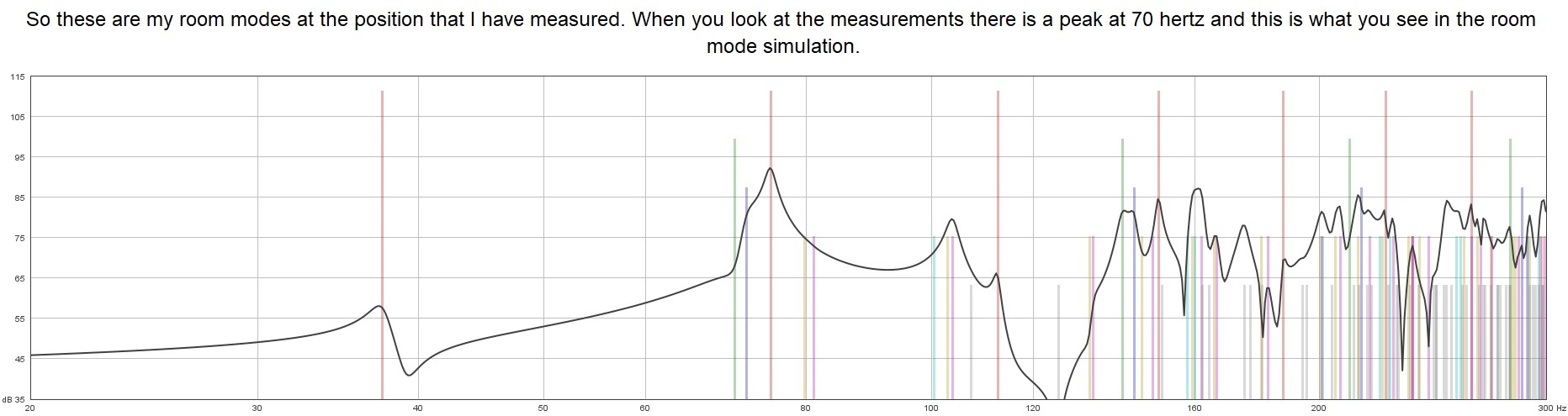

This measurement room is basically 8 feet wide ( 2.5 metres ) 8 feet high and 16 feet long. The loudspeaker is placed at the least modal point in the room. The loudspeaker has a rear firing Passive radiator which was close miced as was the over all response in the front side and this was summed using the math functions available in REW. 25 measurement in 100 mm increments were made from 20mm distance on out. Then I applied a few of the functions available in REW to remove the reflections and sum nearfield and far field measurements.

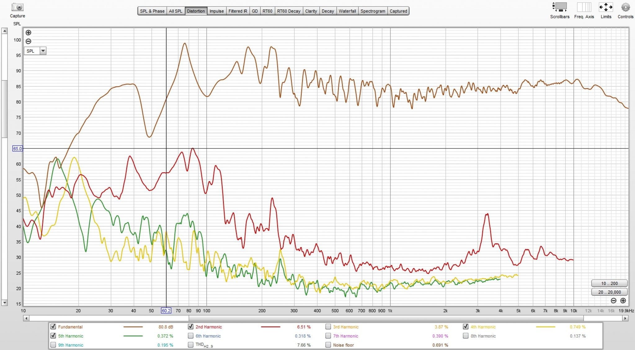

Yes, in this room at this position this is what I measured. It should dive at 45 hertz. Wait for the groundplane measurements.
Ok now outside for recess.

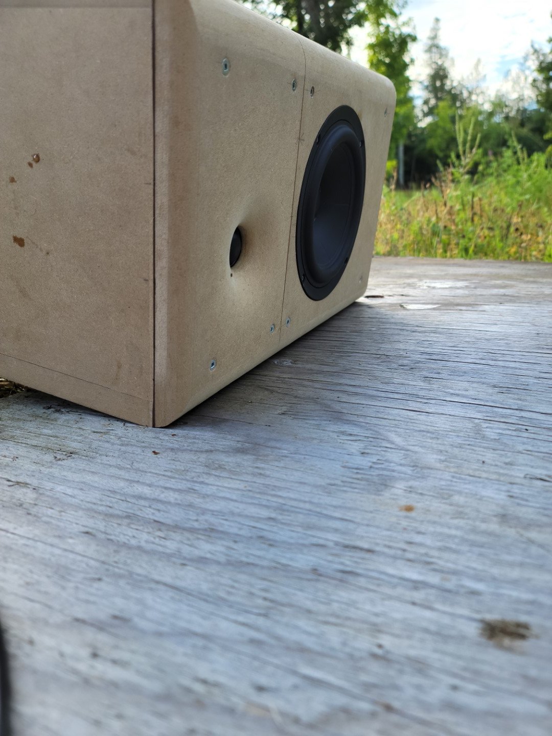

Due to asymmetric tweeter location I could get a slight difference between a vertical orientation and a horizontal orientation. But it was not night and day different. Mic position made more of a difference actually.

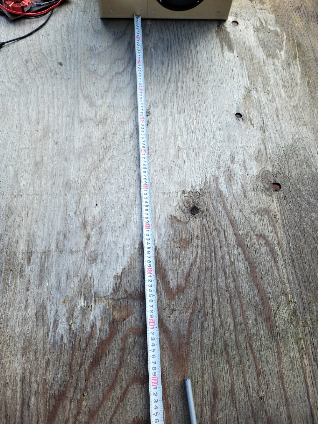

Equivalent of the inside 0.5 metre measurement and I also did the correct 2 metre measurement to simulate a 1 metre 2Pi measurement.

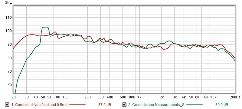

So, what did this get me? Smoothed versus Groundplane measurement?
Have at it men!

Thanks for sharing @Kravchenko_Audio!
Color me impressed that this "beamforming" method can be used indoors so effectively (that wart between 45Hz and 65Hz is VituixCAD's SPL trace not cooperating). One question on your indoor DSB measurement: is it RMS Averaged or Vector Averaged? I've been Vector Averaging mine and have noticed that it makes a difference at lower frequency.

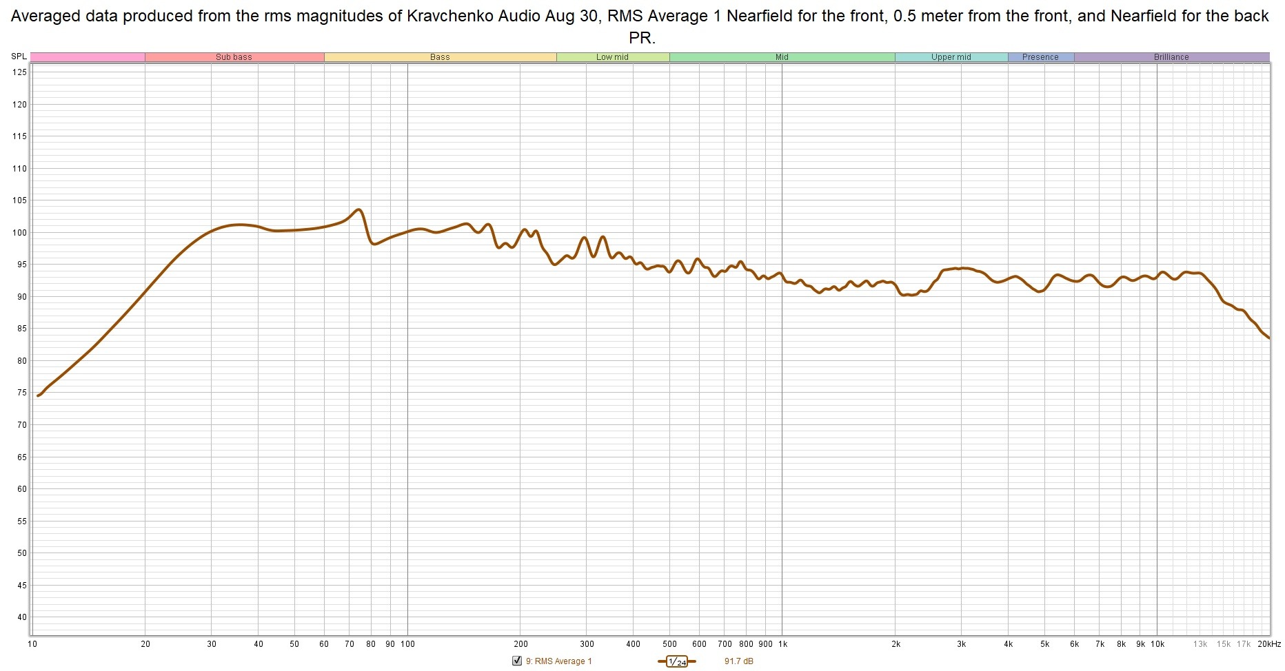

I never mentioned that all the levels were taken at 85 db at the stated distance. So the last graph was 85db groundplane 2 metres. Not normalized from a nearfield measurement.
The measurements were normalized to a common point and them RMS I think. I tried a few different ones. And this was done on the 30 and 31st of August. What I have come to appreciate is that you can get pretty accurate measurements with REW. I never really tried it before. That and the UMIK are a great mix for serious measurement.
There is a lot I am still learning with the software. Old dog needs to learn more tricks I think. Woof er.....

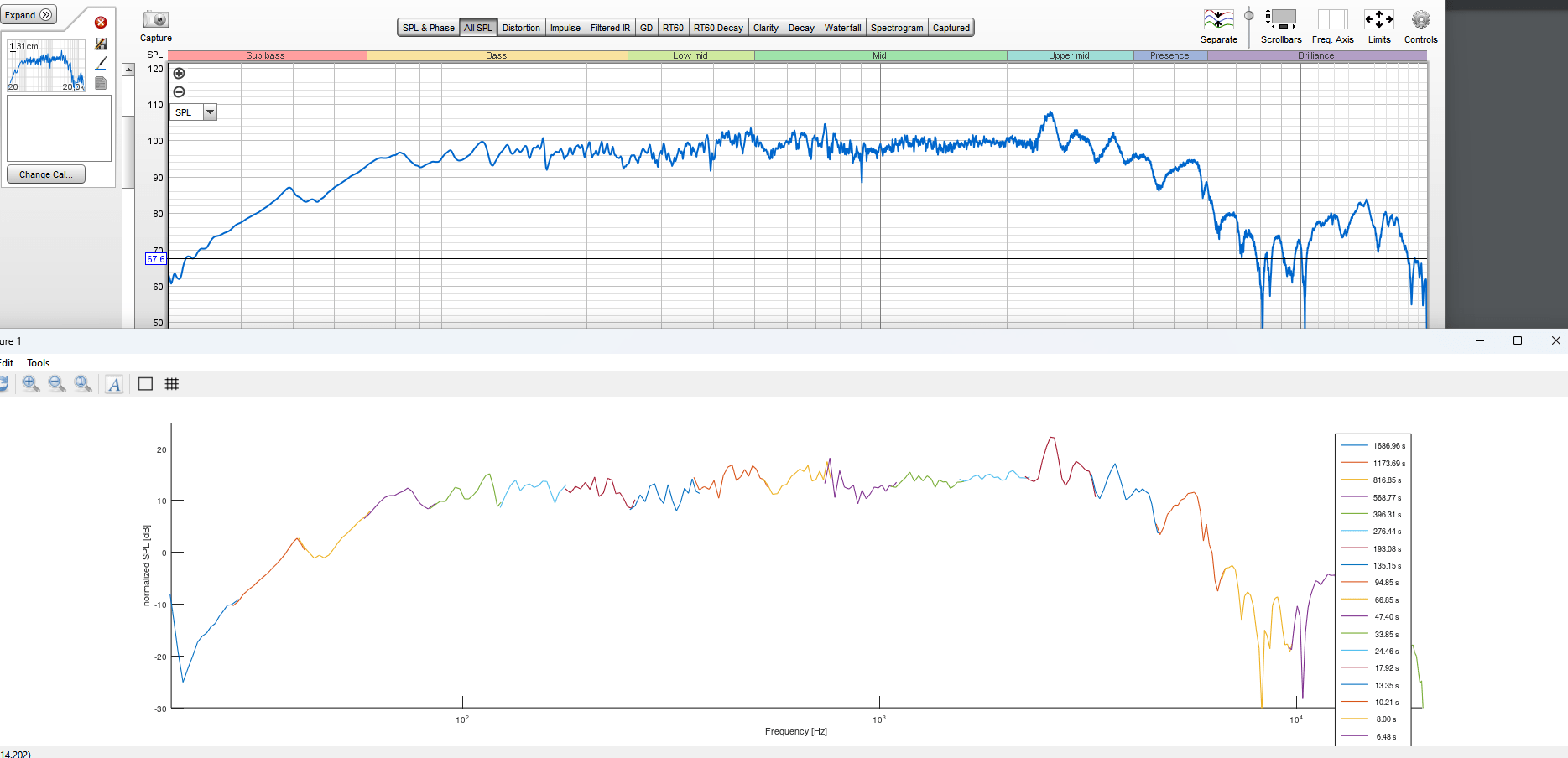

I'm late to the party and am doing a lot of reading up. This old quote got me thinking:
To my untrained eye it seemed that higher frequencies benefit from smaller gates, whereas low frequencies need a large gate to be shown at all in REW.
What if we make this gating adaptive? Small where it can be, large where is has to be? I made a proof-of-principle function in Octave and that resulted in this:

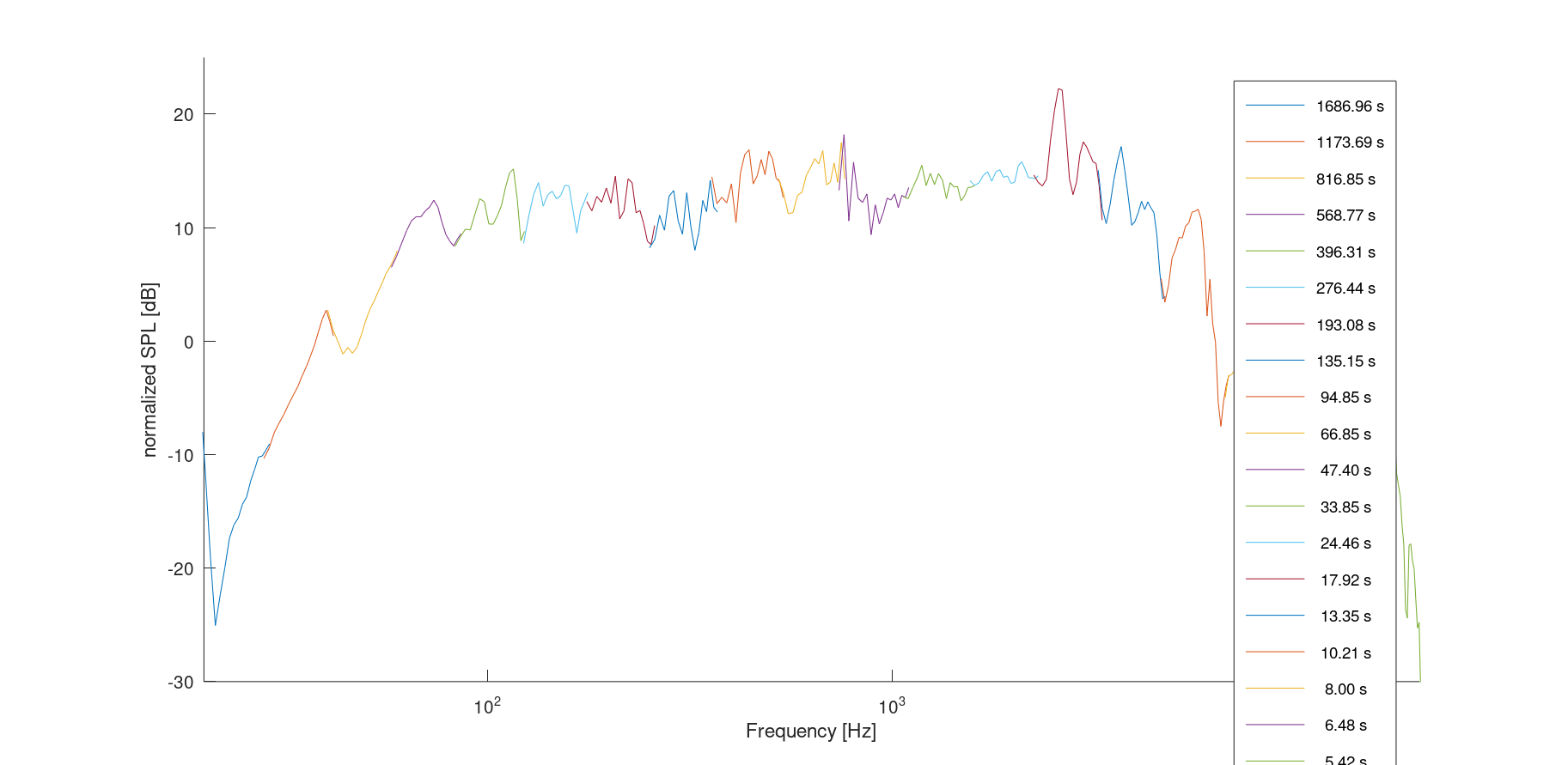

Comparison ungated REW vs adaptive gating:
Adaptive gating:
ps. The legend says seconds; that should of course be milliseconds.
I would think that one would still want to gate at HFs since it's so reliable and easy, but getting LF resolution has always been an issue. This technique may well be an answer. Given that then wouldn't a few point widely spaced be the best approach? Blended into a gated HF response.

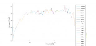

Adaptive gating:

It is true that lower frequencies need a larger gate to provide acceptable resolution, however, in a reflective (i.e. a room) or hemi-anechoic (i.e. outside) environment, the reflections that need to be gated out of the measurement are full bandwidth and arrive to the microphone in the single-digit millisecond range. In other words, any reflection that is corrupting the high frequency will be doing the same to the low.
That said, you do appear to have less "grass" in your adaptive gating results, so it may be a useful method to apply in concert with the other methods discussed in this thread.

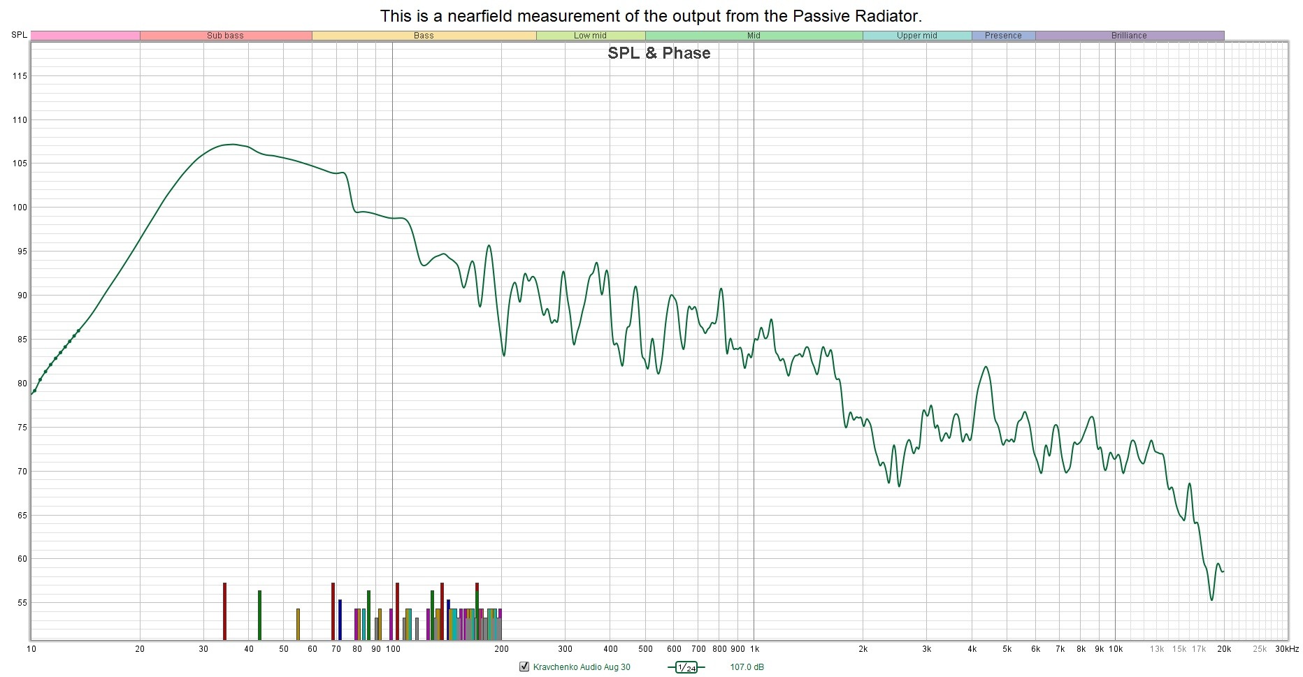

I'm currently working on a 3-way speaker project that requires a crossover from the bass drivers to the midrange driver around 250Hz. Unfortunately, the speaker is quite large and not easy to haul around inside/outside or even lift much to get longer gate windows.
The measurement files currently being utilized for crossover development were prepared using merged far-field (gates 4.0ms) + near-field (SPL-adjusted and Diffraction adjusted using VituixCAD Diffraction simulator). A crossover has been developed using those files, but I need to verify that it's working properly. I did take the speaker to a local community center, and got it off the ground to improve gate time from 4ms to 7ms (picture below) - but even 7ms isn't enough to verify performance in the 100-500hz range. The speakers are not easy to move - they weigh about 240lbs each and are approximately 64" tall. This is where I'm hoping the process being discussed in this thread could help.
