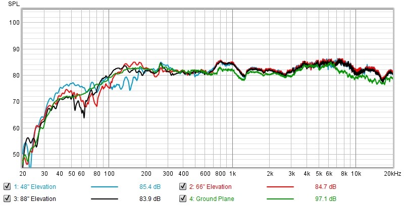

Another update:
Based on the suggestion by Kravchenko_Audio, I did some more tests using the same speaker and microphone. This time to compare the effects of speaker elevation on the data, and this method to ground plane.
Blue, red, and black are all 15 data points taken from 36" away from the speaker out to 84" at (approximate) elevations of 48", 66", and 88" respectively. Green is ground plane in my driveway with the microphone 36" away from the speaker. Nothing is smoothed or IR windowed, and alignment of ground plane measurement is eyeballed.
I think for the next test, I want to do some more investigation into spacing of data points and see what more distance does.

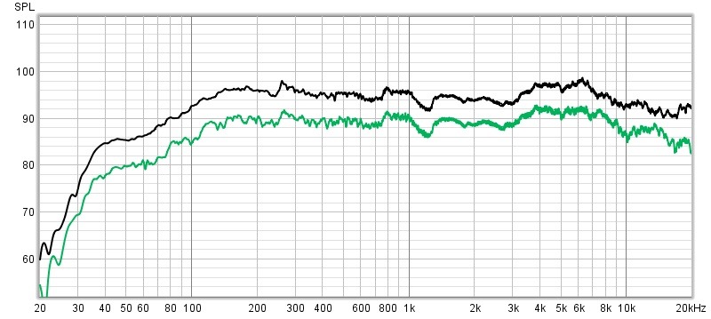

Also, a bonus indoor measurement with this method:
This is only 29 data points, 30" of elevation, and a whole lot of very nearby reflective surfaces (and a different speaker than the above graph), but I think there is potential.
Any observations or suggestions for ways to improve this method are welcome!

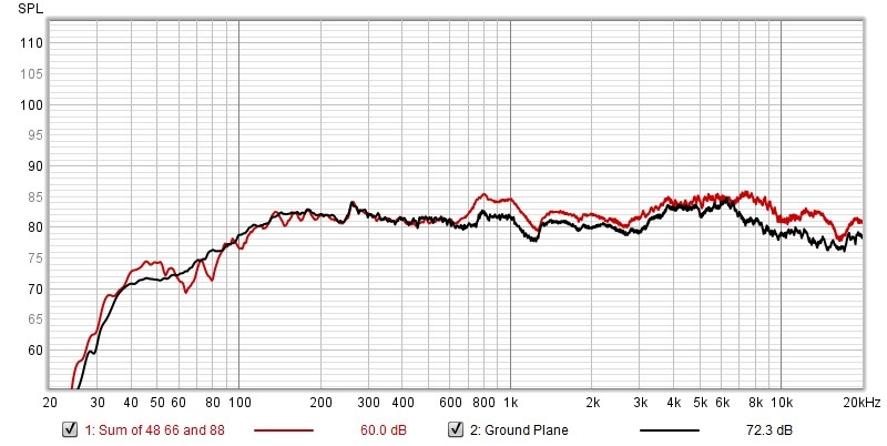

Another update:
Red is the sum of the all 45 data points from the 48", 66", and 88" elevation measurements, and black is ground plane. And as always, no smoothing or windowing has been applied. I'm not sure if this suggests that a collection of heights is useful, but it does reinforce to me that more data points give a better result.

Regarding the control, your ground plane measurement. Are you tilting the speaker box forward about 10 degree's? Mic is 2 metres away from the baffle of the loudspeaker? The resolution is great. From papers that I have you can use a ground plane up to 13Khertz so this is a very useful method often overlooked. The low end resolution is limited by surrounding barriers. I find the discrepancy from 630 hertz to about 1200 hertz interesting. Could be floor or ceiling bounce.Another update:

So now you are comparing an acknowledged equivalent of an anechoic test to the multiple point test. My question is how many test points are required to remove those areas that are different?

I was under the impression that that was something that was done if you wanted results at higher frequency, so since I was only thinking about comparing below a couple hundred hertz I didn't tilt the box. I can try another test with the box tilted and see what kind of a difference it makes.Are you tilting the speaker box forward about 10 degree's?
I tried 6 feet at first since that was double what I was using for the "free field" distance, but 3 feet ended up giving a cleaner result.Mic is 2 metres away from the baffle of the loudspeaker?

I was thinking that the 630-1200Hz discrepancy may be the result of the larger virtual baffle from the ground reflection, so I ran a simulation of what the baffle-step might look like between free field and ground plane for the speaker I was using, and there's only about a 1dB difference... so back to the drawing board to figure out what's causing that.

That is the big question! I'm quite pleased with how close they track down to 200Hz, but worried that the long wavelengths below that will make getting lower easy. Since there needs to be enough randomization between reflections in the data points, it might be possible to apply some simple math/geometry to come up with ballpark number of what would be needed to get full range. Or at least down to 100Hz.
