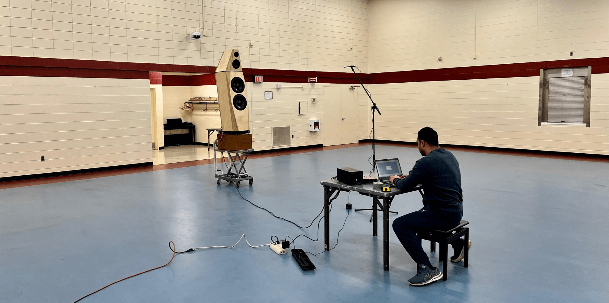

Wow - thank you all for responding.
What is not obvious from the picture included is that the ceiling above the DUT is substantially higher than the ceiling above me - and the back wall was not too much further behind me either. This was the best location I could go with to maximize reflection-free time.
I do regret missing the opportunity to take ground-plane measurements however. I've used this method plenty in the past to obtain below 100hz measurement - but I guess I don't know it well enough to be using it above 100hz. My concern has always been whether the "reflected image" of the speaker has the impact of effectively doubling baffle height (if standing) or doubling baffle width (if the speaker is on its side). I don't know if that would impact below 1.0Khz measurements. One issue with this speaker is that the top hat (mid+tweeter) is separated from the bass cabinet (i.e. it sits on top), and due to its triangular geometry, it cannot be laid on its side (without toppling the top over). I guess I could have strapped it to the bass cabinet for the sake of taking measurements. Damn! I won't get a chance to take it back there anytime soon :-(.

The best position would be in the length of the room and/or at least in the middle of the room.What is not obvious from the picture included is that the ceiling above the DUT is substantially higher than the ceiling above me - and the back wall was not too much further behind me either. This was the best location I could go with to maximize reflection-free time.
It's all about maximizing the distance to any close walls.
So basically where the mic is at this point.
Don't forget that the back wall reflection also counts, as well as the back wall reflection behind the microphone.
Getting the speaker up as high as possible and move yourself plus your desk somewhere in the corner of the room or in this case on an angle compared to the speaker or in the doorway/entrance.
If you have a (crude) floor-plan, that would be a little easier to explain. 🙂
In some cases placing the speaker/source ani-parallel to the walls really helps as well.

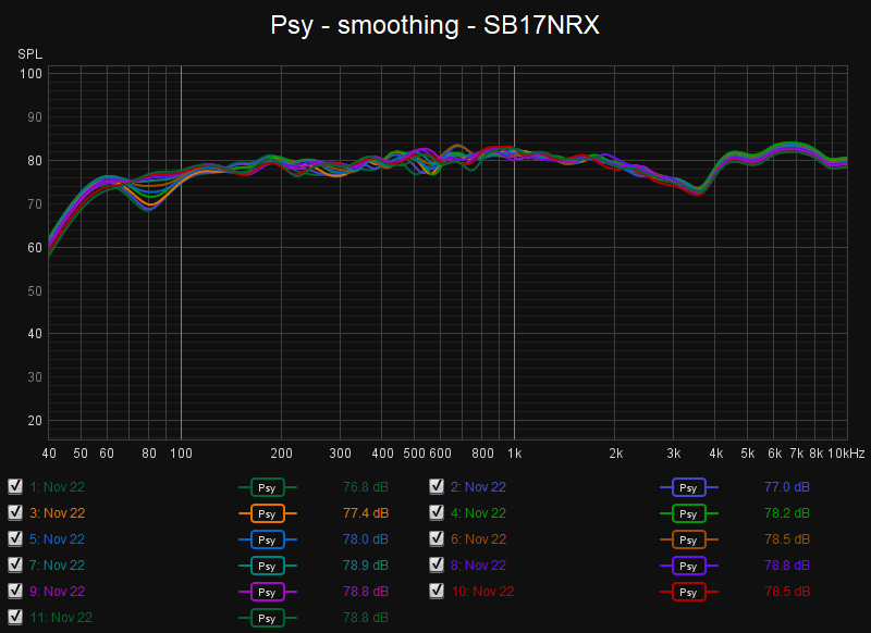

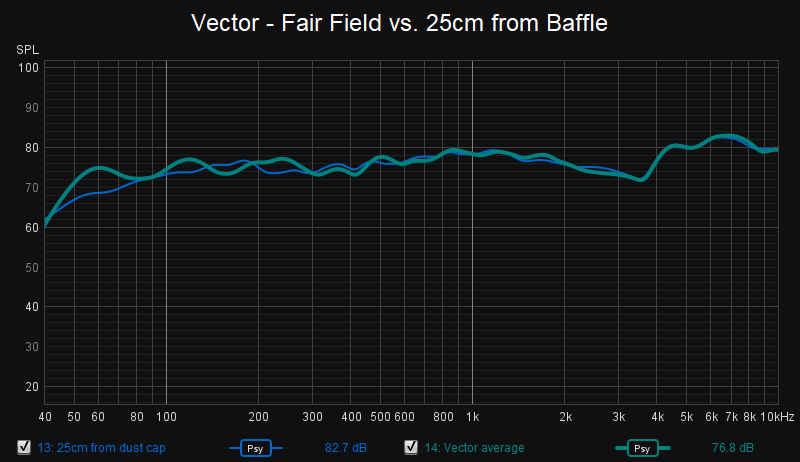

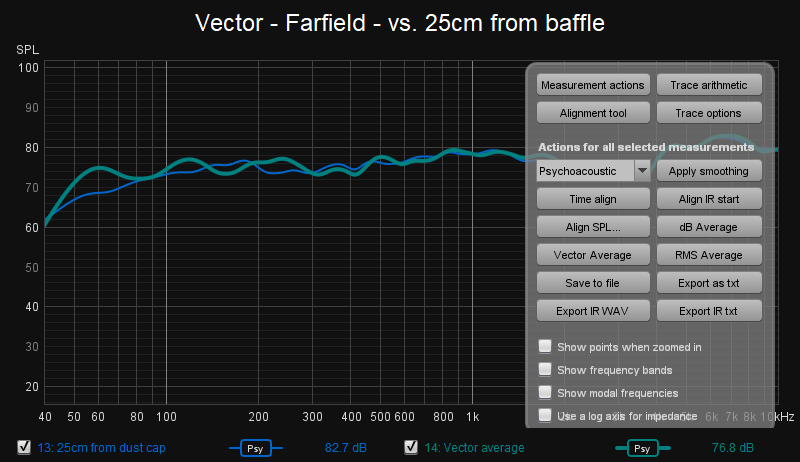

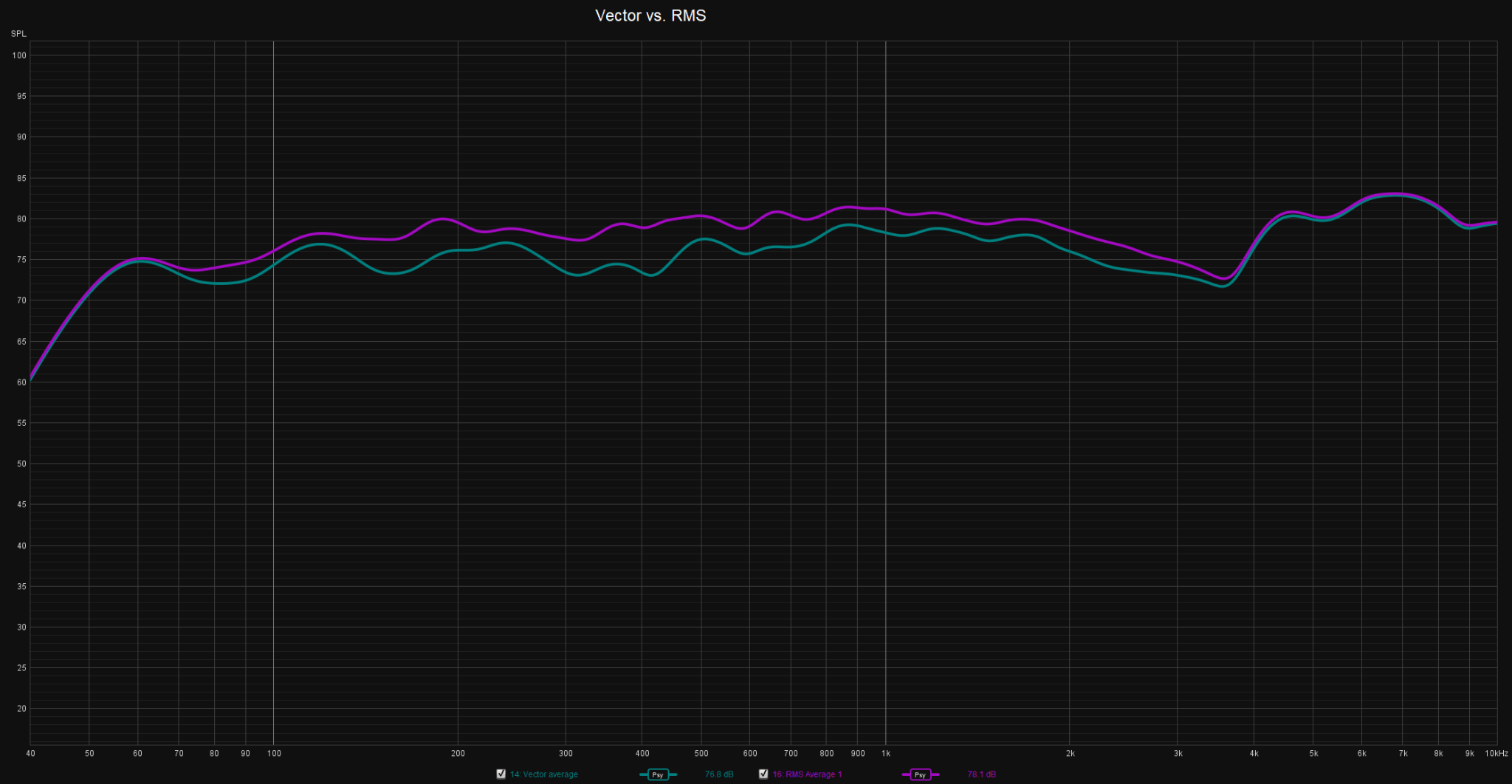

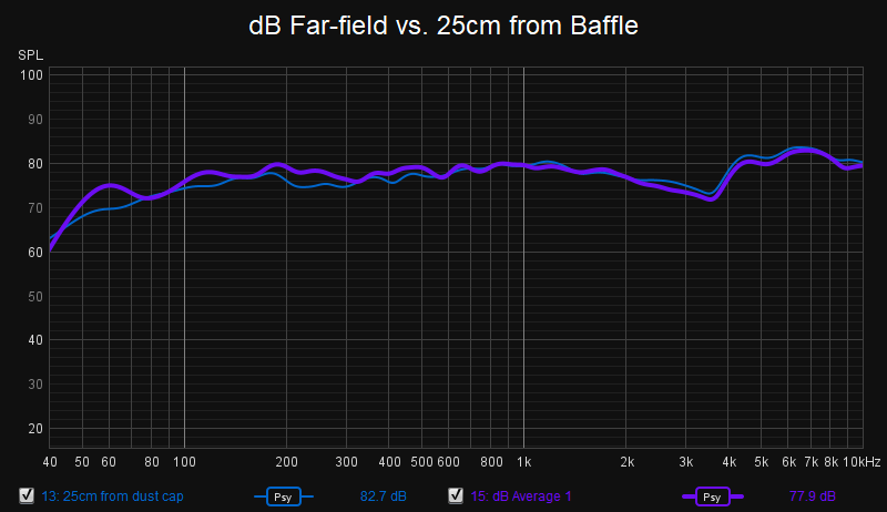

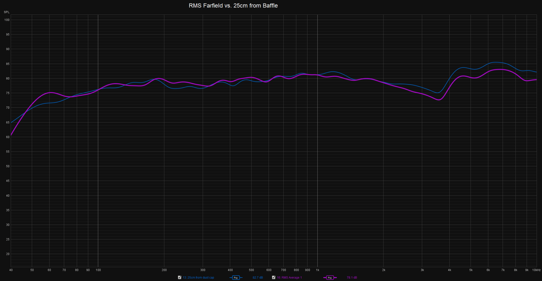

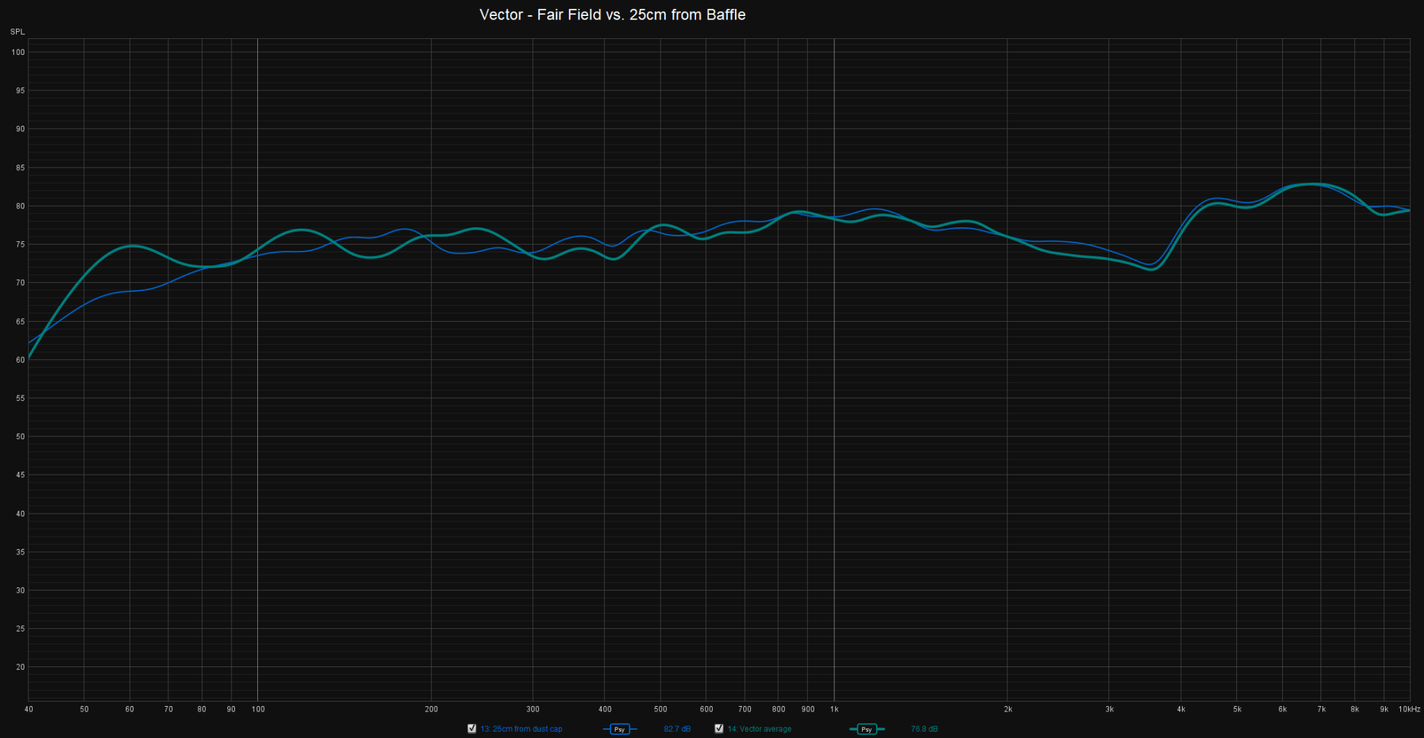

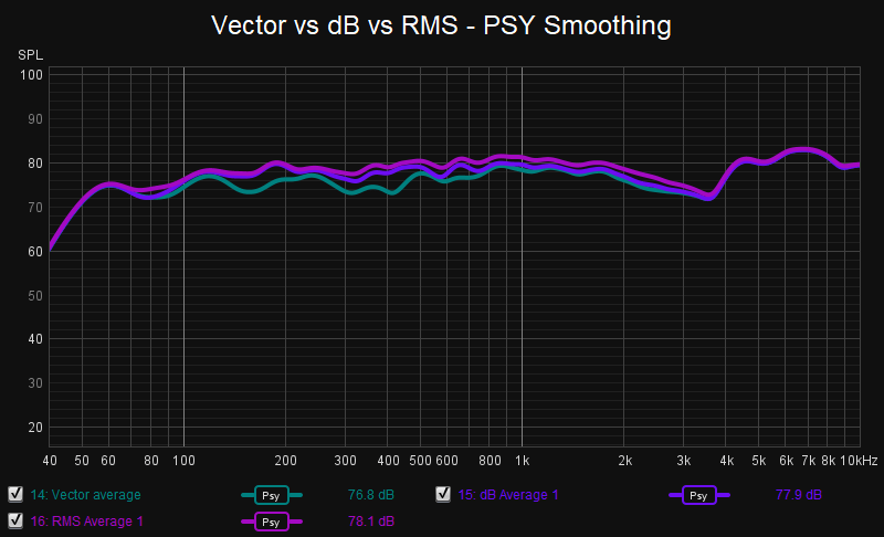

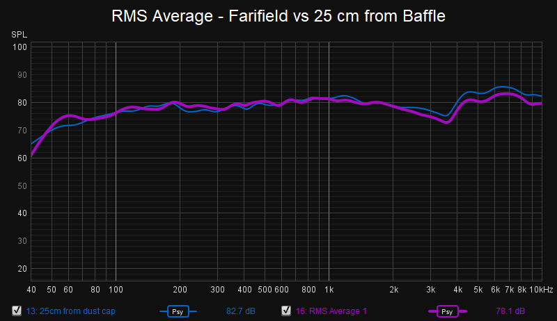

Just out of curiosity, I took some measurements of an SB-Acoustics NXR17 midwoofer in s sealed cabinet - no crossover.
Typical bookshelf-size cabinet. I took measurements starting at a distance of 90cm - and went further away from the speaker by 10cm for each measurement thereafter - and took 12 measurements (to end at approximately 2 meters from the woofer - 90cm + 110cm = 200cm). Have not built a slide yet - just used a laser level and used a fixed mic height - so the mic was on the same horizontal and vertical axis for each measurement.
1) I then "Align SLP" - arbitrarily used 80db at 1Khz.
2) Took vector average
3) Took dB average
4) Took RMS Average
5) Measured 1cm from woofer dust cap
6) Measured 25cm from baffle
Psychoacoustics smoothing was applied for purpose of making it easier to read.
The thinking behind including 25cm from baffle measurement was to get a semi-near-field measurement where the ratio of direct to reflected sound was significant, and not too close (e.g. 5mm or 10mm from dust capt) and possibly still capture baffle-step/diffraction.
The 10db scale makes it seem like an artificially close result.
The RMS average seems to be a better match than the vector.
3) Took dB average
4) Took RMS Average

What I do is take about 20 measurements in rapid succession. I lat a tape measure on the floor, and move the mic stand in even increments. What seems to happen using the math functions is a removal of the echos. I have had good correlation with groundplane measurement down to 30 hertz this way. The only difference I have had is a broad suck out near where you would usually have a floor and ceiling bounce in-fill. The correlation is plenty close enough to do serious work.
