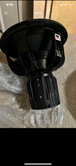

@weltersys The neodymium series of car speakers have motors that deep. Go see Sundown for reference. The remark of "like car audio" is funny though.
@weltersys
I mean looks like physically with a monster protruding magnet structure.
Not that they are alikes copies with same cone,surround and magnet structure
