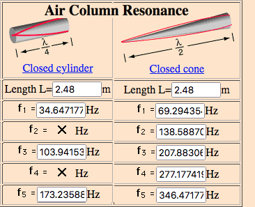

It's response would be different, my guess it would have more pronounced odd order resonances that would ring for a longer time period.
At minimum, a reshape/resize of the exit would be required to make the response similar.

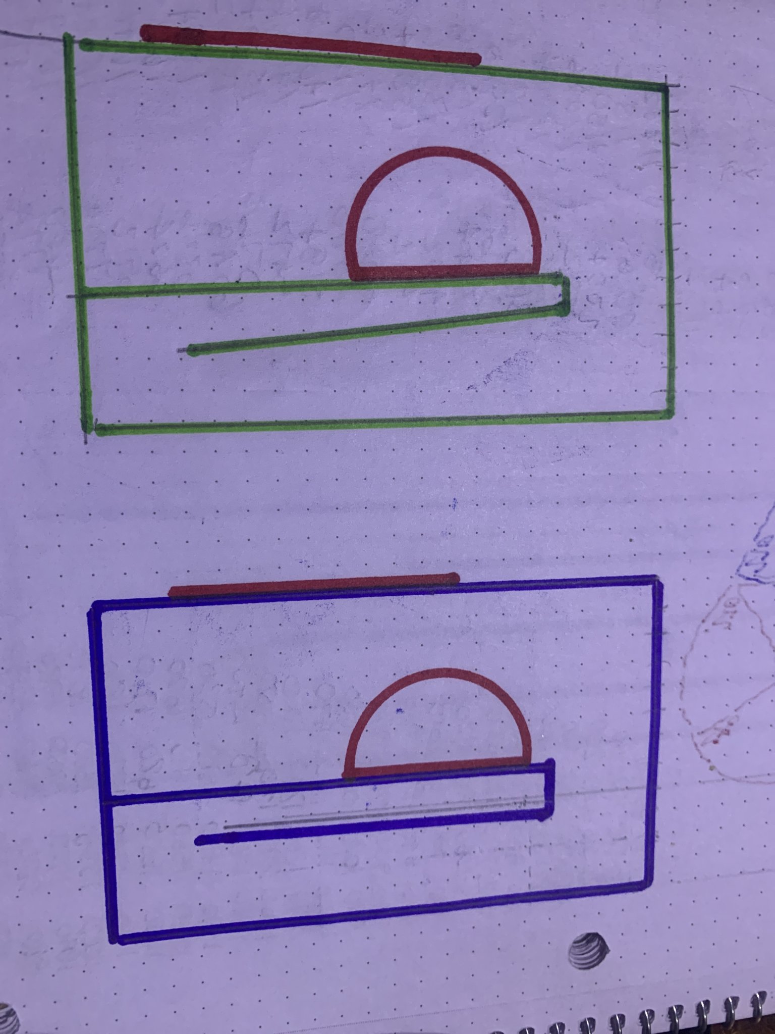

Does the vibrating air really get messed up so terribly dufferent if you change the csa at the ends of sections instead of taper it throughout? I’m sure someone can find decent results either way
If I follow, Danley once made a point of backing me up when I stated that a bend must always be expanding or it will act as a low pass filter, though sometimes referred to (in error?) as bass trap.

So in a TH bends must expand ...can't be 90 degree turns like in TL's...otherwise what you gain you loose getting less bass out ....
Holly frijoles batman!!
What about the turns in all my tapered pipes? There’s a bump in the crossectional area in each corner full of air that’s just ‘stuck’ there essentially. But theres a ‘smooth decrease’ in the pipe shape through the turn if you ignore those and just measure off that tilted panel
