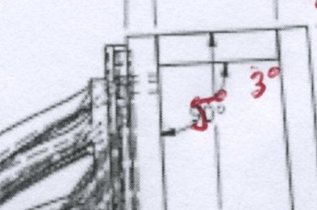

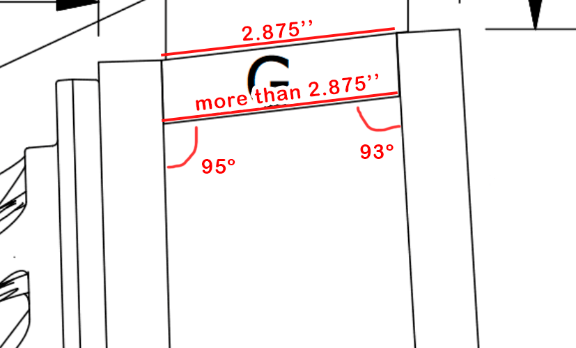

Hello. i have some more noob questions 🙄
1- I'm confused about the G angles in particular. According to the plans in posts #478 and #487, I'm attaching an image with a question.

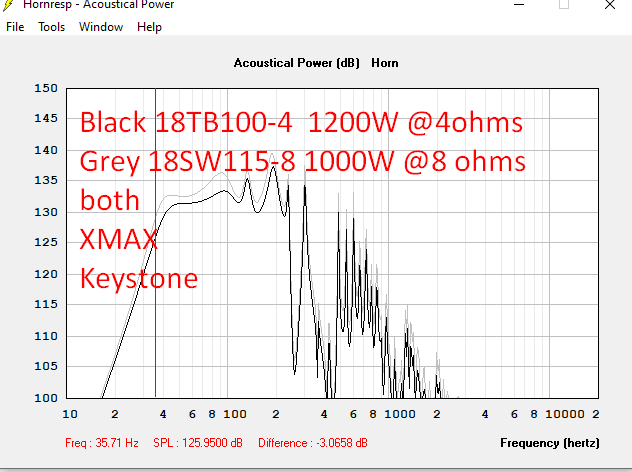

The interesting midway is B&C 18TBW100-4 and RCF LF18X451.
The difference in output is there, and is usually more feasible than more bins, because of drivers, wood, work, transport, amps ...
4Ohm drivers often have more motor force. So if it doesn't get more expensive on the amp side, 4Ohm is better. Definitely at B&C.

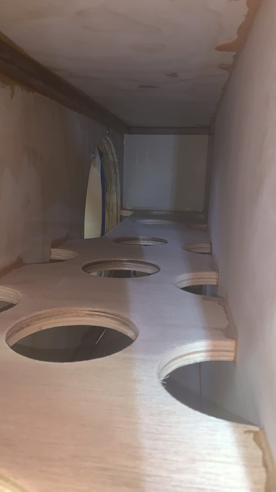

NICE bracing!You can buy 3/4” x 3/4” x 6 foot pieces of hardwood at Home Depot for cheap.
Black is the 18TBW100... i miss the W in the chart below... Gezzzz.... too many hits on the PIPE!! lol !!The interesting midway is B&C 18TBW100-4 and RCF LF18X451.

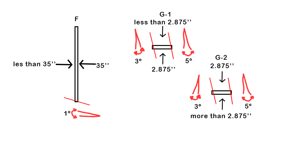

The bottom of part "F" is 89 degrees.I'm confused about the G angles in particular. According to the plans in posts #478 and #487, I'm attaching an image with a question.
89 +1 =90 degrees, like a carpenter's square.
The front of "G" is a 5 degree angle, the back of "G" is 3 degrees as shown in post #478.
so it's like this?
Not for the right side, 90-3=87 (not 93).so it's like this?
Read up on complementary and supplementary angles, angles that add up to 90 degrees and 180 degrees respectively.
When building, compare any angle cuts you make (use scrap wood..) to a full size drawing to confirm they are correct.
Draw the whole thing out, to scale, on a piece of 1/4” (or 1/8”) plywood. And save the template. Then you can check your angles as they come off the table saw, and for proper fit before assembly. And get the same measurements even years later when you make more.

Cut to all the angles mentioned. It's a little tedious, but it's correct. I would go with what @wg_ski said about making a template first.
