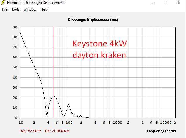

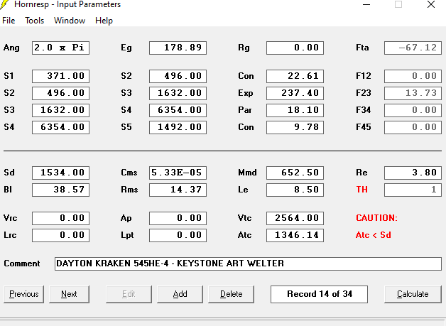

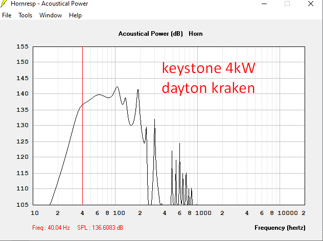

Yes im lazy. Anyone modeled the dayton kraken in a keystone?
Thanks maxolini. Looks like a viable candidate at $600. Would this be too loud for my living room? Lol
Not if you have sufficient power (preferably class A/B) for +20-30 dB dynamic headroom recordings........

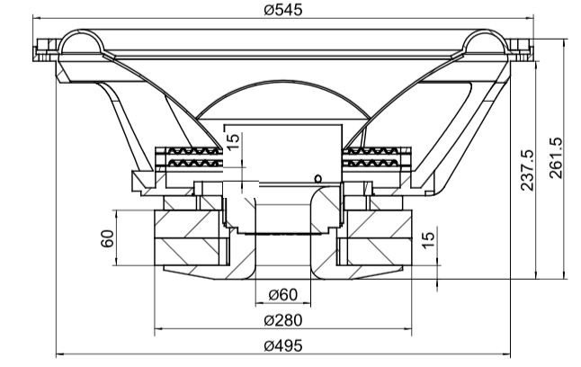

Note that the simulation in #1783 is using 178.89 volts.Thanks maxolini. Looks like a viable candidate at $600.
That is around 8400watts (not 4kW) at the impedance minima near 3.8 ohms, 8k into a nominal 4 ohm load.
The Dayton HTS 525HE-4 is only rated for 2000w AES426B.
I doubt the coil would withstand 178.89 volts in the Keystone for much more than the time to read this sentence.

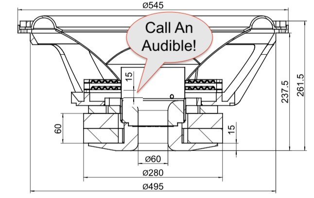

Also, it's "Audible over excursion protection system" might be the spider crashing against the "protector".
If the tech drawing is correct, does not seem to be 21mm excursion possible before parts contact.
I'd think around 2000 watts (-6dB) would be safe, but would be interested in actual results.
Art
What watt at what frequency and impedance?I set the watts till I have 21 mm Xmax
The driver is 4, not 8 ohms, and 4kW is double it's 2kW rating, and since it's 4 ohms, 179 volts is ~8kW, unless the impedance minima is above 4 ohms.

Good catch. From the couple videos of this driver's excrusion online, it certainly looks more like 15mm. Also, it looks like the group delay spike comes in much earlier at 100hz limiting usable bandwidth. I do have a some 12s that might work. Did you ever try reverse mounting one of the 12s? I read that this helps keep cone travel linear at xmax, reducing distortion. I don't understand this though.If the tech drawing is correct, does not seem to be 21mm excursion possible before parts contact.

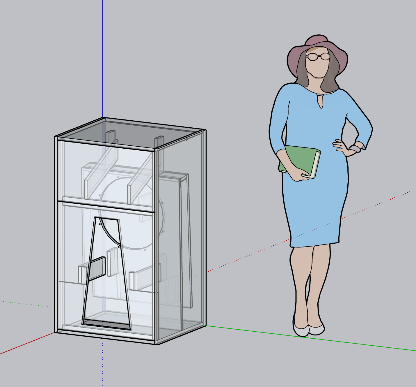

Excited to build my first pair of Keystone Subs. I modeled the speaker in SketchUp with all the parts. I ended up with a slightly different "I - Horn Brace" and "G - Horn Top" shapes. If anyone has time to review the model and double check my work, that would be hugely appreciated. Planning to flatten the shapes and arrange them on 4x8 "sheets" for a CNC cut this week.
I'm considering adding 1/8" deep grooves in "A - Sides" where "F", "G", "H" go and widening those by 1/4" to slot into the grooves. Any suggestions / concerns before making these modifications?
Keystone SketchUp Link
The dado slots shouldn't be a concern, and should make assembly easier.Any suggestions / concerns before making these modifications?
The usual concern is a snug fit, but not too tight- definitely try a dry fit before opening the glue.
