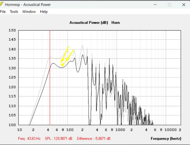

Keystone - GREY:BC18SW115-4 BLACK:Dayton Audio Pro 18-8
Grey is BC18SW115, black Dayton Pro 18. Please note I was also only able to give the dayton's around a 1000w@8ohm before it's EG exceeded xmax. I think there are better options if you're looking for budget drivers.

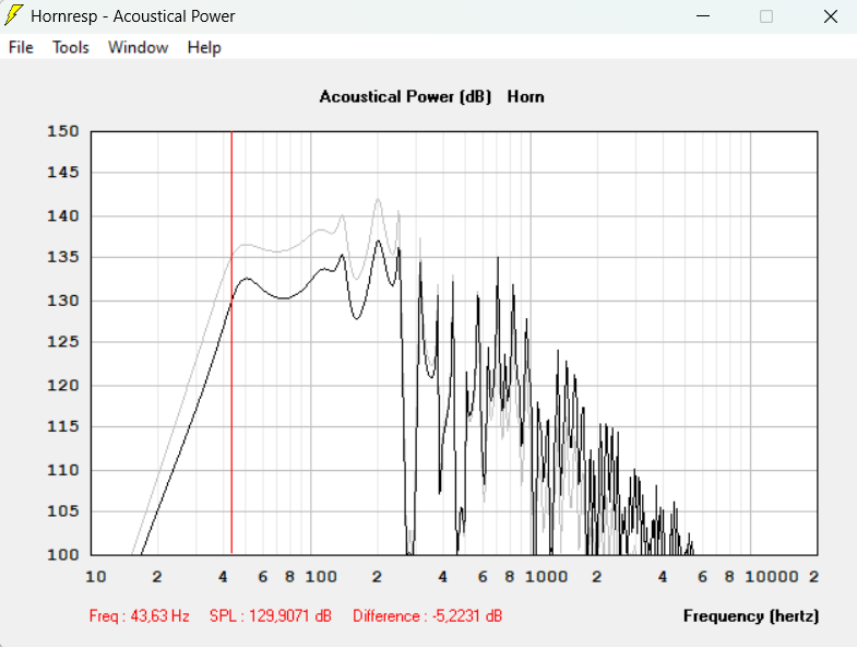

When does this dip become an area of concern? iOw, When is it a sign that the enclosure is too big, or the shape of the resonator isn’t ideal for the driver when not being held in the pressure of a resonace above and below that area?

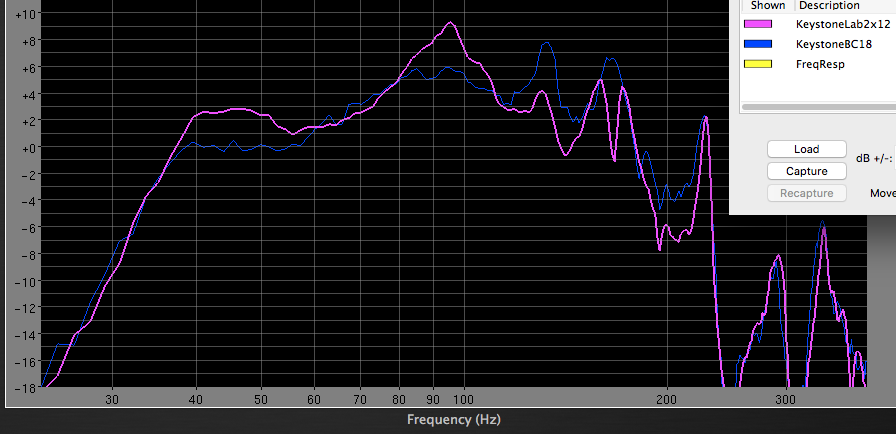

It becomes a concern when the driver runs out of excursion or the amp runs out of voltage.
"Too big?" The Keystone cant be cut down in width and fit two x LAB 12.

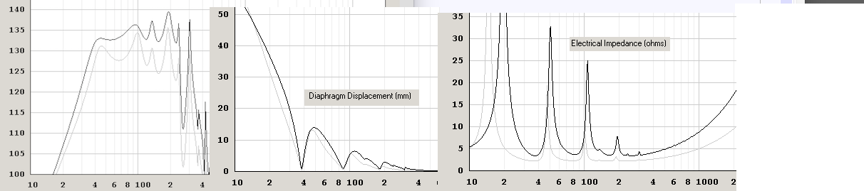

2xLAB12 : BCSW18SW115.png
The above Hornresp simulation compares the 2xLAB12 at 13mm excursion to the BC18SW115 at 14mm, the 2x12 has a -4dB "saddle".

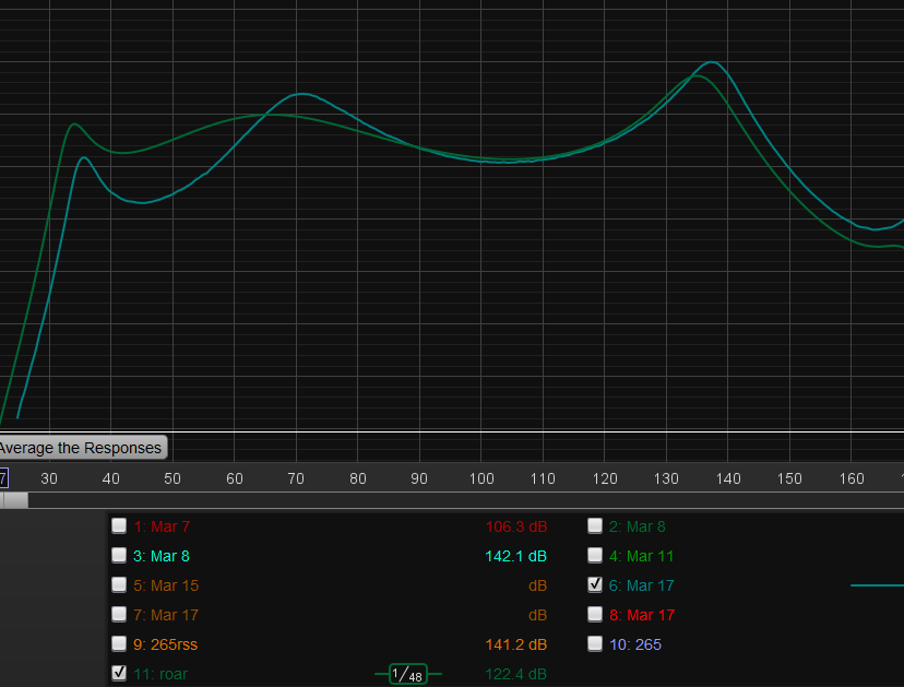

At 2 meters, the measured ground plane response looks different, the saddle is only -2dB, but the 95Hz peak is +6dB over 40Hz compared to +4 in the sim :
Keystone 2xLAB 12:18SW115.png

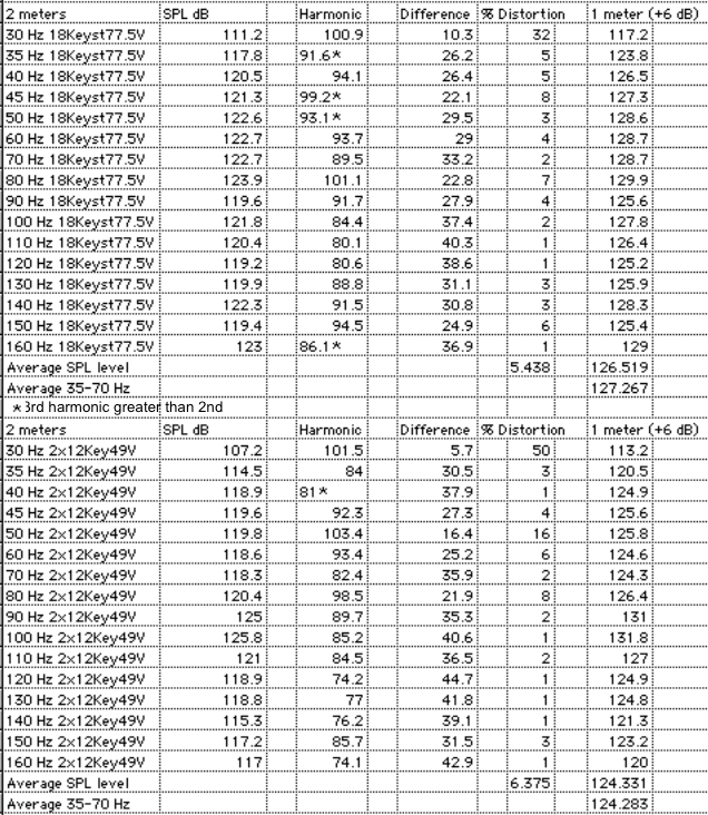

The excursion is pretty close to prediction, as confirmed by actual measurements and distortion tests:
Anyway, sims of the Keystone are close, but don't expect the frequency response to be exactly as predicted, Hornresp can't sim the exit shape.

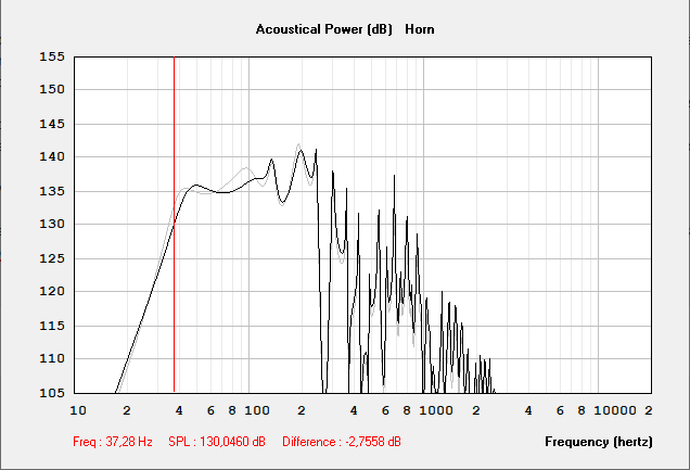

However, if you're still looking for a budget options; The best I could find available and in my opinion could be of interest to you is the Eighteen Sound 18LW2400-4. Thomann sells it for €398,- around here. Here's the simulation compared to the BC18SW115.
Black: Eighteen Sound 18LW2400-4
Grey: BC18SW115-4
It's the closest thing I have found that comes close to the BC18SW115 that costs about €125,- less. It will also draw alot less power, which could be a plus for you.
In the end though, even though a ~-2,5dB diffrence might not look like alot, consider that it will be about 0.735 the loudness of the B&C at 35-45hz with a similair dip around 80-100hz. Which for me are pretty crucial frequency ranges for the music I play. For this reason and the ones I stated above, the €125,- I would save is just not worth the dip in perfomance. Again, this could be different for you.

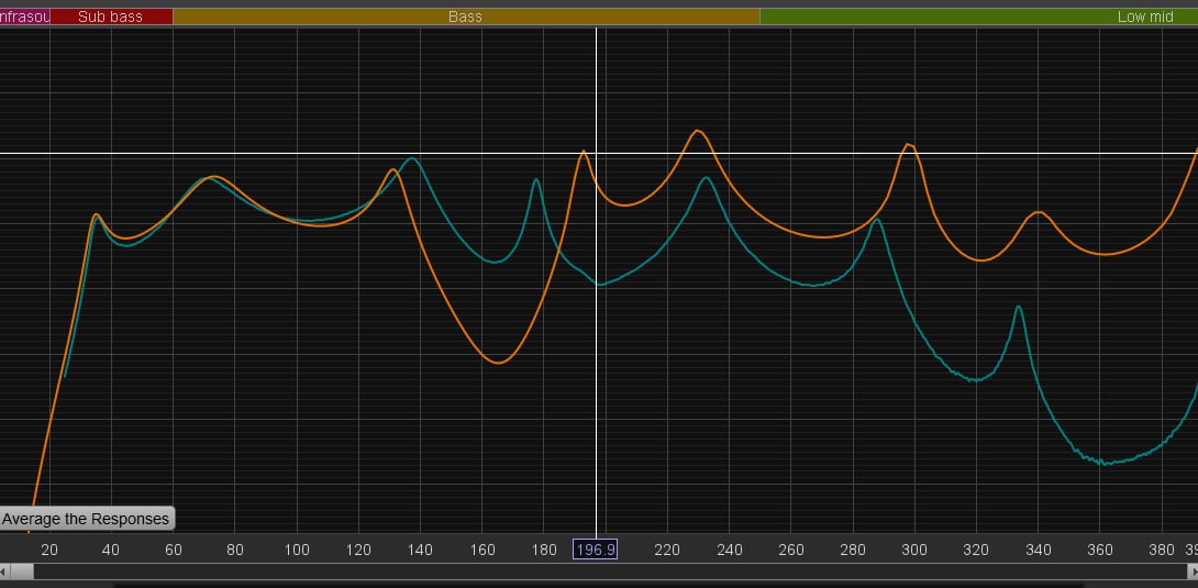

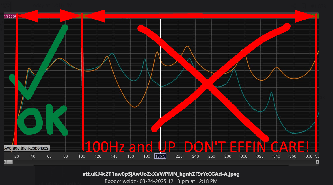

not necessarily.... (but not the question either). assume its all real and needs an explanation regarding the box size and TS parameters?
@maxolini I thought better tidy up my simulation and get it closer to the details (blue is measurement with a filter kicking in on the amp near 200hz )
The dip at the full wavelength isn’t as deep and you can see this if you describe the driver position offset more or less as well. This stuff is tricky
