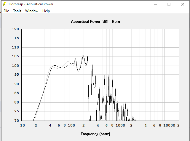

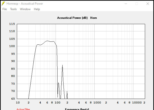

I am looking to build a keystone and right now I am trying to figure out if I can justify the price difference between the 18SW115-4(€525,-) and the 18TBX100-4(€285,-).

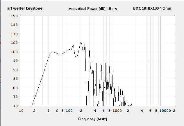

I copied the hornresp inputs @Djim provided in post #130 as well as I could and put in the driver specs for the 18TBX100-4. The results are as follows.
Here compared to the SW115
A difference of +2,25DB for the sw115's in the 90hz range is the highest I could find. But seems like in general they mostly seem to outperform in the 75-100hz range with an average difference of +1db sloping to +2db in the 85-95hz range.
I've seen some people asking about these in the thread, so if my inputs are correct consider this the sim of the 18TBX100-4 drivers in the keystone. I hope someone can confirm I did everything right. As I read these results I am still kind of unsure. Let me know what you guys think!

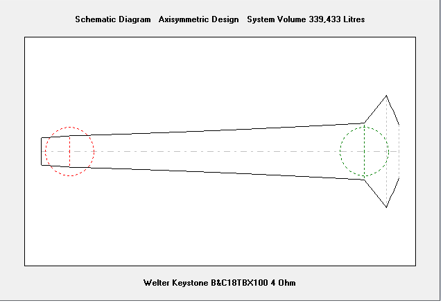

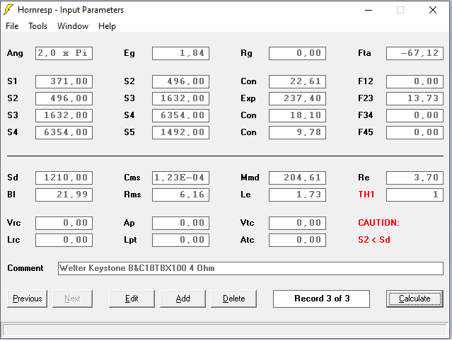

Here's (hopefully all) my inputs for the sim. If anything else is needed to confirm the correct inputs let me know and I will update.

Depends what amp you got for it. The 18SW115 should be easily doung +2dB across the band, but you have to have the signal for it. Now it is not looking like much difference. It would be more interesting if you compared appropriate amount of bins, let's say 4 versus 3. Whole bins price, logistics of these, amp channels needed etc. Then you be the judge if ot is worth or not.
It depends on the deal. "Rarely" The SW and DS speakers can be found cheaper. Or there is middle ground of TBW series.
It all depends...

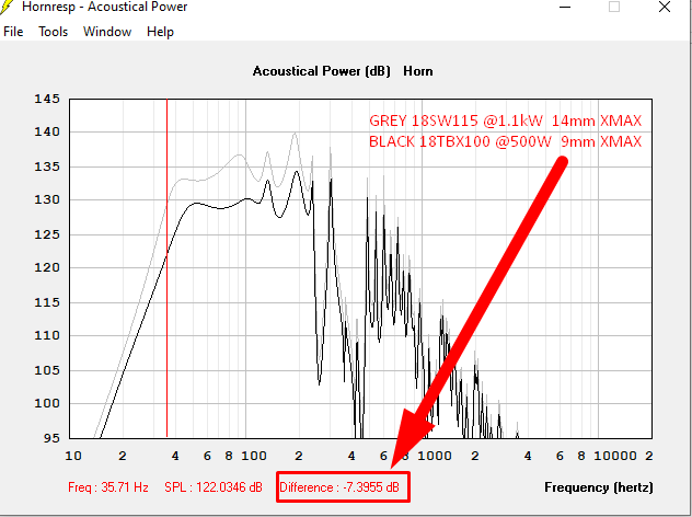

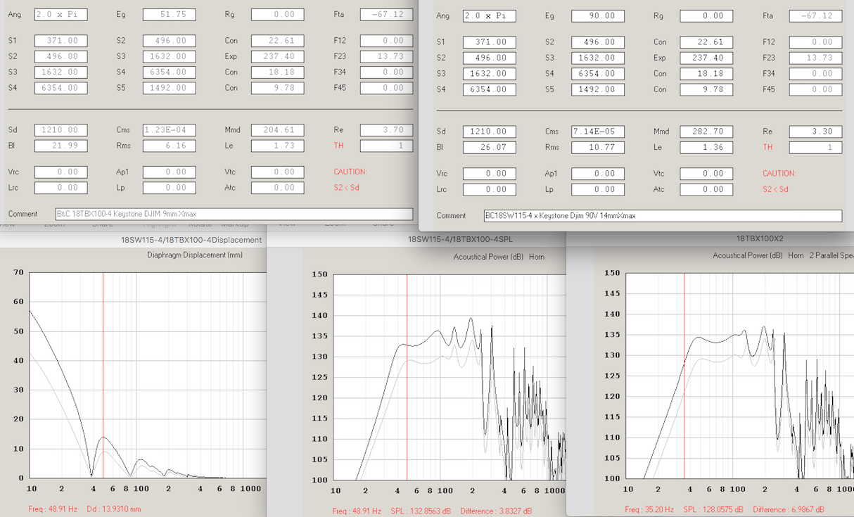

The 18TBX simmed 500W reach 9mm xmax
the 18SW115 simmed 1.1kW reach14mm xmax
and if you see the graphs
there is almost 8dB variation between the 2

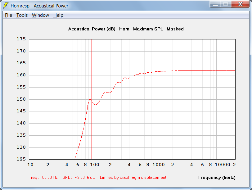

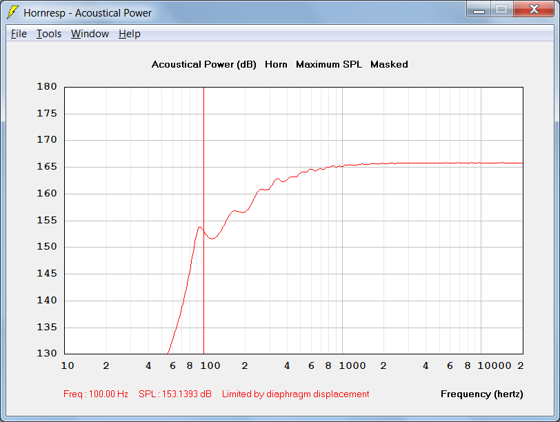

If X1 = 9 mm and X2 = 14 mm then the difference will be 20 * Log10(X2 / X1) = 20 * Log10(14 / 9) = 3.8377 dB
This can be confirmed using the Hornresp Maximum SPL tool. The default record was used, with resonances masked.
The first chart is for Xmax = 9mm and the second chart is for Xmax =14 mm.
The sample was taken at 100 Hz but the difference is the same at any frequency.
153.1393 - 149.3016 = 3.8377 dB
So why HR shows 7.x difference between the 2 drivers in the screen comparison I posted
Check the diaphragm displacement for each driver at the 35.71 Hz sample frequency.
I don't know exactly what your designs are but I am guessing that the displacement for the 18SW115 driver is likely to be somewhere near 7.9 mm and the displacement for the 18TBX100 driver is probably around 3.4 mm, which would give a difference of 20 * Log10(3.4 / 7.9) = -7.3230 dB which is not far off your figure of -7.3955 dB.

So why HR shows 7.x difference between the 2 drivers in the screen comparison I posted , I am missing some dots
Post #1803
As has been pointed out, at the 35.71Hz the lower motor force of the TBX100 can't achieve the output of the SW115 around the lower impedance/excursion minima.
18TBX100:18SW115 composite.png
The maximum excursion for both drivers is ~49Hz, the difference in SPL level at that frequency is just as David said, ~3.8dB.
That said, the power difference to reach Xmax is considerable, the lower impedance SW115 requires 90volts, the TBX100 only 51.75.
the 18SW115 simmed 1.1kW reach 14mm xmax

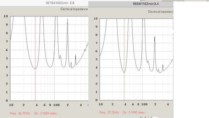

Not sure what frequency you calculated those power figures, at the 37Hz Zmin (where the coil is most likely to burn) the TBX100 draws ~712 watts, the SW115 ~2390.
At 50Hz, the impedance of both is near 30 ohms, but the SW115 still draws ~3 times the power to make 3.8dB more SPL.

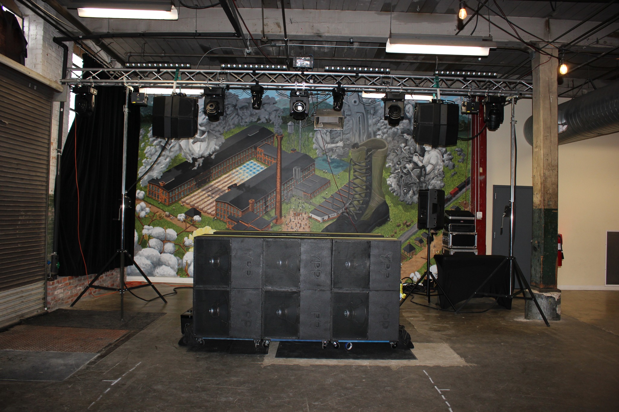

Here you go
Setup in a cardoid endfire 6x6 . The table off to right (black skirt) is the DJ area and it was -20 db.
So tempted to build MORE...

The picture I posted is of those very subs and is from Feb this year.
That was the first time in .... well before covid that I used them! Normally I just use my 4 TH Mini's. It was OVERKILL but fun! Literally used less than a 3 amp draw total on their amps.
And yes they are setup as you said.
