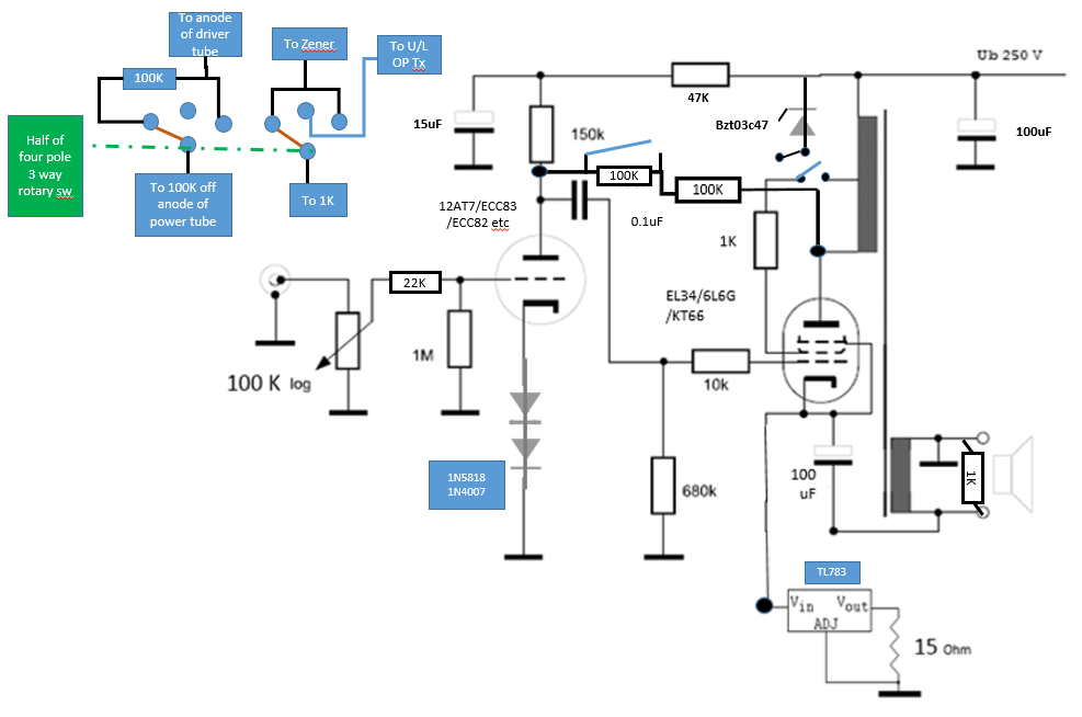

Just a thought.
This is just an update,
This drawing links into the PSU..just to remove any confusion.
Just the PSU Cap sizes and resistor altered.
Regards
M. Gregg

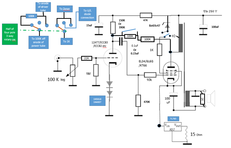

Latest fun..😀
The gain has been increased.
However this is very noticeable in the U/L mid position selection when the RH FB is removed. Interesting to try. Still works with all tubes.
It might be interesting if the mid position was triode..Umm just thought haven't tried it, that's got to be on the cards..😀
Regards
M. Gregg

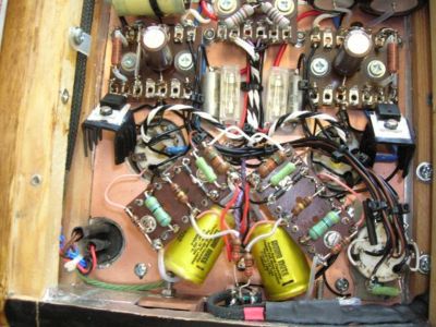

While playing about,
I also tried some old Audio Note copper/paper in oil caps (in the box of bits) to compare against the Audyn copper. 🙄 well you have to play..😀
I have never been a fan of the audio note caps..however you have to give it a go!
Triode connected OP tubes next because the gain is probably going to give more drive. Perhaps another switch..:scratch:
Regards
M. Gregg

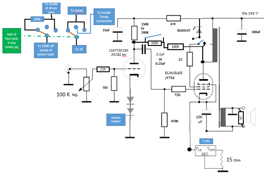

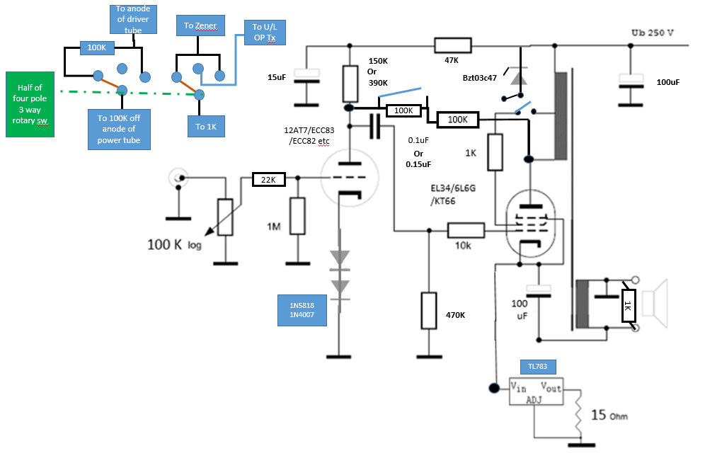

Latest play..very simple modification,
Triode in mid position no RH FB.
This works well with the increase in gain (390K).
I think its better than the U/L connection.😀
Its early days however I think the mod will be staying.
So now I have:
Switch position 1 is 200K RH FB for Ecc83 etc, RH Zener.
Switch position 2 is NO RH FB and triode connection.
Switch position 3 is 100K RH FB for Ecc81 etc, RH Zener.
So as it stands now😛ic
Regards
M. Gregg
I think the 47k is superfluous, anode should be 100k, and you should use an un-bypassed resistor instead of the diodes. I guess that would work much better?
I guess it would..😀 (I'm not trying to trash the RH amps they are great. But this isn't an RH amp is it!)
NB I tried what you suggested right at the beginning. Its also been wired as a PYE Mozart (for fun).
Its also been run in U/L triode and pentode.. For fun. Its had 7025, 5751, ECC83, ECC82, ECC81, and others in it..6L6, KT66, EL34 all wired in different connections its had lm317t in the cathode its had bypassed cathode resistors, even had global FB. Its had variations of PSU its had SS choke standard choke...
This is not about improving the RH universal...Which I believe you are thinking!
Its about trying different things.
Regards
M. Gregg
Try getting rid of the LM317.
When happy with the design replace it with a resistor. My tests using a spectrum analyzer proved the LM 317 is mostly for connivance. The resistor will also compensate for aging valves better.
If you replace the anode load of the driver valve with a CCS ( MJE 350) you will really do something if not concerned with an RH design. It will measure like it has a 1000 V HT. As a transistor CCS is highly linear it should sound much like a resistor ( transistors in current amplification mode might be better than anything including FET and valves). 6 MHz is fast enough as the flow of current is uninterrupted in SE class A. We really only need 200 kHz for safety. If a small resistor is placed between CCS and anode that can help. Try 10% the value of the original resistor. If so get rid of cathode didoes and use a standard value resistor or whatever works best. Use ears for that test as I am sure it will be better. 300 V HT about the maximum. Simple RC dropper/filter to take it that low is ideal. The CCS reference voltage needs some extra smoothing ( 2.2 uF should be enough ).
If not RH by-pass the cathode biasing for extra gain. The various caps can super tune the design to suit the LF of the transformer used. Naim transistor amps use tricks like that. They call it timing.

For those interested (many won't be!)..Component synergy,
YMMV..😀
At the moment..(one side)
22K input resistors (tantalum .5W)
1M Tantalum .5W
150K Tantalum 2Watt
2X 100K Kiwame 2W (RH FB)
10K Tantalum .5W
470K Takman MF 1W
1K Arcol carbon composite .5W (mounted on tube socket)
47K 2Watt MF 500V
NB the OP feedback ground connection has nothing to do with speaker polarity connection.
Getting the correct FB polarity is the issue!
Still trying different things..🙄😀
(I do like the triode position 2 at the moment it has no RH FB) the tantalum .5 watt are used to keep cost down where only signal is being used.

The transformer I used was Danbury. I had a Sowter for reference and can say the Danbury was not disgraced. I don't like the Danbury mains and plan to get Tiger in Peterborough to make me one.
The Danbury offers by chance a 82% tap (it's their best SE at about £62 a piece) . I used it for a small amount of UL feedback and was very happy. It measures like triode with extra gain ( about 30 % if I remember ) . In fact I could not tell from the analyzer that it wasn't triode. If looking at curves that looks about right. The gain is very useful. There is 18 % UL also. That wasn't of help. This allows 5 K or 2K4 usually. I was using 5K and EL 34 in preference to KT88. 88 gives slightly better power and sometimes less distortion. Ears like 34 better. I drove my 34 with a big pentode that was not triode strapped. I ran is at 20 % maximum and that allowed nice worn out valves to have a new life. I did this as I was told by valve guru's that this is impossible. The difference best to worst was 1 % THD to 1.5% . The curves being the same albeit higher. No loop feedback. 50 samples must have been tried.
Much of your journey seems to be exactly where I went. One thing I always say is the best cap is no cap. With the RH design 2 caps is the practical limit . If the input is made DC it won't sound very good. The pay off is it doesn't really need a cap as long as someone knows what might go wrong.
If the RH ECC 81 was swapped for a EF184 (TV pentode if the number is right) shunt feedback might be used from the anode ( 1 ) to g1. The would mean the RH Schade cap will be doing 3 jobs. DC seppartion, shunt EL 34 feedback in pseudo triode and DC separation input g1 to signal source. How neat is that? EF 184 is more or less a ECC81 in triode. As the pentode curves are used the gain shouts up and the distortion lowers. This is because the pentode and triode curve cancell in the same way as UL finds a sweet spot in the output pentodes( beam tetrode). Usually one would question the drive ability of a pentode. In the RH design it can be to advantage as the higher output impedance is helpful to the Schade effect. In truth a Kitic effect as he described it after 50 years of not being discussed.

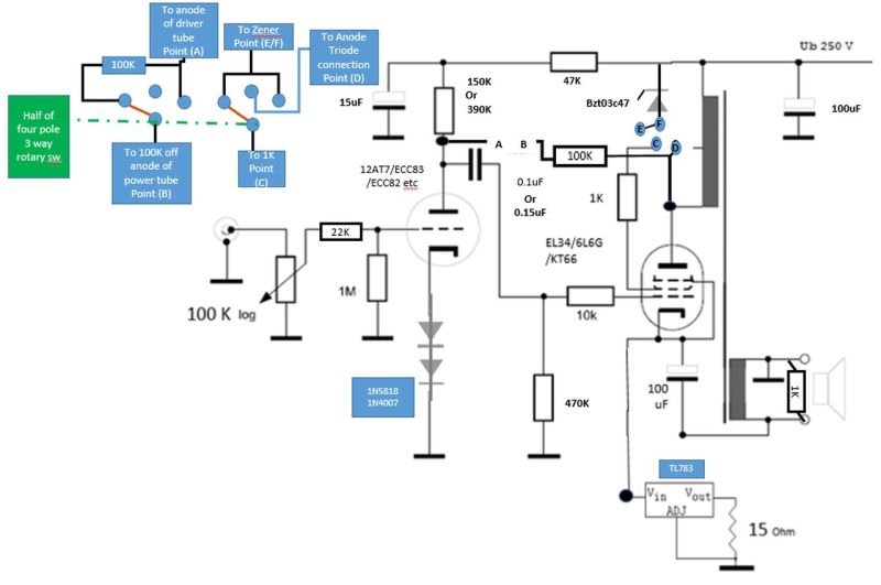

Just to clarify the rotary switches.
Not a good Idea to switch while its on!😀
Probably not needed..🙂 but there you go!
Regards
M. Gregg

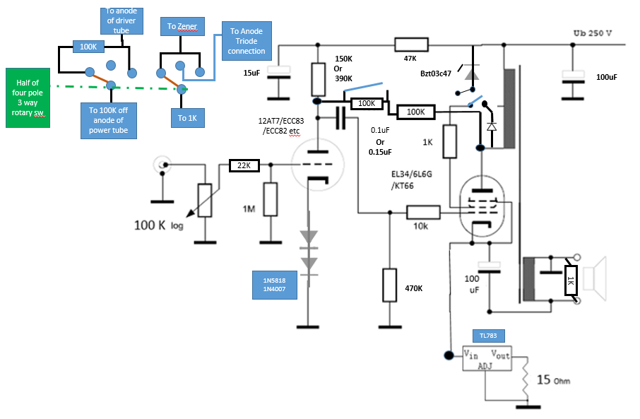

Just tried this,
Using a diode in the triode connection.
Its shown as U/L connected in the link , however if you don't try you won't know.
After reading this...well I had to give it a go..😀
Hiend Audio, DIY, Hi-Fi, Stereo, Electronics site, for lovers of high-fidelity music reproduction.
http://oestex.com/tubes/triode.htm
Early days lots of listening to do..🙂 and things to try.
I didn't bother about the tech explanations I just tried it.
Its in part 2 of the oestex.com link
Regards
M. Gregg
