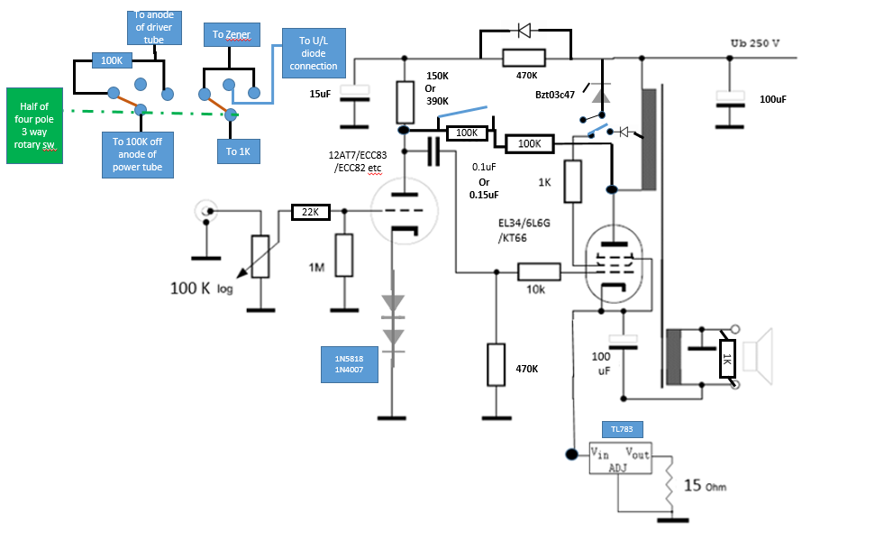

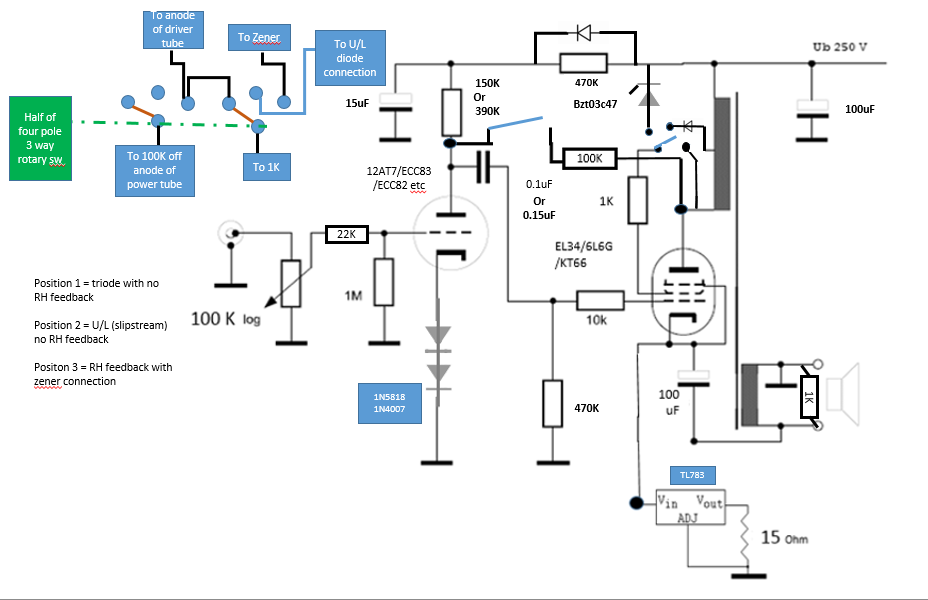

So here is whats being tested at the moment..😀
The 47K has been increased to 470K and bypassed with a diode.
The idea is the 470K gives a high resistance discharge path and the diode pulls up the driver supply.
Pick for fun..(sounds quite good at the moment)..as normal early days yet!

Obviously there is one diode and 470K on each driver (one per channel).
NB switch position 2 disconnects the RH feedback.

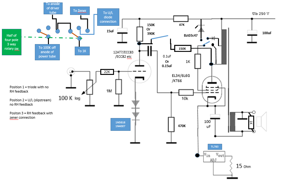

This is the position now after testing various ideas..
Position 1 is triode no RH feedback, position 2 is U/Linear (slipstream) no RH feedback, position 3 is RH feedback with zener...😀
Slipstream diodes are just 1N4007 both U/L and across the 470K ..you could try UF however in the past I have had High frequency problems..YMMV
Sounds very promising at the moment..😀

After some more testing,
I have replaced the 470K and diode with the 47K (as it was) the operating point is better..😀..YMMV
So for now I think it will stay for a while as last circuit (Post 106#)however with a 47K.🙂

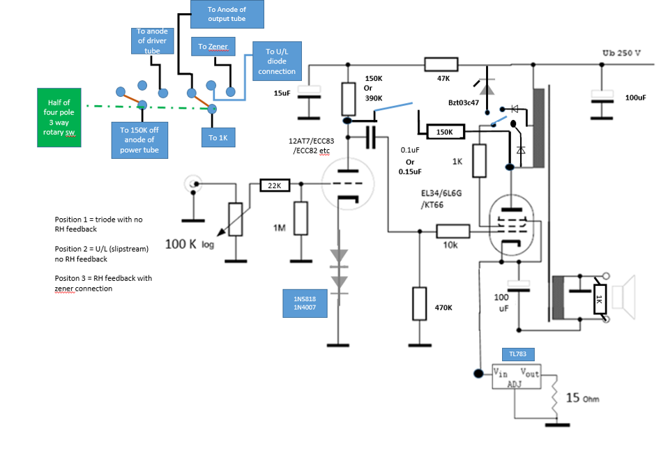

Just to remove any confusion. (How it stands now).
It was quite interesting..🙂 (I have a few things to try)
I will only post if I think its significantly better!

Back again,
100K from anode of output tube for the RH feedback increased from 100K to 150K. Component type is Takman metal film 1W...🙂
This gives a more usable balance in RH mode.(I had to post because it was an issue that needed resolving)

Just a bit more playing..😀
So I'm back to diode enhanced triode..
Switch positions are:
RH with Cathode FB
Slipstream diode U/L with cathode FB
Diode enhanced triode with cathode FB ....Yes I've gone back to it..

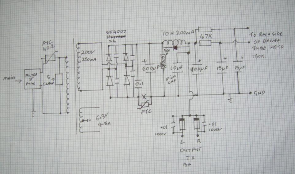

PSU mods are:
Choke bypass with reverse biased diode..rectification is now UF4007 with ceramic cap suppression. NTC in the negative rail after rectifier.
Nothing special..just an update and trying the electron stream mods..

I use the TL783 so I can just plug in EL34/6L6/KT66 etc
The driver tube is also either 81/82/83 etc
ie plug and play any output tube no bias setting.

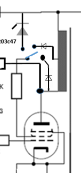

The switch selector is for diode enhanced output selection with CF. Ie diodes on the UL and triode connection.

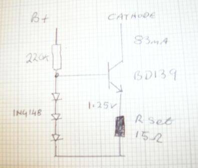

Try the LED transistor version. 250 V transistors are cheap and very linear. T03P case also helps. You can take a power transistor to have a gain of 50 if 100 mA. You can easilly offer 25 mA to an LED. That should offer reliable bias. If not a double transistor CCS.

I'll have a look at the alternatives to the LM317..
Its another thing to try out..🙂
I like being able to just plug in the driver and output tubes..mainly because I have a few different types...🙄😀 (fun project)

Just a quick scribble..🙂
I was just looking at your circuit its very interesting..
Did you find any problems with supply rail ripple with the BD139 circuit? (stability)
