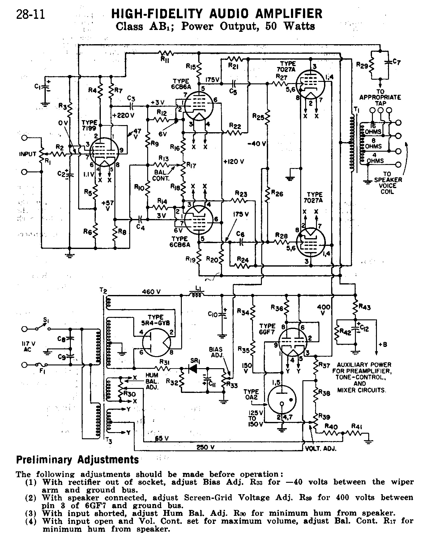

My favourite Kitic amp is attached... 50 Watts, Tons of Power and low distortion!
But... oops... it wasn't designed by him. It was designed by an engineer at RCA and published in 1959.
http://www.tubebooks.org/file_downloads/RCA_HiFi.pdf
I would suggest that Michael J Koster's amplifier is an excellent implementation of the "RCA" idea.
