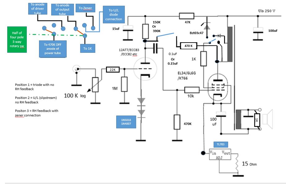

Just ignore this its an update to a circuit resistor value,
The Zener (BZT03C347)can be shorted out and that selection just used as Pentode.
Synergy for anyone interested.
Input 22K and 1M are 0.5W Tantalum magnetic.
150K 1 Watt Tantalum magnetic.
470K is 1W Takman MF.
10K is 0.5 Watt tantalum magnetic.
470K is standard MF 2 Watt 500V.
47K is standard MF 500V 2 Watt.
15 Ohm on CCS is Mills 5 Watt.
0.15uF is Audyn True copper.
Diode on U/L is 1n4007
Obviously don't switch while the amp is ON..but you already know that..🙂
Regards
M. Gregg
I thought you might like to see this. Many who like the Kitic design never talk about distortion. Usually something about bass quality if lucky. This is why I gave up with it . It has high distortion and low sensetivity. I think I had 5 % at 8 watts. Using EL 34 was similar. The funny values are bunches of resistors at hand. On one Kitic thread 1 % THD and 14 watts stated. I have no idea how that could be true. The transformer here is Sowter so not causing the distortion. This wasn't done to show on this page and was for my interest. Many things were tried. This seemed about the best. At least the spectrum is nice albeit very high values ( even by zero feedback standards and SE ).
