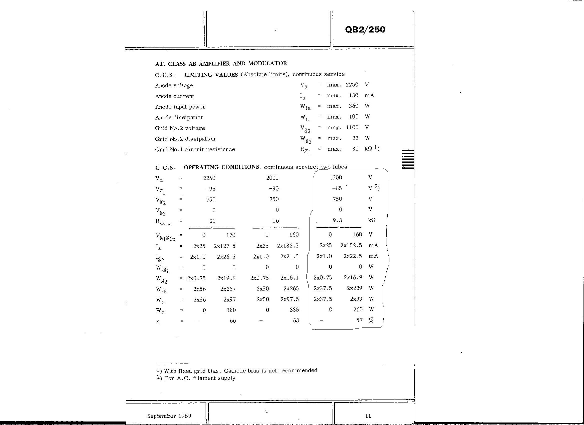

This make very good reading. 813 is a favourite of mine. If correct it can be 0V biased as a transmitter valve. RH series. /QUOTE said:Hi Nigel Pearson !
813 (QB2/250) is my favorite power tube too , I mostly use 813 in OPS of AM / MW Transmitters and Modulators , it is great professional power tube , same as Russian GU13 tube .
but use of 813 in SEP mode for high quality tube audio Amp. is totally Wrong way ! , the real sonic results in SE mode can be achieved when 813 is strapped in triode mode with no more than 800VDC B+, and running with automatic ( cathode ) bias Only .
But the Real Thing for high quality Audio Amp use is two 813 in PP / UL mode , AB1 class , with B+ / Vba = 1,5KV and B+ / Vg2 = 0,75 KV , in that working regime 2 x 813 will give around 250 W of relative low distorted output power with such of easy , and will last for decades .
Tricks for long life of 813 tube is : soft start of tube filament supply , and precise regulation of filament voltage in range of +/- 1% .
But the main question is : Who need 250W / Ch audio Amplifiers for home use ?
Best Regards !

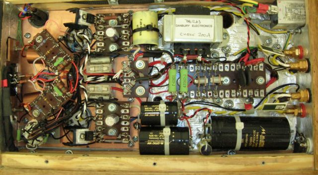

Here are the modified internals..
Its just for interest..
thick film resistors on speaker terminals and True copper coupling caps under the tag boards.
FB resistors are Kiwame all the rest are tantalum. Diode bridge is FRED.
The Heat sinks are the CCS in the tube cathodes that run cool.
Regards
M. Gregg

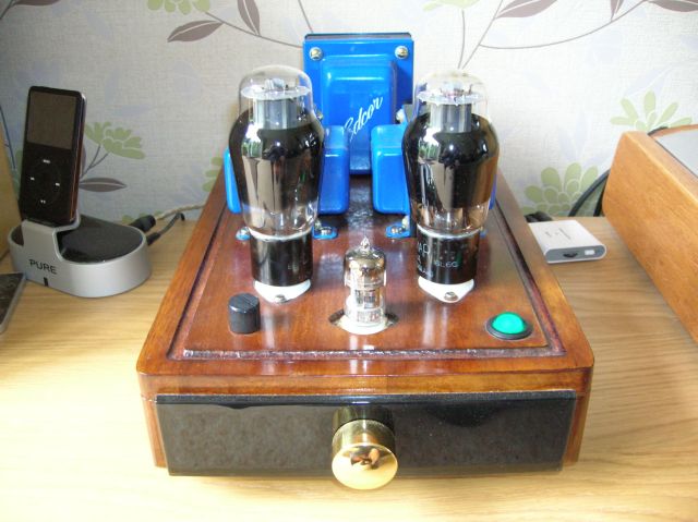

So there you go....my version of the universal amp. The only trouble is I could just keep changing tubes plug and play...but after now convincing myself to stop before I wear out the tube sockets ......I will have to think of something else to do....the problem is it works with all the different driver tubes as well so you have such a combination to try its better to leave it alone..

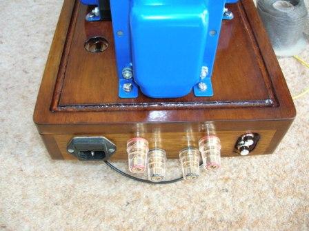

Inertia. Nice wood, is it old?
I put IC sockets in the transistor stuff I make. Getting people to swap IC's is difficult. Weird as it is easier and more of a no brain choice.

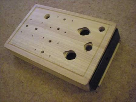

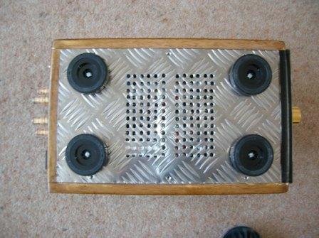

The chassis is hard wood with a shellac finish....its an old project.
Valve bases were mounted on silicone washers (anti vibration).
Top plate screened with EMI tape. Front is glass drilled for the volume control mounted on a copper plate inside. so the glass is not supporting the control
Regards
M. Gregg
Regards
M. Gregg

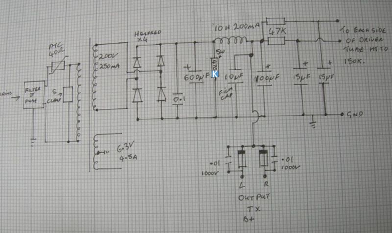

Latest PSU test..
You have to have a play..
Just thought I would add it..quick scribble. And yes I know about the 600uF and the 100uF... (its meant to be that way).
NB the 47K and 15uF replace the ones on the circuit diagram..(10k&22uF)
The fusing could go in the cathodes..however...
Regards
M. Gregg
Regards
M. Gregg
Nobody spotted the mistake..
The bleeder resistor is 470K 5watt..ah well..thats what happens when you get distracted..
Could a moderator please replace the diagram in post 78 with this one thanks..someone might use the wrong value.
Thank's
Regards
M. Gregg
Thank's
Regards
M. Gregg
