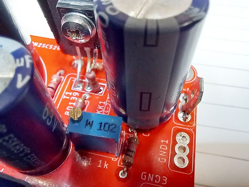

So I got to do a little more work with this tonight.
I also made a new discovery - I wanted to check if it was something like I had the pot badly adjusted, and as I turned it one way looking at the scope I noticed that the frequency changed with pot rotation. Then just as I did that the noise stopped completely. This was repeatable across both polarities. However, when I connected different loads, I saw the noise return, and then I could adjust it out, change the load back and then it would be there again etc.
Unless I hear different from someone here I think my next move is to change out the power BJTs. These ones are working pulls from an amp, but I have brand new ones from mouser as well. The BD139/140 are brand new from mouser. After that I'm at a loss.
- So first off, the issue is exactly the same across two separate builds. So its not something isolated to just one build.
- The frequency of the noise is a relatively clean sine wave at mid 30s mHz
- Amplitude of the noise/oscillation etc is variable I've seen 10mV to 30mV rms
- In both cases, the size of the load affects whether the noise is there or not

You could try ferrite cores on the base of the transistors.
I was wondering about a stopper resistor on the bases, but no-one else seems to have needed that.

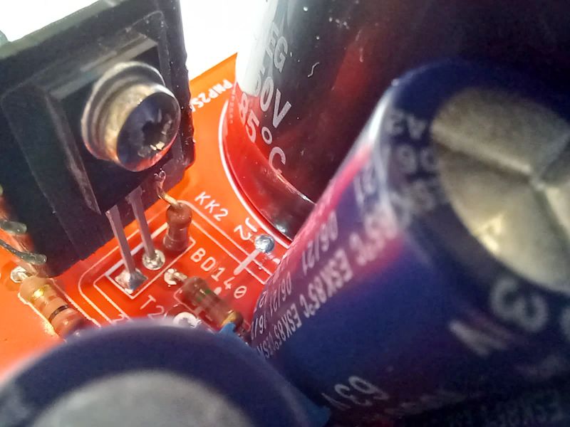

Yeah, so this turned out to be oscillation of the BD139/BD140 transistors. I added a grid stopper of 240r on both and the problems disappeared. No detectable ripple even when pulling 3.5A, and no observable difference at lighter loads. There is some noise/hash of a few mV or so, but that is there anyway on bench when not connected to anything. The whole PSU sags a bit naturally under the 3.5A load, I'm getting about +/-28Vdc from a 2x25VAC 300VA transformer at that load, and about 31-32Vdc unloaded.
I'm still not sure as to why it oscillated at different loads, one thing is that the BD139/140 are mounted on their full length legs to facilitate a little bend in the legs to let the heatsink stick out a bit away from the caps. They weren't on extensions or anything, still on their own legs, but higher up than you would normally mount them. Once the stoppers were in, no oscillation observed at 1.5A or 3.5A. Power BJTs barely even get warm so I think it will be fine to mount them to the floor of the chassis, maybe even with a heat spreader or something.
i would be suspecting fake parts, but these are fresh from mouser a couple of weeks ago.

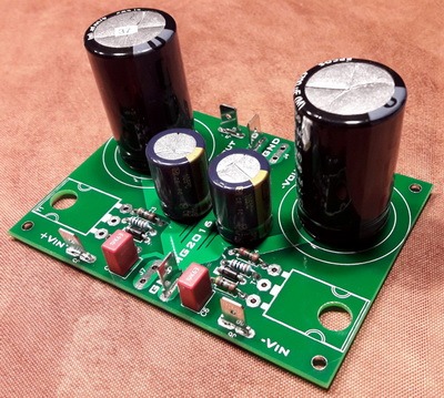

Guys I've just taken out my 3255 amp that I run with a big old unregulated psu. Using this Capmx after a decent cap bank. I noticed just now this resistor is obviously having a hard time.
Any thoughts?!
Any thoughts?!

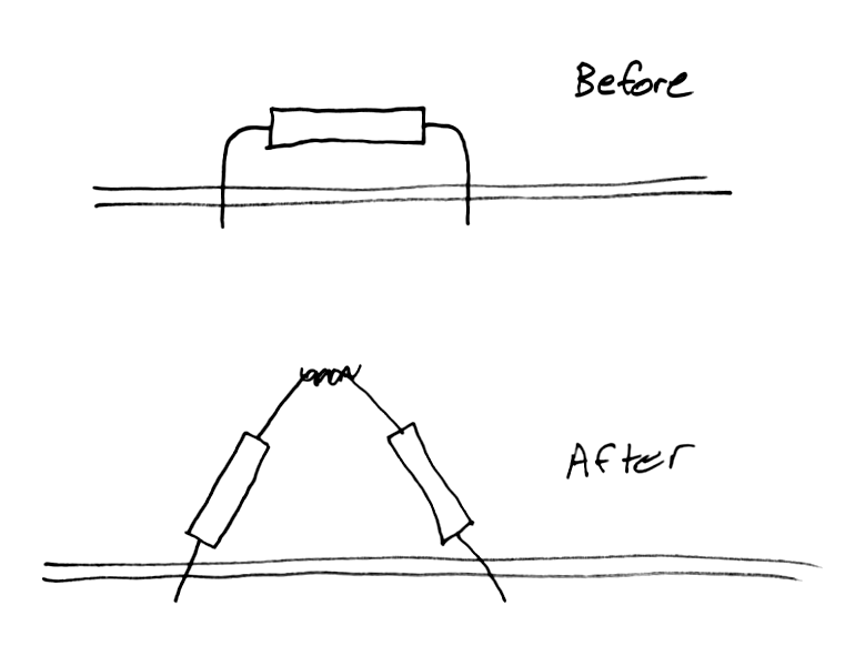

An easy upgrade:
In place of a 3.0 ohm, 0.5 watt resistor . . . . connect two 1.5 ohm, 1 watt resistors in series, mounted vertically. Resistor 1 goes into PCB hole 1, Resistor 2 goes into PCB hole 2, they are pushed together and their midpoint leads are twisted, soldered, and trimmed. Now you've got a 3.0 ohm, 2 watt resistor. Viewed from the side, the two resistors form a very pretty isosceles triangle.

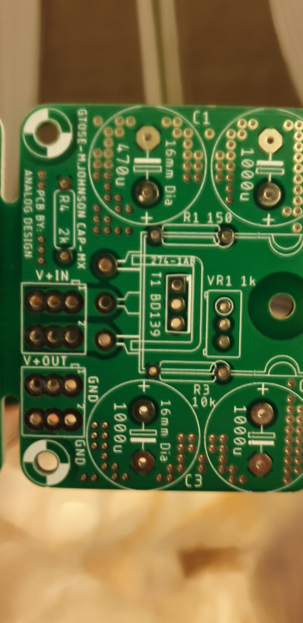

3 ohm....in a position that calls for 2k? Sorry to doubt but I am inexperienced enough to have to ask!
In place of an X ohm, Y watt resistor . . . . connect two (X/2) ohm, (2*Y) watt resistors in series, mounted vertically. Resistor 1 goes into PCB hole 1, Resistor 2 goes into PCB hole 2, they are pushed together and their midpoint leads are twisted, soldered, and trimmed. Now you've got an X ohm, (4*Y) watt resistor. Viewed from the side, the two resistors form a very pretty isosceles triangle. You've quadrupled the power handling capability!!!
Substitute whatever values of X and Y you like. Perhaps X=2K, Y=0.5W . Perhaps X=3, Y=1 . The calculations work the same way for both cases.

I suspect your wattage rating on that resistor is a bit low. That's the drain resistor (if I'm right) that collapses down the voltage in the big reservoir caps if the load is dropped (well its pulling some current all the time). I would replace with a higher wattage resistor mounted off the board by a few mm, or else follow as @Mark Johnson suggests. If your PSU is running at eg 30V then that resistor is continuously dissipating 1/2W, if your voltage is 40V then its 0.8W.
I think I would use a 3k resistor there instead (or even 4k7). At 30V, 3k would see 1/4W, so a 2W would be very safe. 4k7 would only see 0.16W, so a 1W would do fine. The other thing to think about is that you would probably be better having the capacitor bank after the cap-mx, although I'm guessing you have it set up that way because the normal PSU has the rectifiers on board.
Thanks guys yes that all makes sense. I didn't realise it was a bleeder. And its a 50v rail too !
I have some 2 or 3w that I can use vertically.
And I keep seeing the comments about Capmx before any other cap bank so I'll amend that too!
yeah, 50V across 2k is 1.25W, so probably pushing it alright.

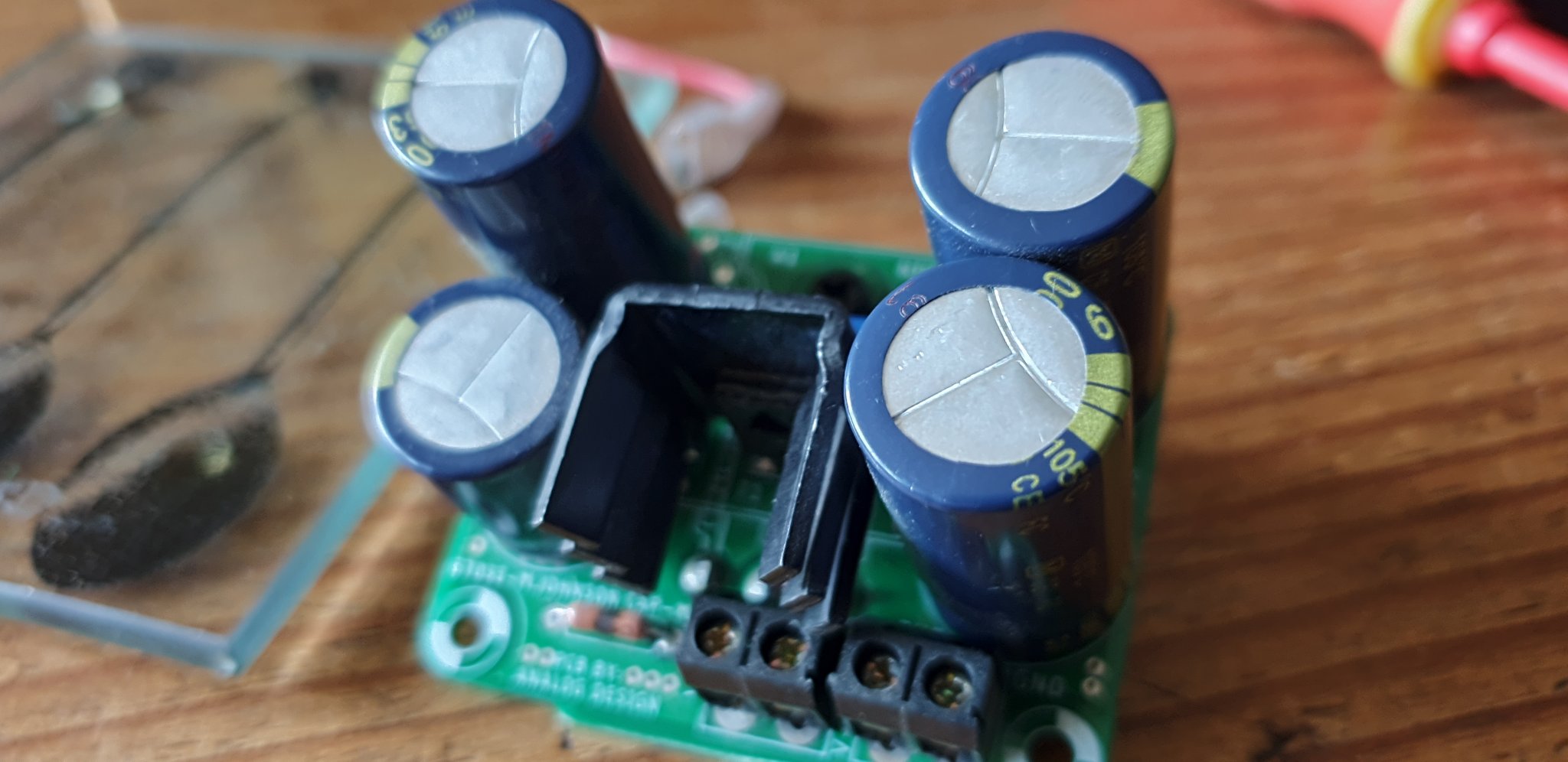

Hey people,
First, many thanks @ Juma, XRK971, Prasi and everyone who helped making these things real!
I'm driving three LM3886 per box with an unregulated PSU (18-0-18V) and about 50000µF/ rail (for all 3 Chipamps). I am really happy with these loudspeakers and, as a newbie, I cannot even imagine I could improve anything 😉. But, you know ...
In the ChipAmp-forum, the user "Kaltecs" (who developed very nice composite amps with the LM1875 & the TDA7293) wrote very positive about using Cap Multipliers with his Amps.
As the PSU in my speakers is still under construction anyways, I'd like to give a Cap Multiplier a try. So, as I just ordered different PCB's in China, I ordered some PCB's for the shown CapMu also >
The PCB's are now on their way from China, and I'd like to ask if you people maybe got some advice what to look at when building & using these things.
First a few questions:
I took the smaller PCB with two MOSFETs, because it will be installed in the PSU-compartment of the loudspeaker, where there is not much room. What is your advice, does each amp need it's own CapM, or one CapM per box?
I am not sure if I can afford 47000µF caps. Will 22000, maybe 2x 22000µF be ok?
What should I do with the already existing caps? Maybe three smaller ( it's 4700µF caps, maybe 10 (5 per rail) for each Amp) packs after the CapM, or how could I use them?
How much voltage drop will I have? Sooner or later I got to buy better toroids (300VA should be, now I got 160VA) and maybe I can order a few Volts more when I order at "shop toroidy" in Poland.
What else should I keep in mind?
