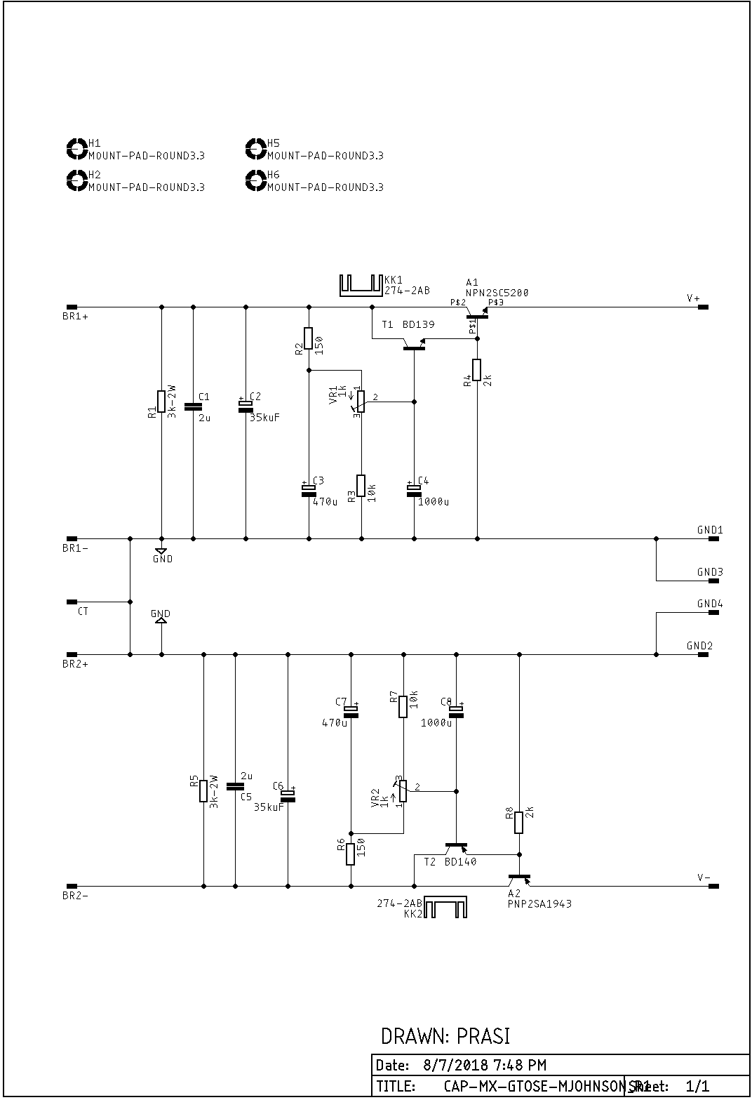

I had some Cap Mx boards made to be fed by two SMPS supplies for +/- voltage rails. I have decided on this version by Gtose and Mark Johnson:

After kindly being donated a few boards here, I've read the thread through, a lot to learn and I suspect not all of it has sunk in. BUT can I ask a question here - I want to drop a little more voltage than the standard 1k pot is giving me. Is there a way to get a bit more adjustment down? Another 3 or 4V down would do the trick for me.
I'm using an old but beefy transformer for a build, (37VAC) and I have about 43V DC at the bottom of the range. I need to get to about 35-38 V if at all possible for the amp circuit that its to power.
And if I might be really cheeky and ask another question of the collective wisdom - is there any benefit in a CRC stage after the cap-mx? The amp is a chip amp, so its not a constant class A current draw.
Fran
So answering my own question possibly we can have no less voltage drop than the mosfet gives but we can trim that voltage a little to balance to the other rail?
Ray, most of these boards have 2 pos and 2 neg rails...4 separate cap mx 'set ups '. Maybe you could hack a board and feed the out from one cap mx into the 2nd cap mx....=8v drop..?!

I think the 2SC5200 is a BJT and therefore 2v drop? A mosfet would give a 4v drop....from what I have read but I'm far from well informed on this!
I don't know if your circuit is reconfigurable for a mosfet.
What about adding a coupe more monolithic bridge rectifiers to loose some V? Not a pretty solution but might help.
