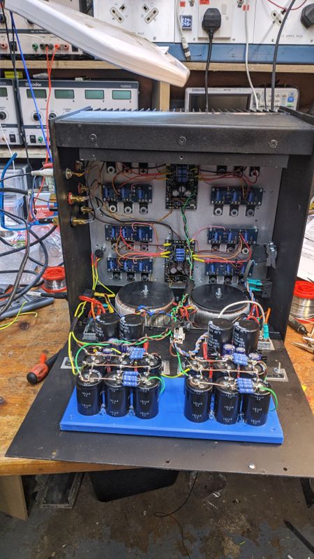

So, just a thread update. I fitted two of these (followed by a cap bank in CRC) to an Aleph 60 build - these are the ones back up the thread a little. Under full load, the noise is tiny at the capMX down to as low as the scope will go. No hint of the oscillation that I posted about above. The transistors (2sc5200/2sa1943) don't get very hot - I just have them bolted to the back plate of the amp which is just 3mm alu plate. That gets to 40degC or so. Each rail is pulling 2.5A so heavy enough load.

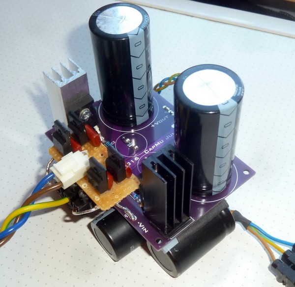

Hi people,
now I built this with IRFP240/IRFP9140. 2x 10000µF/75V, 2x 4700µF/63V + 2x 4700µF/63V. Same Transformator as before. It takes several minutes until the voltage is at the maximum of +/- 57V. Theres not much room for mistakes and I cannot find any. Everything stays cool. Is this normal?
regards
J.

The temp depends on how much current you are flowing. Power dissipated is I x V. V is about 4v for a MOSFET cap Mx. So about 4W for 1A current. Those heatsinks won’t handle more than 2-3W. If you were running an average Class A amp that draws 1.5A to 3A then 6W to 12W and you’ll need to mount the MOSFETs to a larger heatsink. Those diodes will need heatsinks if Class A as they dissipate I x 0.6v.

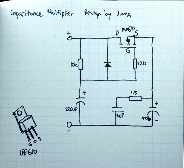

Maybe you understood me wrong. My question is: is it normal, that it takes about 10 minutes until I can measure the maximum rectified voltage of +/- 57V at the output of the CapMultiplier? The small coolers are just for testing, and the statement "everything is cool" was ment as, nothing gets hot because of a part soldered in wrong direction/placement/size (biggest cap I ever blew up was a 470µF/35V. I don't want to experience this with a 4700 or 10000µF, so I look 3x for the right polarity) . That flowing current will heat up the Mosfets which control the flow should be clear, even to me.
It should reach voltage within 45 seconds or so based on RC time constant of the parts in the schematic. 10min is way too long. Are you off by a factor of 10 on the resistor?
The cap being “multiplied” is the 220uF at the gate of the MOSFET and the 10k is charging it. If you are using 4700uF and 10k that’s 21x longer so 10min would make sense. Change the cap to smaller value. No bigger than 470uF.
