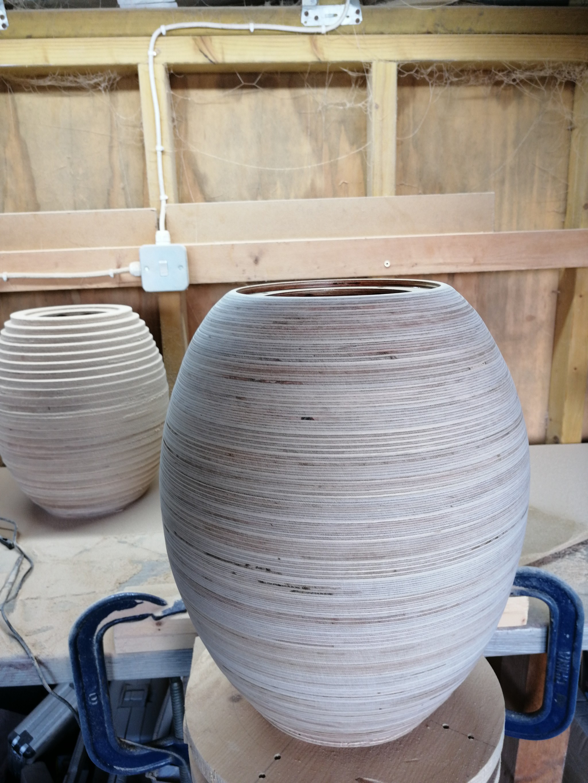

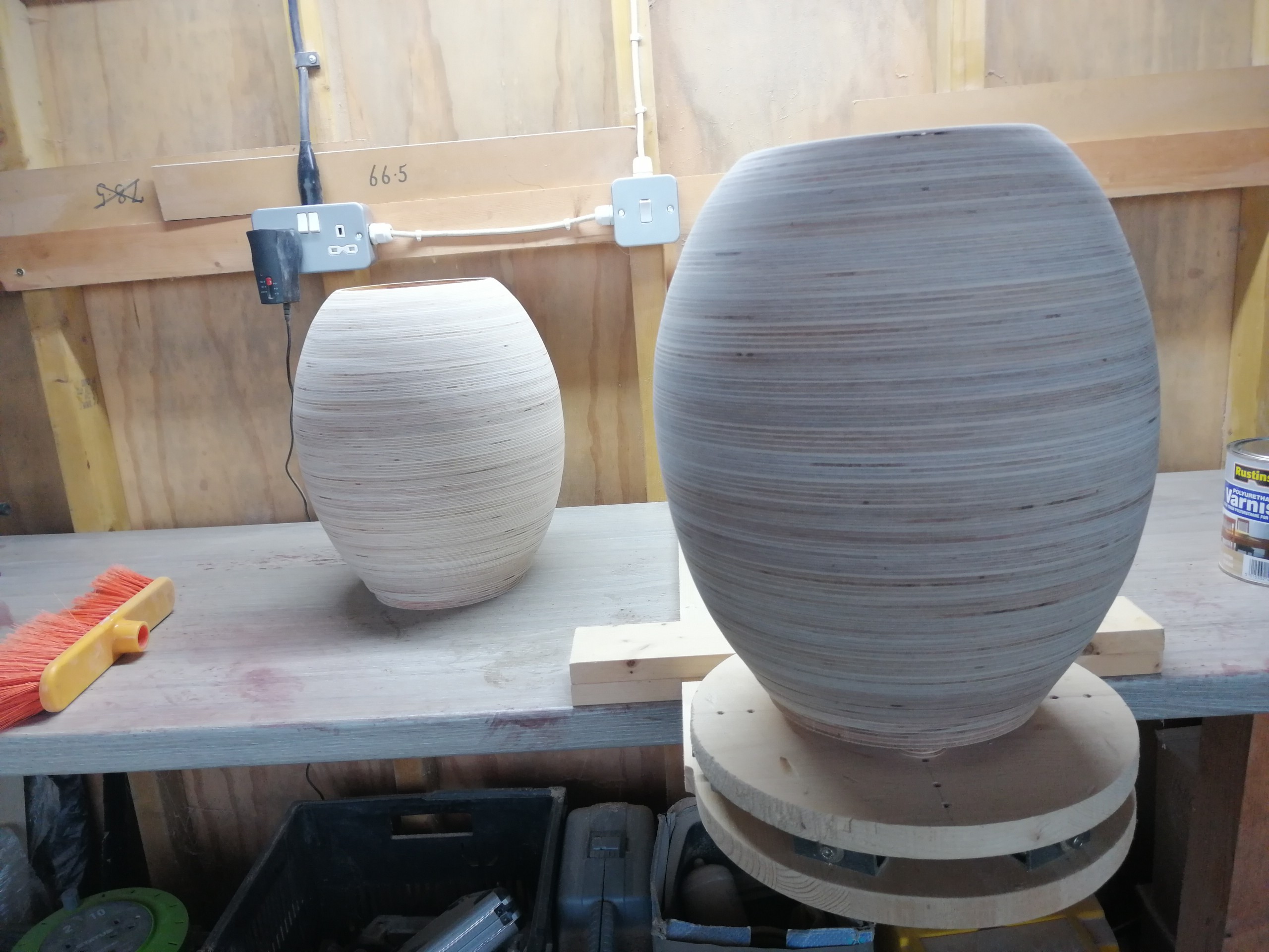

It is probably a little residual from the original stepped finish. I'll try shaping the other cabinet and see how that one comes out. If it's not visible then I'm not going to worry. It certainly won't be enough to effect sound quality. Fingers crossed.
Niffy
I've shaped the front section of the second cabinet. It has the same issue of the slightly undulating surface. Again it isn't really visible and is only noticeable to the touch.
I going to have to ponder whether I want to try and smooth it out further.
Niffy

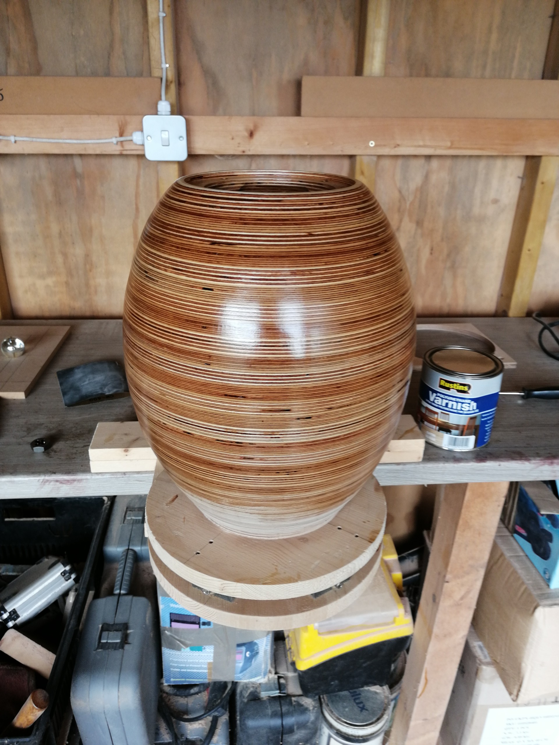

Hi mhenschel,
I believe that you are on to something.
Before I glue on and shape the rear panel I think I'll varnish the front section to see if any surface imperfections are visible. Then decide from there which way to go.

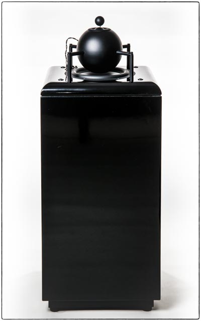

It seems to me that a lot depends on how you expect this shape to operate for you. If the objective is primarily to not have a sharp diffracting edge then minor imperfections are likely immaterial. Except for the appearance.
On the other hand if the desired function is more like that of the sphere on the Morrison 19 then the configuration and conformity probably matter a lot more.

Hi mhenschel,
My design is not omnidirectional like the morrison. It looks like the spheres in this design are used as reflectors.
The spherical nature of my design is purely to give the smoothest diffraction and a benign baffle step. My wanting to get the surface as smooth as possible is purely cosmetic, the slight undulations won't have any effect on sound quality.

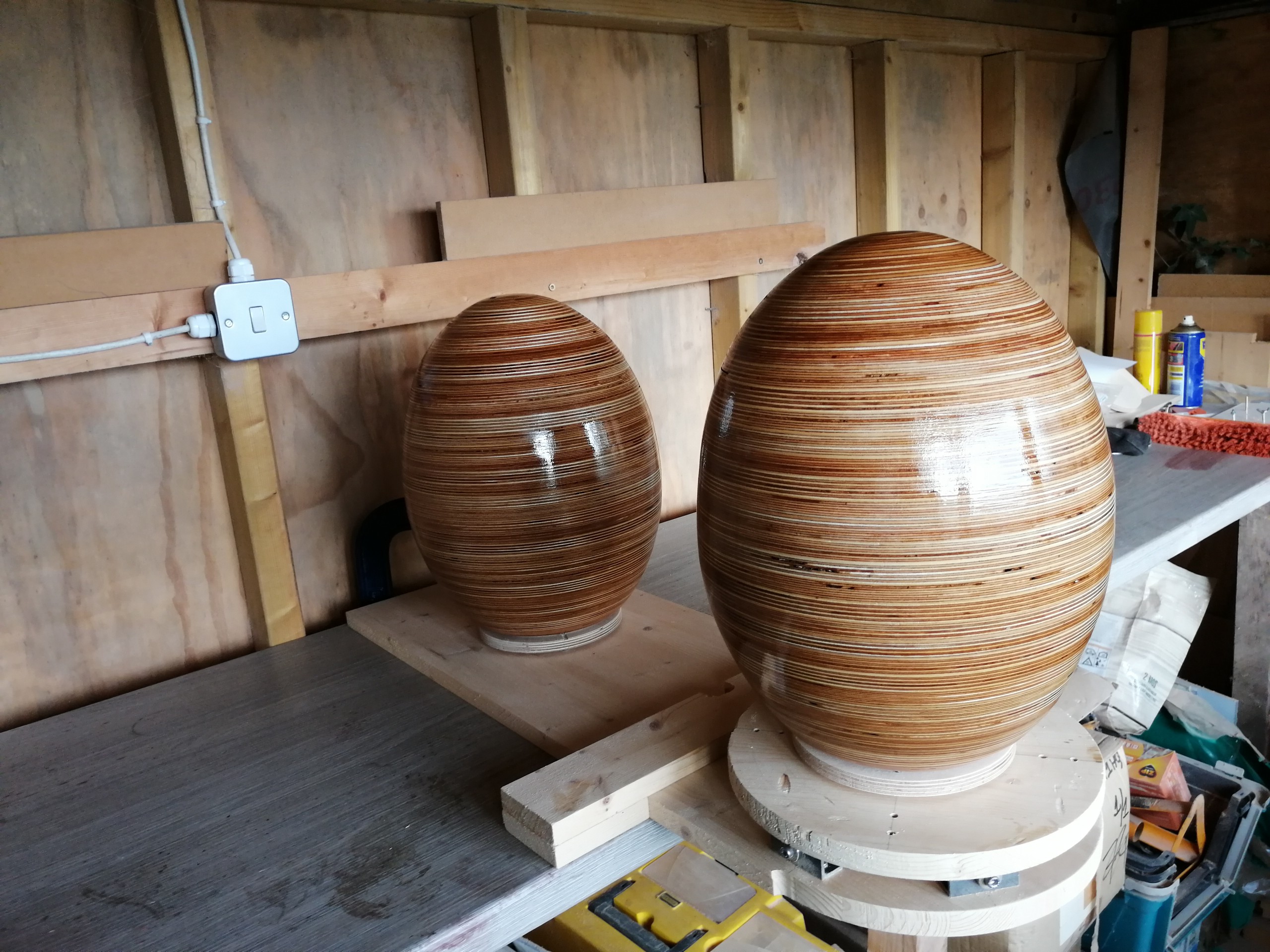

I have varnished the front sections of both cabinets.
They look pretty smooth so I probably don't need to do any further shaping, and the colour is great.

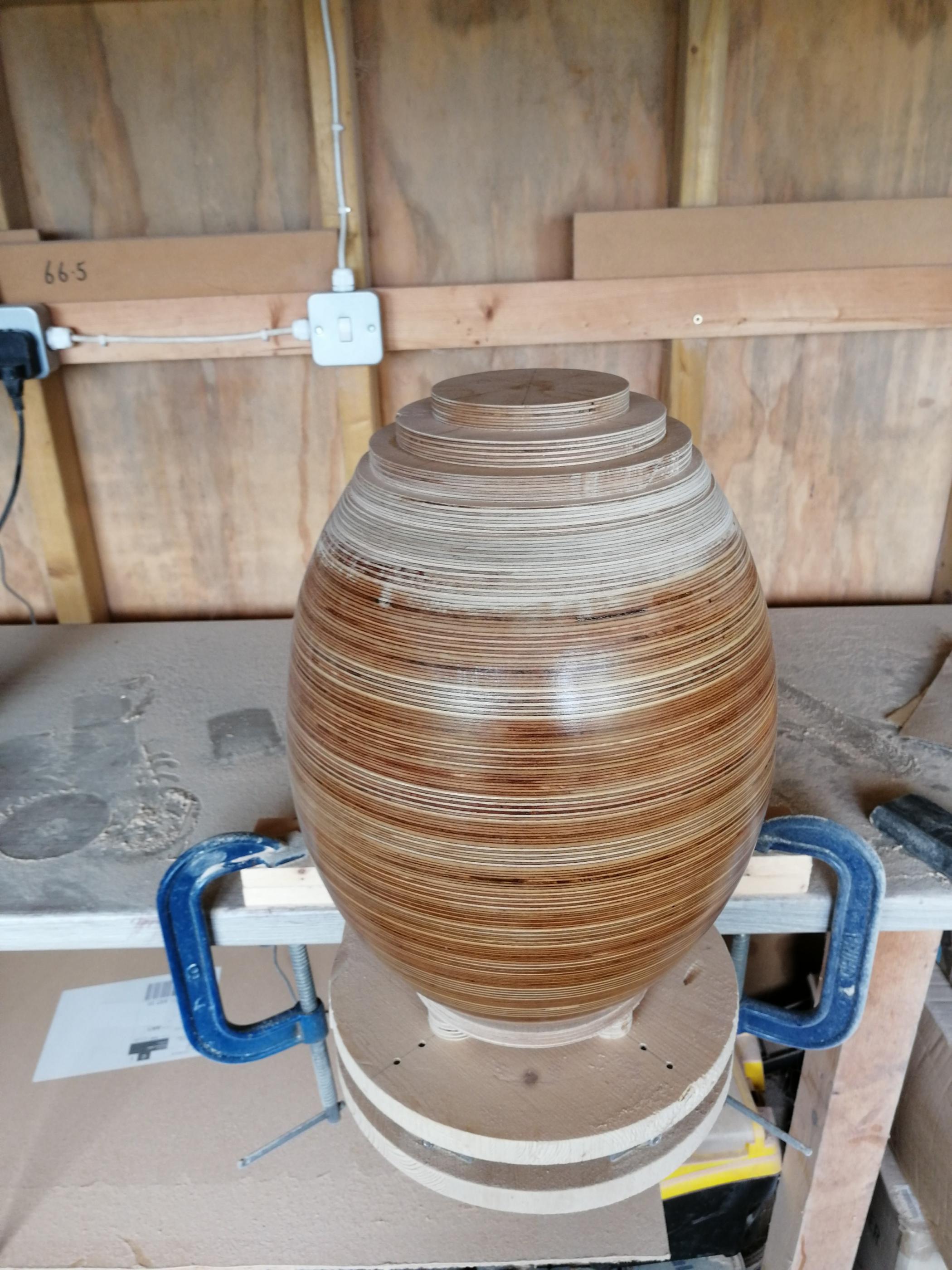

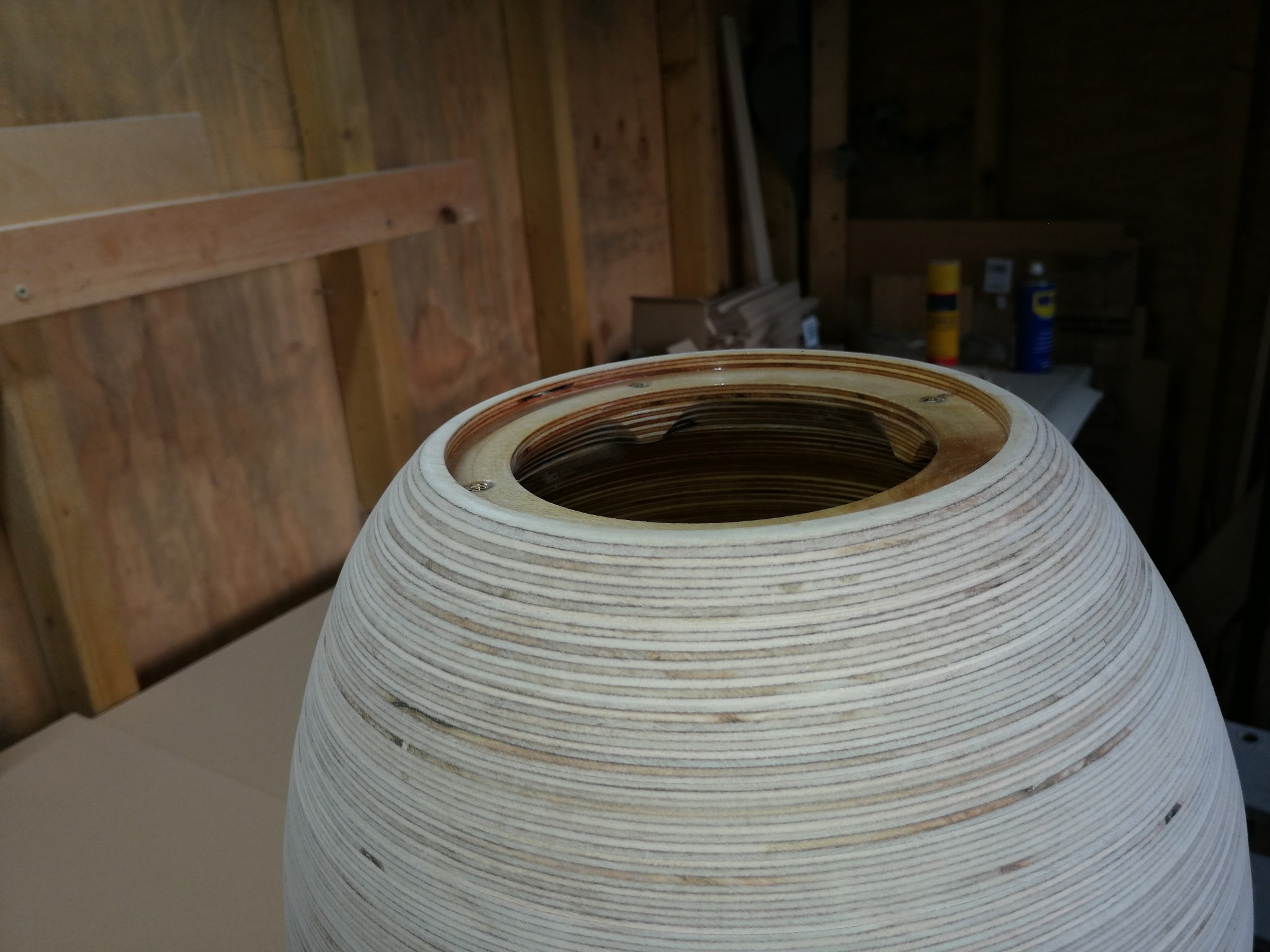

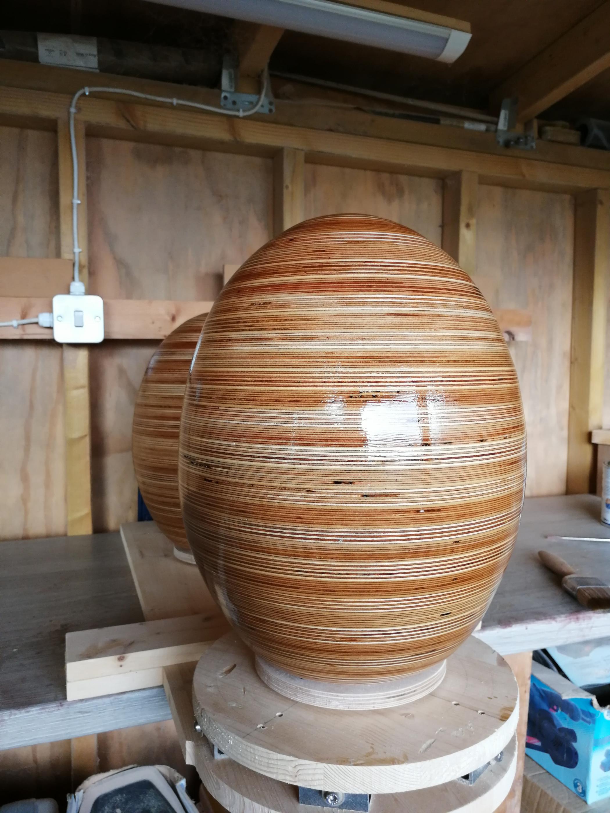

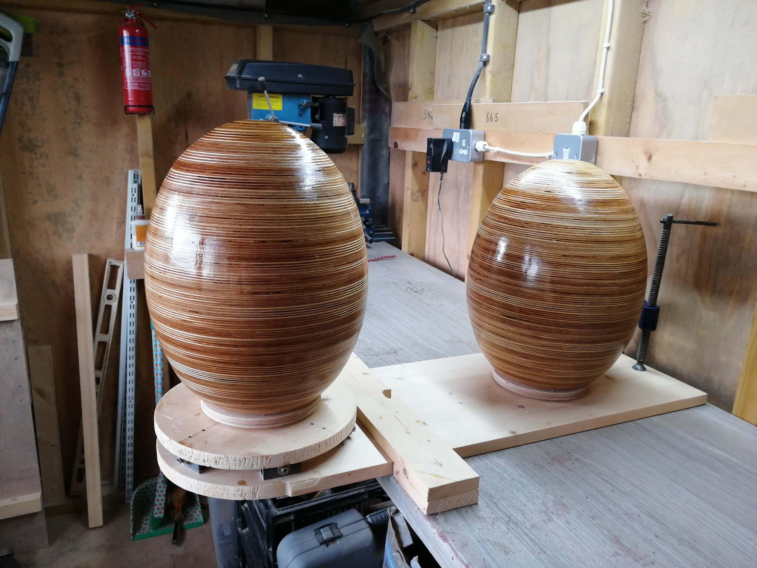

Last bit of gluing.
I've glued the rear panels to the cabinets this morning. The glue to was well cured so it was on with a bit of sanding. First one done. I've attached the second one to the turntable in preparation for its final shaping.
Niffy

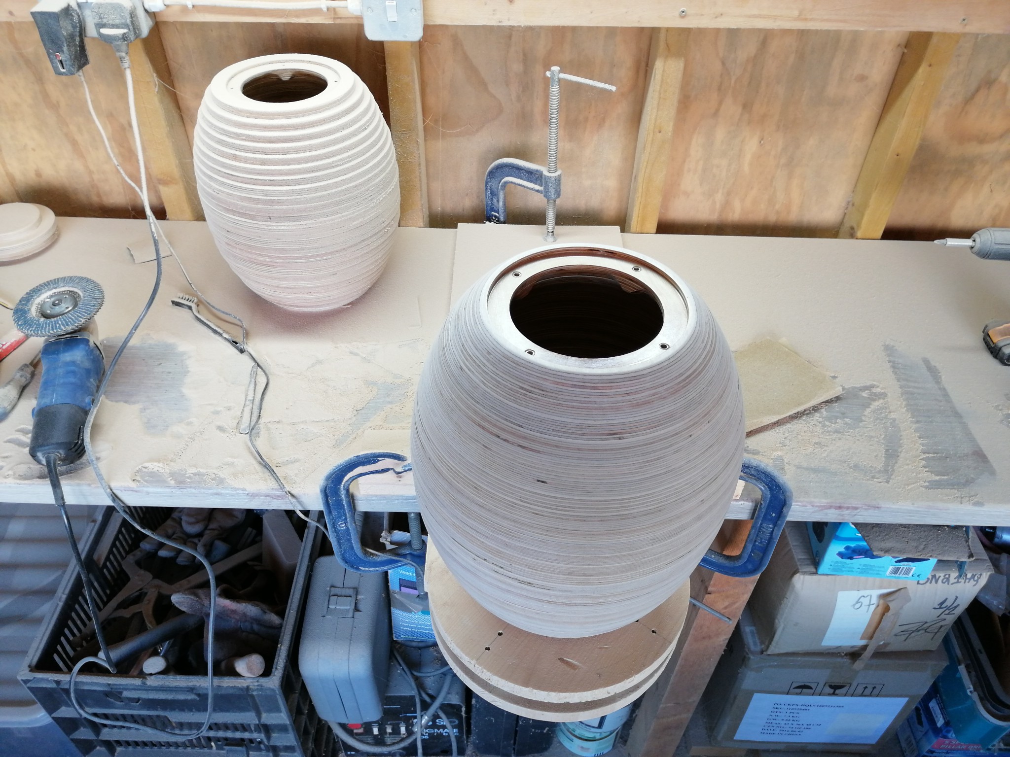

The finished shape
I've finished shaping both cabinets and given them both a coat of varnish. The shape is just what I was after. They will need several more coats with a bit of a rub down in between. I feel like I'm in the home straight.
