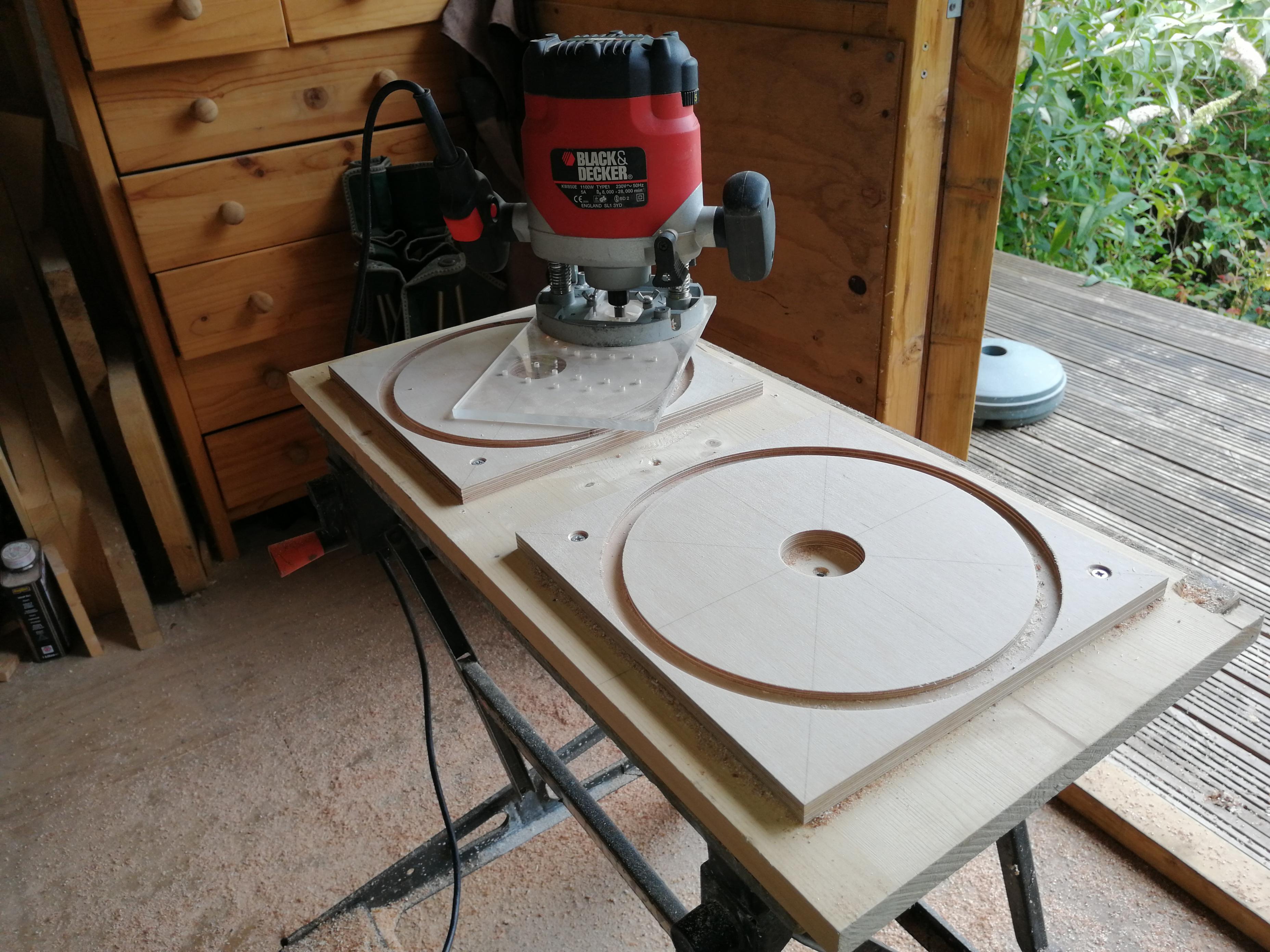

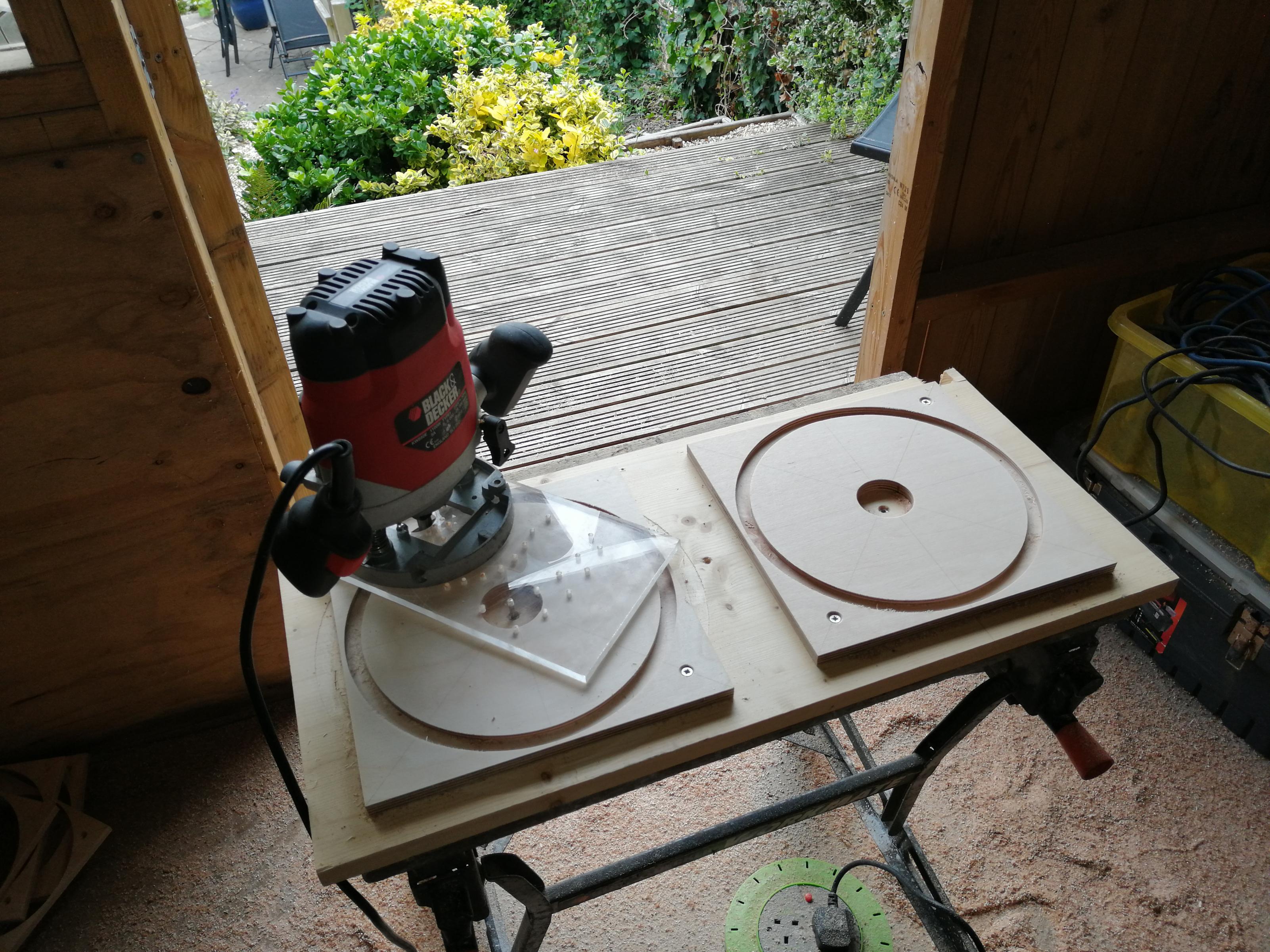

Router jig
The first batch of disks have been cut.
The base of the jig is offcut of furniture board with a batten of 2 by 2 glued to its underside. The batten allows the jig to be held in the Jaws of my trusty workmate. Set into the board there are two metal inserts each with a 4mm hole into which the peg from the upper part will be inserted. Metal inserts were used as a hole just made in the wood of the board would probably deform with repeated use.
The upper part of the jig is made from 8mm polycarbonate and has M4 tapped holes for each of the sizes required. The 4mm peg is fitted into one of these threaded holes.
The square from which the disk is to be cut is secured to the base with a couple of screws.
I found that making two passes with the router was easier than trying to do it in one.
The jig works really well and is much faster than I expected.

On the amount of sawdust, I have a question.
Why did you choose such a wide bit? Wouldn't a 1/4" bit make for an easier cut and produce less sawdust?

Hi mhenschel,
I have found that a high cutting speed works better. By doubling the bit diameter I double the speed of the cutting edge. I have also found that the groove cut by a smaller diameter tends to clog up with sawdust which can overheat the bit. Using a 1/4" bit would require more shallower cuts so would take longer overall. A 12mm bit cuts nice and easy.
I still have to sweep the same area of floor so it won't take much longer if I have to sweep up twice as much sawdust. The only advantage of a smaller radius bit is slightly less material wastage.

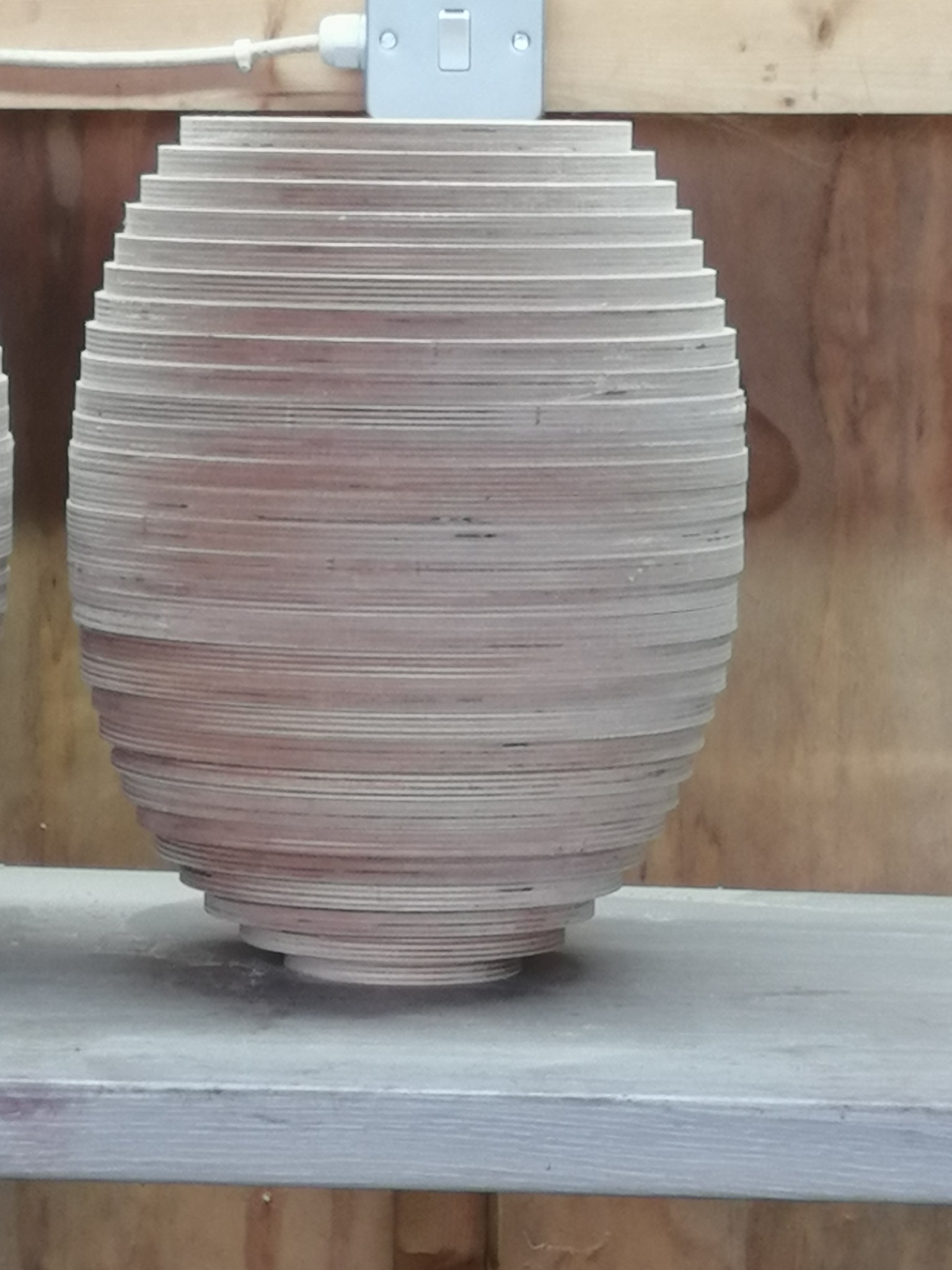

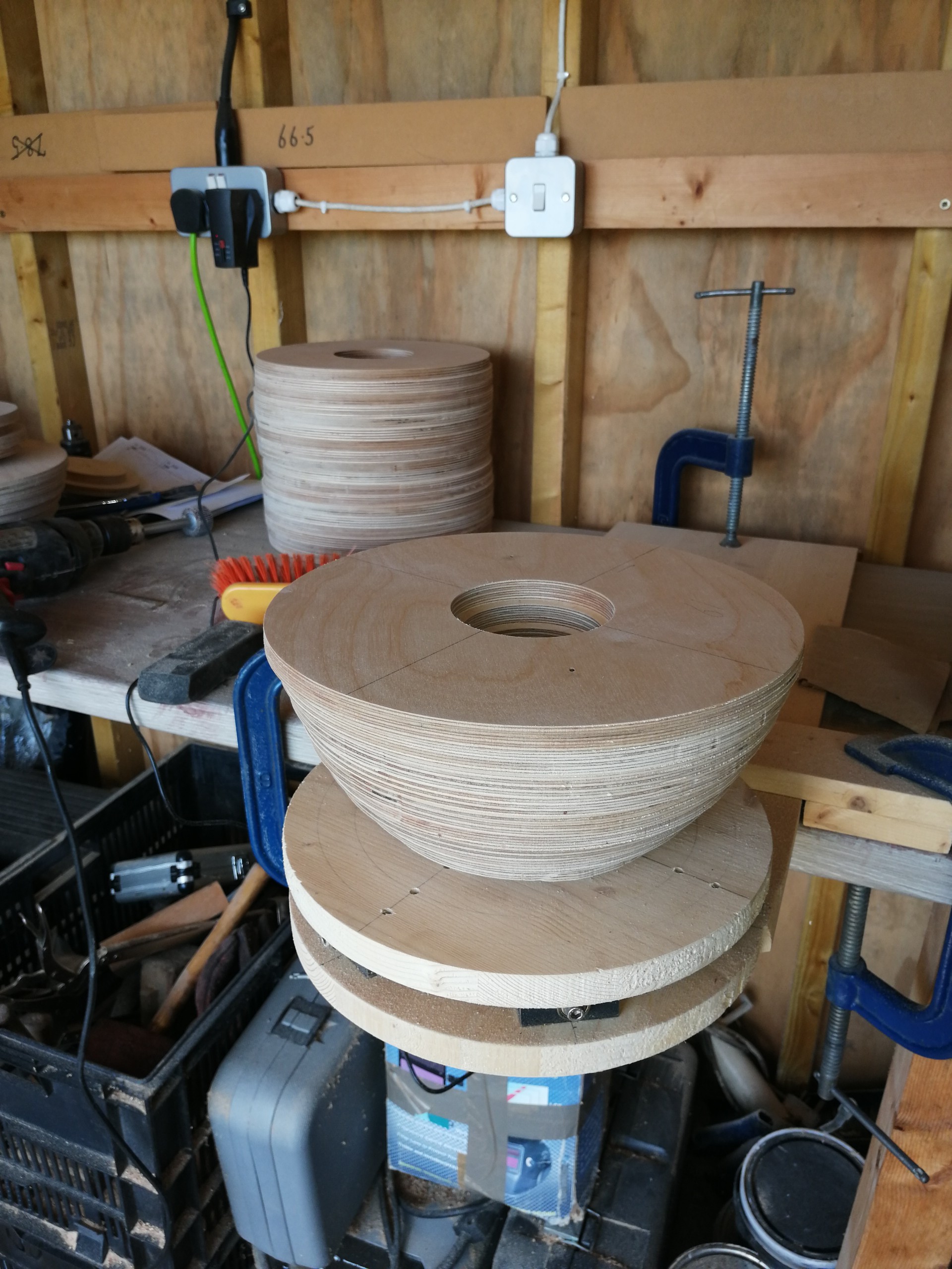

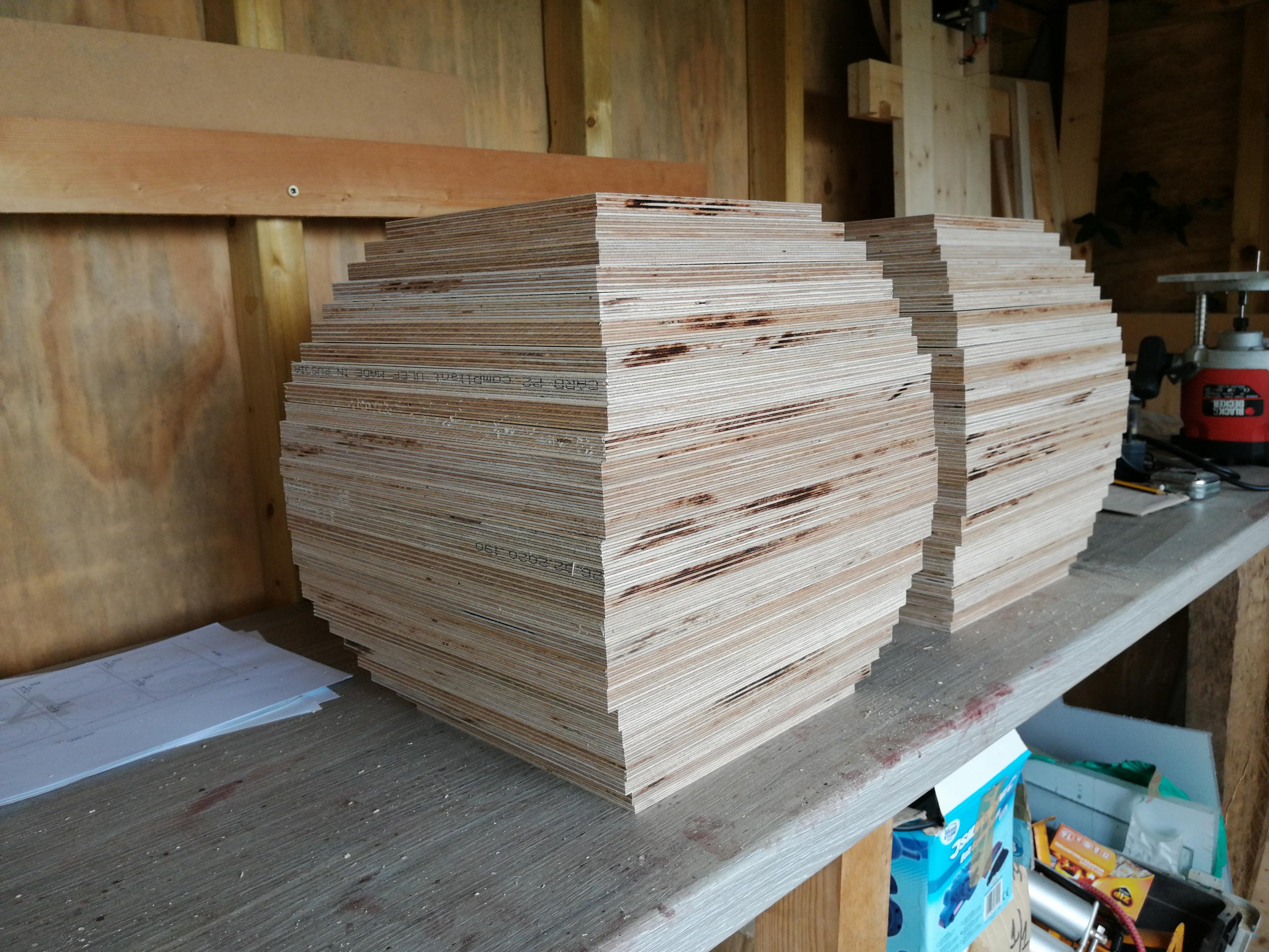

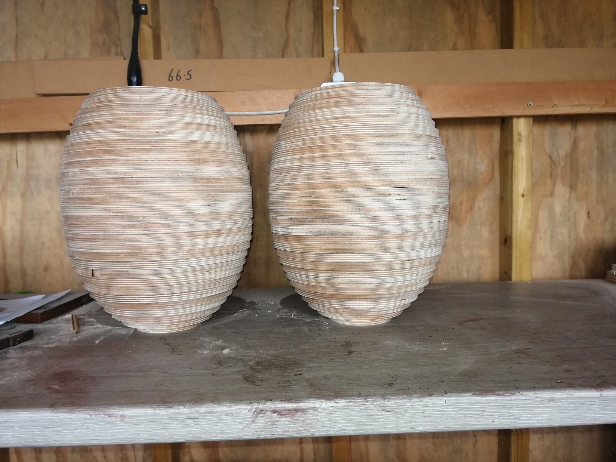

Stage two complete
Well that went more smoothly than I thought it would.
I have cut all the layers for both speakers. I haven't done any of the glueing yet, I've just stacked the layers to get a feeling of how they will eventually look.
They are looking pretty good so far. They do appear to be more elongated than I pictured. I'm hoping that they will look more rounded once the steps have been sanded.

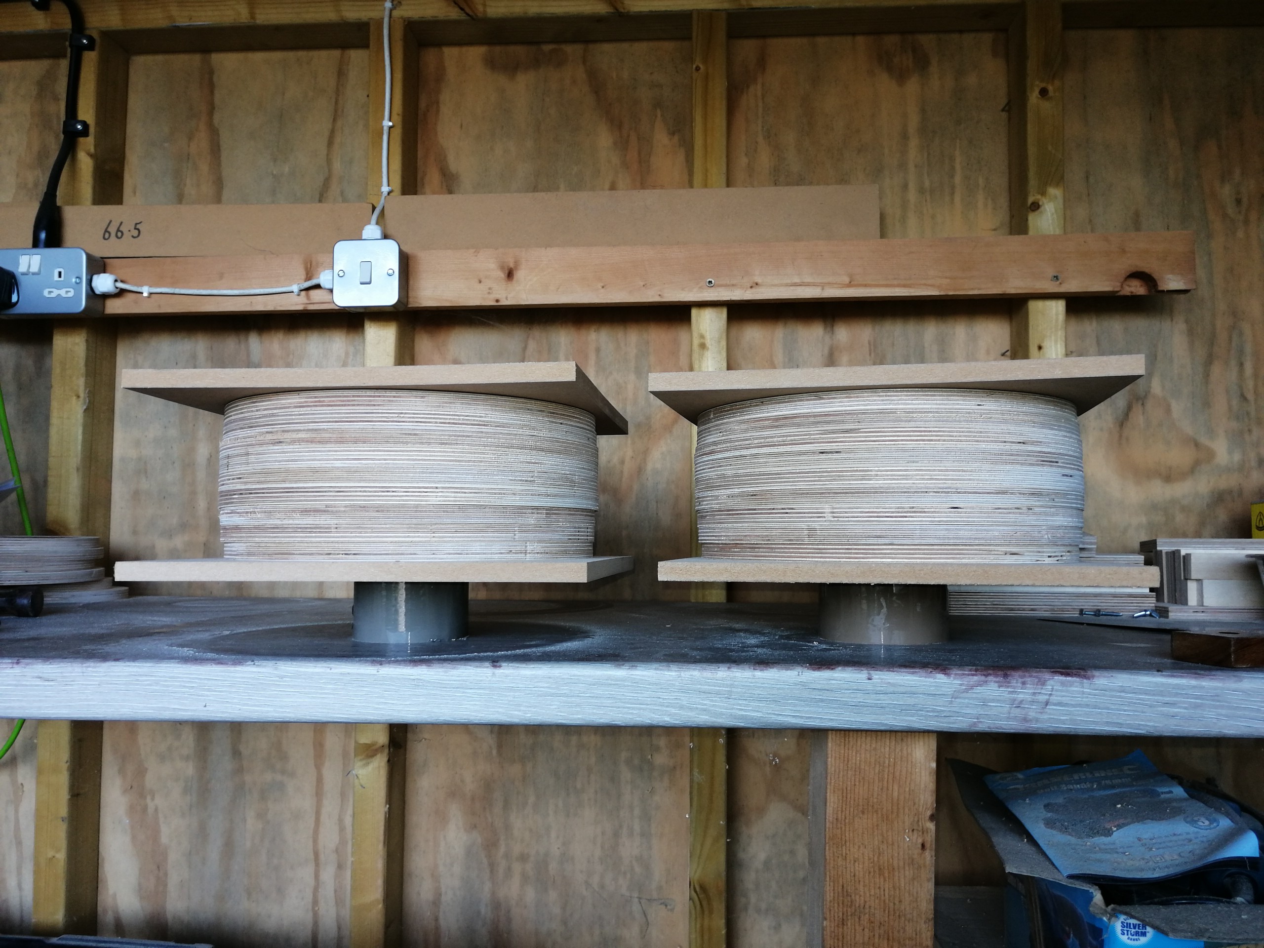

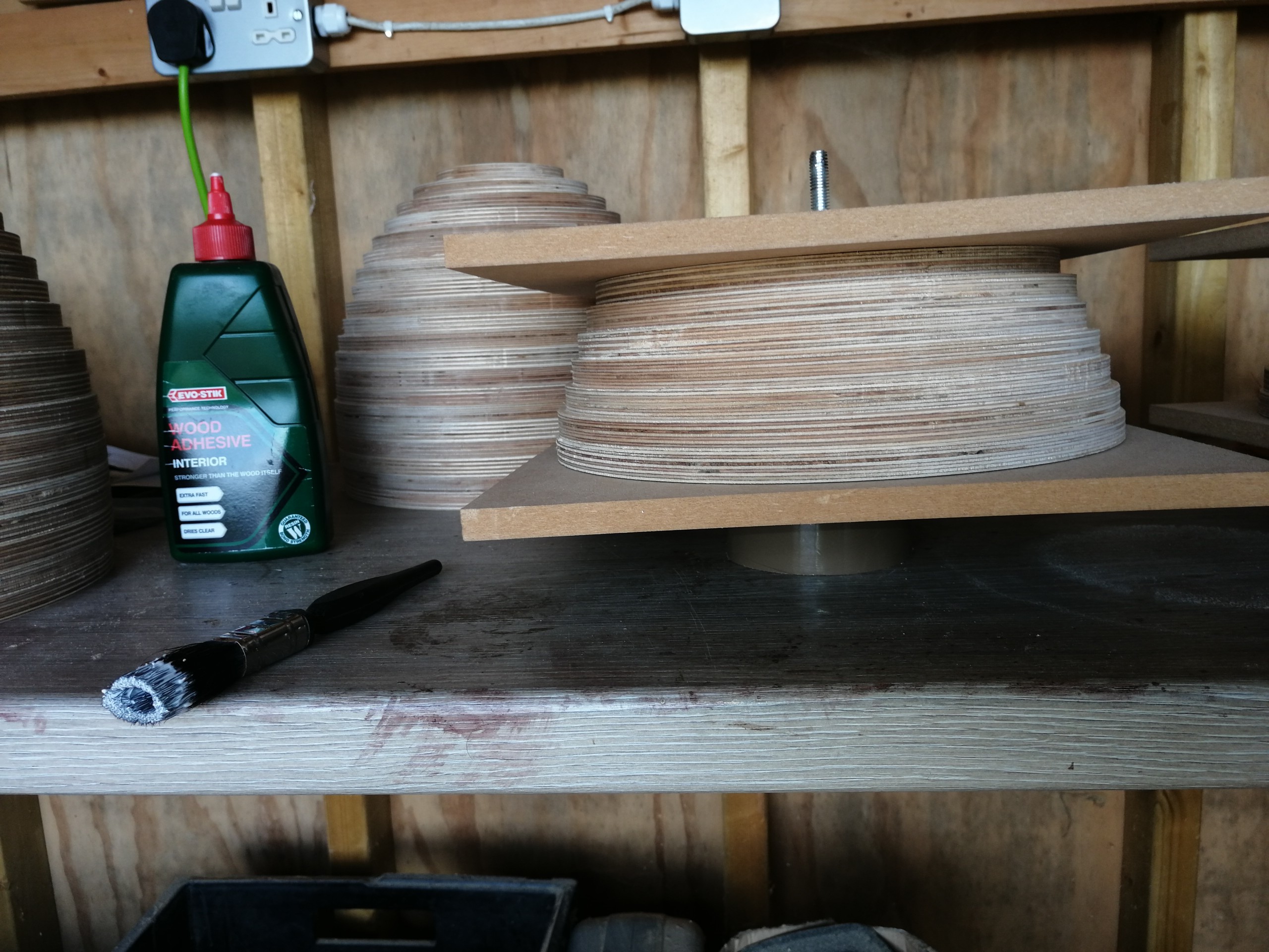

All glued up
I've glued all of the disks into the sections I outlined in my previous post. I was having so much fun that I forgot to photograph the glueing of the baffle, rear and back panels. I did take a couple of pictures of the front and middle sections. The method for all the middle sections is the same so this doesn't really matter.
A good layer of wood glue was spread onto a disk before the next was placed on top. The disks were aligned using the pencil lines I mentioned in a previous post. Each layer being rotated by 45° relative to the previous. The disks would have had a tendency of moving around as other layers were added due to the liquid layer of glue between them. To prevent this and ensure that alignment remained fixed a couple of panel pins were hammered through each pair of layers.
The clamps are made from 300mm squares of mdf. M10 threaded bars with nuts and big washers were used to clamp the squares either side of the glued up section. I misplaced my 10mm nuts so had to use wing nuts for the first couple of sections. Hooking a spanner over the wing nut still allowed me to tighten the clamps sufficiently. Luckily I found the nuts for the last couple of sections. The baffles and back panels were clamped using G-clamps and offcuts of wood. The glueing seems to have worked very well. The sections are good and solid.

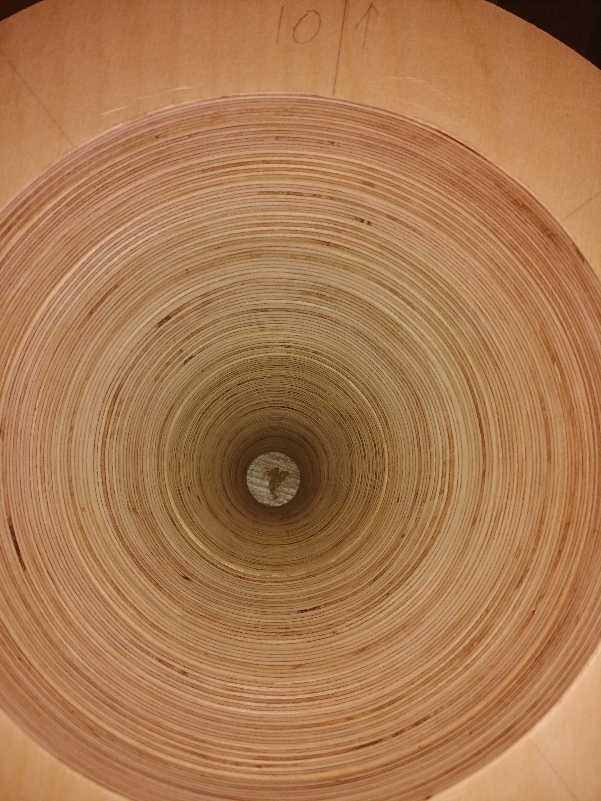

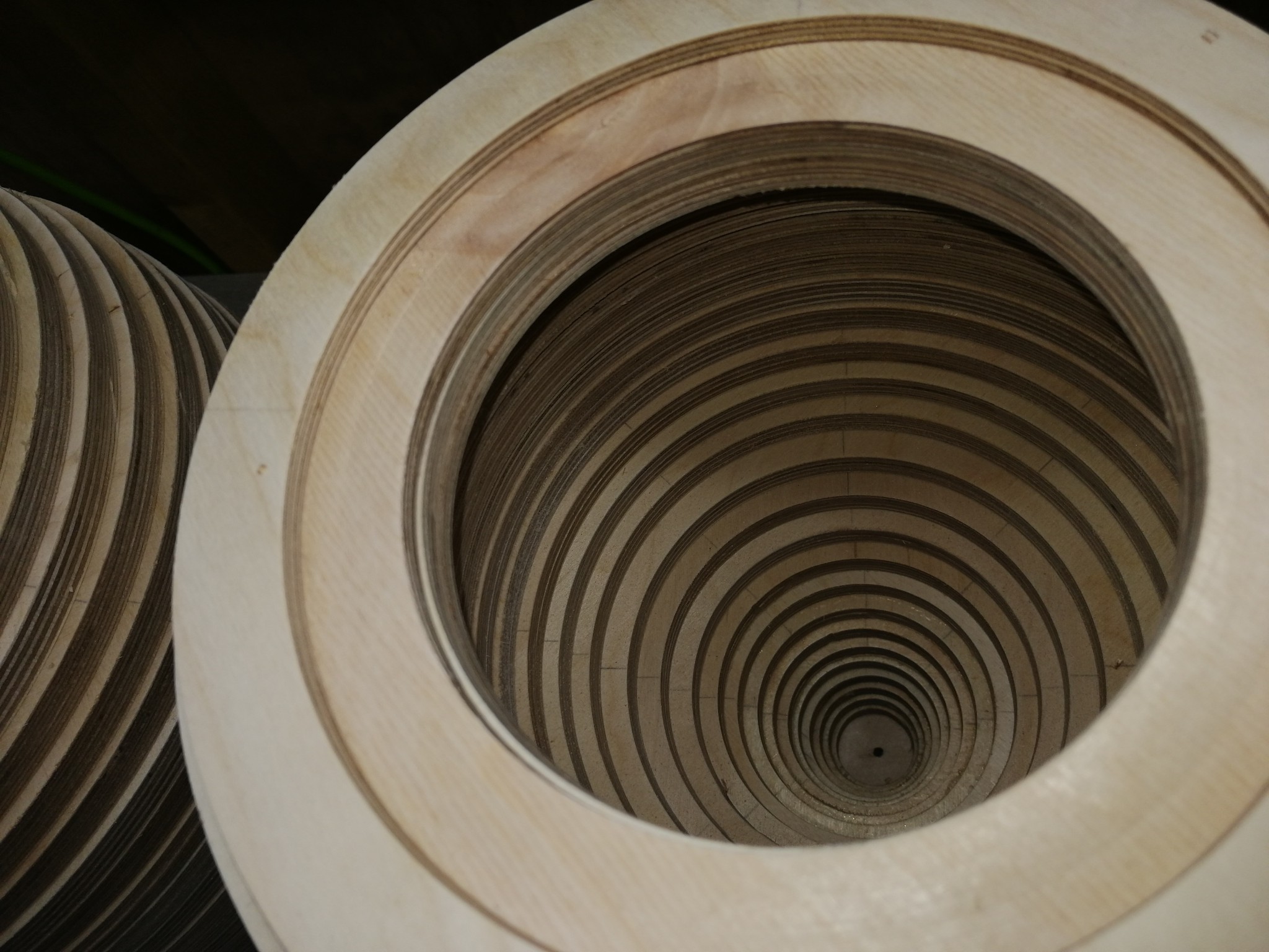

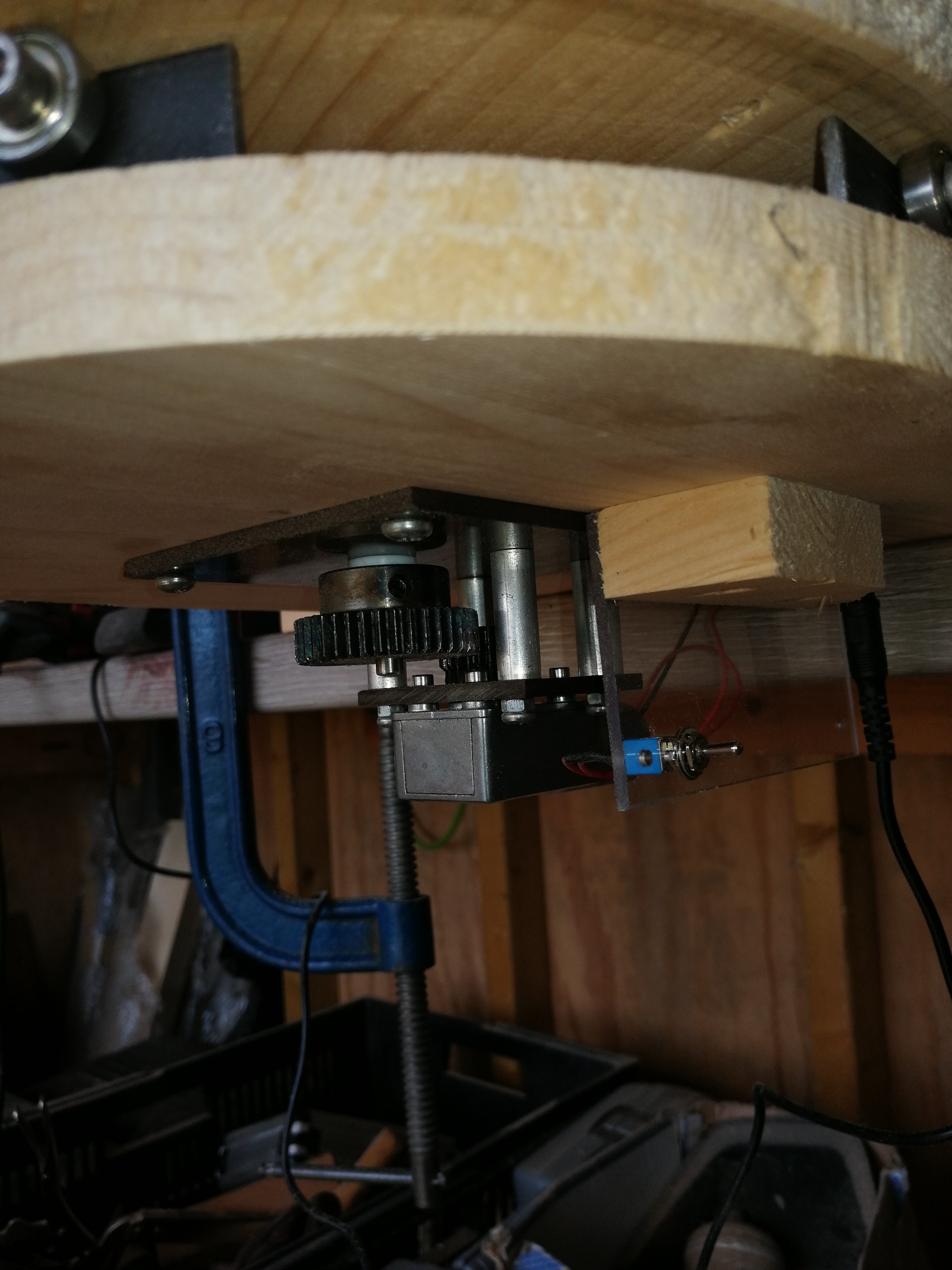

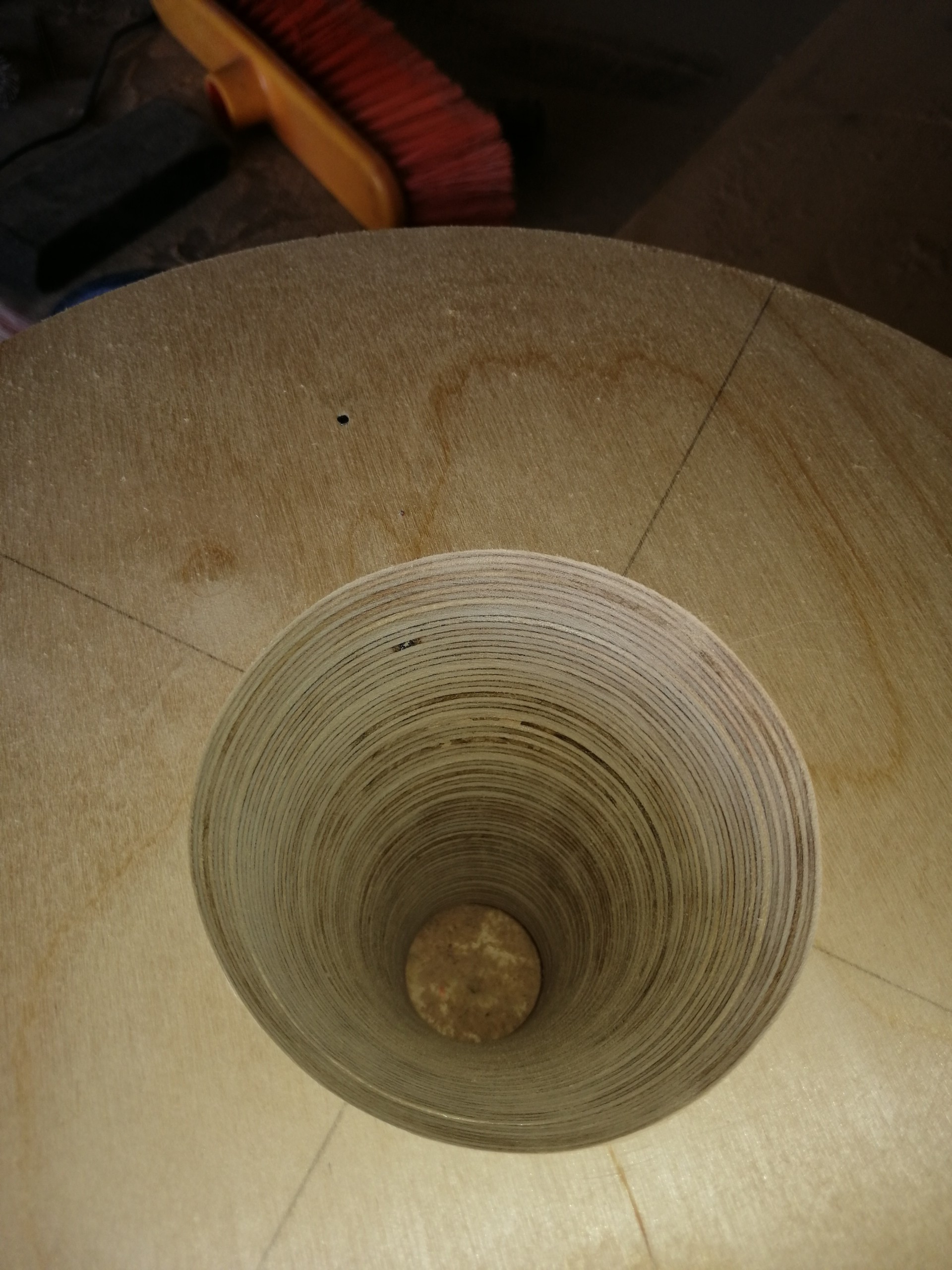

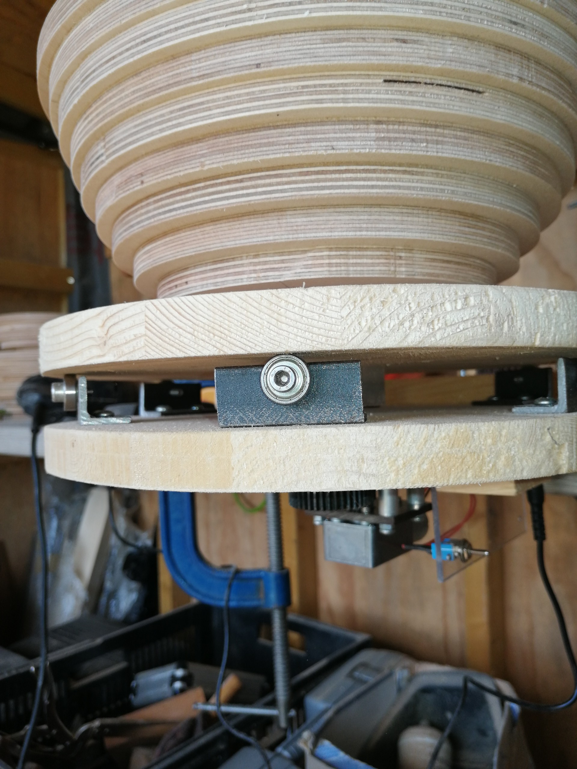

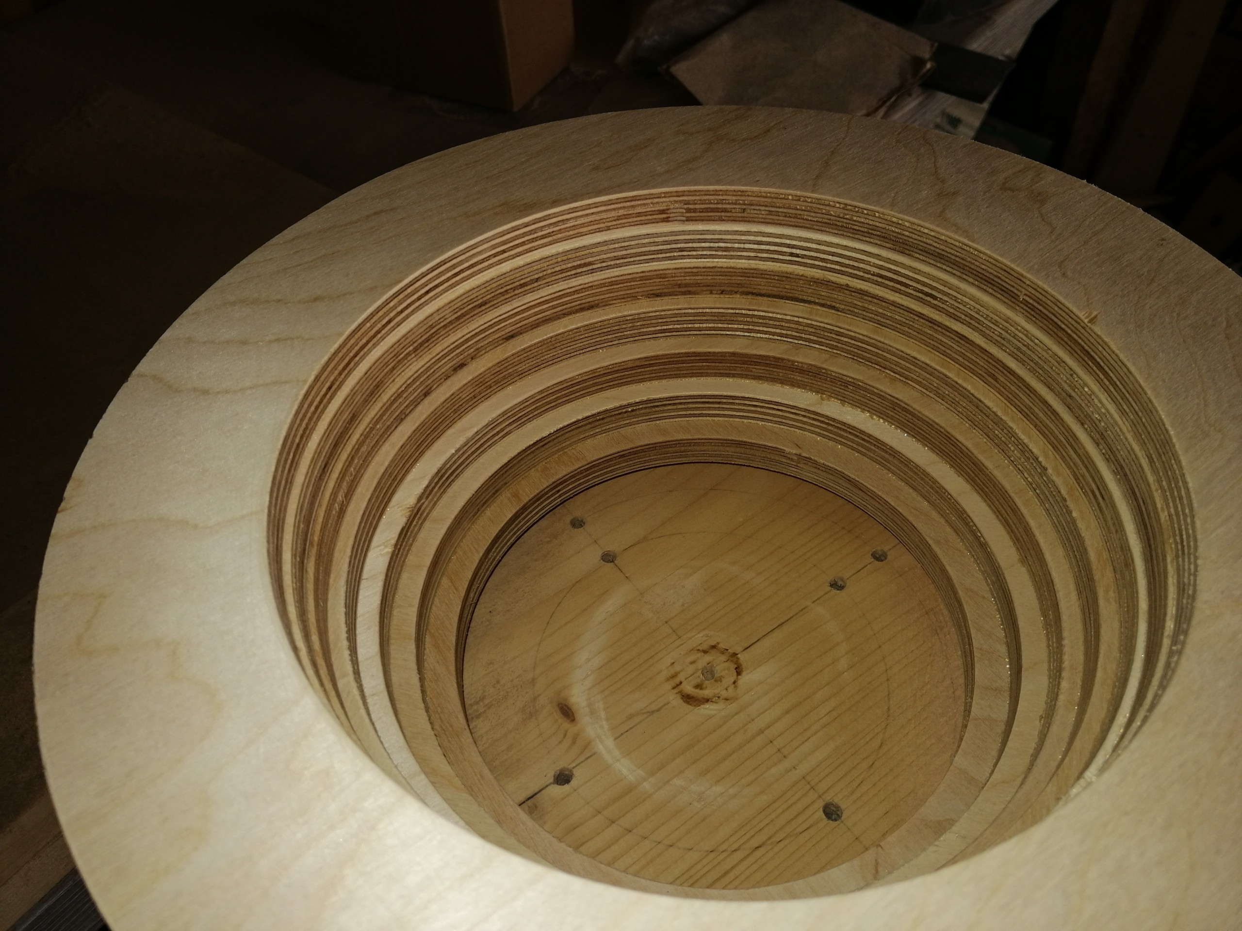

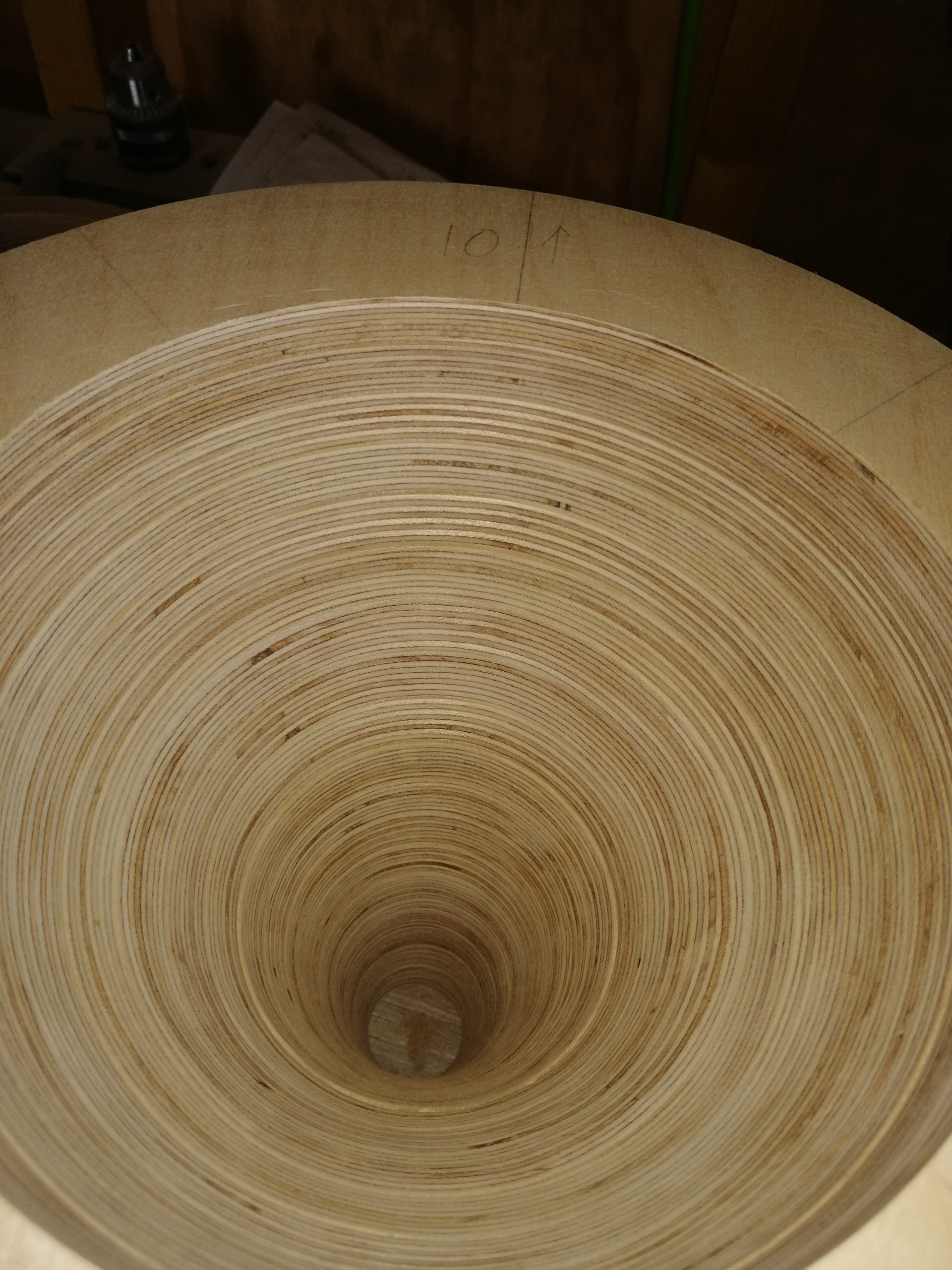

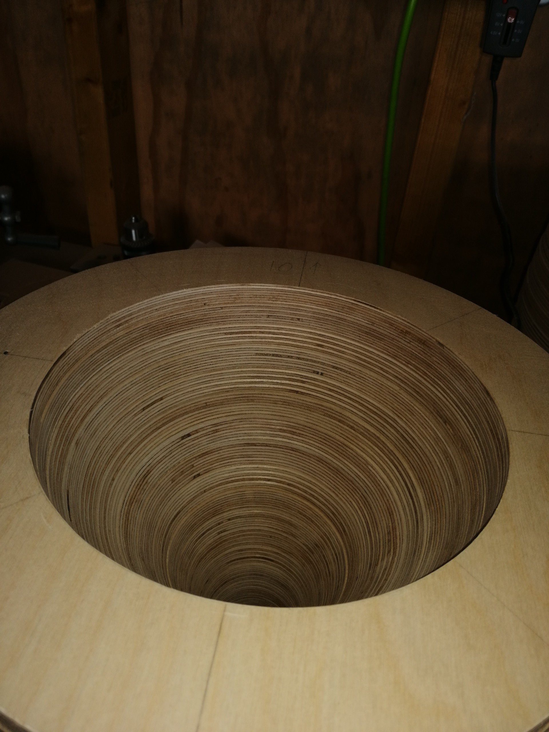

Internal profile
Hi all,
I have finished the shaping of the inside of the cabinets. To make this as easy as possible the I built a turntable that rotates the sections at about 30rpm. I can then use a flap sander attached to my drill to slowly smooth out the profile. The turntable was built mainly from my scraps bin. I also borrowed a motor and gears from my DIY record cleaning machine. This motor was from the rince cycle. The motor is mounted with a couple of bakalite plates, left over from the power supply boards of my power amps. This doubles up as the lateral bearing. The vertical load is supported on 6 ball race bearings that sit under the periphery of the turntable. These also prevent the table from tilting. These bearings were the only component that I needed to purchase for making this tool, everything else was from the scrap bin or repurposed. The sections were attached to the turntable with screws. Some of scrap left over from the centres of the disks were used as spacers.
The shaping was performed using flap sanders. These were attached to an extention rod so that they could reach the bottom of the sections. Several different sizes and grades of sanders were used. For the front section and the front of the middle section an angle grinder flap sander was also used.
The profile came out really accurately, the separate sections aligning with each other with only a tiny fraction of a millimetre error.
The final photo shows the front section before being profiled.
The next step will be to glue the middle and rear sections together and smooth out the joint and then varnish the inside surfaces.

Hi all,

Hi Dave,
The shape of the interior is designed so that all of the sound from the back of the driver is reflected into the narrowing section at the rear of the speaker. There are no surfaces angled to reflect the sound back towards the front. The rear section is filled with wadding material that has a logarithmic increase in density towards the back acting as an absorption line.
By smoothing the surface it should act as an acoustic mirror. If I had left the surface stepped there would have had a lot of surface that could reflect back towards the front. The idea of stepping the surface in order to break up the sound wave won't work on this scale as the steps would be far too small. To be effective the steps would need to be larger than a quarter wavelength of the sound being diffracted, a 12mm step would only be really effective above 10khz.
The aim is to minimise the amount of energy from the rear of the driver that can reflect back through it into the room.
