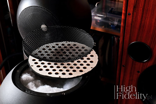

I was looking at pictures of Gradient 1.4 speaker and thought that one could make quite similar speaker using a full range driver. Stacking plywood would be an obvious option to create a spherical enclosure.

I've had a quick look at the Gradient speakers. This might be a difficult speaker to copy as the designer is giving very little away as to the internal structure.
It could be easy because the structure looks simple. There is a driver, some fill inside the enclosure, and some kind of acoustic resistance.
Hi Nikolas,
I was thinking more of the internal shape of the speaker. Is it spherical internally? The write up hints at a port as well as some form of defuser, which I guess is the perforated disc. How and where these are implemented is not clear. The write up mentions controlling dispersion from the rear of the cabinet. How this is achieved is not described.
I would suggest starting with a good full range driver, like the Jordan or Mark Audio. Calculate the ideal internal volume for your chosen driver and design your own spherical cabinet based on this. I would avoid making the inside a perfect sphere. With translam you can make the shapes anything you like. I would recommend making the walls quite thick as translam is not as rigid as using plywood as sheets.

But I don't know really. It could be a straight cylinder as well. An enclosure that is spherical from the outside should be good at avoiding diffractions. I think that Gradient was more interested about internal volume and distance between the driver and vent, and less interested in internal shape. The speaker seems to be well stuffed with some wool (polyester or something). It is a resistance enclosure.
What I have understood is that the acoustic resistance leaks and partially cancels sounds radiating wrong direction.
I see that translam allows very complex acoustical labyrinths. It is one possible way to make a speaker aperiodic. An aperiodic vent is another.
Maybe.

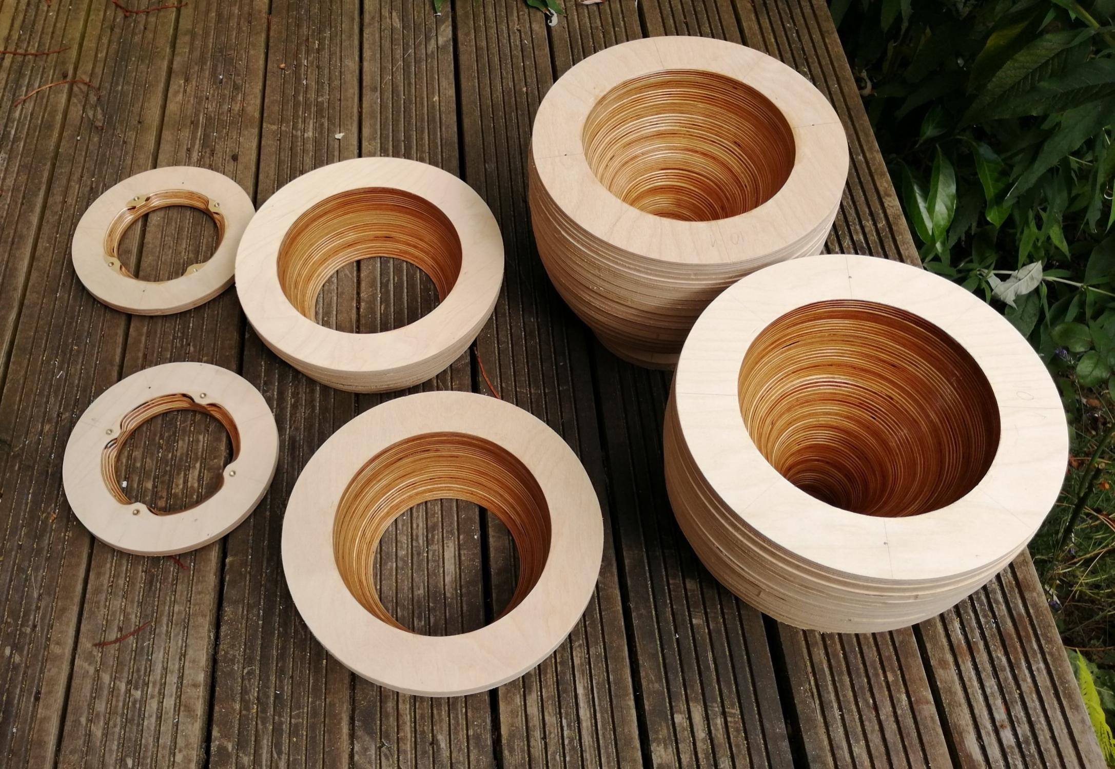

Internal finishing
I've glued the rear and middle sections together, sanded the joins smooth and varnished all the inside bits. I used a rustins satin finish clear varnish. It came out a darker colour than I had imagined. It is also a much nicer colour than I expected and much more fitting to my decor. Very fortuitous. I'll definitely be finishing the exterior to this colour.

Nice inserts. I used Araldite to glue E-nuts into the edge of ply to make rear panel of my VTL's removable, worked well

I found this side view of the gradient speaker.
Now it makes sense. The spherical cabinet has equal sized grills front and back with an aperiodic vent the size of the driver behind the rear one. I'm guessing that the interior of the cabinet is probably spherical.
A cabinet of this shape should be easy to construct using translam. Hopefully you can find suitable grills.

I've glued all of the sections together with the exception of the back panel. I'll give the glue a bit of time to cure then it will be sanding the joins smooth and a quick lick of varnish. The sections fit together very well so the sanding should be nice and easy. Smoothing the sections together like this will probably have no real effect on sound quality but I want to do it for completeness sake.
I haven't glued the back panel on yet so that I can screw into the rear section to attach it to the turntable. After the front is shaped I'll glue on the rear and attach the speaker to the turntable using the driver mounting inserts.

External shaping begins
I've started the external shaping of the first cabinet. So far I have shaped what will be the front 2/3rds of the cabinet. I started with an angle grinder sanding wheel. I've finished off with a palm sander and hand sanding. To the naked eye the shape looks perfect. Only when running my hand over the surface can I feel the slightest undulations. I'm afraid that if I try and smooth this out further I might muck up the shape. The undulations are so slight I'll probably leave it as is.
