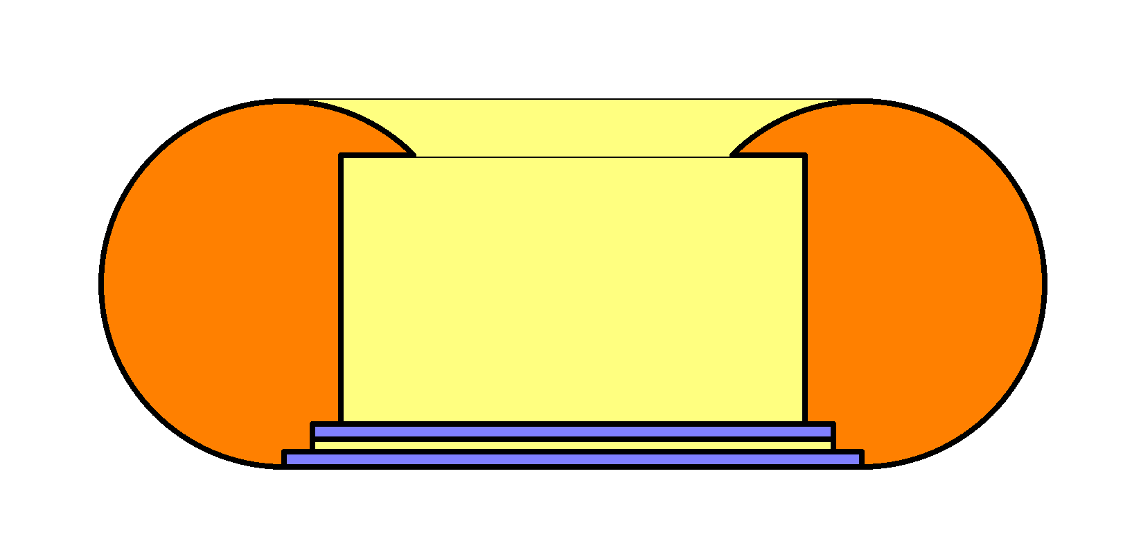

Not spherical, not elongated, but almost torus
The spherical enclosure becomes pretty if the grills match the shape, which seems to be what Gradient achieved. But I am not sure whether the enclosure would be otherwise optimal. I was thinking about a different shape.

Now it makes sense. The spherical cabinet has equal sized grills front and back with an aperiodic vent the size of the driver behind the rear one. I'm guessing that the interior of the cabinet is probably spherical.
A cabinet of this shape should be easy to construct using translam. Hopefully you can find suitable grills.

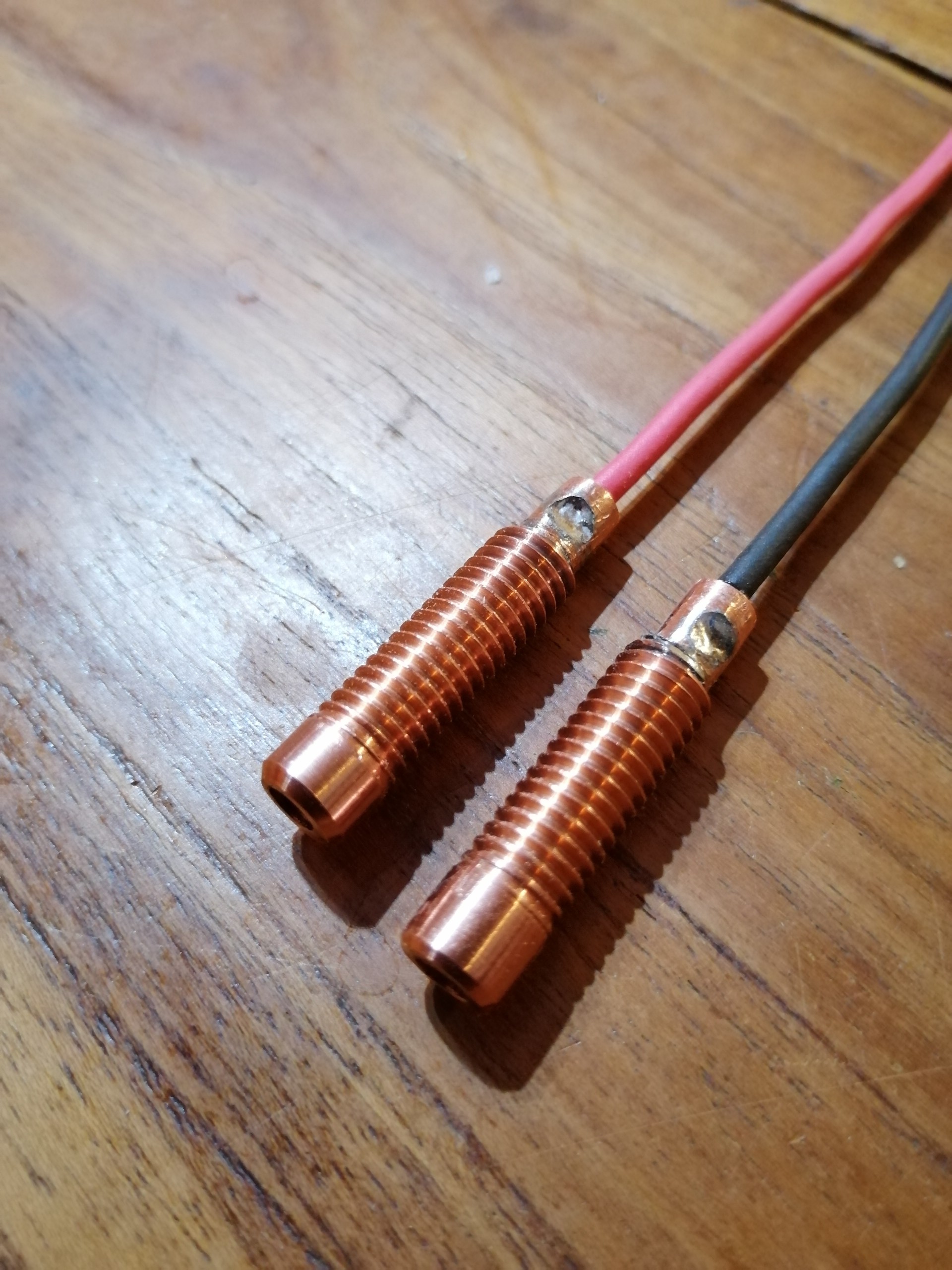

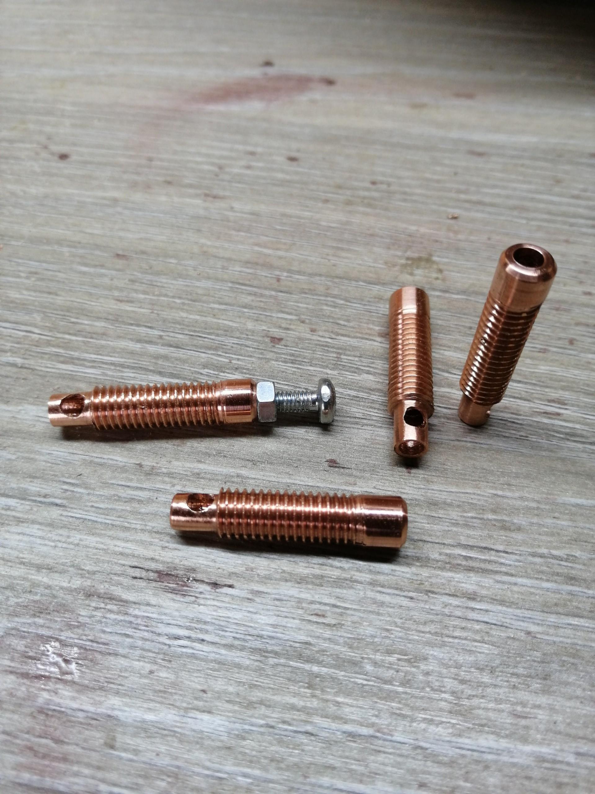

In between coats of varnish I've been working on the input sockets. I want the sockets to be as unobtrusive as possible and not spoil the smooth lines of the cabinets. Traditional binding posts would be far too bulky. I decided that the best route would be 4mm sockets (for banana plugs only) flush mounted. Predictably, I couldn't find sockets like this so I made my own. The cabinet walls are about 100mm thick at the point where the sockets will be fitted so mounting from the inside will not be possible. I have made the sockets from 8mm pure copper rod. The sockets are 35mm long and externally threaded so they can be screwed into the cabinet from the outside. The last 5mm is left untreated so just a small button can be left protruding. The back of the socket is a solder bucket. Behind the 4mm socket section is a short M4 thread. This allows a bolt with locking nut to be used to drive the socket into the cabinet, and remove it again if required.
These were total pigs to make. Pure copper really snatches and binds on the tools. I now know why tellurium is added by most manufacturers of copper posts and sockets.

Many manufacturers of binding posts and phono sockets offer unplated pure copper versions. These don't seem to suffer oxidation problems. The plugs I have purchased are a good snug fit so hopefully won't allow an oxide layer to form at the points of contact.
