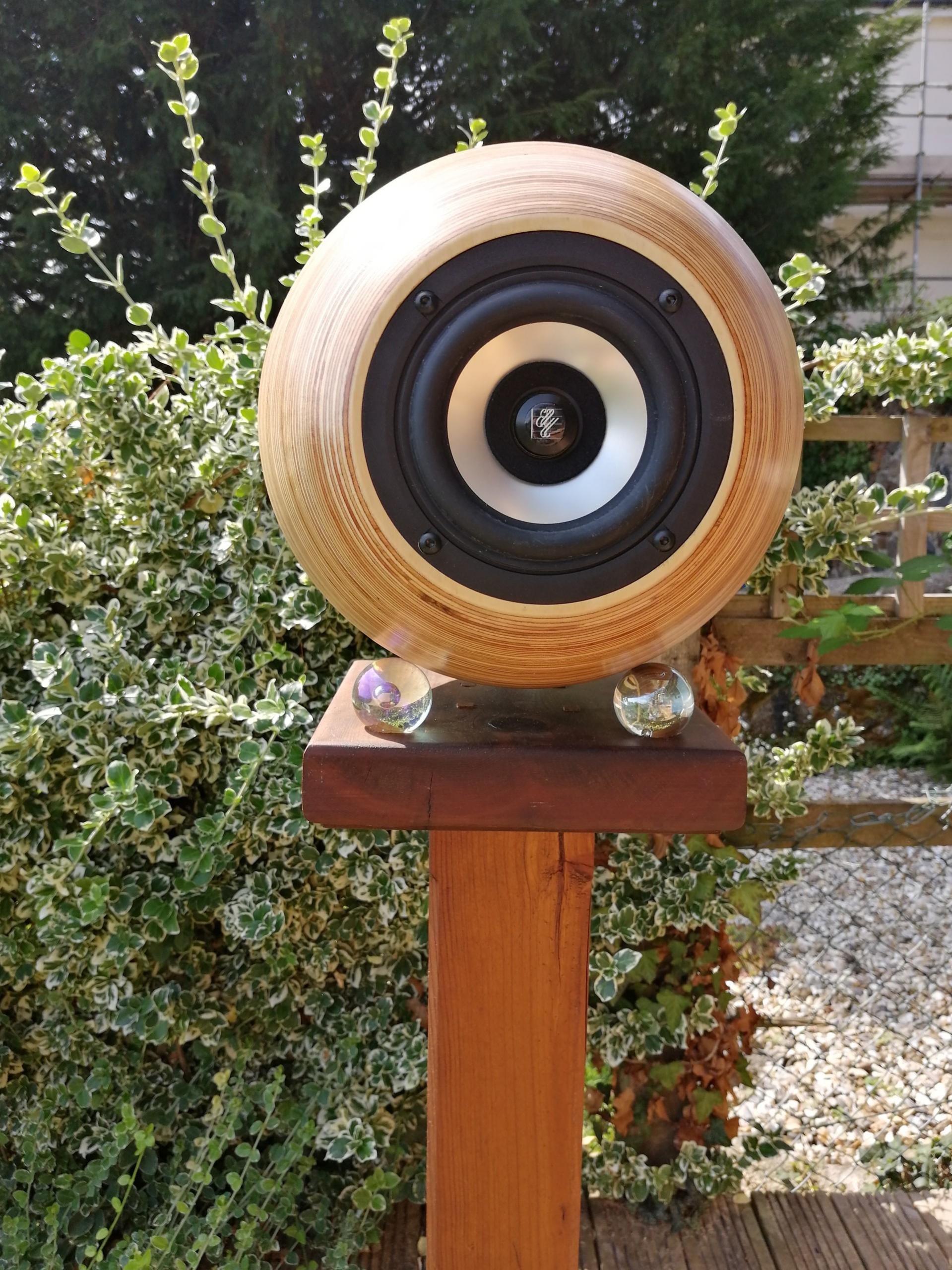

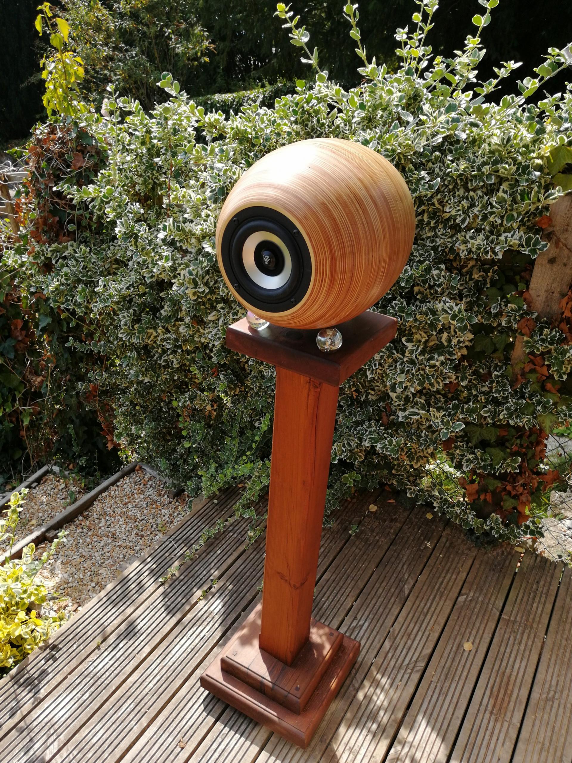

As far as balancing or suspending the speakers... The easiest way is to show you a speaker sat on a stand.

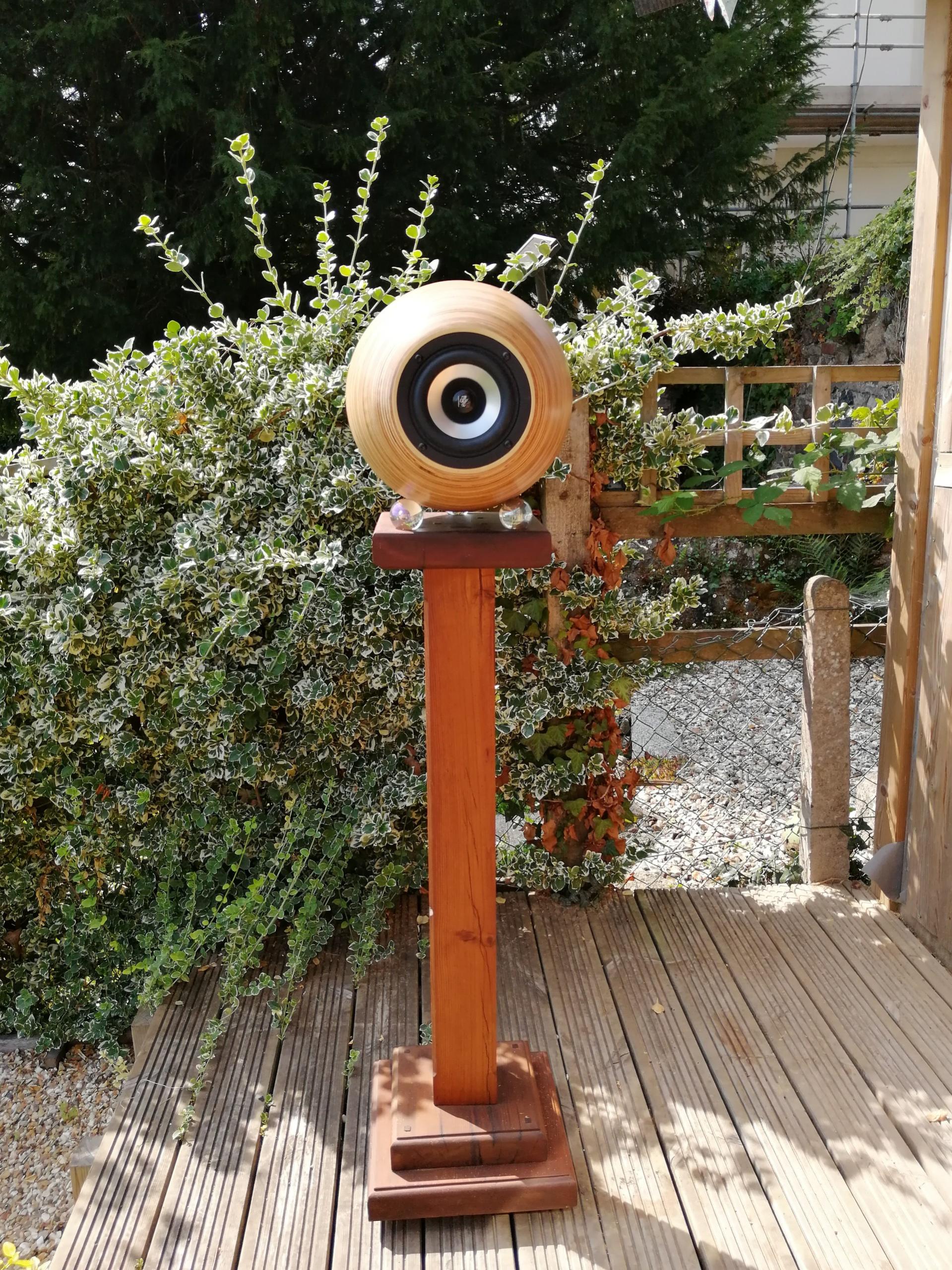

I'm using the stands that I was using with my previous speakers. They are solid wood and were probably originally designed as plant stands. I found them at a local recycling centre and picked them up for pennies. I added adjustable spikes to the bottom. The stands are tall. The centre of the driver is about 200mm above ear height. For these speakers I added 3 large marbles, I live just around the corner from the house of marbles. These hold the speaker nicely and allow it to be tilted. I rather like having the speakers slightly above ear height and tilted down. I find it helps to give a more natural soundstage, many megabucks speakers have this arrangement. Look at the Wilsons.
The stands do work with the speakers visually. The solid wood construction might not be the best sonically. With the speakers mounted on the stands a knuckle rap on the cabinet has a slight woody sound. I think this is the sound of the stand. It might have been a better idea to use squash balls rather than marbles as this would have helped to decouple the speakers from the stands. The marbles do look good.
I've reterminated my speaker cables with banana plugs at the speaker end. The cable is run up the back of the stand and held in place with cable clips so is virtually invisible.

The marbles are inspired... creative, even.

The marbles are also quite widely spaced out so the centre of mass is well within the triangle produced.

It looks a bit precarious to me. Could this cabinet shape be turned on a lathe out of a single piece of wood?
They are probably less precarious than most stand mounted speakers that sit on spikes or cones.

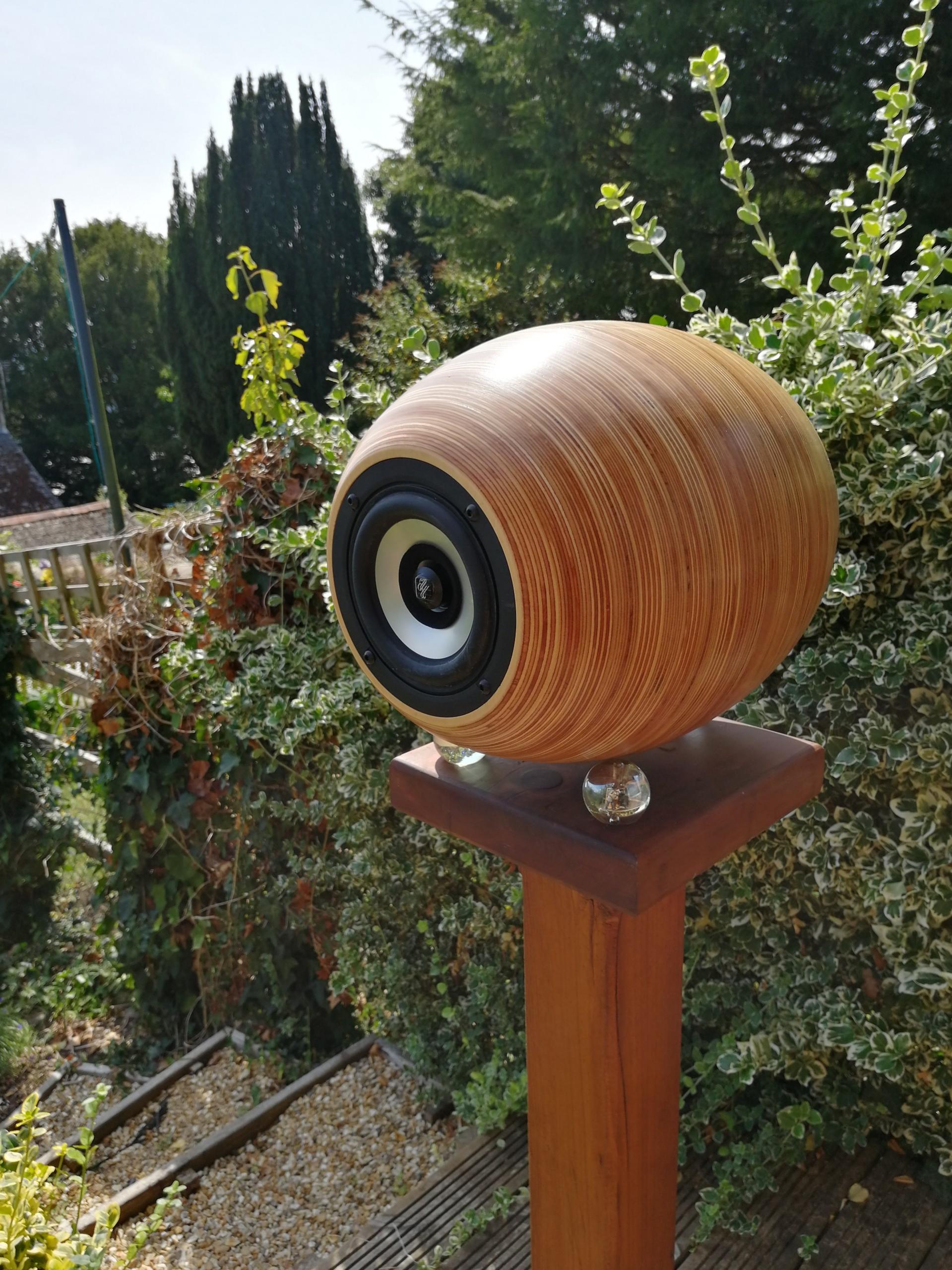

It could indeed be turned on a lathe, either from a single piece of wood or from a block made of translam. As I don't own a wood lathe or have the necessary skills I decided to use flap sanders and a slow turning turntable. I could possibly have achieved a better finish with a lathe but it might have been more difficult to get the shape right, especially the inside. I think that translam will be a better option sonically but a solid piece of wood, especially something like burr walnut, would look amazing.

The idea of making the inside smooth is to make it act as an acoustic mirror so that all sound is reflected towards the rear and none is reflected back towards the front. The internal wadding increases in density towards the rear. The idea is to absorb rather than scatter the energy.
