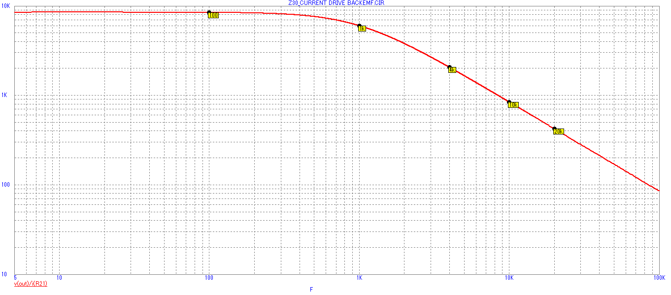

@RNMarsh: your post disappeared, however, I am posting a simulation of Zout of the amplifier that I use as a current output amplifier. Basically it is a VFB amplifier with Rf/Rg = 25k/1k. Output impedance reflects loopgain, or in other words openloop frequency response and Rf/Rg, not absolute values of Rf and Rg. Rf would be reflected if it was a CFB amp. But the output impedance reflects Rshunt as well (reference resistor)! The lower Rshunt, the lower Zout.
We can see that Zout is about 8.5kohm at 100Hz and 850ohm at 10kHz. Cut-off frequency about 1kHz.

1audio and keantoken, thanks for you explanations - I think I understand how it works now.
PMA - why didn't you make your amp low impedance in the bass and high in the treble? Wouldn't that make sense given where the bigger resonances are?
This amp's purpose was to check effect of current drive to distortion. The output impedance curve is Rshunt*loopgain.
