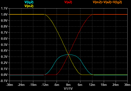

I'm trying to implement the BL curve. But actually it's either the B curve or the L curve, not both at once. From the coil's perspective it is a B curve. From the magnet's perspective it is an L curve.
I realized that until the coil actually begins to leave the gap, the number of turns in the gap are constant. The only thing changing is the number of turns outside the gap. So the modulation must come from these stray turns. Of course an underhung voicecoil must be thought of differently.
So I can model L as constant, while the proportion of L in different flux loops changes. Attached is a graph for a overhung voicecoil with the gap 1/3rd the thickness of the coil. The number of turns in the gap is never more than 1/3rd of the total L. The curves come from LTspice's smooth limit function, so they are not necessarily realistic, but are an acceptable approximation for now.
Furthermore, I have a theory about Le. I think Le is actually larger outside the motor. After all, the skin depth of steel at 60Hz is in the hundreds of micrometers, acting more like a shorted turn than a magnetic core. We really aren't measuring the inductance of the voicecoil, but rather the inductance of the pole piece. If I'm right, the inductance increases inside the motor because of getting away from the steel and closer to the magnet, and if the Le plot was extended to higher excursion the Le would rise a bit. This also means that possibly motor reluctance could be crudely extracted from the difference in inductance at positive and negative xmax.
I realized that until the coil actually begins to leave the gap, the number of turns in the gap are constant. The only thing changing is the number of turns outside the gap. So the modulation must come from these stray turns. Of course an underhung voicecoil must be thought of differently.yes for the most part.
Furthermore, I have a theory about Le. I think Le is actually larger outside the motor. After all, the skin depth of steel at 60Hz is in the hundreds of micrometers, acting more like a shorted turn than a magnetic core. I suspect there's a problem there. Le is smaller without the pole piece as a core.We really aren't measuring the inductance of the voicecoil, but rather the inductance of the pole piece. If I'm right, the inductance increases inside the motor because of getting away from the steel and closer to the magnetmost speakers I see have a steel back plate. It's leaving the gap that is important., and if the Le plot was extended to higher excursion the Le would rise a bit. This also means that possibly motor reluctance could be crudely extracted from the difference in inductance at positive and negative xmax.

I have a weird problem with the model. I separated it into 3 flux loops. One loop outside the gap, one loop inside the magnet. The problem is that the portion of the coil in the air generates it's own motional EMF from the B field generated by it's current.
Obviously you don't produce EMF by just waving a coil around in the air, even if it has DC current.
It seems the difference is that when the coil is in the gap, it's field is concentrated and held stationary while the coil moves.
So now this makes me wonder if even the portion of the coil in the gap produces it's own slight field through the permeability of free space, which moves with the coil. This means that if the gap has a permeability of 10, 1 of that is free space and doesn't generate motional EMF whereas the remaining 9 is coming from the gap.
