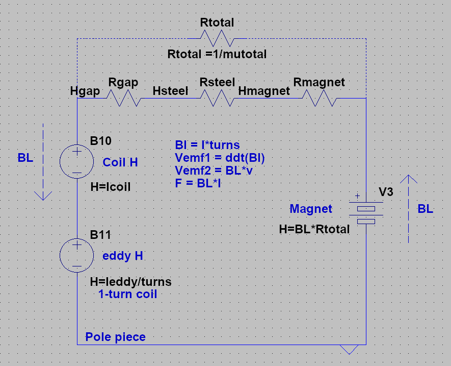

How does this look? I was meaning the air dominates because it is harder to magnetize than anything else. But maybe it doesn't matter if the gap is small.
Since current modulates BL via reluctance, the amount of BL modulation we get depends on the reluctance/permeability of the motor. If I knew the reluctance, permeability (at as low a frequency as possible) or magnet H, I could pin it down. Estimating air inductance of voicecoil Le(x) graphs suggests permeabilty is above 2 which is the closest I got. But now I'm starting to suspect it's much higher than 2 and the Le(x) charts don't get near air inductance.
I have the eddy currents responding to absolute value of current. They also modulate BL, as any current in the flux loop would. But oddly enough none of the magnetic nonlinearities I've added are generating dominant 3rd harmonics.
Since this is probably the 3rd or 4th transformation of the model I haven't re-implemented Le(x) yet.

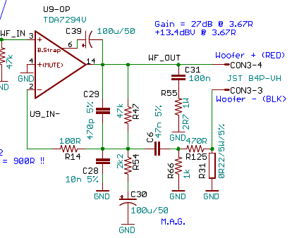

Attached is a scheme I once used in a product with ordinary small woofer with Qes ~ 0.4 or so, ported cab. Simple inductive slope starting at zero Ohms, HF stability (Zout peaks and gets capacitive above a certain freq), unity gain at DC.
This is pretty similar to what I already have in simulation. What is R14 for?

Just a safety resistor.This is pretty similar to what I already have in simulation. What is R14 for?
EDIT: And, the compensation sure isn't SOTA ;-) and likey is a cause for trouble in a general-purpose amp with unknown load, cable capacitance etc.

It sounds like I neglected to model a second important flux loop, the flux loop of the coil which moves with it. This might fill in some puzzling blank areas in the model. This way the coil and magnet will both be modeled as complete magnetic systems.

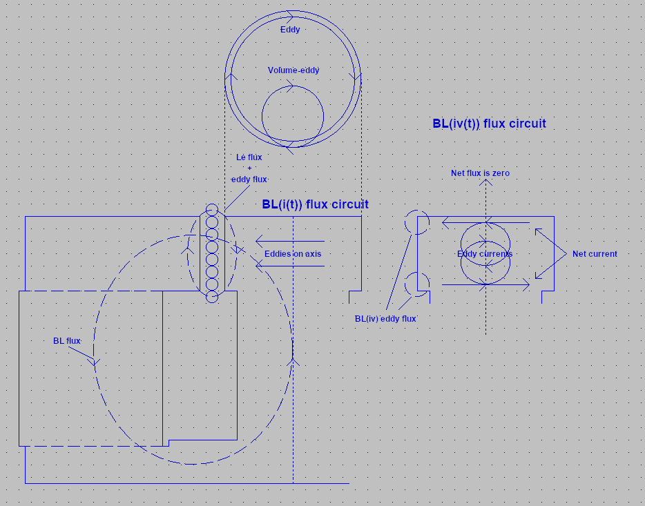

I've made a crude diagram of the flux circuits and eddies as I understand them.
One thing that keeps tripping me up is the difference between what happens when BL changes and when the BL is physically moving. I have to keep reminding myself that a physically moving BL does not directly cause eddy currents, rather a physically moving BL causes induced voltages, which then produce currents depending on conductivity.
