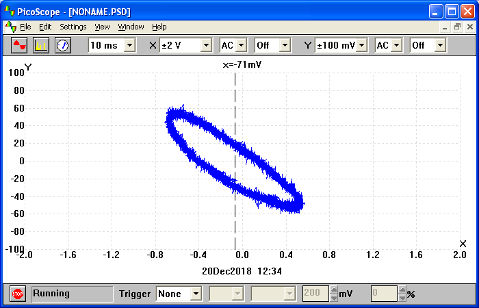

I need you to be clearer on "diff signal" so I measure the right place. I already went off in the wrong direction once. I can get waveforms and may be able to get an X/Y display (not sure yet).
With the top terminals of the coils connected together and to the amplifier output, the difference is the voltage between the other ends of the coils.
Since the drive coil is connected to ground, the pickup coil end shows the distributed resistance of the drive coil, ignoring all reactive voltage caused by the intimate coupling of the two coils.
I can see using this difference as a diagnostic tool. Useful for examination of the coil resistance including eddy loss equivalent resistance and acoustic transfer equivalent resistance, both during voltage drive as well as during current drive.
I did not mean x/y. I meant two waveforms on a two channel scope.. Top trace being drive signal, that being either voltage out of the amplifier, or current through the current drive system, and the second being the difference signal.
An x/y would be capable of displaying non linearity quite clearly, especially with current on one axis and difference on the other, that's not a bad idea, I like it.
jn
Attached is an XY plot. Current is Y, difference voltage (input to feedback resistor) is X. 45 Hz, about 2V drive. Not sure about current calibration, it should be 100 = 1A but I'm not certain. Clearly some phase shift.

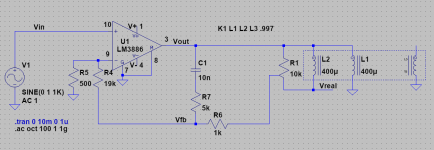

You could drive the speaker with another speaker and measure the difference between voicecoils. This way we know how well the voicecoils are matched and can better judge the results from subtraction.
Also the second voicecoil output could be scaled in the measurement to null out mismatch. Put a trimmer across it and take feedback from the wiper, measure at the end of the coil. Or if the mismatch is negative, take the measurement at the wiper. One of these should provide a better null.
R1 is the trimmer. It works if the feedback coil is slightly larger than the other coil, so you may have to swap coils.
I think 10k is a good value since it is at least 1000x Re. The impedance of the trimmer shouldn't affect the feedback too much unless the coils are grossly mismatched.
EDITed for trimmer value. 100k might actually be better, the better the coils are matched the higher value trimmer you can use.

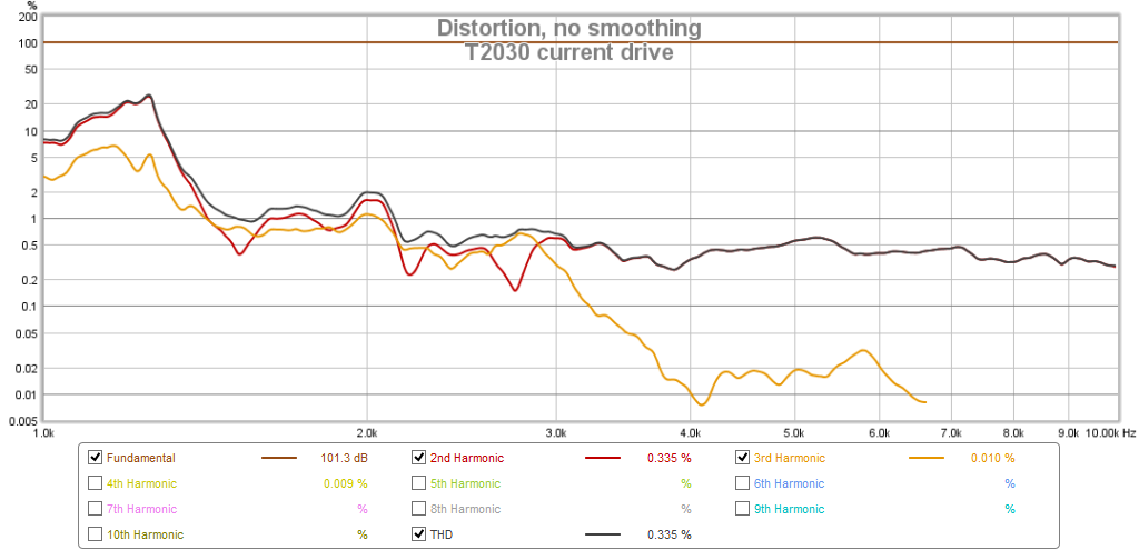

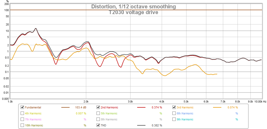

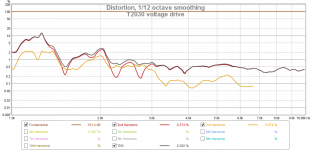

If I am allowed to put my 12 cents, I would do this (as attached):
- measure THD (H2, H3) vs. frequency under standard voltage drive,
- measure THD (H2, H3) vs. frequency under current drive or with DVT correction, whatever you have available.
In my case, Beyma T2030 tweeter (resonance about 900Hz), we can see that H2 under voltage x current drive is almost unaffected. But, above 4kHz, there is a really dramatic decrease in H3 distortion for the current drive. This was shown in my previous twin-tone IMD measurements. So, if you make a H2/H3 vs. frequency, you may find where the distortion correction works and then make a FFT there.
