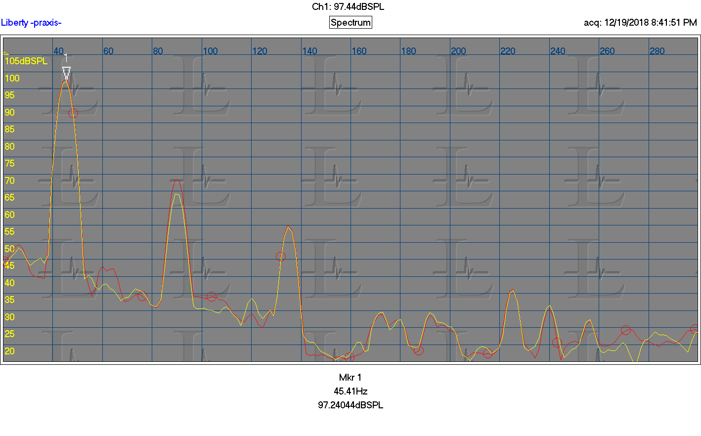

Here is a low frequency harmonic test. In this test it seems H2 is increased. The yellow trace is voltage feedback and the red trace has the "correction" coil added. I'll do a low frequency IM test in the morning. I'm a little baffled that IM can improve and HD not since the underlying mechanisms are the same. Maybe the one that has maximum impact on IM is improved but the nonlinearity that impacts harmonics isn't.

Interesting. This is at 2/3rds it's free air, so the "mass" mechanism is different.
I note as well, you do no compensation that others used to control that rise in this area.
Do you have waveform capture? It would be good to see a voltage drive and diff signal at varying frequencies, as well as current drive/diff voltage vs freq.
Above resonance we are driving the cone mass, below it the forces required are automatically H2.
Jn
If one put a capacitor in series with the tweeter - will the distorsion reducing effect disappear?
I was thinking about it and am not sure yet. I will probably test it.
Regarding presence of 1 kHz difference tone in my tweeter test, asymmetric distortion, I do not assume it is a result of eddy currents, but I think it is a result of Kms stiffness asymmetry with displacement, in the tweeter.

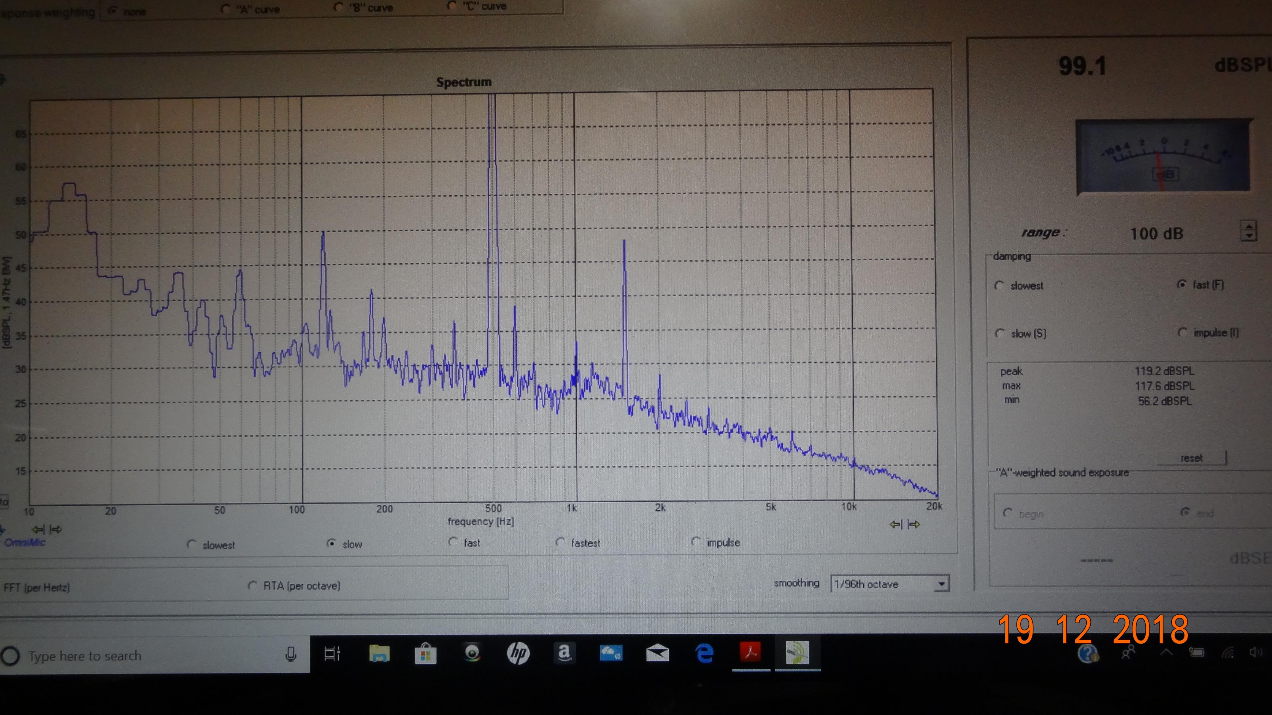

Well, I just started to test and it seems like I bought a decent 10 dollar driver. The 2H is very low and only 3H shows. measured at 5cm and 100 db spl.

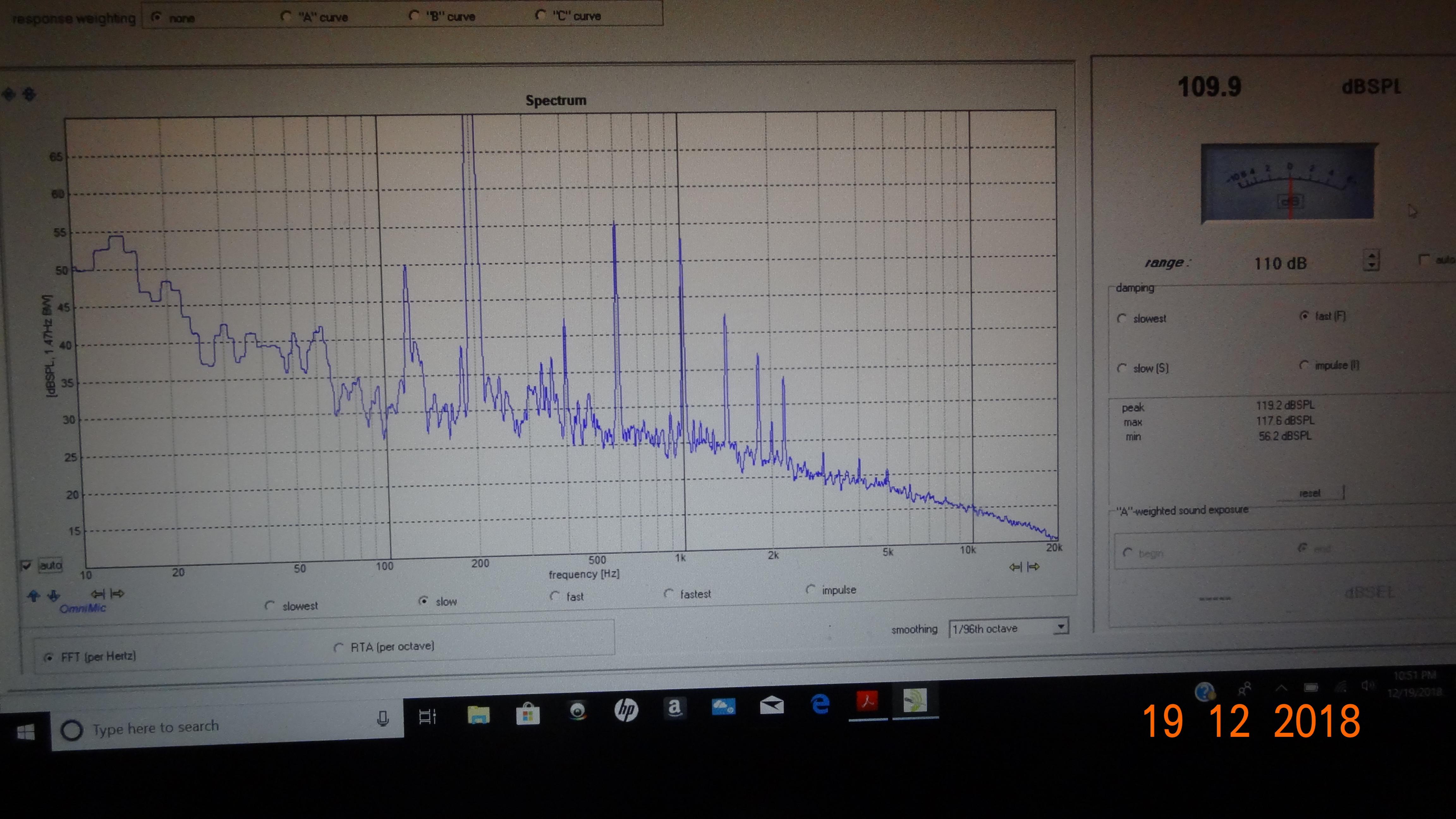

If I push it to 110 db spl I start to see more 2H and 3H ++ but it might be the microphone spl limit also. have to check.
100db spl
110db spl
Might have to get worse drivers....

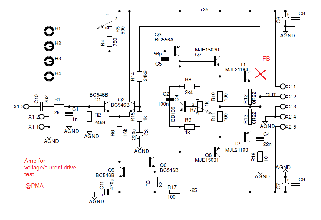

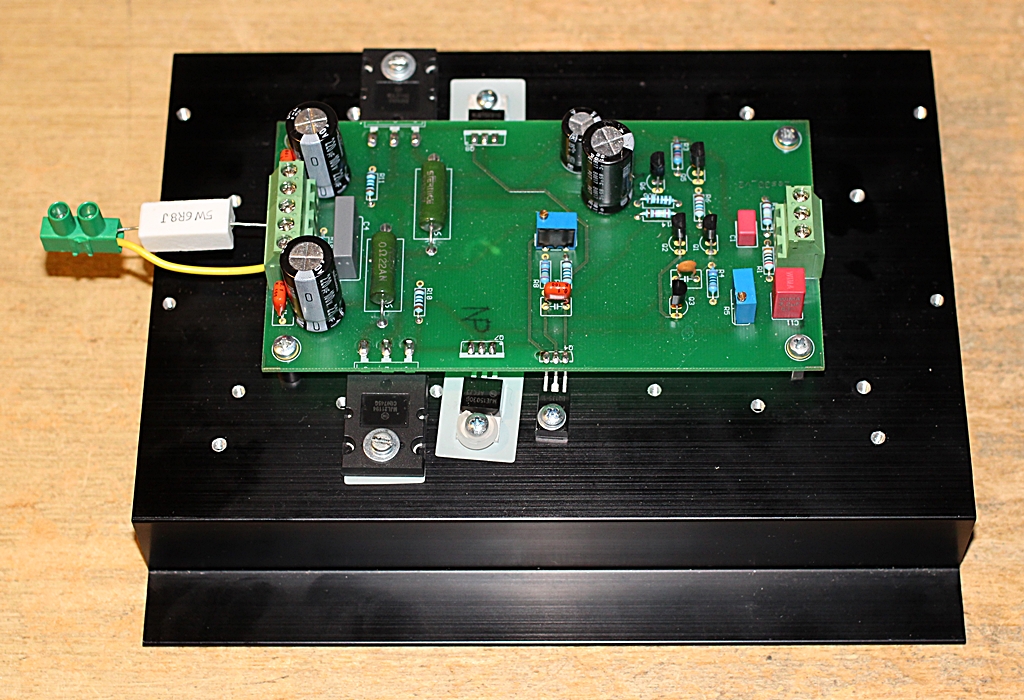

This is what I use for the test (modified old Sir Clive's). FB from out to R14 track was cut and FB is now on the yellow wire (photo). The resistor is the current sensing resistor for current drive.

Is it with any correction, or just a voltage drive?
Do you have 60Hz mains network? 😉
Starting with one of these: HiFi LM3886TF Mono 68W 4Ω Audio Power Amplifier Board AMP 50W/38W 8Ω Q5B5 191466724989 | eBay can make exploring dual coils much easier. Most assembled amps don't lend themselves to lifting parts and adding wires. Especilly if its an amp you care about. And this is incredibly cheap.

My test amp is a hybrid with an LM12 driven by an OPA134. Fortunately its pretty easy to tweak. Stability is not trivial in this configuration but can be attained and still have power to 80 KHz, even with the unusual feedback arrangement in this application.
If you follow the datasheet the LM3886 seems to be pretty stable even running motors on the other side of transformers. And they don't seem to break under duress.

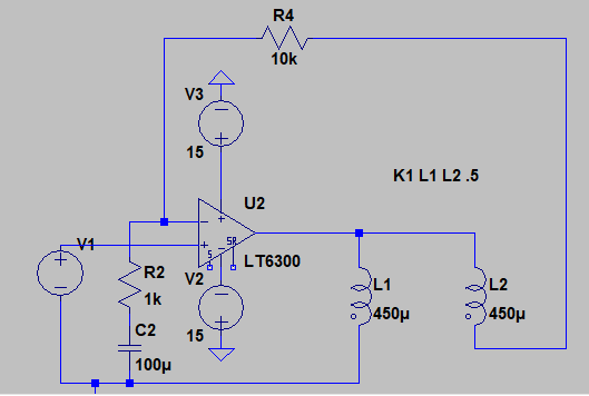

Take 2. I think this is closer to what you are currently thinking. It does seem to work much better with a 10 dB reduction in the 1.1 KHz sidetone over voltage feedback. The 800 Hz tone seems unchanged. The level is reduced by about 6 dB which seems right. If this is right i'll do a more complete battery of tests. What to test for?
Pictures; circuit, "coil difference" feedback and voltage feedback for reference.
Maybe you also want that protection resistor if the feedback coli/path breaks - as mentioned before by JN.
How do one calculate R4?

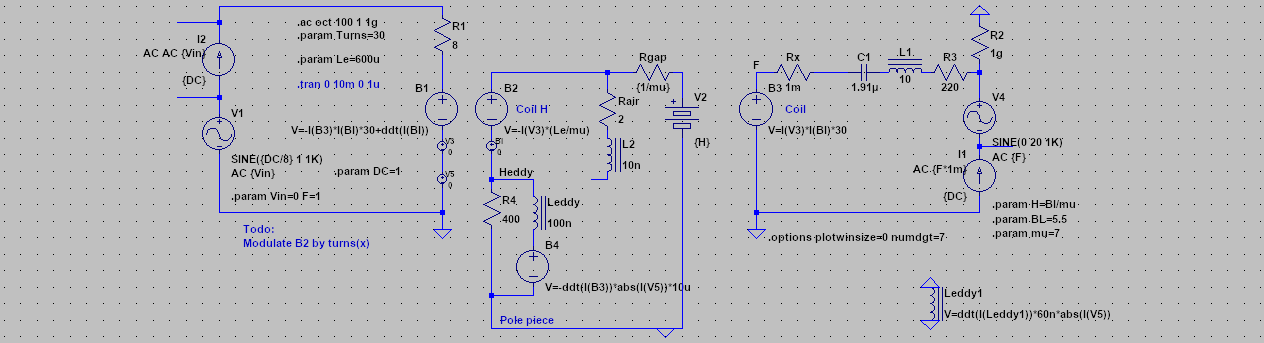

I am playing with a flux model which I think will help with the magnetic nonlinearity modeling.
Current in the voicecoil generates a static H-field (B2) which adds or subtracts from the H-field of the magnet (V2). The difference appears across Rgap which represents the permeability of the magnet. The current through it represents flux, from which Le and force are derived.
The magnet H establishes flux through Rgap. The coil H (B2) adds or subtracts from this flux, and the resulting Bl modulation results in distortion. This models reluctance force; if the voicecoil current were large enough, it would overcome the Bl of the magnet and be attracted to it rather than pushed away.
I'm pretty sure this is wrong in some way or I'm using the wrong terminology. I think H is analogous to voltage and flux/B is analogous to current.
For some reason I can't put dI eddies and coil velocity eddies in the same flux loop. B4 is my best attempt so far but it still doesn't work right. B4 represents a flux generated by the movement of an energized coil abs(I(V5)).
Leddy provides the resistive component of eddy currents shunting Le. However I can't get these eddies to provide damping to the cone at the same time.
