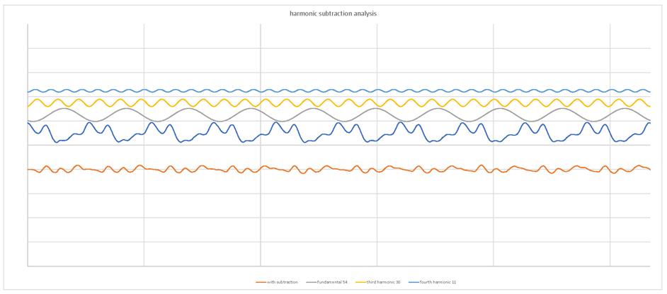

Demian,
This is the kind of analysis that is required.
I've attached a harmonic analysis of the type needed. One could try to use an FFT, but for this need, an FFT is a little bit better than useless as it does give signal power. However, it does not provide any intuitive feel for what is happening. For example, the attached. Yes, I could give the techs and mech engineers an FFT package to evaluate what is going on, but they will not be able to interpret the results sufficiently to diagnose the real problem easily.
Re the pic.
The dark blue is the waveform of interest, it is the error component of a closed loop negative feedback system. It is obviously periodic.
The grey is the fundamental sine. I altered phase and amplitude so that the resultant difference is minimized with respect to that frequency.
What resulted, I then found the next harmonic with lots of signal, it turned out to be third harmonic. So, I again played with phase and amplitude, and cancelled it out as much as possible.
Then, repeated it with the fourth harmonic.
The end result is the orange waveform. What is notable, is that this is no longer a simple periodic waveform. Rather, it is a gated waveform between the fundamental frequency and the fourth. This is a non linearity in the system, one consistent with mechanical gearing. In this case, I know exactly what happens every cycle of the fundamental, and can find physical entities which are affected by torque at the fundamental and fourth. This is all data dropped into excel, btw..
You should:
1. repeat the current vs diff run, taking note of which direction positive current drives the cone.
2. capture at least 40 cycles of the fundamental for both current and difference.
3. transfer it to excel
4. use the periodicity to average the waveform over the 40 cycles. This will clean the waveform up.
5. Fit the resultant error waveform to the current drive by gain subtraction to leave a residual.
6. Perform a harmonic analysis on the residual in the fashion I used here. that will show you the error vs excursion.
For a two tone test, you will require a lock between frequencies. Perhaps 10 times the fundamental, the lock needed for the averaging out function, you don't want to average out the higher tone. This test will show eddy drag modulation of the hf tone.

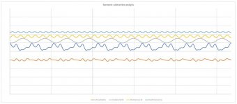

Re the pic.
You should:

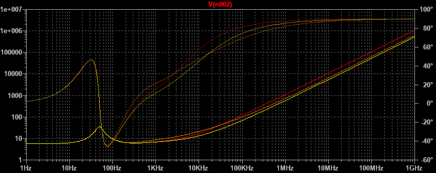

Was Demian's measurement taken with the cone locked or not? I think we need some way to isolate the different magnetic effects we're looking for.
This thread has some Z(x) charts:
XBL^2 design drawbacks? -
Techtalk Speaker Building, Audio, Video Discussion Forum
It shows some interesting activity, but unfortunately you can't tell which line belongs to which.
EDIT: Here is a Z(x) chart from my model. Nonlinear suspension is not enabled.
