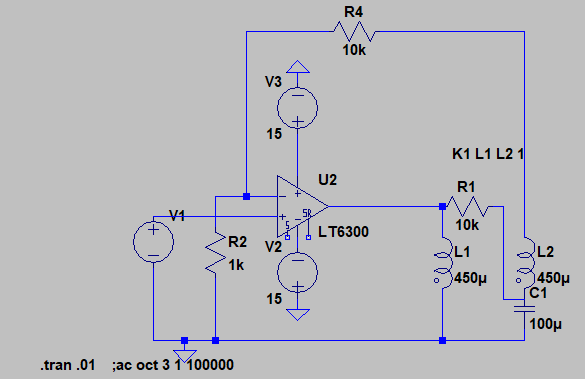

I have an amp and a box now.
My experiments with LTspice have not suggested good results even with a "perfect" transformer. But I think I have a workable solution for DC stability. The inductance is the measured inductance at rest at 1 KHz (same for both coils). The inductance increases when the cone is pushed in to 550 uH or more and drops to around 380uH pushing out for both coils.
However very little time to futz between now and the 26th it seems.
