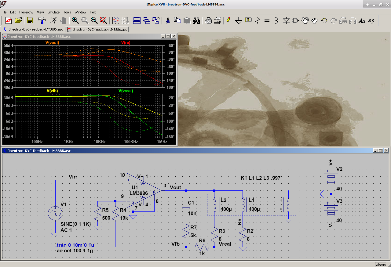

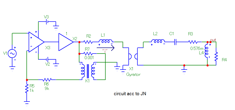

I just threw together the DVC circuit. It is not unstable, but it has ringing which needs to be cured with C1/R7. This compensation reduces the accuracy of the DVC subtraction which is shown in the yellow and green lines (ideally Vfb=Vreal). To reduce this error a faster amp is needed, since correcting inductance requires increasing feedback at higher frequencies.

Yes K, you added a hi frequency bypass to keep the feedback loop stable, good idea. BUT does this circuit LOWER measured speaker distortion usefully?
Unless jneutron is right and there is some useful difference between the coil EMFs, I don't think so. It will not really be any different from pure current drive, just with extra complexity and more that can go wrong. I was mainly just trying to get the simulation off the ground after PMA mentioned problems with stability.
The stability problems with this circuit are analogous to current drive, the amp's GBW limit imposes similar limits on both circuits.

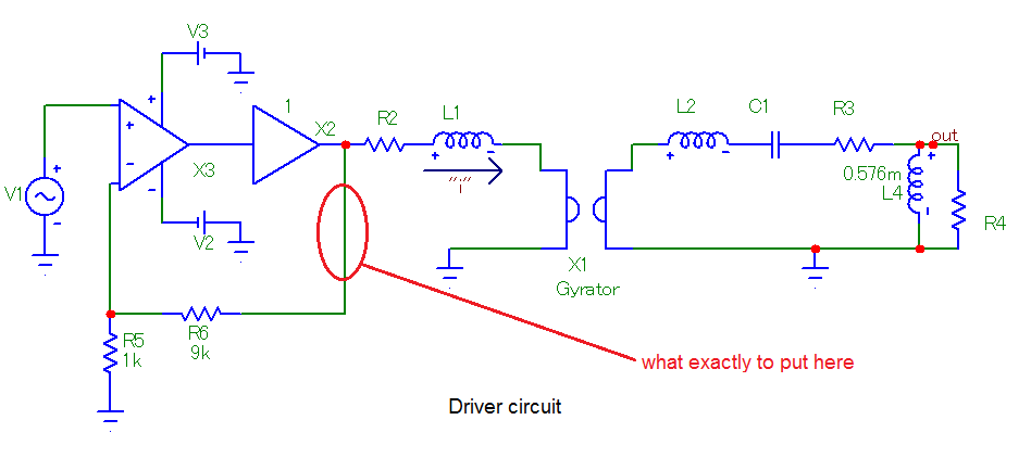

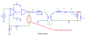

Jn, this is your compensation idea, right? It is difficult to keep the line, sometimes.
Edit: I have added a speaker scheme and am asking what you wish to put into feedback (ellipse).
That is my scheme.
As to your question, I do not know. I am not as good as you guys with this simulation.
I will think on it, but I still have much to learn with respect to what your doing.

That excludes the transducer EMF from subtraction, only subtracting the coil flux which does not couple to the motor. You have separated things which cannot be separated.
Use 2 gyrators, put the gyrator outputs in series. Then each input is an input coil which has it's own series resistance and small leakage inductance. There is not issue as you describe.
The flux that is not coupled to the motor can be represented by coupled inductors in series with the inputs, as the voicecoils are coupled more to each other than to the motor.

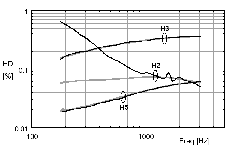

indra1 said:
Esa,
it seems atypical that 3rd harmonic distortion increase while 2nd decrease at higher frequency on voltage drive as shown on your link for both woofer and midrange. Did I miss something?
They are typical when measured with a proper microphone - you haven't missed anything. The 2nd harmonic on voltage drive is usually dominated by L(x) nonlinearity and therefore has a decreasing trend with frequency. The 3rd harmonic instead is usually dominated by L(i) nonlinearity, which increases with the inductive impedance and hence also with frequency. Figure below shows the harmonics measured in the current of a voltage-driven 6.5-in midwoofer (Peerless). (The gray lines are taken with blocked voicecoil.) Corresponding acoustic distortions are always higher than those in the current because of the baffle step and cone horn effects. Near the surround dip frequency, distortion often has a bump due to mechanical reasons.
See also these.

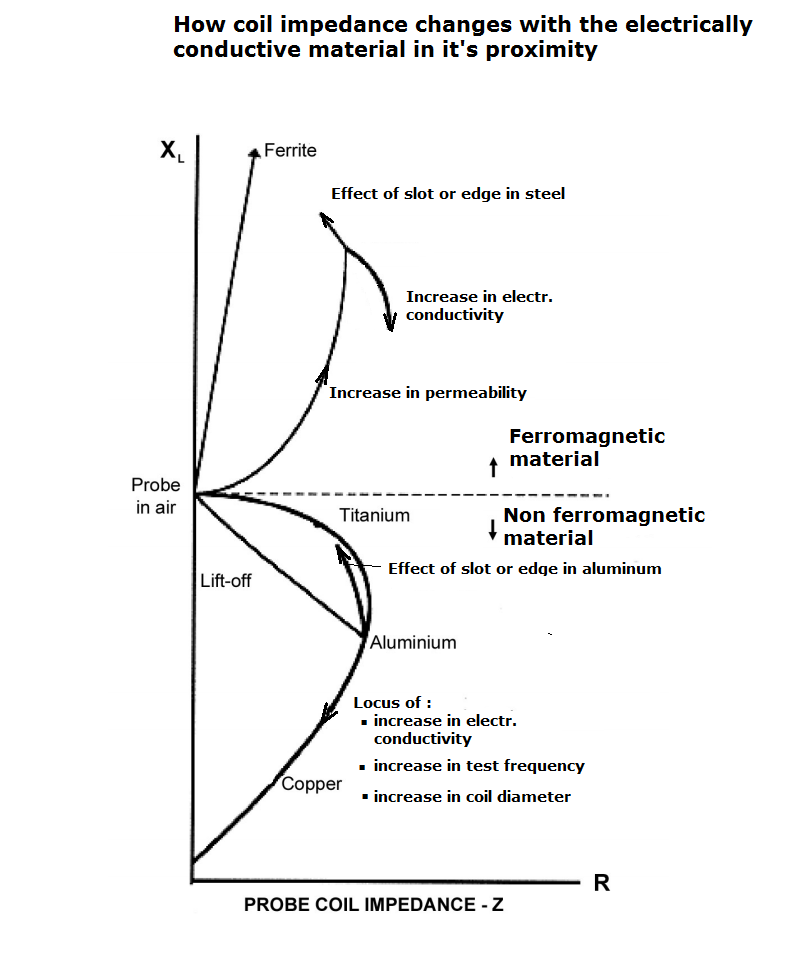

Circular currents of the plate and eddy currents in the plate are one and the same.
Eddy currents are the circular (better: circulating) currents
When alternating current is passed through the speaker’s driving coil, a magnetic field is generated in and around the coil. The probe's changing magnetic field generates current flow in the conductive material in close proximity to the coil. The induced current flows in closed loops in planes perpendicular to the magnetic flux. These current flow loops are named eddy currents (because they are thought to resemble the eddy currents that can be seen swirling in running water).
Now, the eddy currents produce their own magnetic fields that interact (tend to oppose) with the primary magnetic field of the coil (Lenz's law)
This changes the impedance of the driving coil.
Impedance
The degree of resistance and inductive reactance change of the driving coil depends on surrounding conductive material’s attributes, namely:
The electrical conductivity and magnetic permeability of the material, and the geometry of the material (i.e. , the amount of material cutting through the coils magnetic field and whether it contains edges or cuts.)
The distance that the coil is from the conductive material affects the mutual-inductance of the circuits.
If an impedance measuring system is connected with the coil and the system is balanced with the coil in air and then placed close to a piece of non ferromagnetic electrically conducting material, the resistive component R will increase (eddy currents are being generated in the electr. conductive material and this takes energy away from the coil, which shows up as resistance) and the inductive reactance Xl of the coil decreases (the magnetic field created by the eddy currents opposes the coil's magnetic field and the net effect is a weaker magnetic field to produce inductance).
If a slit or edge is present in the material, fewer eddy currents will be able to form and the resistance will go back down and the inductive reactance will go back up.
Changes in conductivity will cause the eddy current signal to change in a particular way as well as test frequency and probe diameter.
When a probe is placed close to a ferromagnetic material such as steel, eddy currents form, again taking energy away from the coil, which shows up as an increase in the coils resistance. And the eddy currents generate their own magnetic field that again opposes the coils magnetic field.
However, the inductive reactance increases.
This is because the magnetic permeability of the steel concentrates the coil's magnetic field. This increase in the magnetic field strength completely overshadows the magnetic field of the eddy currents. (remember that for metals, conductivity change spans from 0 to 110 in IACS scale, while rel permeability spans from ~1 to tens of thousands).
The presence of a slit or edge, change in the electrical conductivity of the material, change of test frequency and change in probe diameter will produce a change in the eddy current signal similar to that seen with non ferromagnetic material.
Ah, Perhaps that is the problem of understanding. Eddy currents dissipate energy as heat, and they fight dB/dt by the creation of a counter magnetic field which works to try and exclude flux change within the conductive surface. The difference is, when the stimulus ends, the eddy collapse does not return magnetically stored energy to the system like an inductor. So, it does not change the flux in a way the pickup coil can see.
Eddy currents do store energy and give it back. Otherwise it’s effects wouldn’t have been utilized.

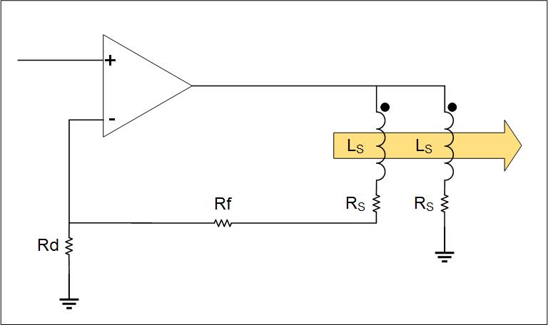

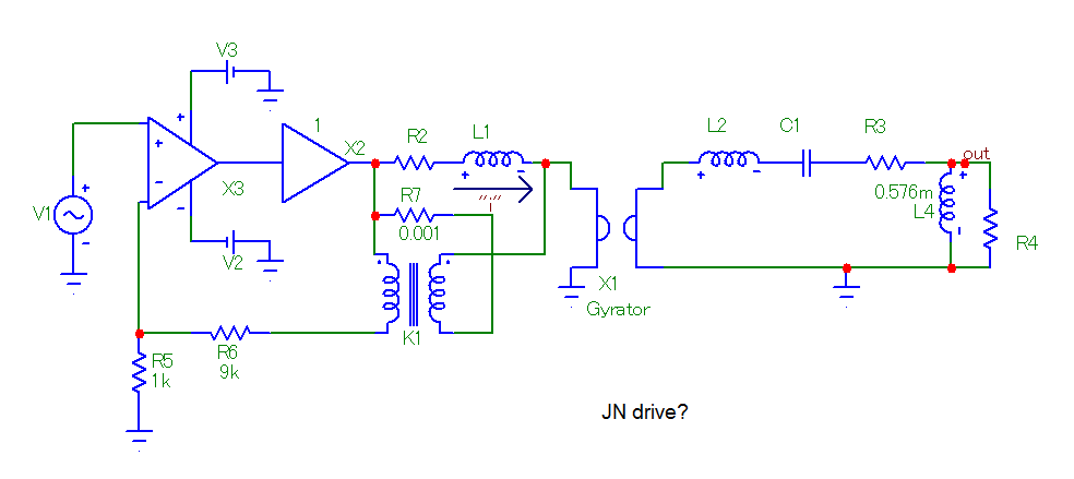

That's why I have done it. I have explained in the one previous post it cannot be separated. In fact the scheme, according to JN's hint, would go like now attached, and it does not work.
You may have figured out what jneutron is seeing in his head, I wasn't able to.

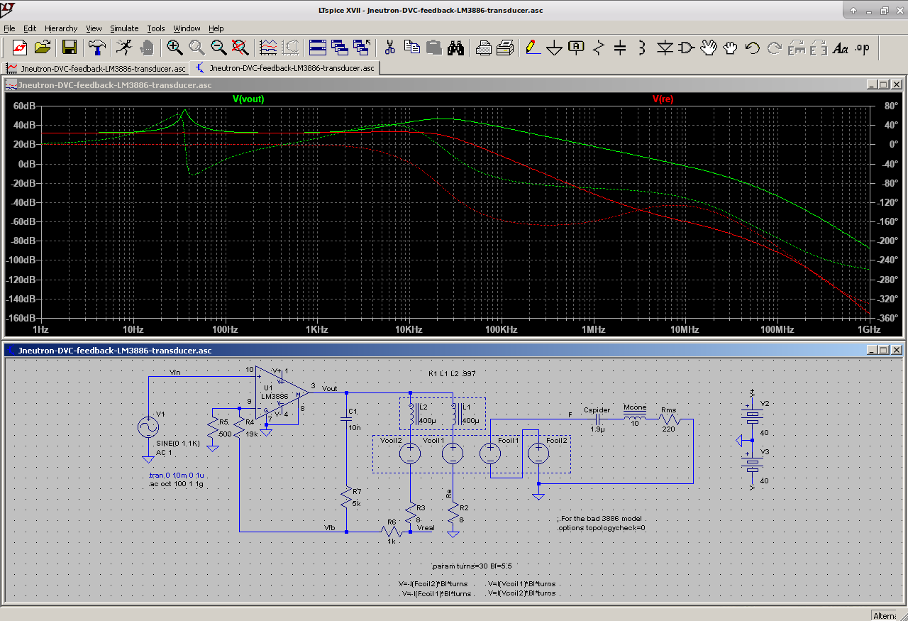

Here is my schematic which AFAIK shows how it actually works. You can expand the mechanical side to include Bl modulation, suspension nonlinearity, etc.
The gyrator has 2 inputs, the second input would be on that line. L1 represents leakage inductance, which would be very small with a bifilar wound coil, so it should be very low, maybe 0.2% of Le.
L1 represents coil’s inductance (Le)
