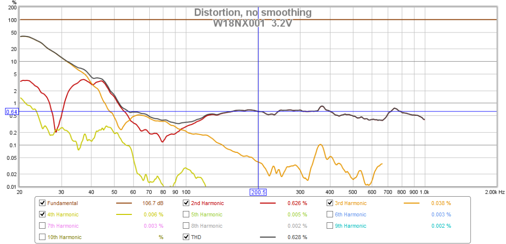

it seems atypical that 3rd harmonic distortion increase while 2nd decrease at higher frequency on voltage drive as shown on your link for both woofer and midrange. Did I miss something?

Looks like you misinterpret the graphs. Execpt for the glitch at 120Hz H3 there is no point in the graphs where voltage drive gives lower distortion than current drive.Esa,
I mean typical distortion reading on regular voltage drive usually show decreasing H3 going higher in frequency like Pavel's Seas.Looks like you misinterpret the graphs....
Esa's link show increasing H3 with decreasing H2 towards higher frequency for woofer and midrange. Either the drivers are atypical or I miss something like normalization or weighting.

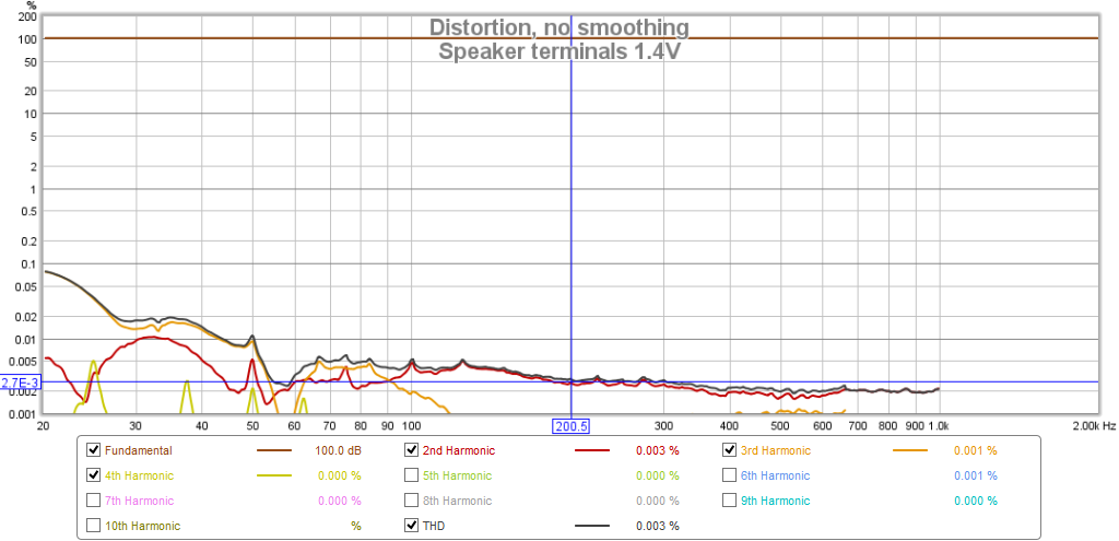

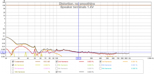

I think it is worthy to display or at least to check distortion at the power amplifier output, with speaker connected. It is good to know that amplifier distortion does not rise with frequency and that the amplifier distortion is always at least 20dB below measured speaker distortion, everywhere, at any frequency and amplitude.
You used one of my measurements as an example and I would like to add a measurement of distortion (voltage) at speaker terminals, behind the speaker cable. This measurement belongs to acoustical measurement that you have shown, but at 1.4V, I am afraid that for 3.2 it has not been saved, however there would not be a big difference.
