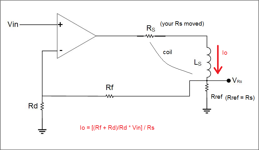

The circuit in your post is a current drive. The same circuit as I use for the current drive of tested speakers.
That specific diagram was to show something in particular. You understand current drive, this is almost current drive, but this is not quite the same. I drew it that way, eliminating the 1:1 transformer that is the DVC, and connecting the feedback directly at the model Rs rather than make another Rs, with dotted lines indicating it is the exact same voltage as the model Rs. But implicit in my drawing is the fact that the resistance is part of the voice coil and immersed in the magnetic circuit. An external viewing resistor is supposed to be rock solid.
1. I am viewing the exact coil real impedance component. You look at an external resistor.
2. I control the exact voltage the resistive portion of the coil has. You control the exact voltage on an external sense resistor.
3. I do not compensate for voice coil heating, just a pure voltage across the distributed resistance which allows compression. You can cause thermal runaway if not careful, but avoid compression.
4. I automatically compensate for hysteresis of the magnetic circuit**, you cannot do that with current control. And because that is position dependent and creates H2, I have a slightly better handle for cleaning some of that up. Especially when it causes intermodulation products.
I believe your technique is frequency limited and I believe requires tuning to accomodate the speaker. (I would be happy to learn otherwise from you).
I believe my technique is not, and does not require adaptation to the load. (but again, the jury is out on that, we are learning as I type.)
Both techniques are capable of reducing H2 and H3, and from your nice model, it appears both can extend the lower frequency region below normal resonance.
Which is best, who knows.
Which is simplest, who knows.
There may be a hybrid of both that is even better, who knows.
Hopefully we learn from others till we die..

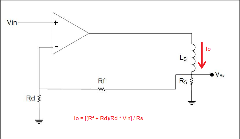

From the point of view of circuit theory, I see no difference if I take your Rs (voice coil resistance), put it up behind the voltage amp and replace the Rs of your schematics (which was connected to gnd) by a reference resistor Rref, value Rref = Rs. This Rref is now a current sensing resistor, same Io flows through the coil and the upper serial Rs makes no difference in the coil signal, it only rises voltage at amp output. The only difference would be that before the Rs might have been nonlinear, like temperature dependent.
Your circuit theory view is entirely accurate, that is not the problem.
You make the incorrect assumption that all of the current that flows through Rs contributes to the BLI product and therefore voice coil force.
That is incorrect.
edit: I do my best to try and keep up with you guys with much of what you post, I try not to stare at the floor too much as I drool.
But E/M theory is not one of those subjects I have a problem with.
jn

1) so a part of the current that flows through Rs is lost somewhere? This seems to violate Kirchhoff law.

How does the DVC circuit compensate for magnetic hysteresis in a way that normal current drive would not? In current drive you are increasing series impedance, in the DVC circuit you are decreasing EMF voltage. Both do the exact same thing just from a different approach.
Any energy that shunts around the force generating mechanism is not seen by current drive. It may increase the voltage requirements through compliance but cannot control for loss of transfer function ( transfer function being the conversion from current to force.
Any losses which cannot be seen by the current means the coil is not in the exact position you want it to be. Under current drive, you do not care where the voice coil is, nor do you care what it's velocity is nor it's acceleration. You only care about current.
In my scheme, any change in the coil velocity is seen by the pickup coil, and the difference is seen at the feedback terminal.
2) I have no doubts about your knowledge of E/M theory.
1. I refuse to break the law..😀
2. I have doubts about my knowledge of E/M theory..😀. Luckily, I have people here who are far above me in that regard...
Is there any magnetic situation/environment where Kirchhoffs law is not valid for an electric circuit?
I am unaware of any. If I were, I'd be waiting for that call from Stockholm.
I think he means that the magnetic hysteresis shunts the generated EMF, thus a portion of the current does not generate force. IE a similar mechanism as an aluminum voicecoil former.
Yes, you mention two of the mechanisms.
